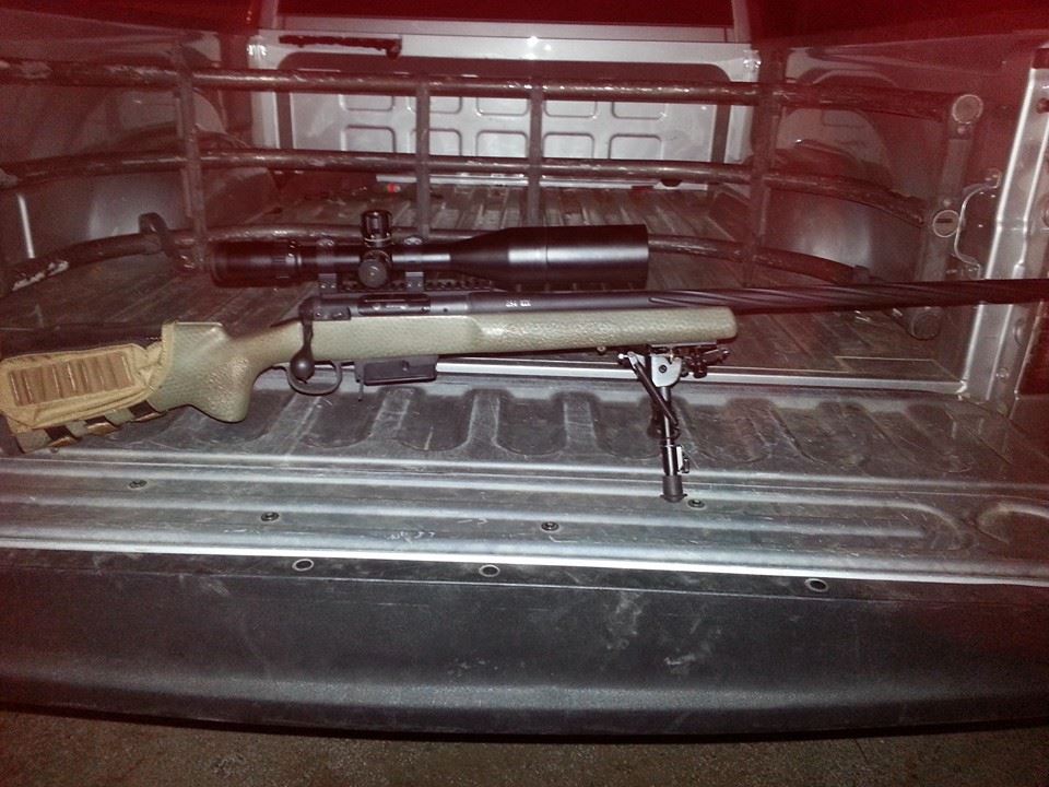

I was wondering why no one has bothered with IMR 4350 in their 284. I believe it's a very good powder for most combinations. I'm running a blueprinted savage short action with accurate mag bottom metal and dbm, krieger 9 twist @ 28" with brake, manners t3 stock, nightforce 20 moa base, warne rings, and bushnell 6500 6-24x50 ffp g2dmr.

Here's a couple pics of the chrono reading after 55gr and the rifle. The 54gr charge was the most accurate at 1/4" at 100 and the worst was a tie between the 55.5 and 56 at 3/4". It's still a new barrel so I hope the accuracy will stay with the 54.5 ish loads. If I can stay at 3150 or 3100 ish I'll be happy.
