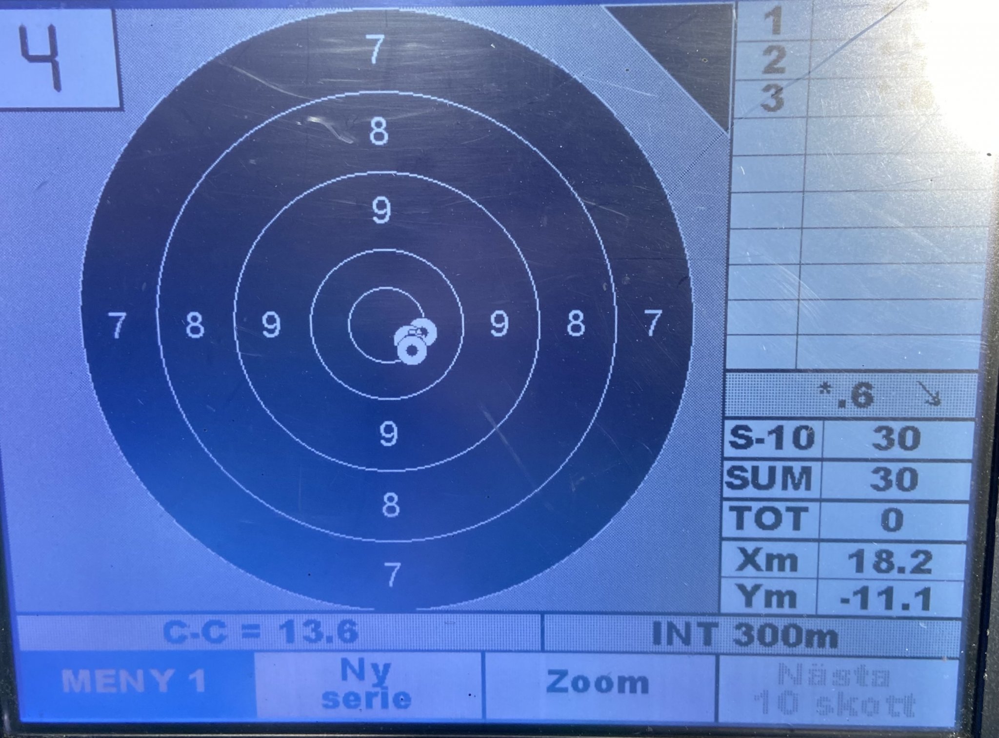

After changing to VV N570 & Berger 230 Hybrid (from VV N565 & Hornady 225 ELDM) I'm now getting a consistent group size of between .25-.5 MOA at 100Meters with low SD. Also had to get my bold bushed. The large firing pin was piercing primers even at low pressures.
28" inch Bartlein 1:8 on AI AXMC
85.7GR VV N570
Lapua case
CCI 250
909 m/s with SD of 1 = 2982 Ft/s with SD of 3.3
Jump 0.02"
CBTO 72.20mm/2.8425"

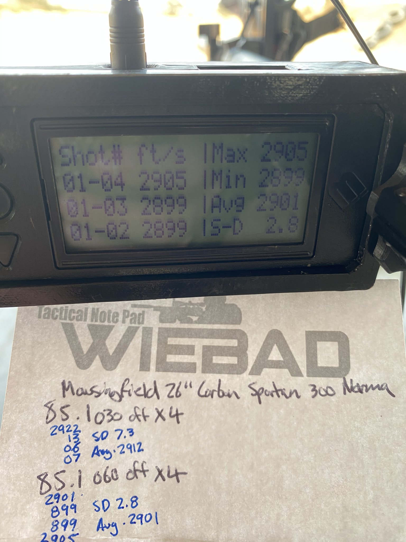

86.8 gr H1000
28 in K&P 1in9 twist

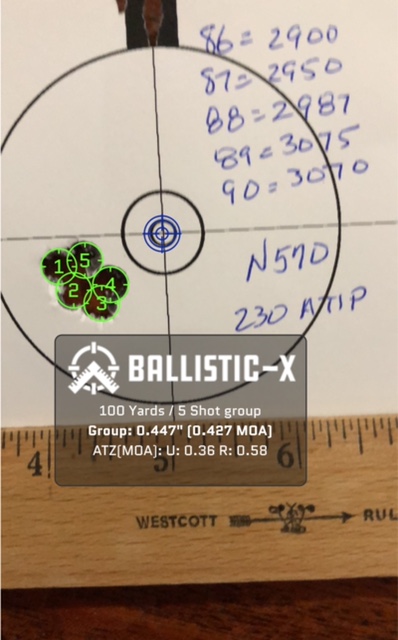

1/8 26 inch AI barrel (25 shots on it)
230 ATIP - 3.700 COAL
Lapua Case
N570
86-2900
87-2950
88-2987
89-3075
90-3070
RL33
91-2942
92-2954
93-2993
94-3026
95-3075
No pressure signs with either powder.
Case is pretty much full @ 90 N570 and @95 RL 33.

Any accuracy info?
Any accuracy info?

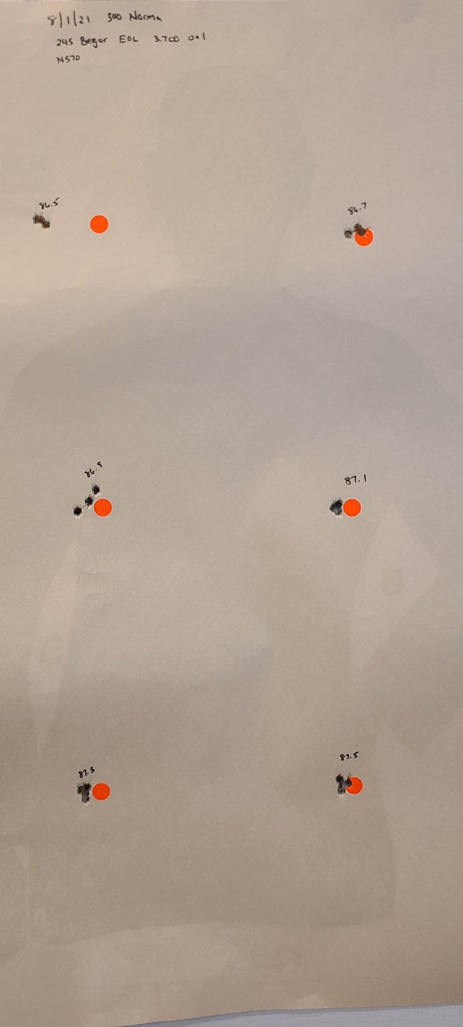

I was only looking to see where pressure would start with each powder. N570 target with the 5 diff charges attached. RL 33 was about the same.

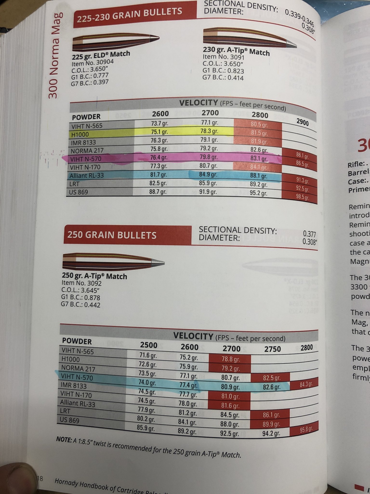

Anybody get the new Hornady book? Actually has 300 Norma load data. Even has LRT data. Lyman has a Long Range Reloading book with 300 Norma data. That’s surprising considering Hornady has said a few times that they had no intention of publishing 300 Norma.
Any load data for N570 and the 250 A tip?
I may have to buy it either way though.
I’ve got their latest online manual and there is no data for 300 Norma Magnum
I'd be surprised if they put any data out for the Norma while they are still pimping their PRC round.
Maybe they are trying to make up the lost sales revenue with reloading books since the Lapua PRC cases came out.
I'd just purchase the QL software and work up.

Here ya go
Thanks for posting that I'll pick up the book.
I'm definitely over their data. Just hit 85 rds on the barrel and still playing with loads. Was at 87 grs of N570 with the 250 gr no pressure signs and was averaging 2953 fps. Cleaned the barrel and it sped up to an average of 3015 fps still no pressure but groups opened up so I'm backing down and re-testing.
From Hornady -
Rob, This data was definitely all done in a pressure barrel and shot. However we did use the SAAMI spec. standards and not the CIP spec’s. The (MAP) per SAAMI on this cartridge is 61,000 psi. Thanks.
The CIP (MAP) is 63,817 psi.

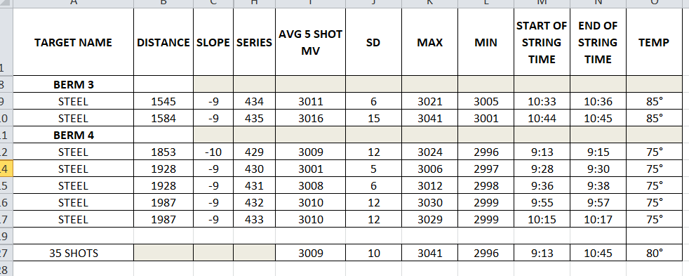

Nick, here is the data for the overall SD/MV and each target shot with 87.5 grains of N570 and the 250 ATIPS.
Reactions: nick338
Thanks for posting. Nice to see someone else shooting the Norma with 250 A Tips.

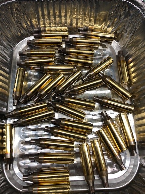

They seem to work okay with the N570. My overall SD was 10.07 for the 35 shots, but you can see that the SD for the 5 shot strings was between 5 and 15. Looking to smooth that out a hit. The error was always on the high side. I'm guessing tight neck tension. Those cases had been fired 3X without annealing. I annealed cases tonight and will try again next weekend.

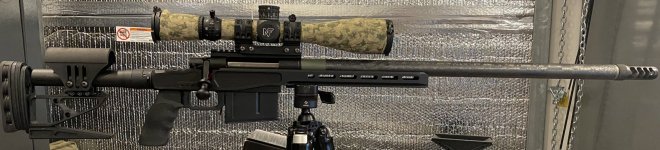

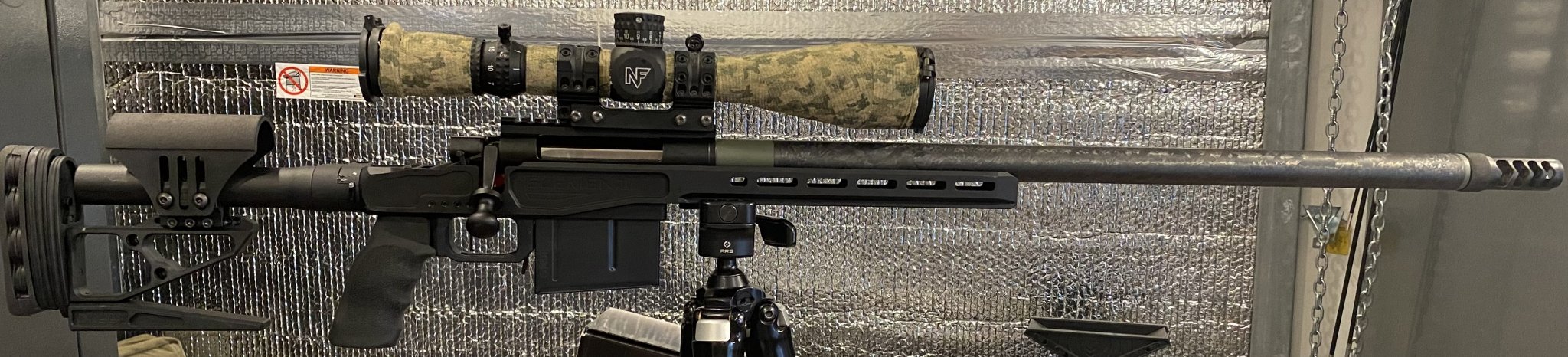

Ultimatum Deadline- 28" barrel, 1-9
225gr ELDM
Bertram case
CCI250
H1000 84.0gr
Jump 0.010"
2985FPS
SD7
85gr got me to 3035 but getting some ejector swipe and left it alone.

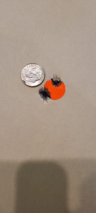

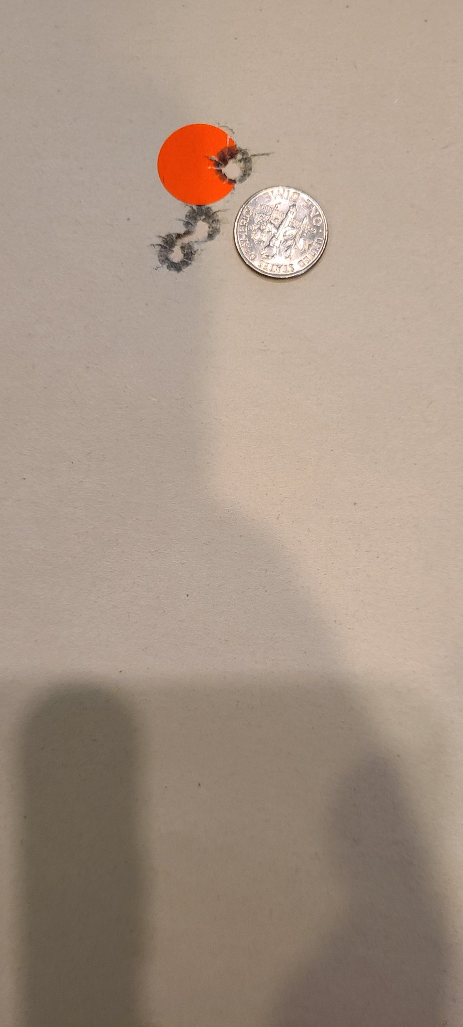

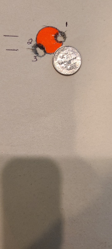

Please explain “very well”.
at what distances?
pics?
Thanks
