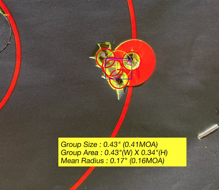

Here is a 1 mile group from a few weeks ago:
If you notice. The first shot is high on paper. I saw the splash behind the target and new it was a high shot. I lowered on the target and sent the other 4 as fast as I could get back on target. You see an insane vertical spread of around 2" at a mile. The horizontal was due to a 12-15mph wind that would blow and let off from second to second. While the high shot put this at a 21.619" group, I was beyond happy with the outcome of the group. I was the only one to keep 5 on target that day. That target is an IBS 1000yd Target....but shot at 1mile.
Later in the day I shot a 1000yd target and the Verticals at 1000 are just plain crazy:
You will notice the wind monster ate me up again...but that is a 0.71" vertical on that target at 1000yds. Getting your SD and ES down as low as you can will allow you to achieve this sort of precision at long range. If the wind would have been nice that day....I could have had an epic day with the 300PRC. These groups were shot with Berger 245's, RL-26, Fed215's...and shocker... Hornady 375 Ruger Brass converted to 300PRC on like the 5th firing.
So...I suggest you try out the 215M primers and see if the Magnum primers give you better ignition and help shrink your ES/SD to a point where it won't affect you as much at long range.
BTW....these groups were shot with a TACTICAL gun...not a benchrest gun. Scope is a ZCO 5-27 with MPCT3 reticle...so don't think I went out and shot with a typical BR light gun on linear bearings with a $2500 front rest and a 50x scope...I did it with my ELR gun.
Have a great day and I hope you enjoy your 300PRC as much as I have over the last 2 years.
