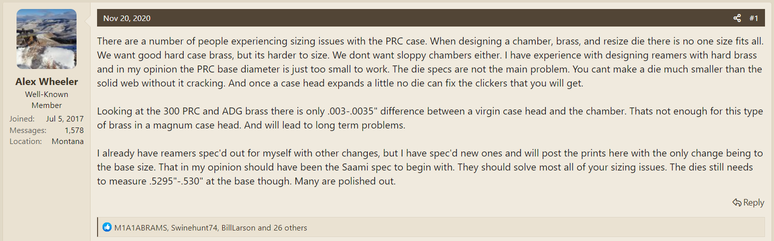

You aren't the only one... https://www.longrangehunting.com/threads/the-prc-die-problem.253223/page-18
I had the same issue and went ahead and fixed it by rechambering to Alex Wheeler's AW2 chamber. The SAMMI chamber is tight (especially with ADG and Lapua brass).

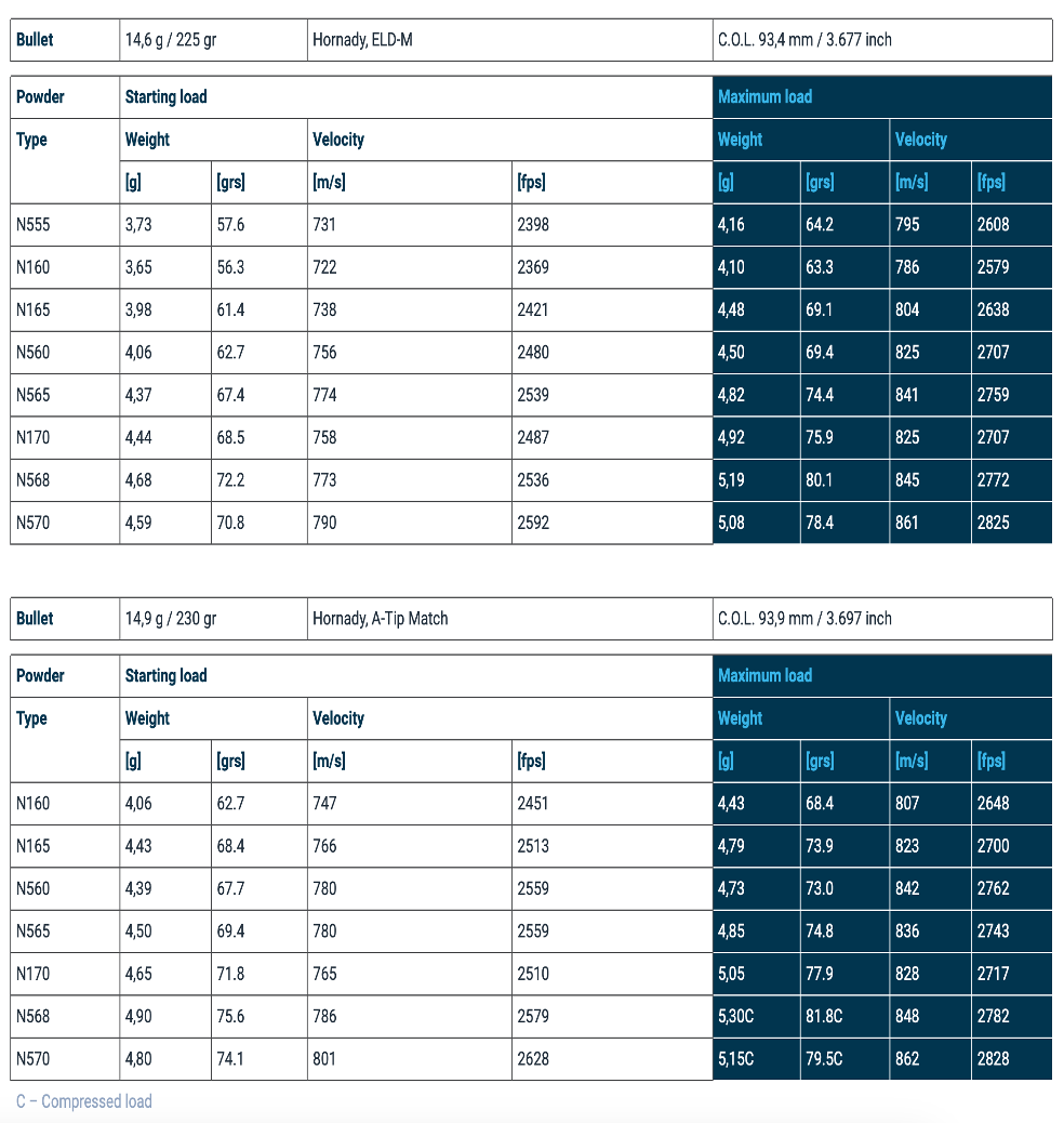

I believe the high angle problem with the 300 Norma was alleviated with N570. Some say it's more temp sensitive than some powders but I haven't seen any extreme velocity changes shooting from 20 degrees up to 90. I think Bryan Litz likes N565 a little more for stability but I haven't tried it the Norma.
I'm back to testing my 300 PRC with the Berger 220 and N568 but don't have a lot of data yet. I don't have the barrel length to run the heavies.

How does making the chamber bigger solve the hard sizing / brass sticking in the die / brass shaving issue?
Reactions: TripleBull
I solved my sizing 300 PRC issue by ordering four different FL Bushing dies...not the preferred COA.
I originally had 2x Redding dies and both of them were attempting to size the base area at .5275- .528(too small). I destroyed several pieces of brass and was very frustrated. Prior to that I was NS only with great success until the 4th firing. Redding reworked the dies by polishing them out free of charge(3 day turn around).
I then ordered a LE Wilson and RCBS die and problem solved. Both dies size the cases to the exact spec by barrel requires.

What does your sizing dies measure at the base (mouth) dimension of the die? I know it is hard to measure with the radius at the bottom but if you can try to measure it at the tangency of the radius/body I would appreciate it.
probably one of the best explanations I've read in a very long time, thank you, thank you.

... off topic, sort of, was surprised to see neither N565..N570 or any of the Vihtavuori powders listed in the Hornady reloading manual (10th edition).
Did you check VVs website? They are obviously listed there for 300 prc. I am in the process of testing both n570 and n560 w Berger 220 LRHT. That said the number VV lists for 560 seem low to me…. GRT simulation shows pretty low pressures for the recommended max charge…. Anyone directly use this combo? I’m pushing the 220s from a 30” barrel…. Have yet to test the rounds too though.
from VV. PS: these numbers are by them stated as for a 26" barrel, you will notice N570 is quite a bit higher at all the loads.
