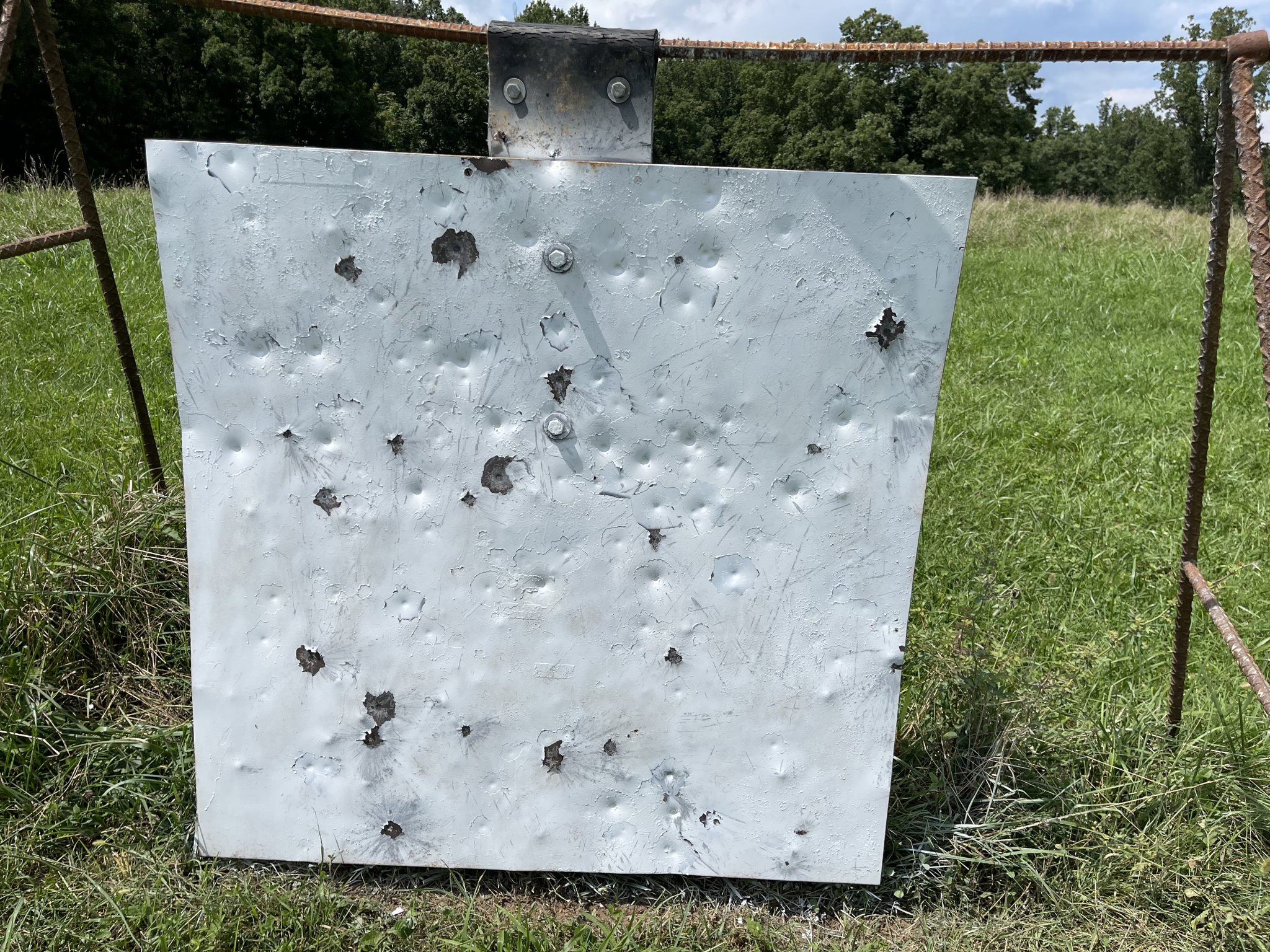

Got the opportunity to shoot a mile the other day. well almost at 1730yds 4x3 steel tgt(big but not too big for a mile ish.
Barrett Mk22 - 26" 300 PRC CF barrel 1:8
76gr RL-26 - 2900 FPS
Lapua brass
GM215M
230gr A-Tip
Elevation 15.3 mils
Surprisingly I got 10/13 hits at that range.

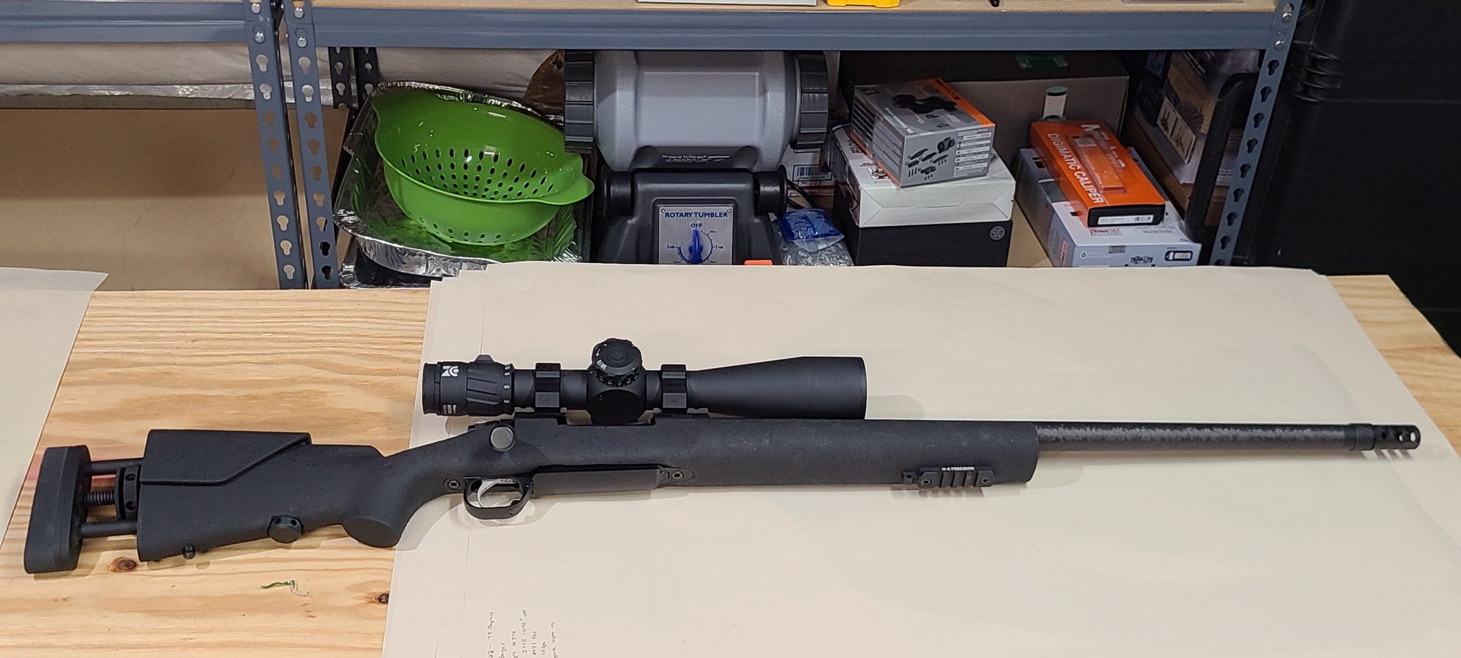

Finally able to share some data on a West Texas Ordnance 300 PRC.
HS Precision M24 Stock
Impact 787R
Bix N Andy Trigger
Bartlein Carbon Fiber 24" 1-9 Twist
Insite Arms Heathen Brake
Rifle sits at 13 lbs with optics.

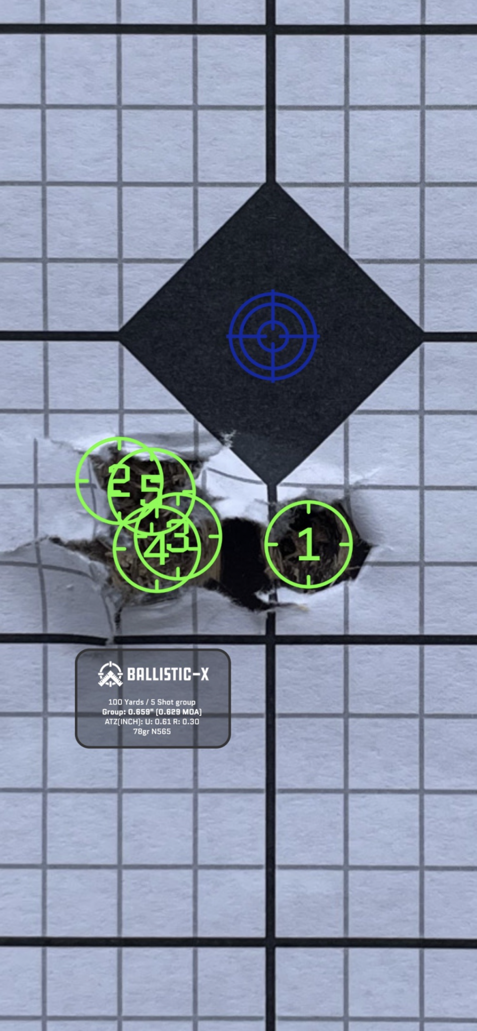

Played with N568, N570 and N565 and Berger 220 LRHT at .025 off the lands.
First powder tested was N568 which was accurate but had high ES numbers, like 25 fps
Next up was N570 which the rifle didn't like and neither did my shoulder. Definitely a different recoil pulse than the N568
Moved on to N565 and found the sweet spot, most likely due to a shorter barrel and faster powder. Very accurate, every group around the 78 gr mark shoots 3/8 or less but was still having an issue with high ES. Started playing with neck tension and could see the ES drop as the barrel broke in.
Seems to like the CCI 250 primers a little more than Fed 215's, at least in vertical spread at 100 yards but will be taking it out to 600 soon.
Current load is:
78.8 grs N565
CCI 250
.3055 Mandrel on Virgin Lapua Brass
Avg Velocity 2844 fps
ES 9 fps

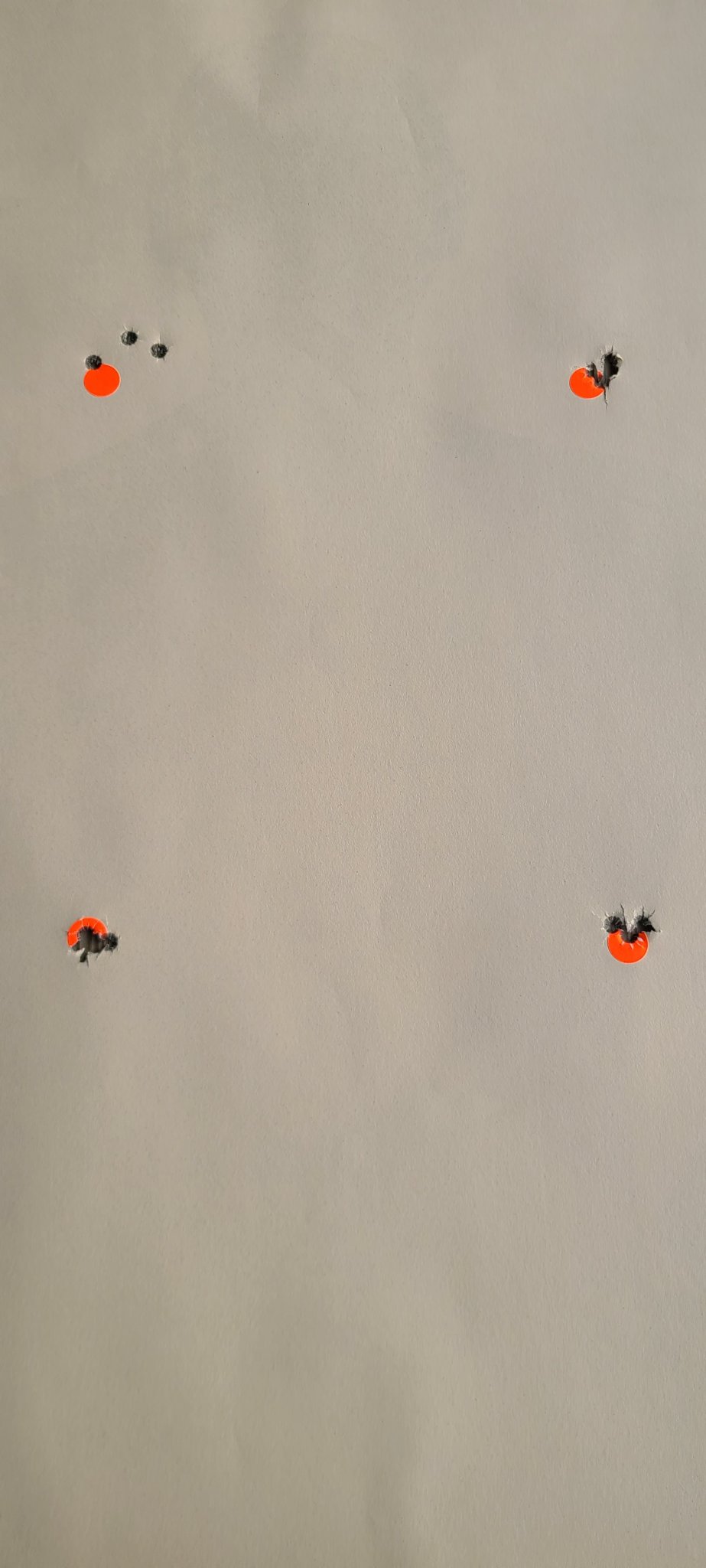

I finally finished off my ladder test with 245s and N568.
88F 49% RH
81.4 2798
81.6 2807 (tight group)
81.8 2829 (tight group)
82.0 2829 (tight group)
82.2 2867
82.4 2835
82.6 2848
82.8 2872
83.0 2885
83.2 2877
83.4 2879
I could have kept going but I felt it was getting hot with light ejector marks and slight increase in bolt lift.
Going to load a few at 78.3ish, 80.7ish, 81.9ish. Will report.
