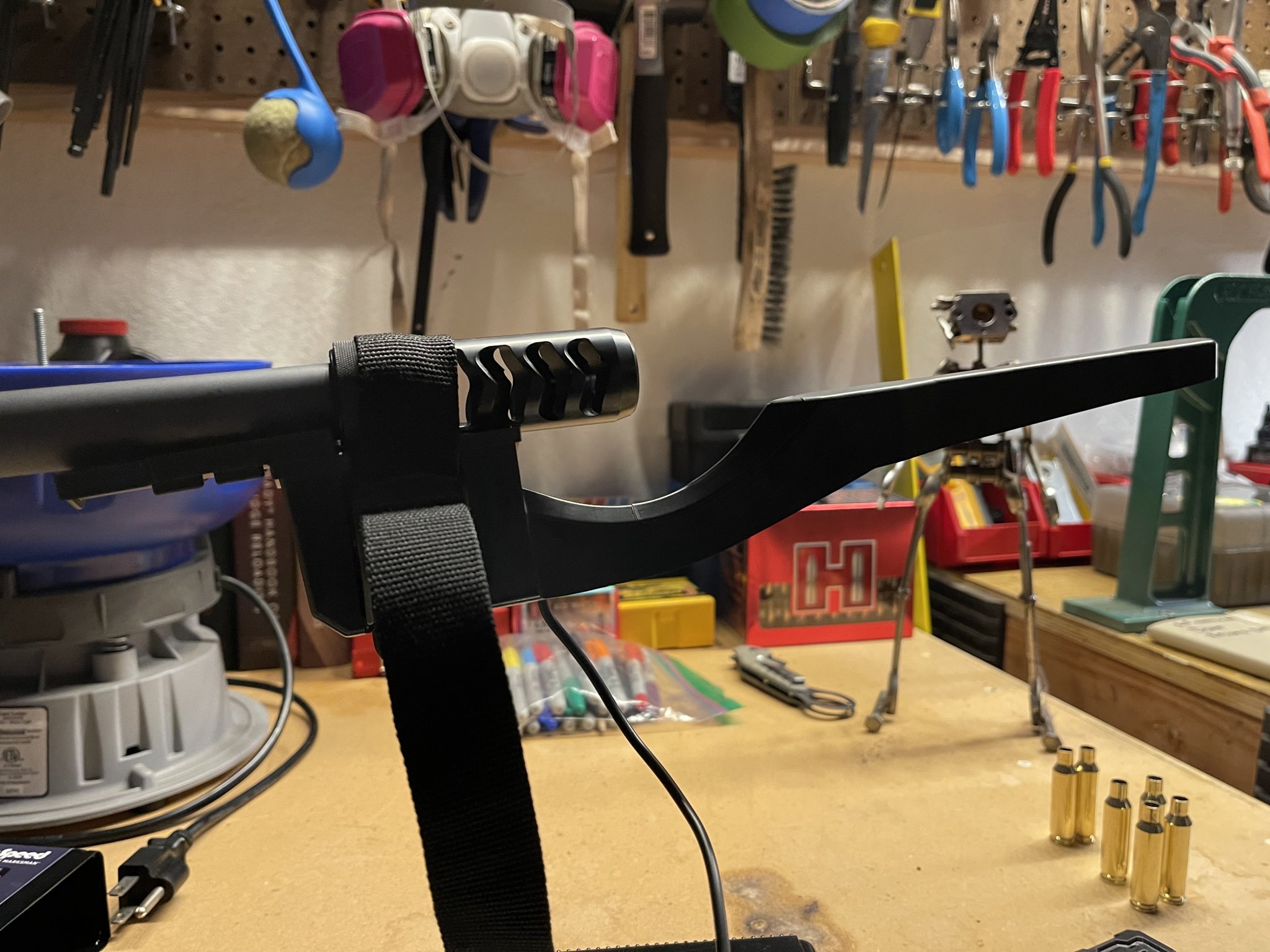

View attachment 7896027Silly question for folks…. I have a Bergara 26” HMR and I’m developing a few hand loads for it. I normally use my magnetospeed Sporter w my 6.5 cm and I’m trying the same here. My issue however is that I’m running a Area 419 muzzle brake and the damn think doesn’t align properly from the barrel mounted position. I’ve seen folks w suppressors mount from there but never from a brake….. anyone experience w this before I go and ruin my magnetospeed? (I’ve also heard that the V3 is longer so I may go that route too…). Pic to show what I’m thinking:
Look at the MK Machining and Wiser adapters for the MS Sporter models to get it off the barrel.

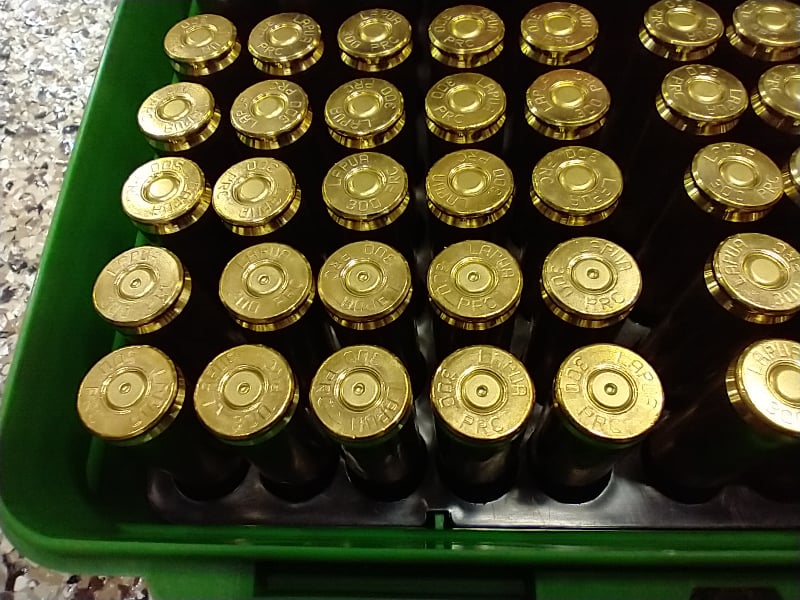

Random question for the peanut gallery here since im not sure where to put it…. I’ll be in the UK in a few weeks and I’ve noticed that Lapua brass for 300 PRC is much easier to come by there… spoke w a shop to potentially pick some up in person. Has anyone ever brought brass ONLY through US customs?

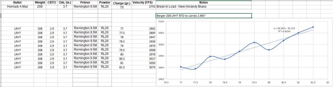

Here is the results I got from the 208 LRHT and RL26.
GRT says it is getting quote hot, case heads are showing me no pressure. Row 1 Case 1 is 77gr, Row 2 Case 5 is 81.5gr. Virgin Lapua brass with a .307 mandrel. charges done on a CM lite. Barrel is a 24" K&P done by LRI.

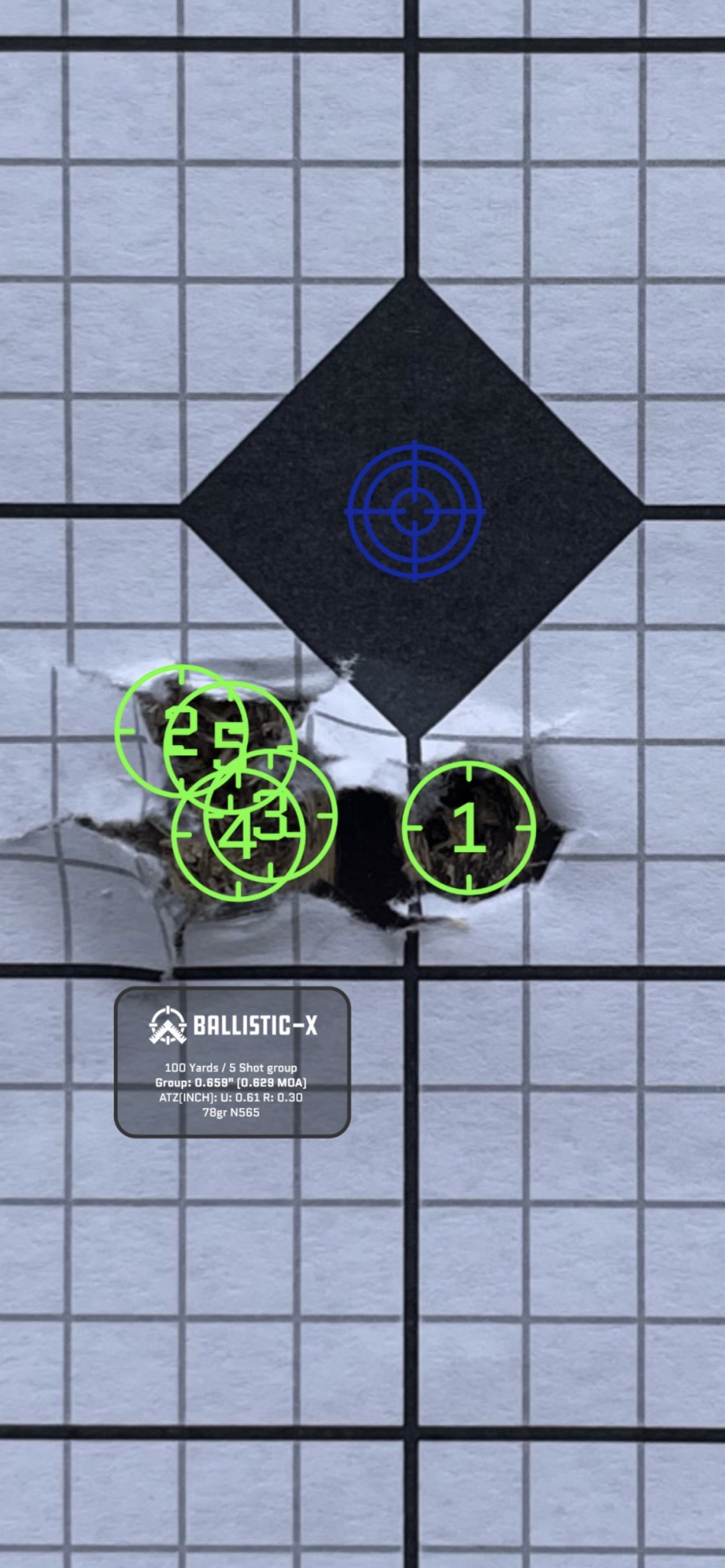

Also had 5 rounds of 78.0 grs N565 with Berger 230 HT leftover and they shot .63moa @ 2778, see picture.
