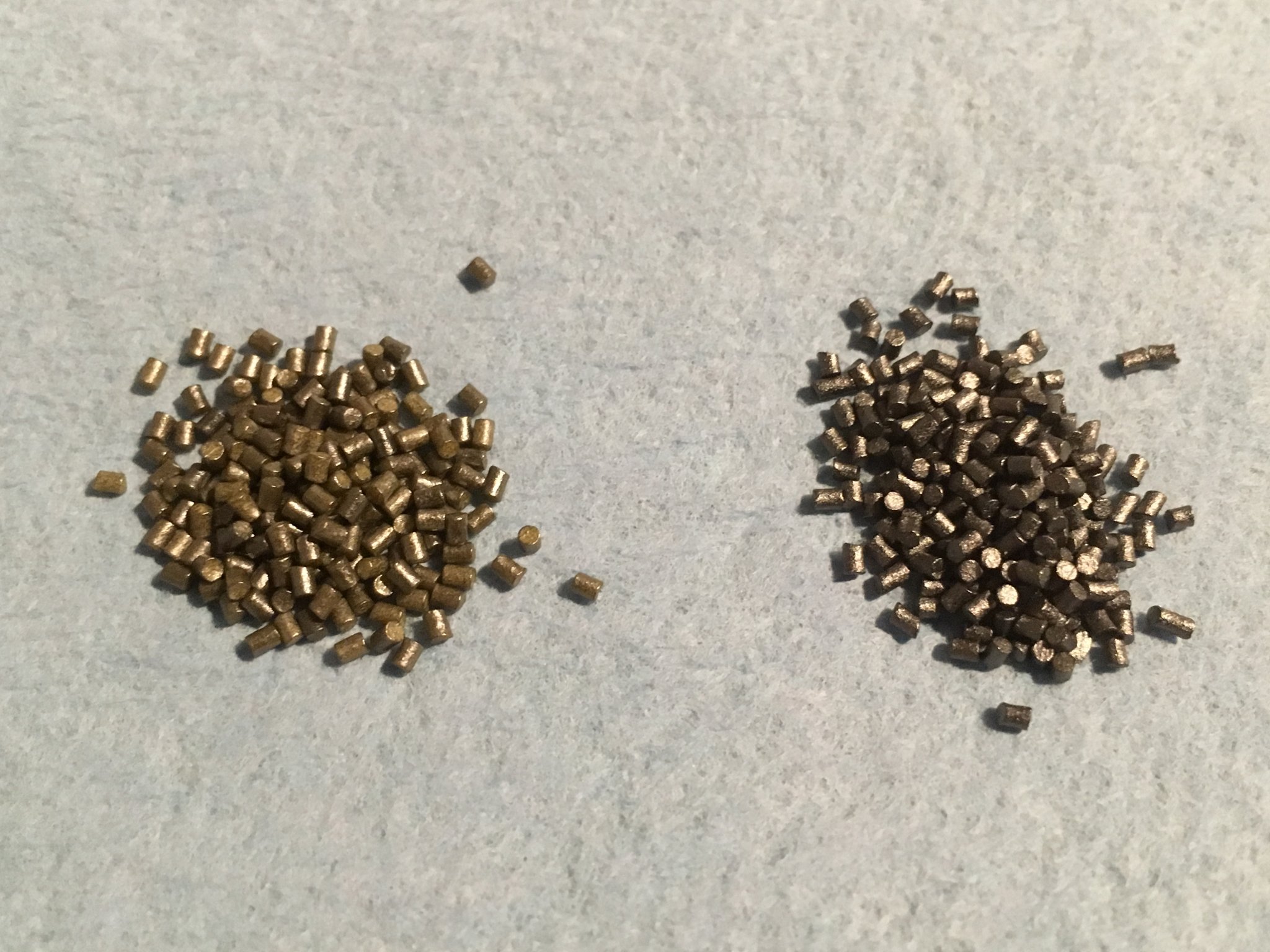

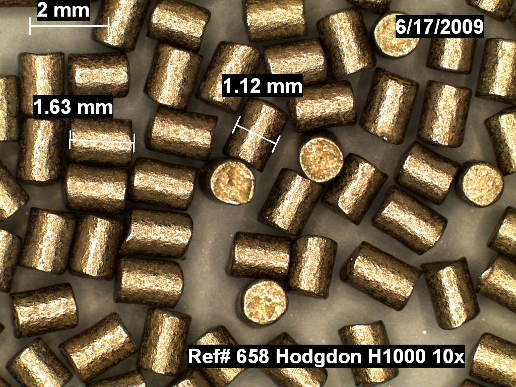

*Correction* The new lot of 225 ELD-M does not use H1000.
H1000 on left.
Lot 0359...3.667
Lot 0278...3.679
Lot ......0338 is 3.662 coal 75.0 gr powder
lot .......2739 is 3.685 coal 75.2 gr powder

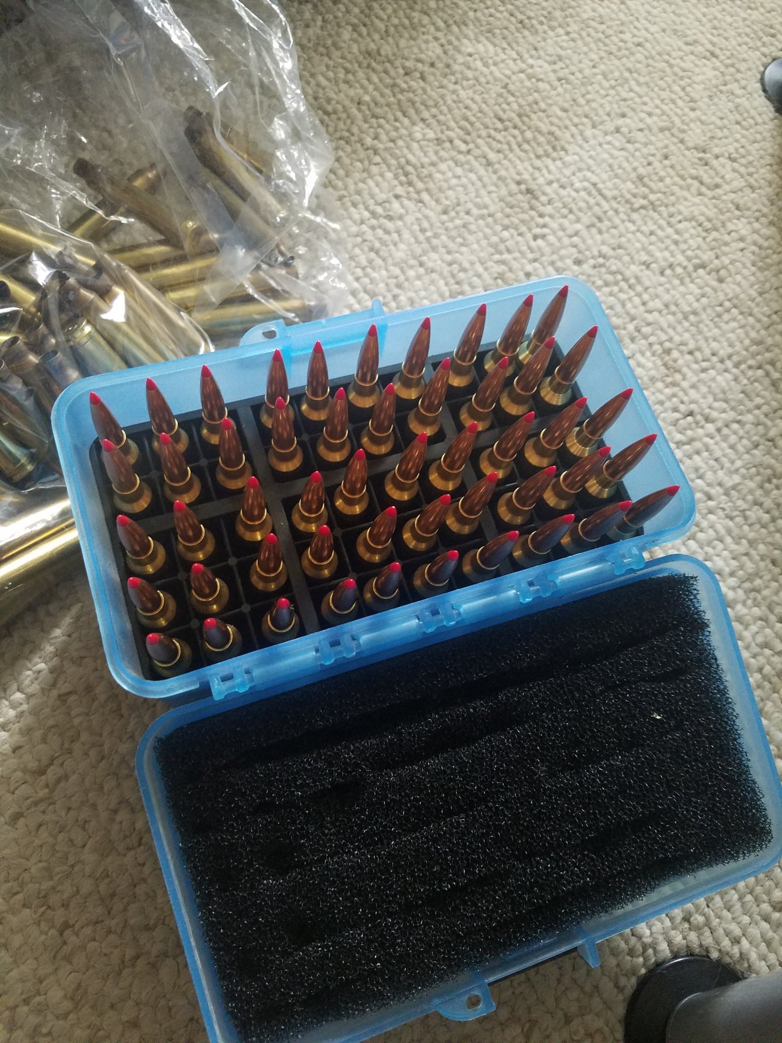

After one of those royally crappy work days yesterday, all was made better when Marc at Spartan Precision emailed me to tell me my rifle was ready to go. I picked it up, did a measurement for seating depth, and loaded up my first ever 50 rounds of 300 PRC (attached). I'm heading to the range tomorrow to break in the barrel and take a few pics. I'll post rifle stats and results tomorrow afternoon.
Looking forward to the results.
