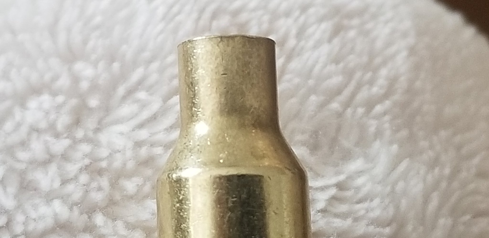

I don't know what if any brass prep you did but one thing I always do with Hornady brass is straighten the necks and chamfer in and out. The way Hornady trims the brass to length it rolls out a lip on the case mouth. I've seen it cause a slight interference fit in some chambers. That could well be the reason for your two out liars. Neck tension alone would not cause that much increase in velocity. It's in our head that neck tension causes major issues but it's been my experience that it's over rated. The act of seating the bullet acts like an expander mandrel and pretty much makes all the neck tension the same. Brass hardness affects it more. That's why I don't anneal. They're all the same.
That is a fact....I just recieved 100 new Hornady 300 PRC cases and the first thing I noticed was a lip on the case mouth opening.

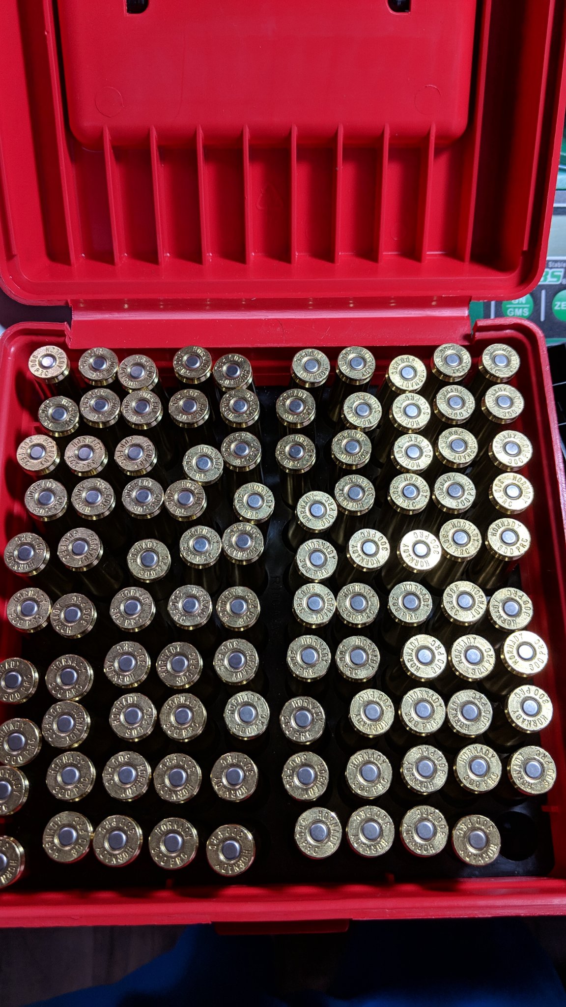

That's what all mine looked like. Spent hours yesterday prepping 100 new Hornady 300 PRC brass. Hoping ADG starts making it for the 300 PRC soon. Talk about frustrating times having to prep this Hornady stuff. Good thing it's -2 here and I didn't have much else to do.

Yep I've bitched for 20 years but it is what it is. Actually not a bad thing as it makes us do basic prep work which we should do with any brass. It doesn't take long if you can run the tools under power.
