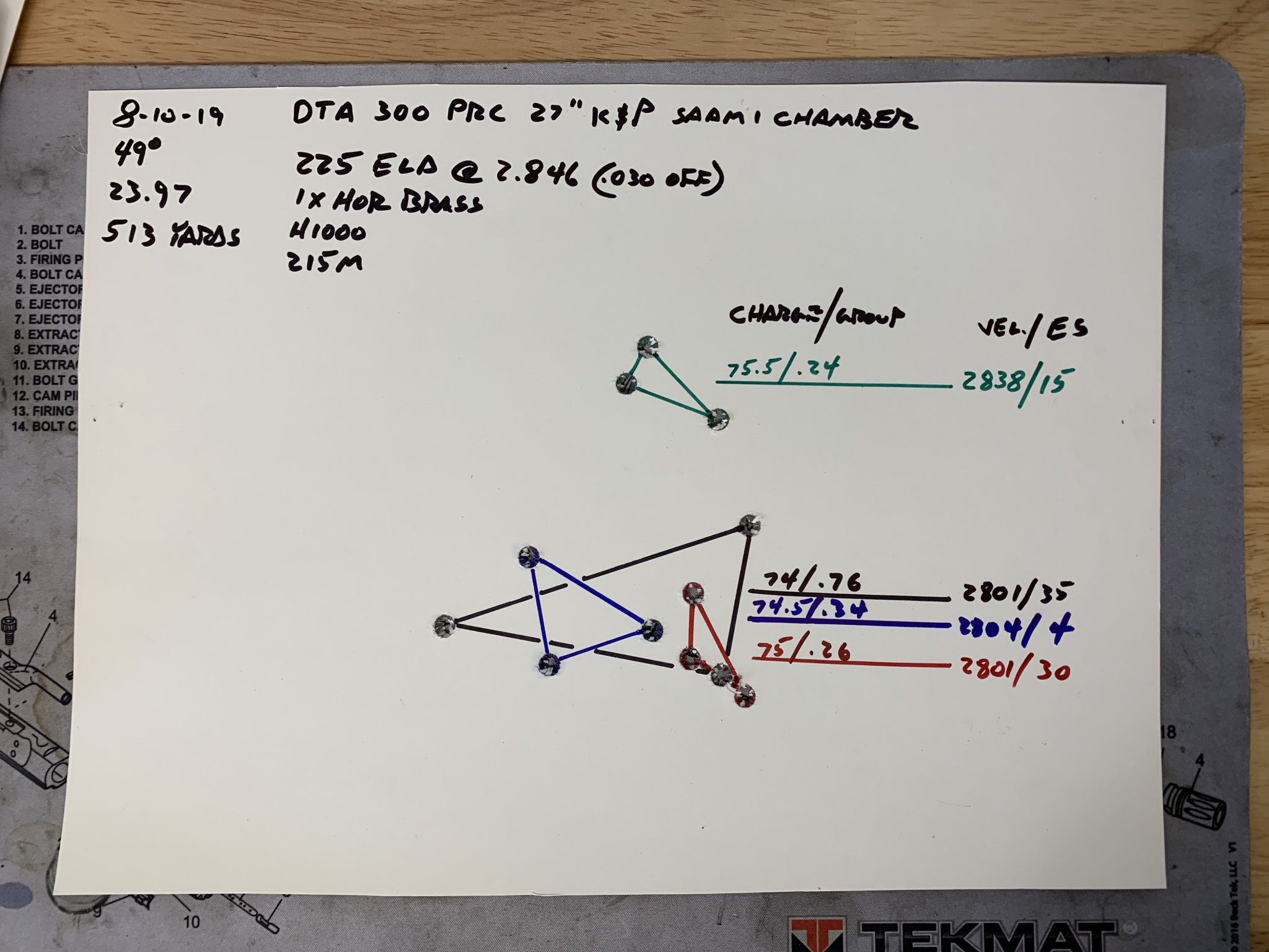

Shot a narrow OCW test at 513 yards today. Probably should have gone wider on the charge range. It appears there’s a super wide velocity flat spot between 74 and 75 grains. On the last outing there was a 23fps spread between 74 and 75 grains(only single shots at each charge), and today it was 3 fps. Charges were double weighed, so not sure what happened, but that seems too close a spread. ES in the individual charges sucked for two of the three, which probably played into the low ES across the range. Since this was the first go round loading the fired cases, I learned that my neck bushing isnt small enough. The Hornady brass necks have a tapered wall thickness, and my .335 bushing doesn’t size them down enough to for a mandrel or expander ball to uniformly establish the ID. So the base of the neck is sized and gets kissed by my mandrel, but the top of the neck was oversized. So the necks are essentially funnel shaped on the ID. Neck tension was all over during seating. I have another bushing inbound.

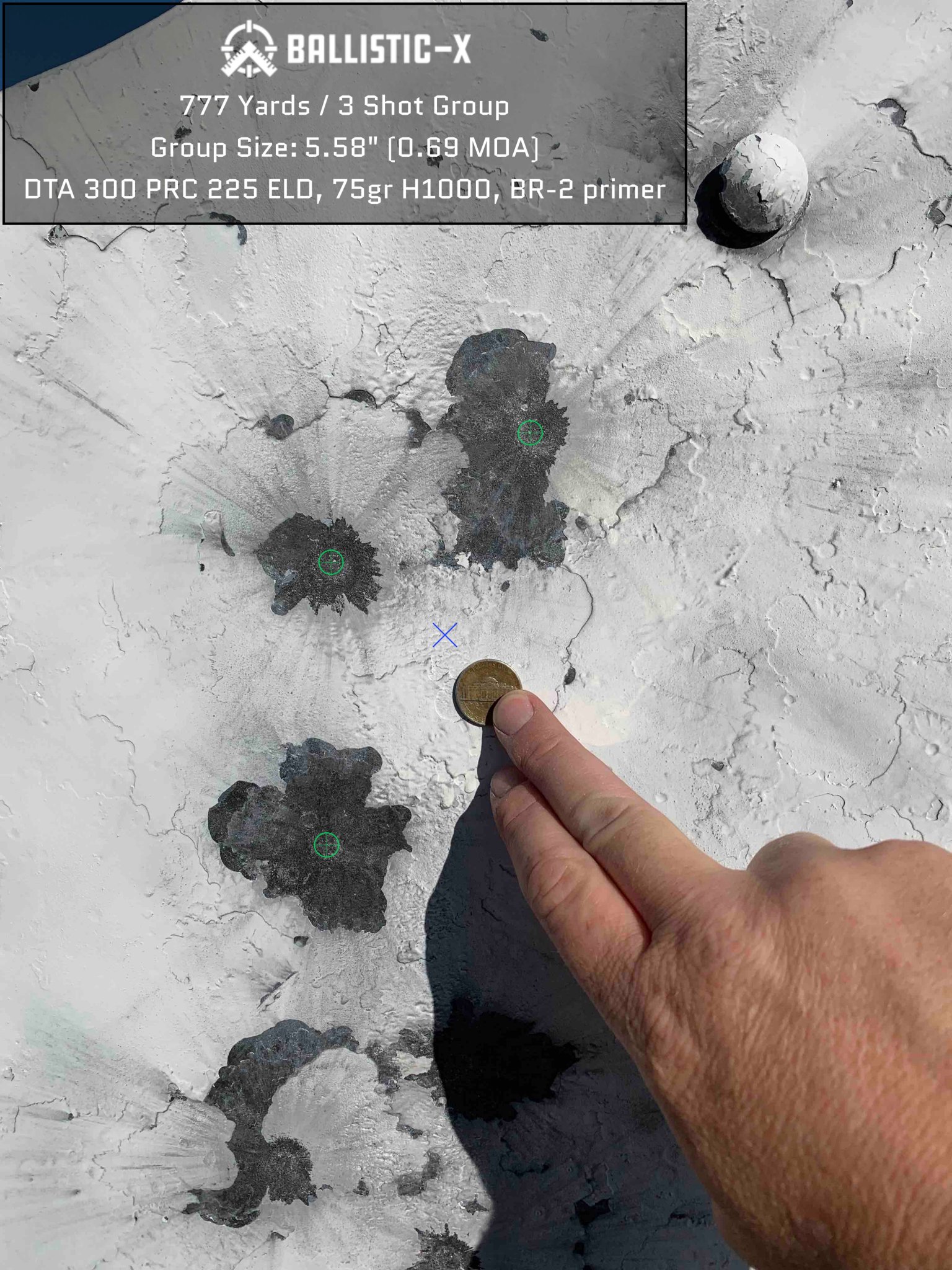

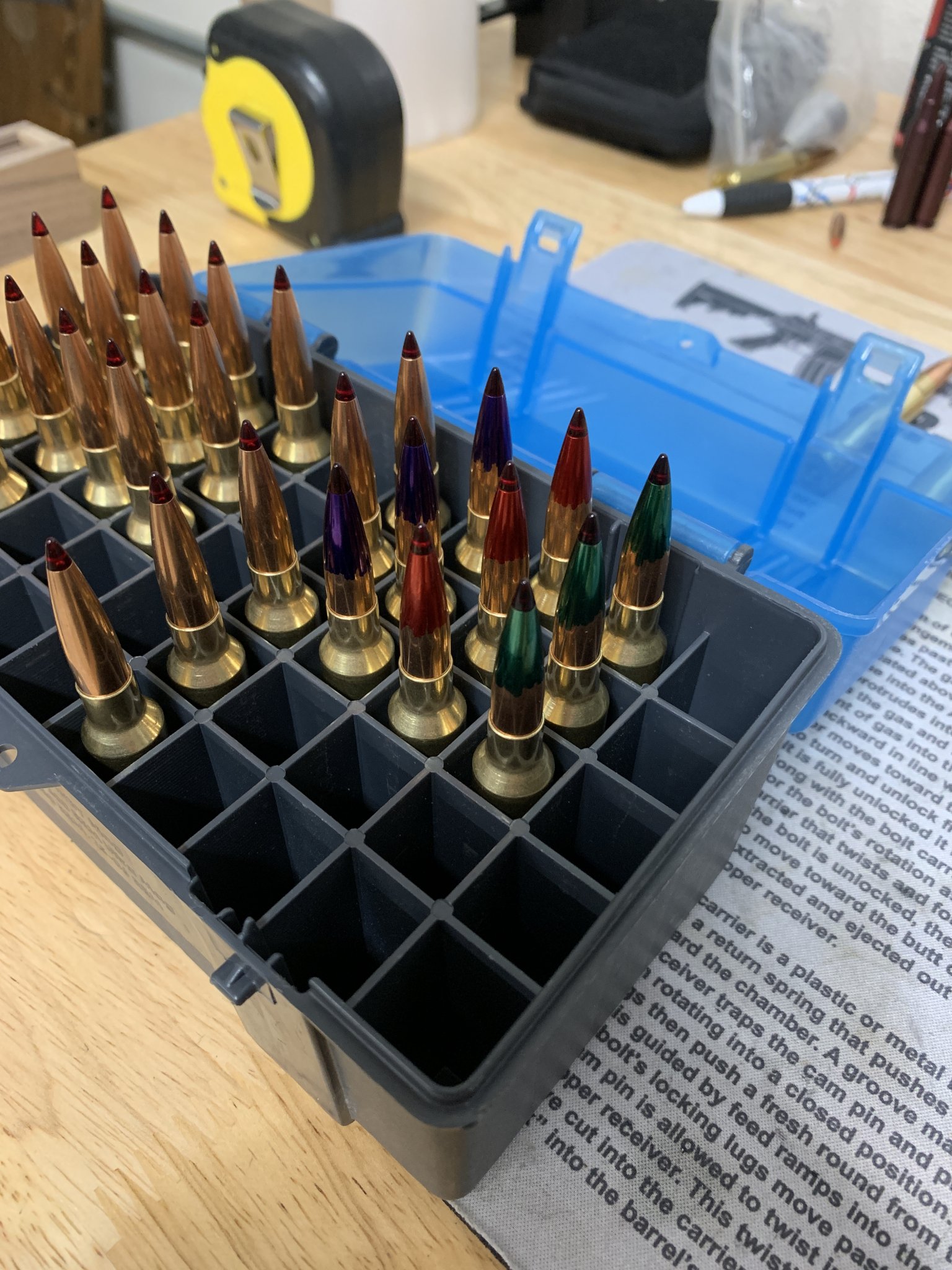

I loaded up 10 extra cases with br-2 and 215m primers(5 each).

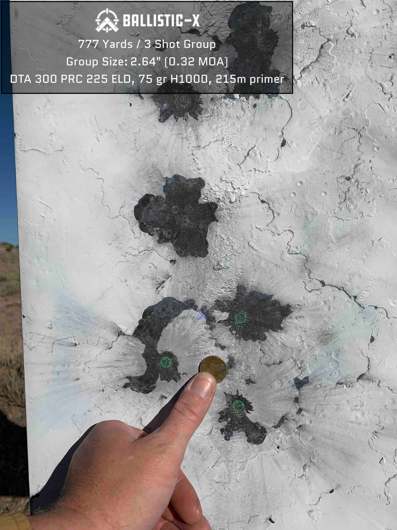

Shot three of each at 777 yards. Ignore the group placement, as I adjusted to separate them. The second round of the BR2 load dropped low nearly to the 215m group.
BR-2 primer
215m primer

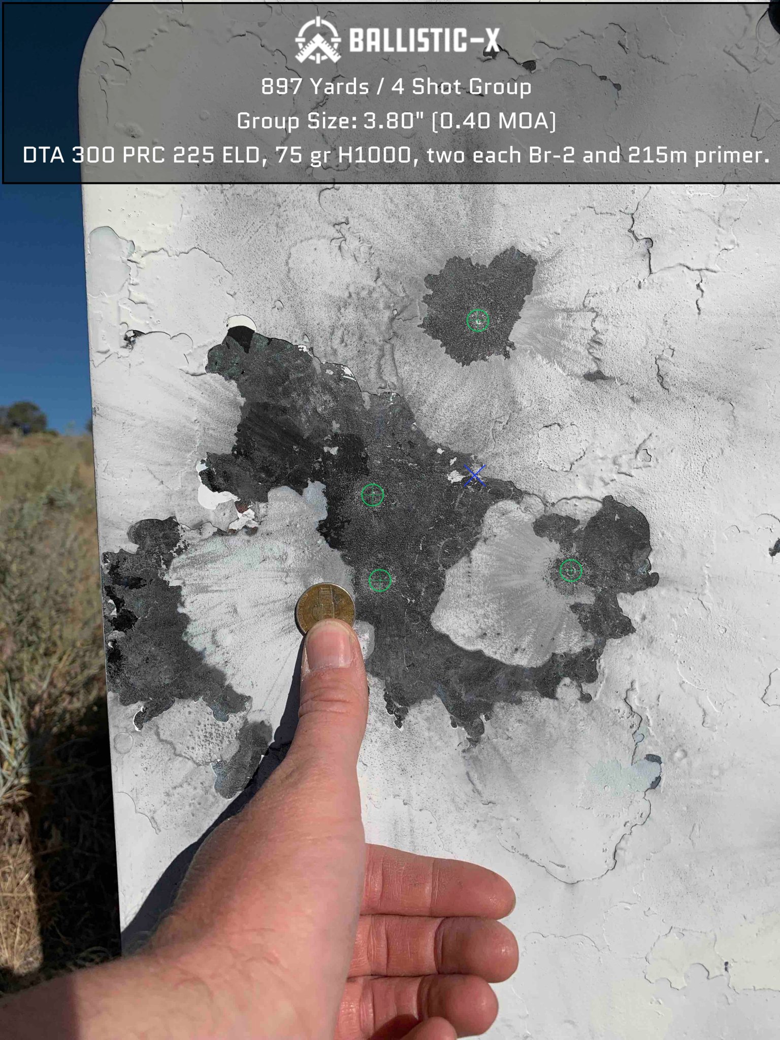

I took the remaining two rounds of each primer and shot them at 897 yards with the same sight setting. One of these rounds didn’t read on the labradar, but the ES of the remaining three was 3 FPS.

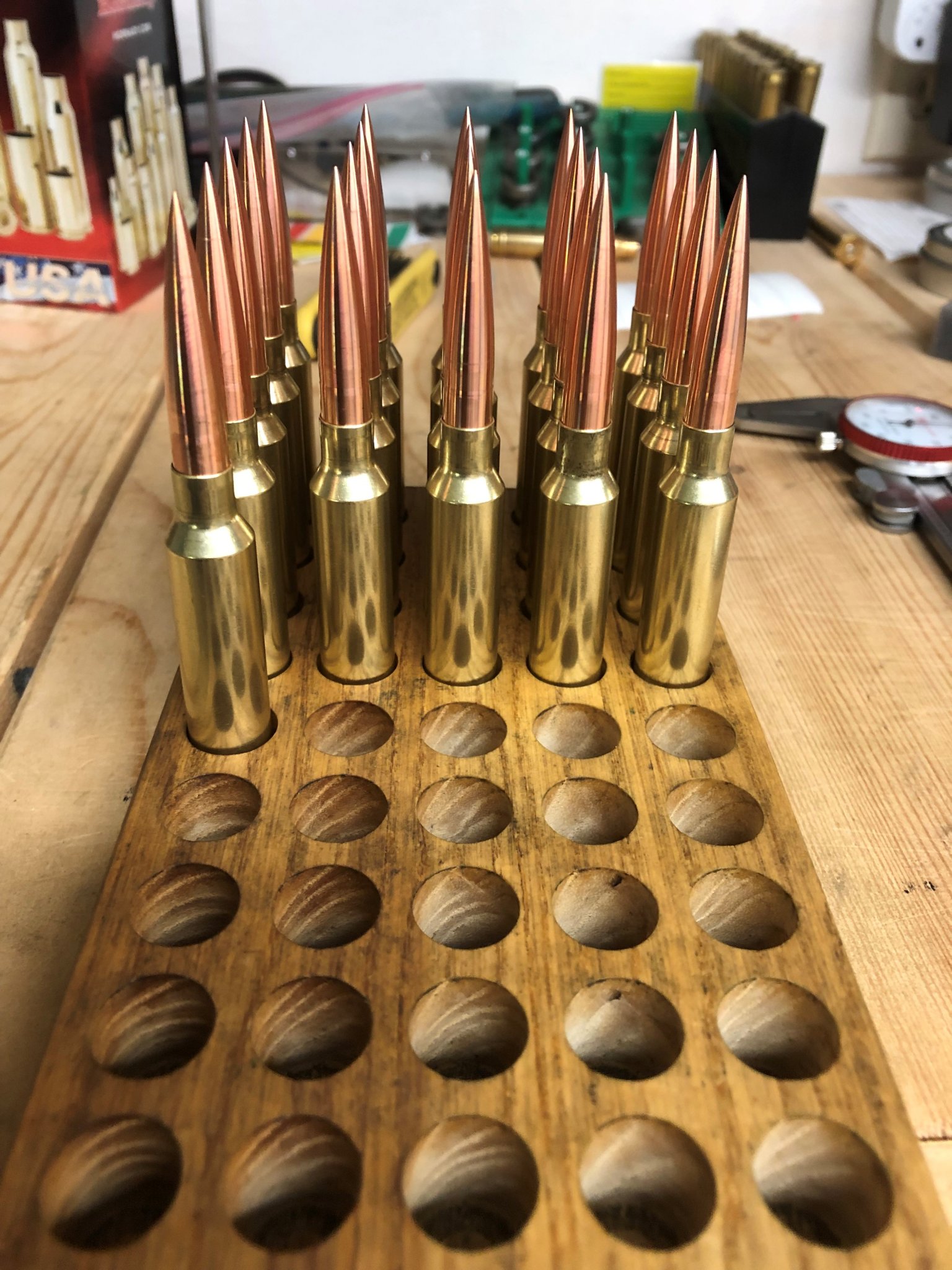

Shot 20 rounds today of Hornady Match with the 225 ELD-M. I'm in awe and in love at the same time. There were 4 of us at the local range today. My first shot after bore sighting was a little high at 50 yards and the next was dead on. However, it was funny because it blew my buddies hat off his head with the lil'B muzzle brake...he was sitting slightly behind and 5 feet to the left. The lil'B was like fire and furry....like a woman scorned. All thump and noise...but they looked at me and wondered why my face was smiling from ear to friggin ear.
Simple, the recoil on this 28" Bartlein heavy varmint, 1-9, spiral fluted, blended lil'B brake....with a Deviant Tact....all nicely tucked into a MDT ACC chassis that I sat on my living room floor and adjusted everything to my liking.....well...it kicked like a 5.56 AR. ALL that noise and it kicked like a little girl. I could sit behind this thing all day. The MDT ACC set to my liking...to my body...had a straight recoil with no muzzle jump....I could see the target from before, trigger pull, recoil, and through the entire bolt cycle.
Yea...I think I can live with that. I was only able to shoot out to 242 yards today. Basically I was breaking in the barrel today. It is going to shoot lights out. I borrowed a chrono for a few shots and it was 2907, 2900, 2984, 2909 and 2984. Tonight, I'm processing my brass, reloading and I'll go tomorrow with some 230gr A-Tips with Retumbo...yea...nobody has RL-26 right now. I will do a little load development and see what the speeds are on the Retumbo.

4. 71.5gr - basically same damn hole. Audible and recoil weren't discernible from #3
5. 73.0gr - basically same dman hole. Audible and recoil weren't discernible from #3 or #4
These three different powder loads shot a 3 shot group under a 1/4MOA...to me..that is a nice node
Reloaded in blocks of 5 for the next groups
6-10. 75.0gr Group - Shift the windage to pull the group left of the other group. Measued .473 with a dial mic. Target is .018 thick cardboard and flaked around the holes...hard to measure. For a gun with less than 30 rounds to this point....this group made me think naughty thoughts.
11-15. 78.0gr group - Again, shifted windage to pull the group away from the previous.
First shot I heard a metal on metal clang...didn't know what it was.
Second shot went way low and then the adjuster ring for the parallax slid down the tube toward the elevation knob.
Third shot I noticed an artifact in the lens.
Fourth Shot I noticed something like extra scope shadow in the bottom left.
Fifth shot didn't seem to get any worse
This group can't be covered by a Quarter...It isn't the loads fault...I'll be able to buy the Razor GenII in a few weeks and revist this load again.
16-20. 78.5gr Group - Same issues with the previous group and about the same results. I shifted everything left again to pull the group out of the path of the other group. I'll revist this load when I get the new scope.
21. 80.0gr - OVER SPECS - Shift windage back to original wind zero and it shot high. Audible and recoil were very noticeable but brass appeared fine. When I de-prime I'll take notice of any primer pocket issues...and when I reprime, I'll see if it is loose or is noticeably easier to insert.
Continuing on from the above post. You'll most likely be asking about speeds.
1. Retail Hornady 225-ELD-M - 2909
Retumbo and 230gr A-Tips
2. 68.5gr - 2701
3. 70.0gr - 2817
4. 71.5gr - 2825
5. 73.0gr - 2849
6. 75.0gr - averaged 2884
7. 78.0gr - averaged 2925
8. 78.5gr - averaged 2947
9. 80.gr - said 3041...but only shot one.
As always....every chrono will measure differently...on different days....in different conditions....so take those speeds with a grain of salt I guess. Next week should be some H1000 load development with hopefully a new scope.
