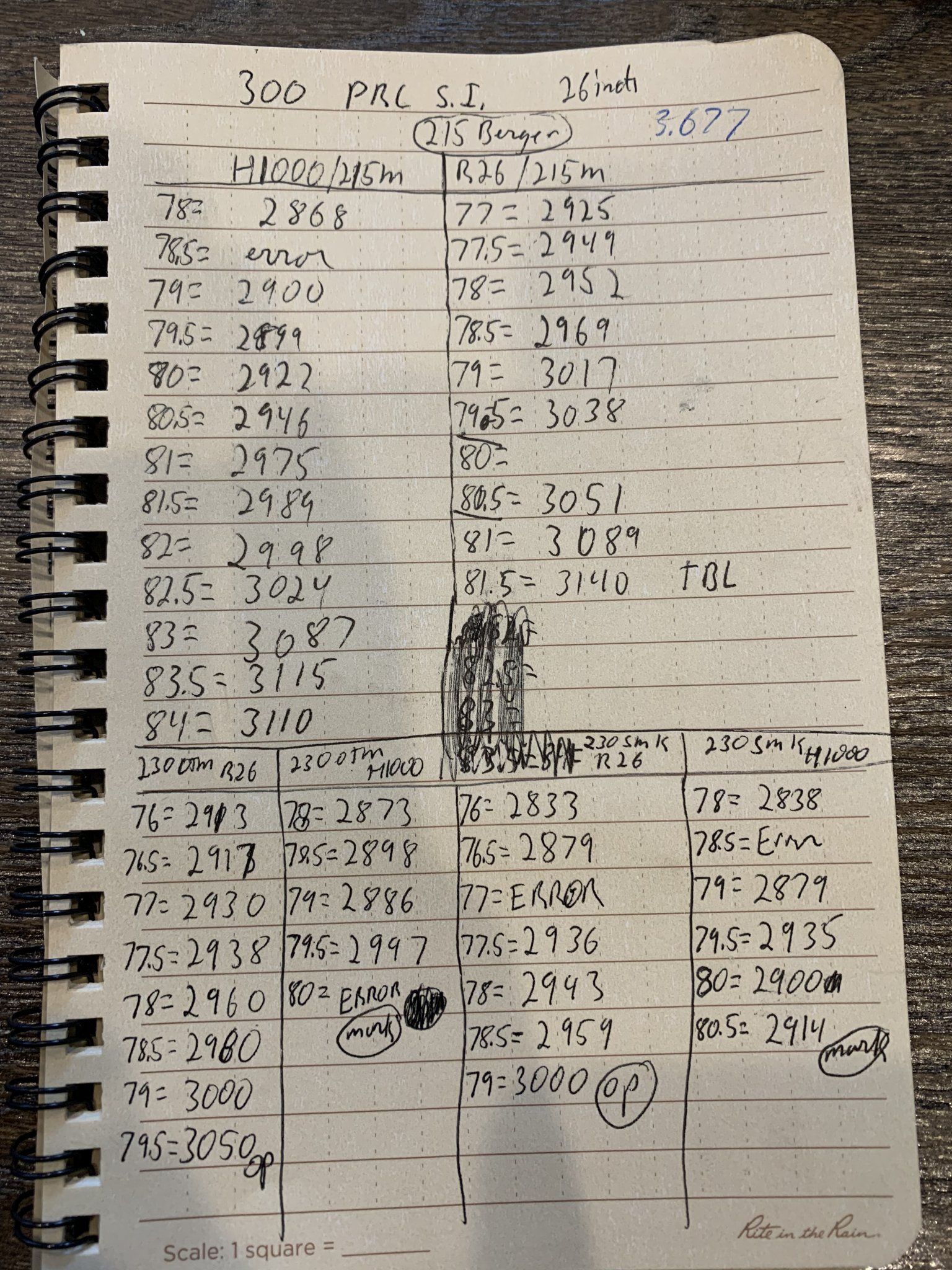

I went the 300 PRC improved by rich Sherman route. It’s been talked about earlier but just got time to do a ladder with the 215 Berger’s. No pressure at 3100fps using H1000

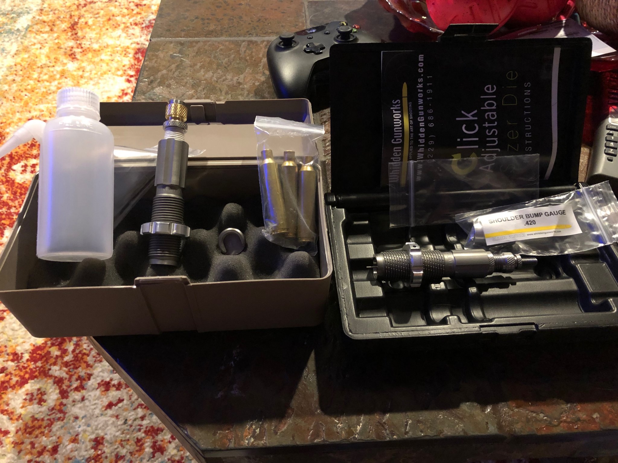

I bought the hydro die to form 8x68S (the die on the left with the water bottle) and the custom die because I'm having consistency issues with the Hornady die I've been using.
For the 8x68S, I use a .341 bushing to do the first sizing, then I ream out the inside of the neck to get rid of the extra brass that got forced in there from the sizing, then I use a .336 to get .002" of neck tension for the final. I've got two videos on YouTube showing how to do all this. Honestly, it's very easy to fire form 8x68S, and the RWS brass I use is much, much more consistent than Hornady and lasts a lot longer.
I actually have a full set of 30 cal bushings going from .329 to .341.

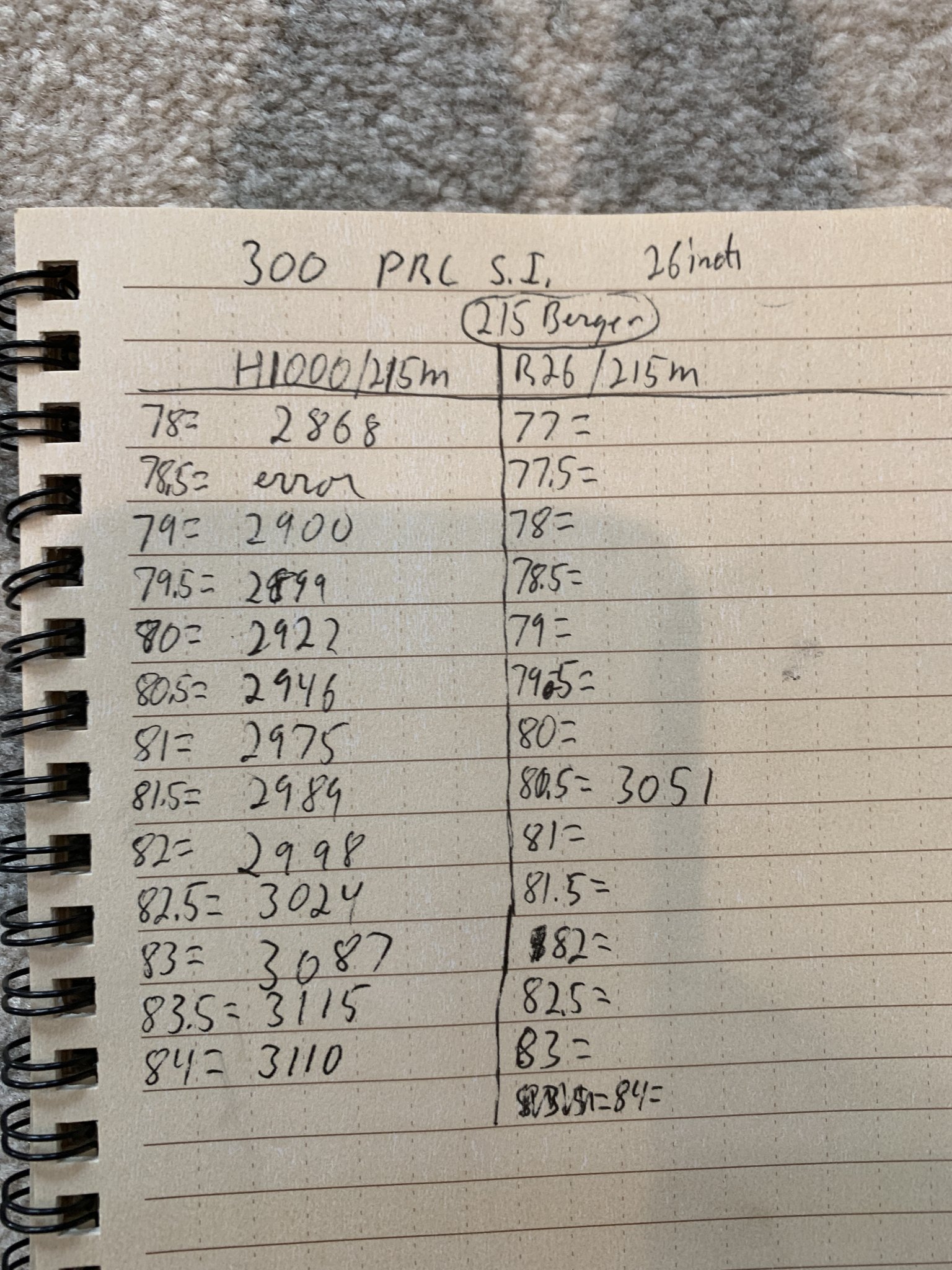

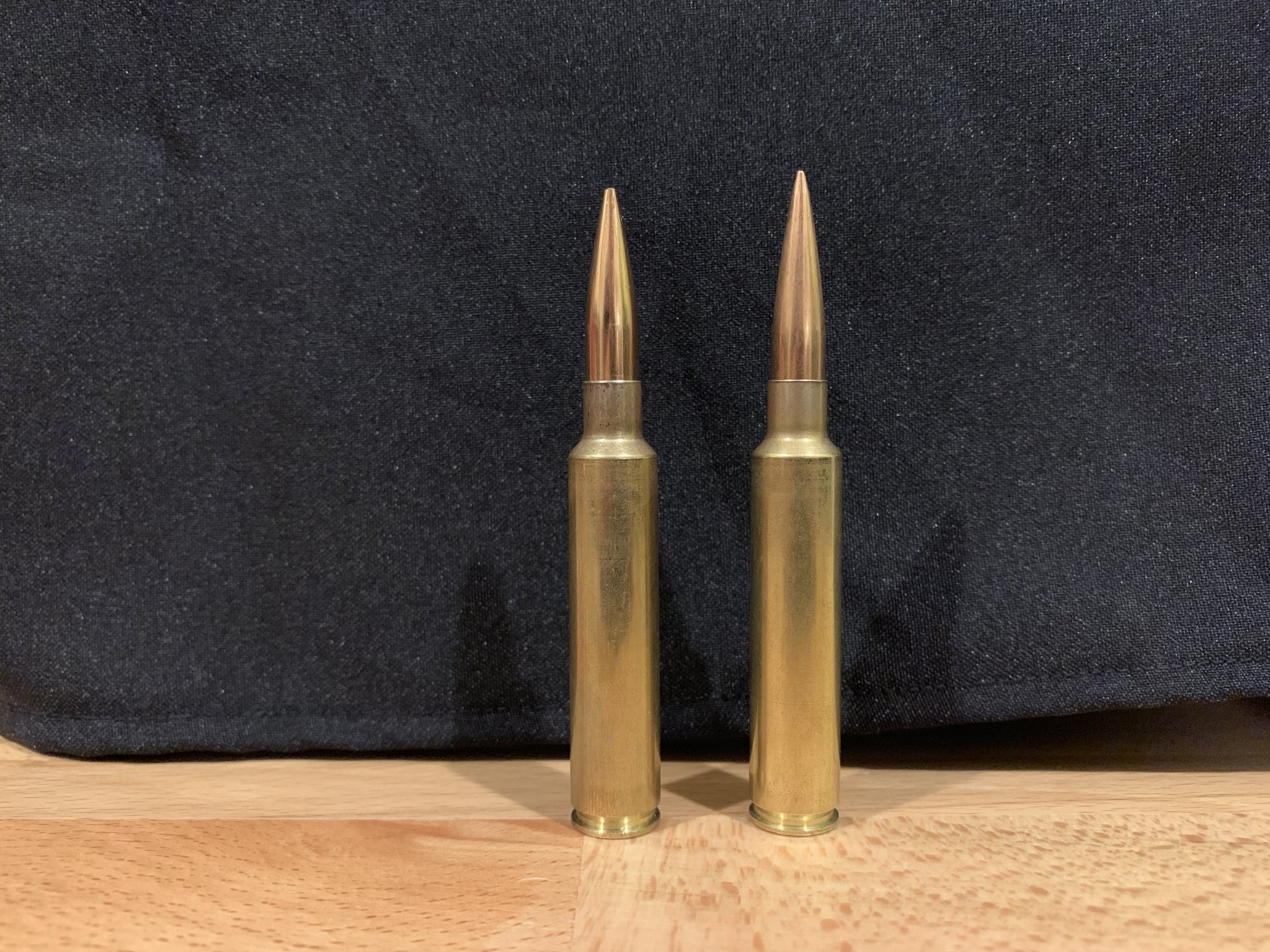

Just loaded up a 230 OTM on the left, coal of 2.630 and a 230 SMK on the right with a coal of 2.750. They look like sewing needles

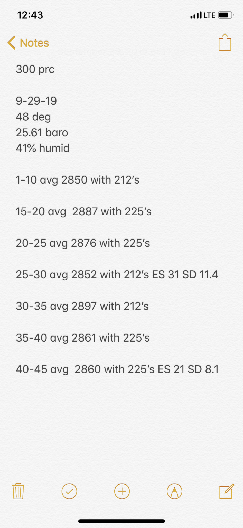

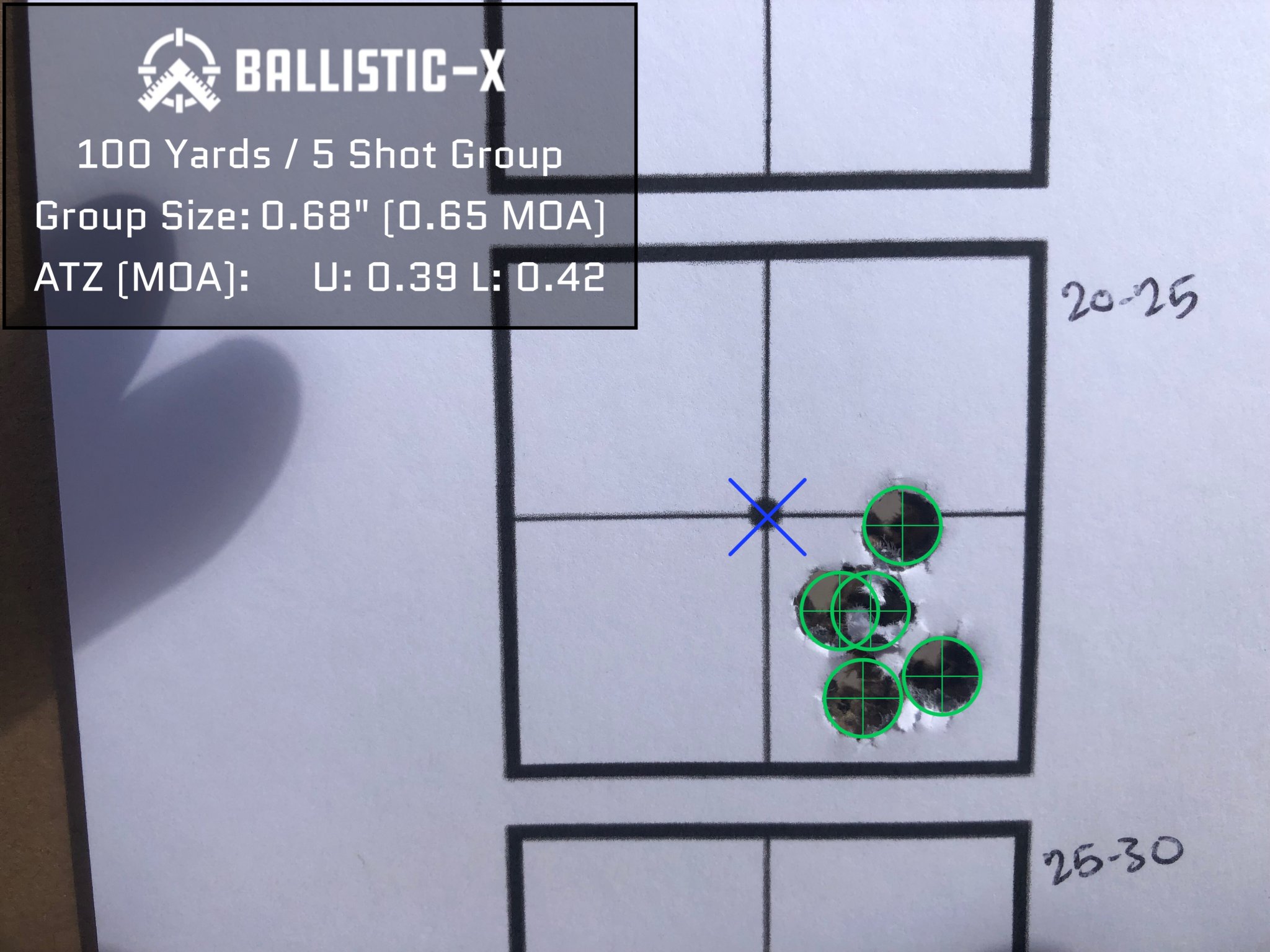

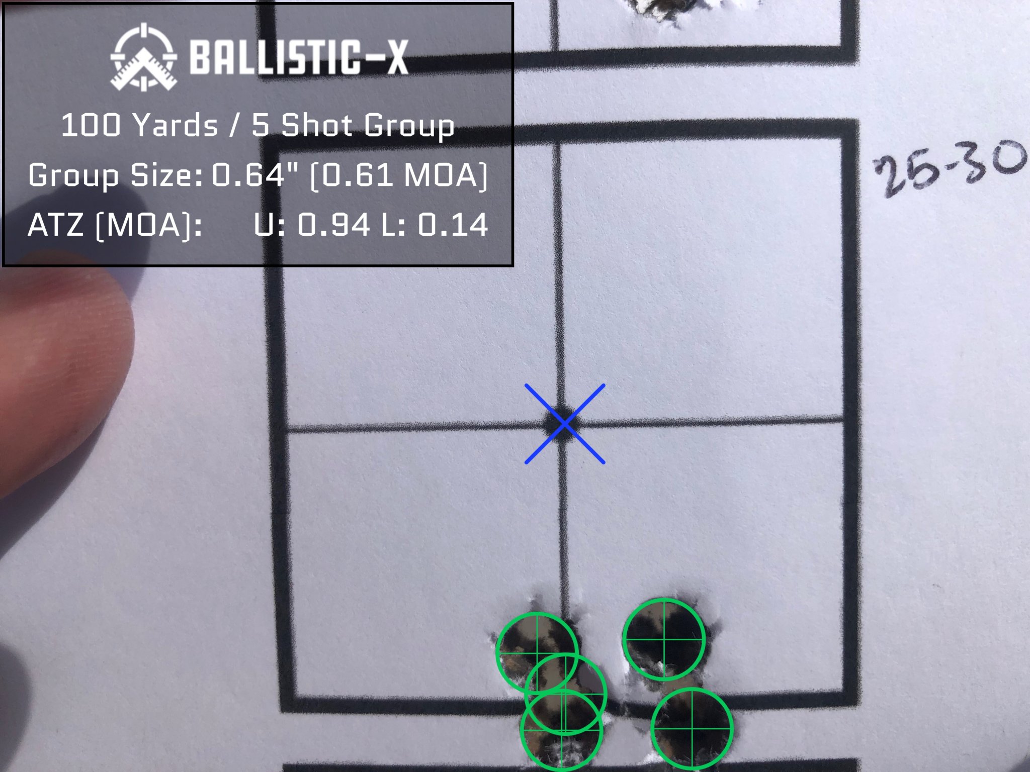

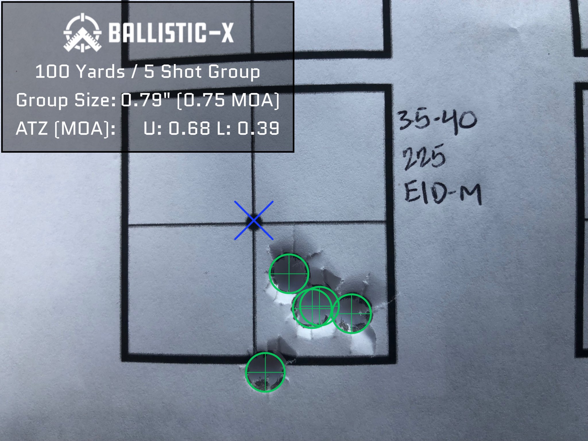

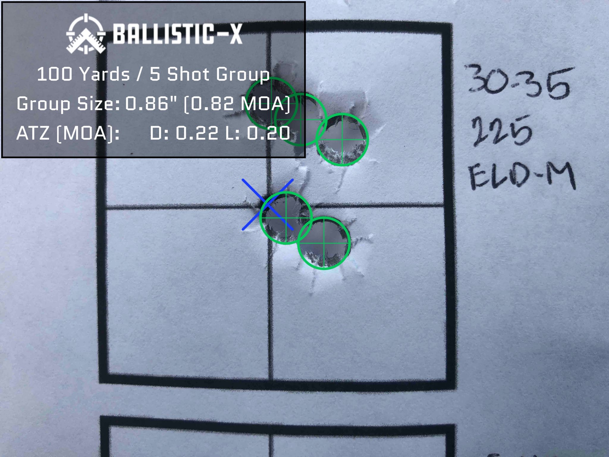

Little range report from a fresh build ! I replaced a 28 Nosler barrel on my SR3 with a proof savage prefit and am pretty impressed so far. Here are shots 20-40 with factory 212’s and 225’s. Can’t wait to see how some 230 A-tips pan out.
Reactions: LakuNoc
Did you get any velocities?
My rifle shoots the 212 factory ammo in the .3’s at 2830 FPS.
I pulled apart 2 each from two different boxes. All four had exactly 78.5 powder with 215 primers.
I thought it was H1000 until I shot it over the magnetospeed and got 2830 FPS average. Maybe it’s retumbo?
26” barrel

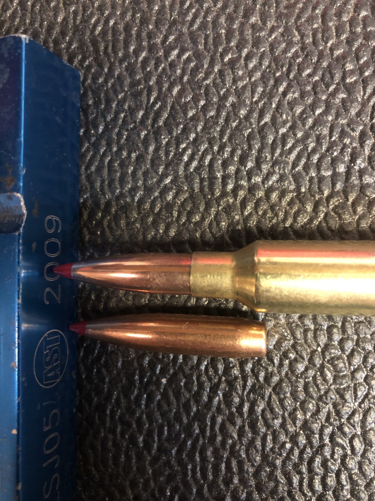

I’ll just post these up as well .... I’m always curious when putting together a new setup.
Sammi proof chamber
230 A-tips touching @ 3.830
212 ELD-X touching @ 3.6–
