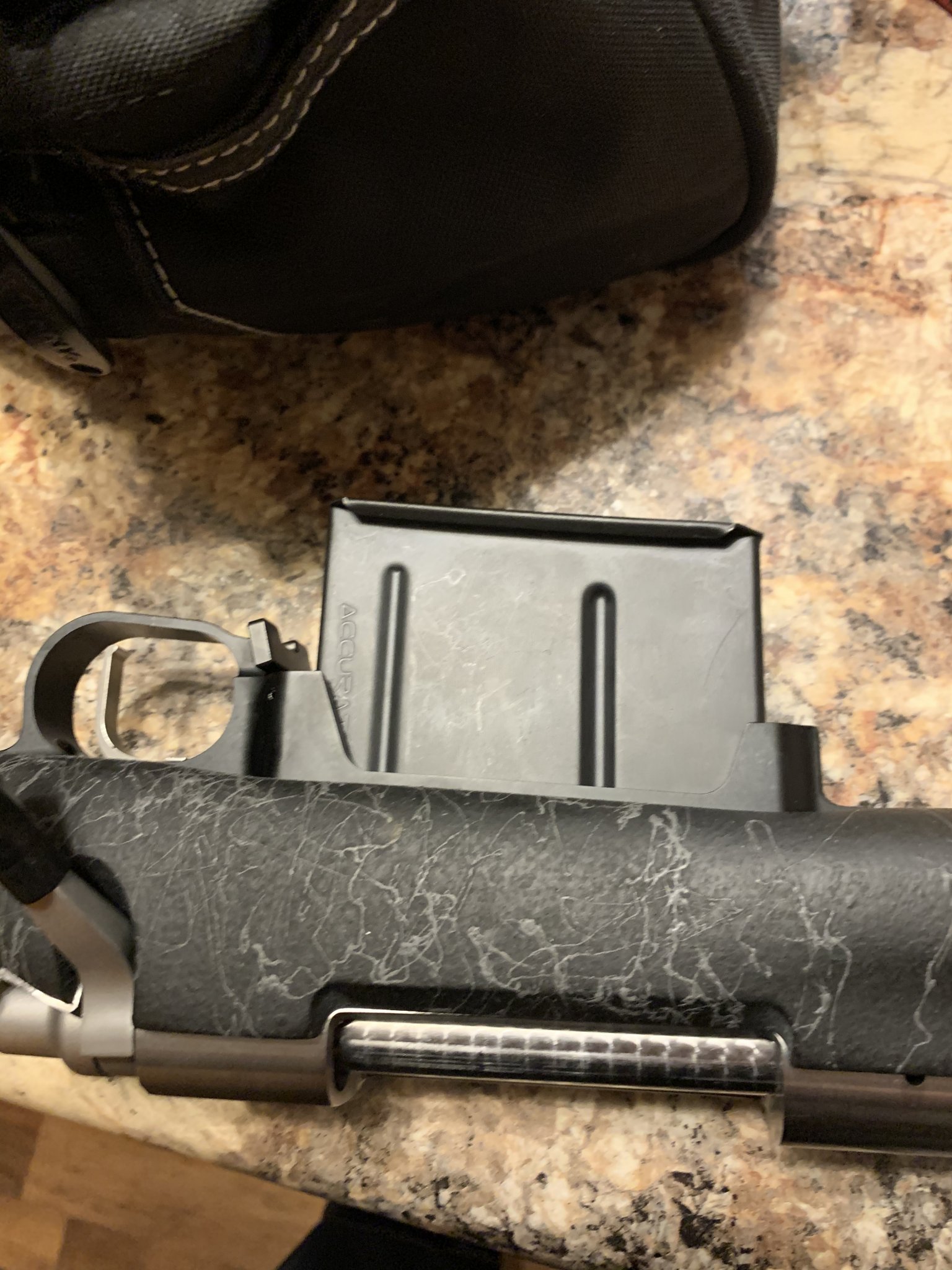

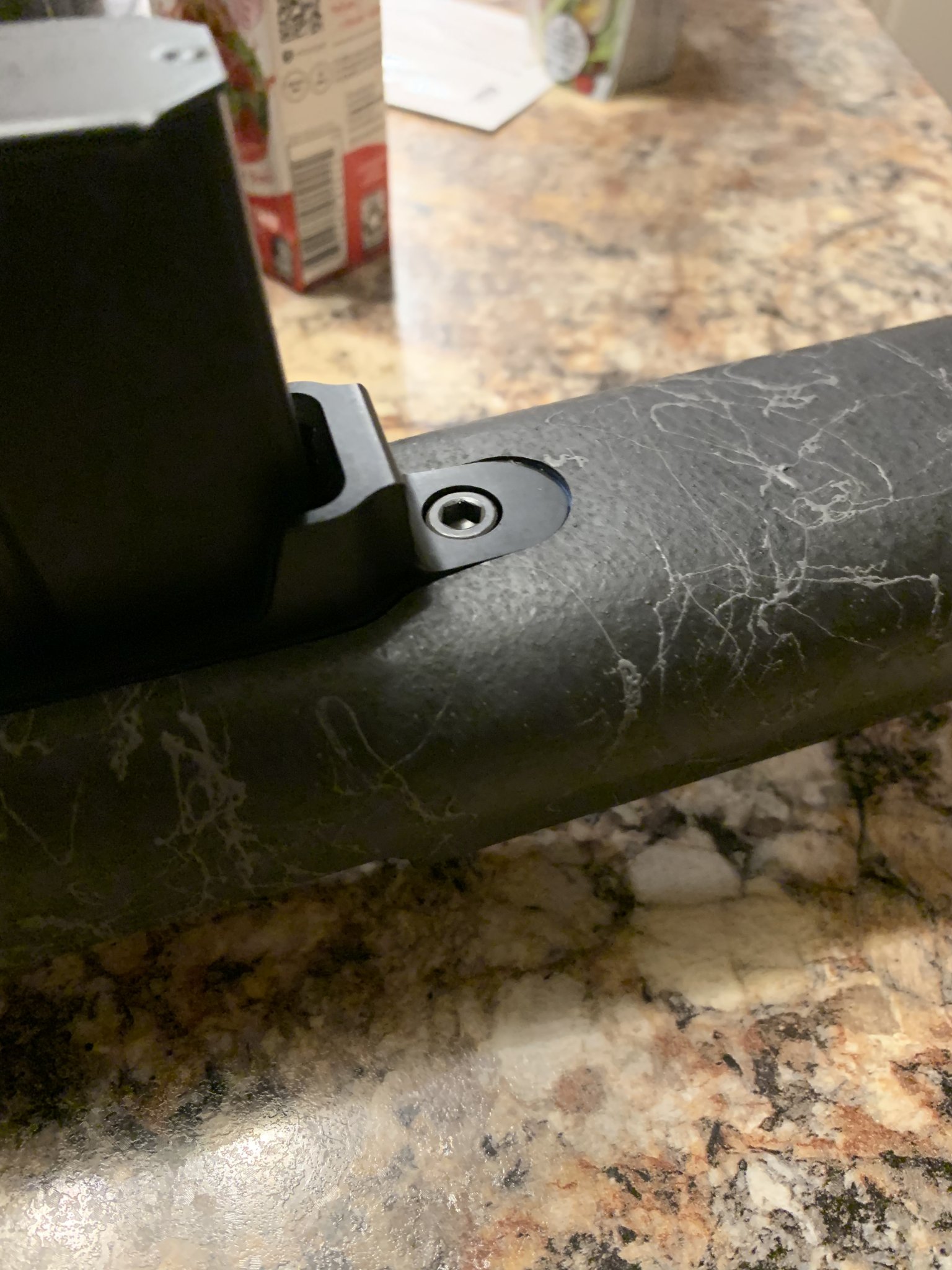

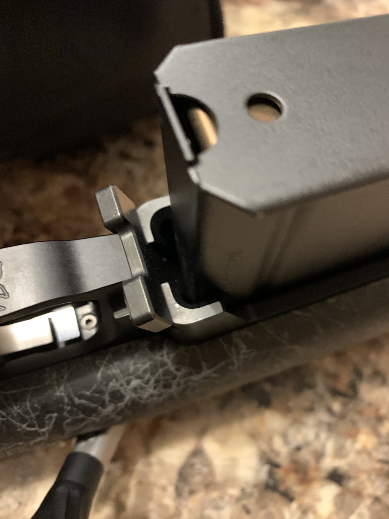

Question all, I ordered the Hawkins CIP bottom metal. Inletted by LRI.
Order the accurate mag 300WM 3.85 (atleast I thought anyways)
I go to seat the magazine and it has a lot of play in the magwell. So much play to the point I can wiggle it and it disengages from mag catch and falls out.
This is on empty magazine.
Is this normal or do I have non CIP length magazine?
It fits tight on regular LA bottom metal for reference.
I uploaded some photos of gaps to show the best I could.
Can you measure the inside dimension of the magazine?
What should the inside dimension be?
I don’t have in front of me right now but roughly measured internal length and was like 3.6. Overall length didn’t appear to be 3.85.
I ordered from Altus Shooting. I guess I didn’t look at packaging or anything and assumed it was the right one. I may have been sent the wrong mag.
