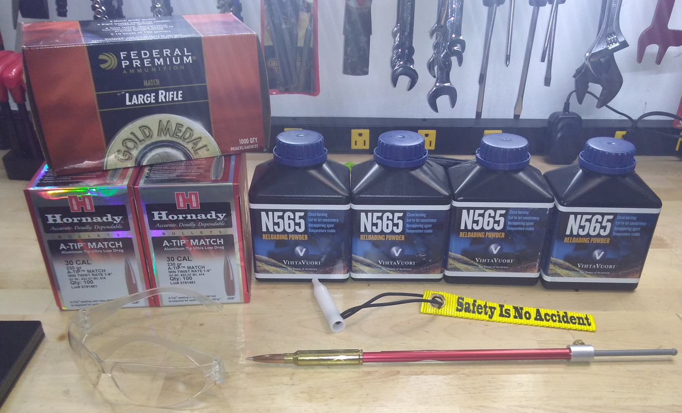

Also, just ordered 8lbs of N565 to try out. I'll be making an RCC purchase soon as well...hell...why wait?...I'll do that now...

230gr A-tip....I'm running them exclusively now. I will probably sell a few boxes of the 225ELD-M's because I don't intend to use them.
I'm currently running them with 80gr of Retumbo and getting great speeds and accuracy. HOWEVER...I'm loading them to magazine length...and not to what many of you would call a good jump to the lands length. Due to geometry difference between the 225 ELD-M and the 230gr A-Tip...there is a different jump to lands distance you can achieve....when loading to somewhere less than 3.75 COAL.
I won't argue with the accuracy though. I've read many times of some Bergers and others VLDs liking a 150 thou jump...that to me sounds wrong...real wrong...but you can't argue with what the bullet/chamber/barrel combo likes.
With the tight tight specs on the 300PRC at .3088"...I don't know if you will find much difference on most rifles with different seating depths.

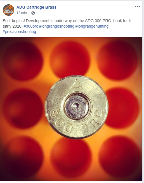

Good News...ADG 300 PRC possibly 2020

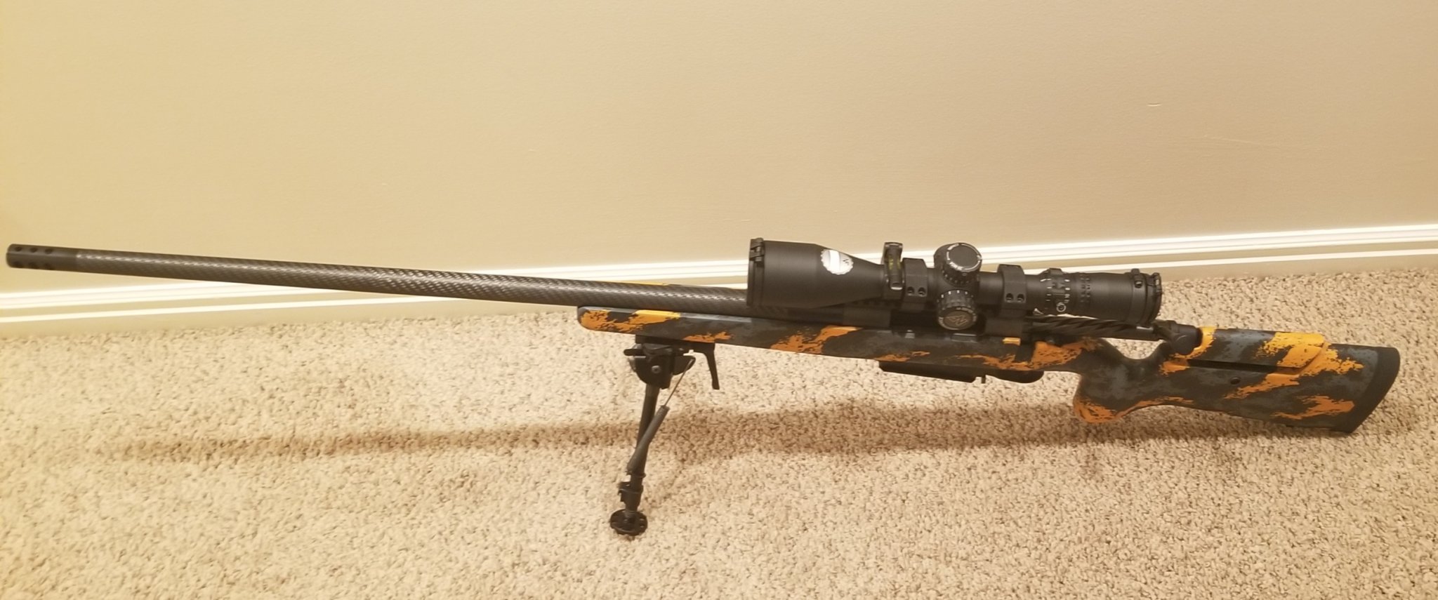

Starting a 300 PRC build on a ARC archamedies. Looks like a bartline barrel is in my future .
I figure I'll be shooting the A-tips and other 230gn
What length should I be looking at knowing I'm going to hang a Ultra 9 off the end?

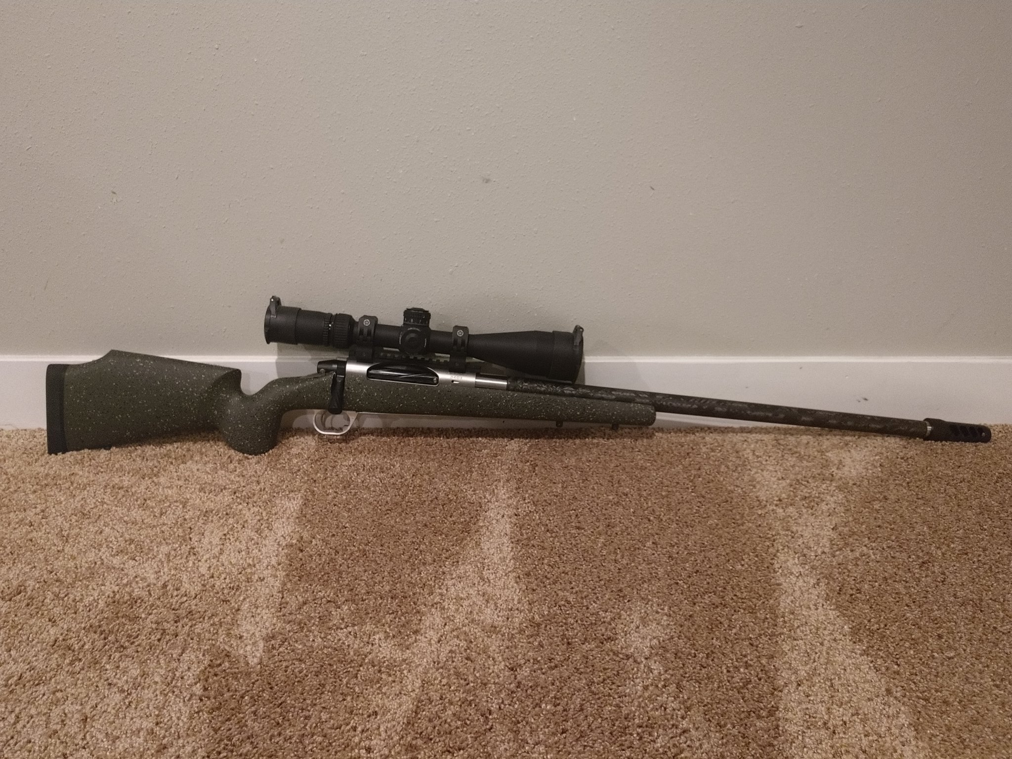

I received my 300PRC from the smith today! She came out perfect.
Hells Canyon carbon fiber barrel
AG Composites adjustable stock
Lone Peak Razor-Ti action
Chambered and assembled by Horizon Firearms in Tx
Can't wait to hit the range Sunday. Already have 225gr ELD-Ms loaded up to perform a ladder after breaking it in.

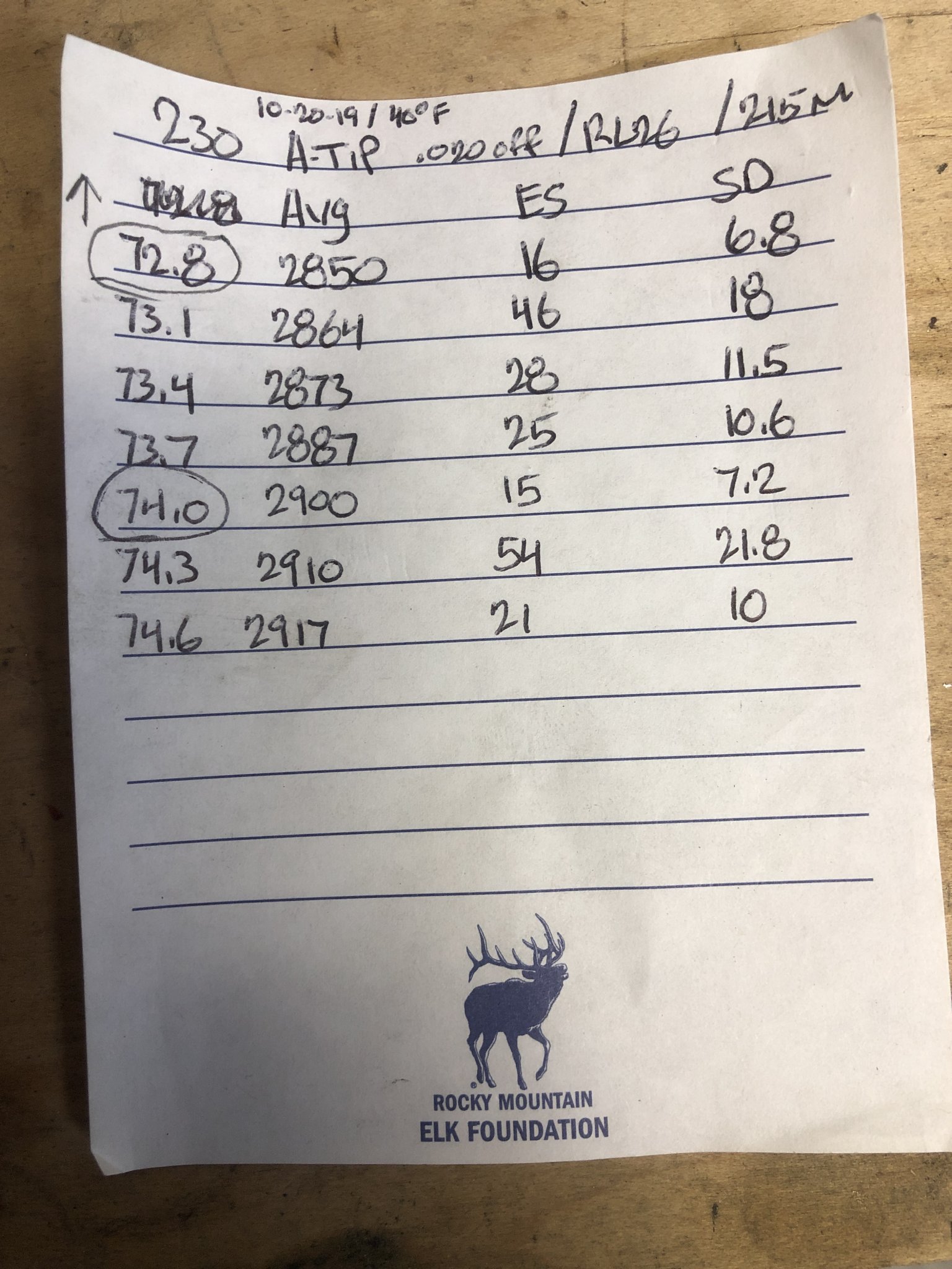

I like your style! Mine arrived today also. Greg Young at Southern Precision Rifles worked his magic connecting a Proof CF Sendero to a Bighorn SR3. Placed neatly in a McMillan Carbon Game Hunter. Not taking time to throw a rail on for a bipod, or even level the AMG. Soybeans to combine tomorrow before it gets wet again.
I'd take any data guys have on the 230 A-Tips with RL26 also... Even though my Bugholes rifle was shooting the factory Hornady Match 225 into one ragged hole. But why not waste time that I am already short on!
Lot of powder seems fast .... 75 gr is where I pressured out @ 2940 in a 26” proof barrel
