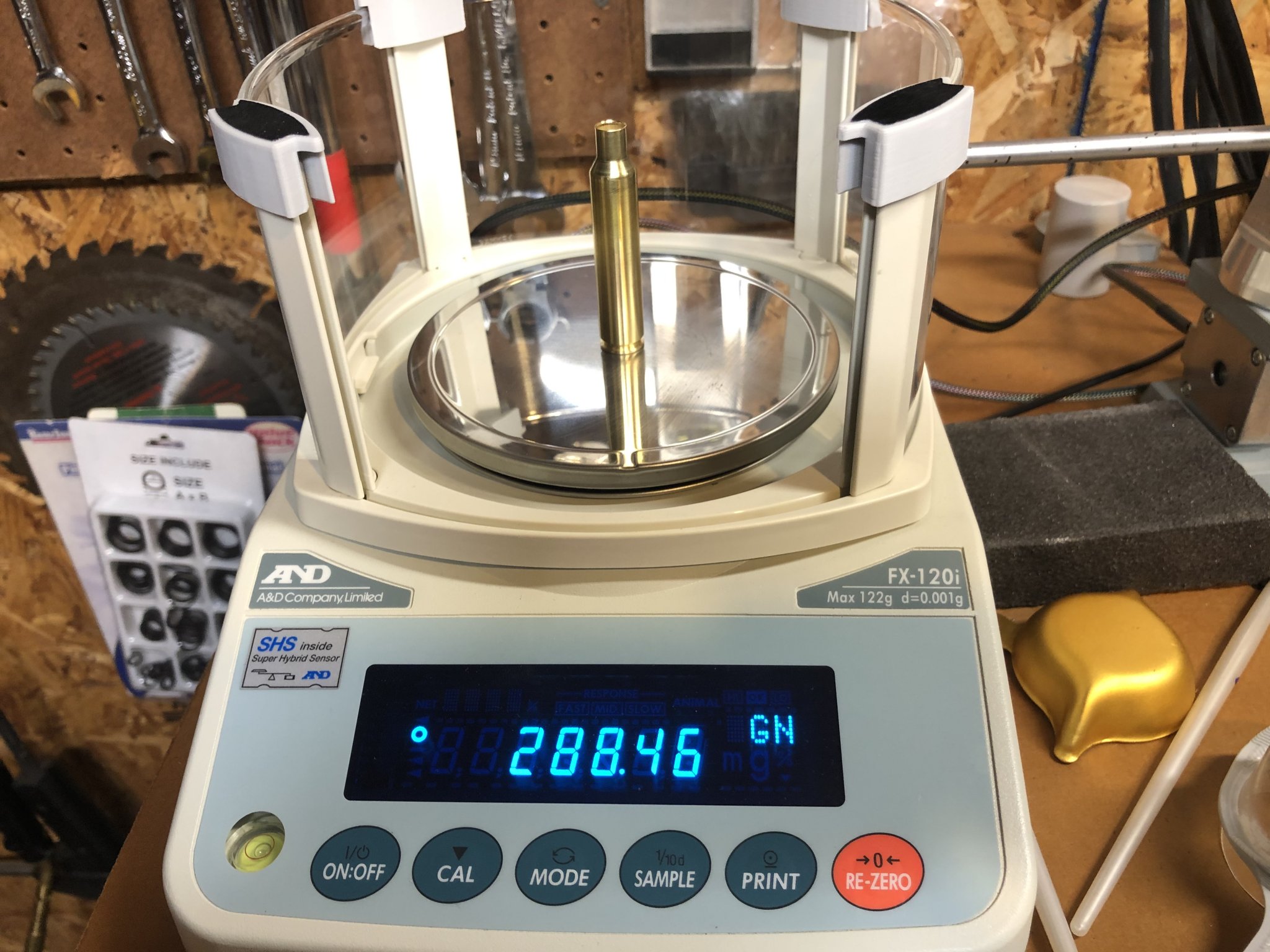

I finally got my RCC brass chambers in 300 PRC. Just to be clear i payed for my brass around $600 for 100 pieces. I took random 10 pieces of brass and did measurements.
As i stated before i will perform full review of RCC brass this is part 1 and part 2 will be coming after i do all testing on range.

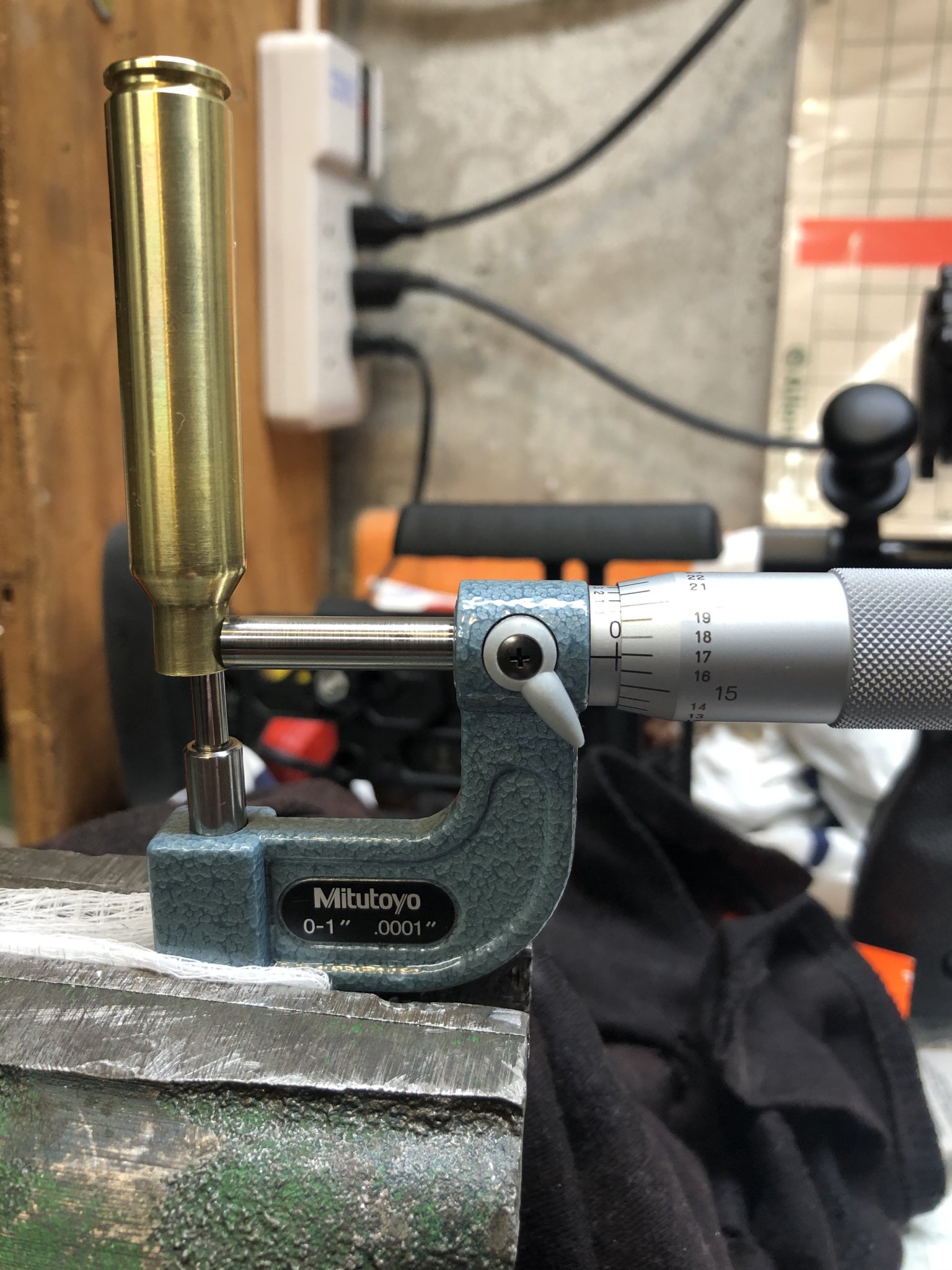

I used Mitutoyo ball style Micrometer, and results were amazing.
Neck thickness of brass was within in 0.0005, 0.0005, 0.001, 0.0005, 0.001, 0.001, 0.0005, 0.001. 0.0005, 0.001. Better than Lapua brass that i use in my 6.5CM.

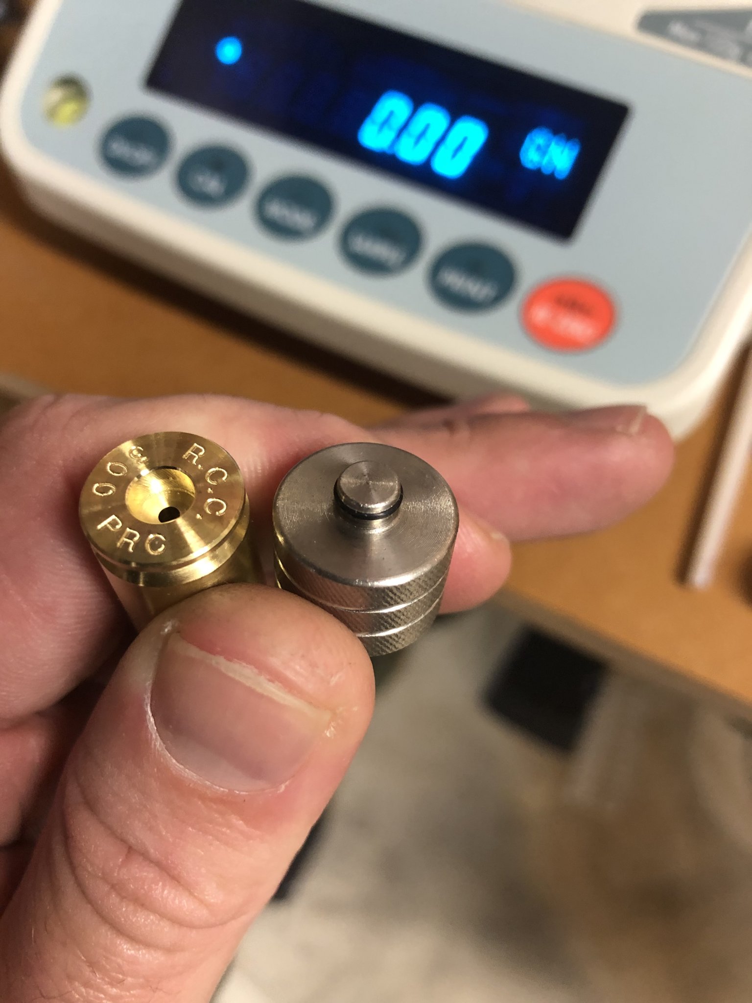

After neck thickness i weighted 10 pieces of brass. Using Lab scale FX-120i.
Brass was very close in weight 288.46gr 288.44 288.35 287.43 288,41 288.33 287,89 288.46 287.95 288.40.

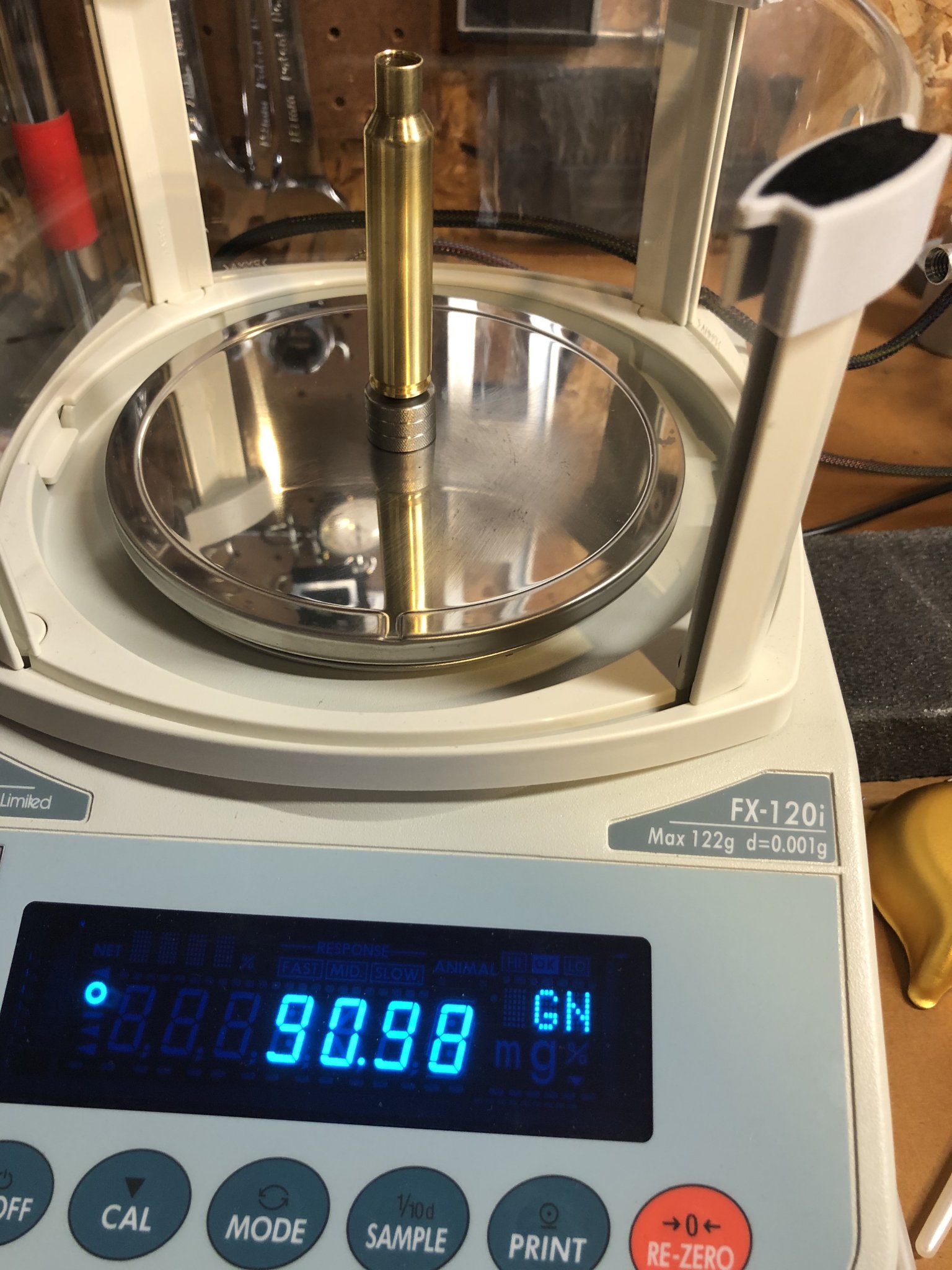

Then i filled brass with H2O to measure internal case capacity and to see how consistent it was be using same scale. I think this is very important at least to me because i shoot long distance. This has big impact on Extreme Spread internal volume of brass is something that can be more than 10-20 GN that i witness in my 338Lapua brass which is consider one of best out there in my opinion.
Results came out again very consistent and close to each other.
Internal case H2O capacity: 90.98 90.91 90.81 89.90 90.80 90.91 90,82 90.99 90.98 90.95
So far I'm liking the results its very good.

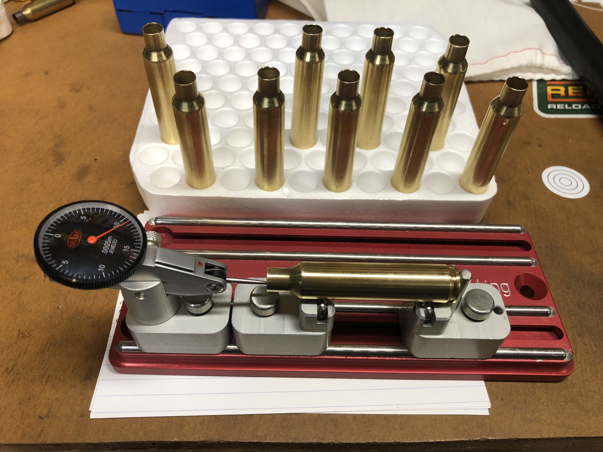

Last in this part1 but not least i did perform Concentricity of brass i don't like to do this until i load ammo and do Concentricity of loaded ammo. Results were okay i can't say they were perfect because i like all my rounds to be within one thousands of and inch. I can't judge this part yet i want to fire brass at least once and load full ammo than do Concentricity on loaded ammo.
But results were okay no to write out all Measurements . Concentricity was 6 cases within in one thousands of and inch and 4 causes were 2 to 2.5 thousands of an Inch runout.

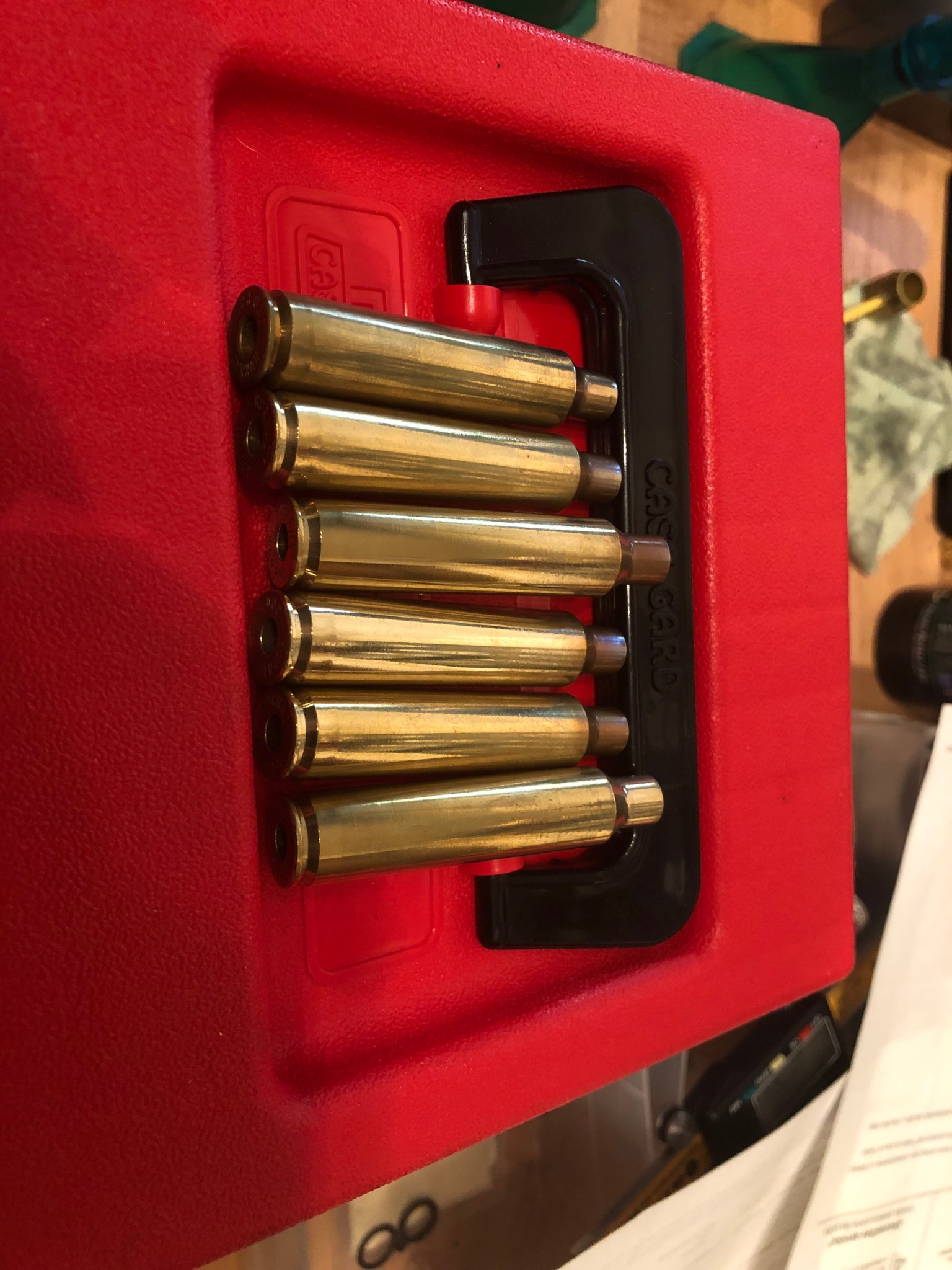

Anybody had a case separation yet? (See my previous post questioning pressure signs) Hit 4X on some Hornady last weekend, didn't notice till last night that I had 7 definitely ringed/toast, and about 15 others that are now very suspect which is close to a 30% failure rate on that lot and I'm not pushing them near what some of you guys are. Dropped the gun off this morning to have the chamber, bolt, chassis, looked over in detail. I/We would really would like to see pics from anyone of 2x, 3x fired Hndy brass bases if anyone has time. Thx.
I can get you pics on Monday. I have about 20 pieces that the primer pockets are already toast from a hot load early on in the barrel. I've backed down since and have 7x on about 80 pieces of Hornady with still a decently stout load.
I've got a bunch of ~5x fired brass. No signs of case separation. My issue was always primer pockets giving out. This is why I moved to fire-formed 8x68S

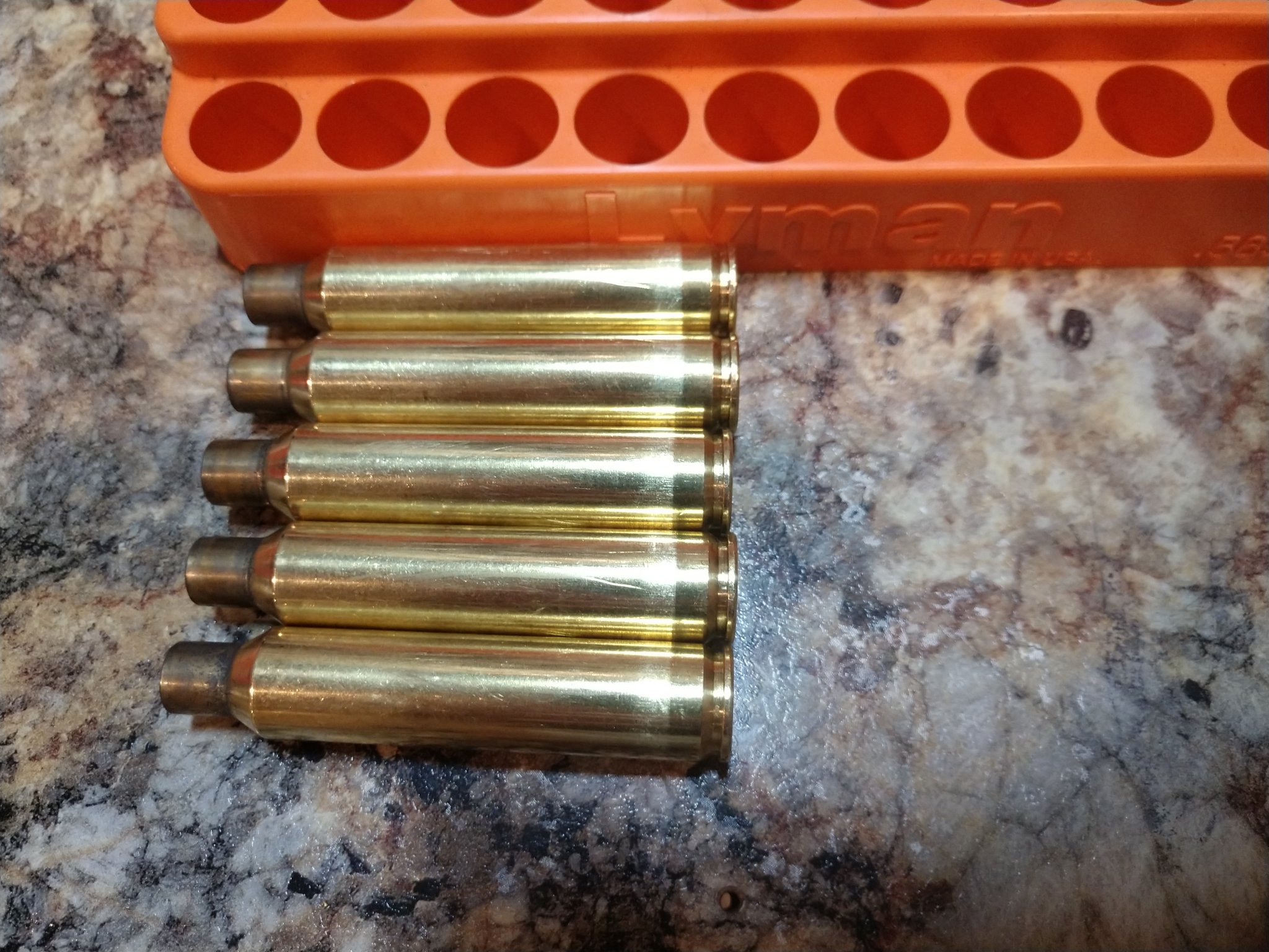

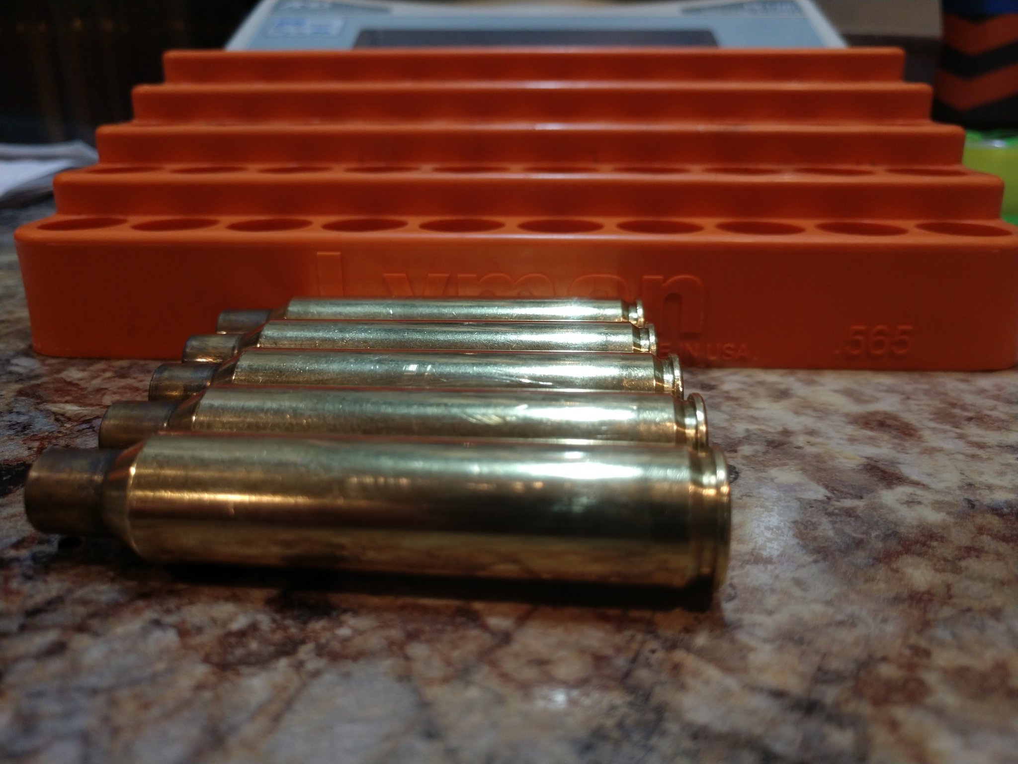

I'm interested in what you guys are trimming at. I trim at 2.565" and I got zero growth on the last few reloadings. I know that is the Hornady spec but I've seen Hodgdon and others list 2.850" as trim length on their webapp and that is the Max case length.
I'll try and get out to the range and make some more empty brass...but dang do I hate the cold. I'll take pics of my brass for a 6x reload when I can.
Thx guys for any pics. Much appreciated.
I just measured new Hornady brass at 2.577 and my once fired at 2.5785 with twice fired at 2.580
For obvious reasons I may not be the best reference on this but mine were 2.577 out of the box, first round growth was .010-.013. Trimmed to 2.575 and bumped the shoulder .002 on 2x growth was .007-.009. Trimmed them back to 2.575 again for consistency and reduced bump to .001. Growth stabilized and after 4X all are 2.577 to 2.579. 2.580 is long for a 2.5874 chamber, you'd be trimming every time or risk crimping on the shoulder.

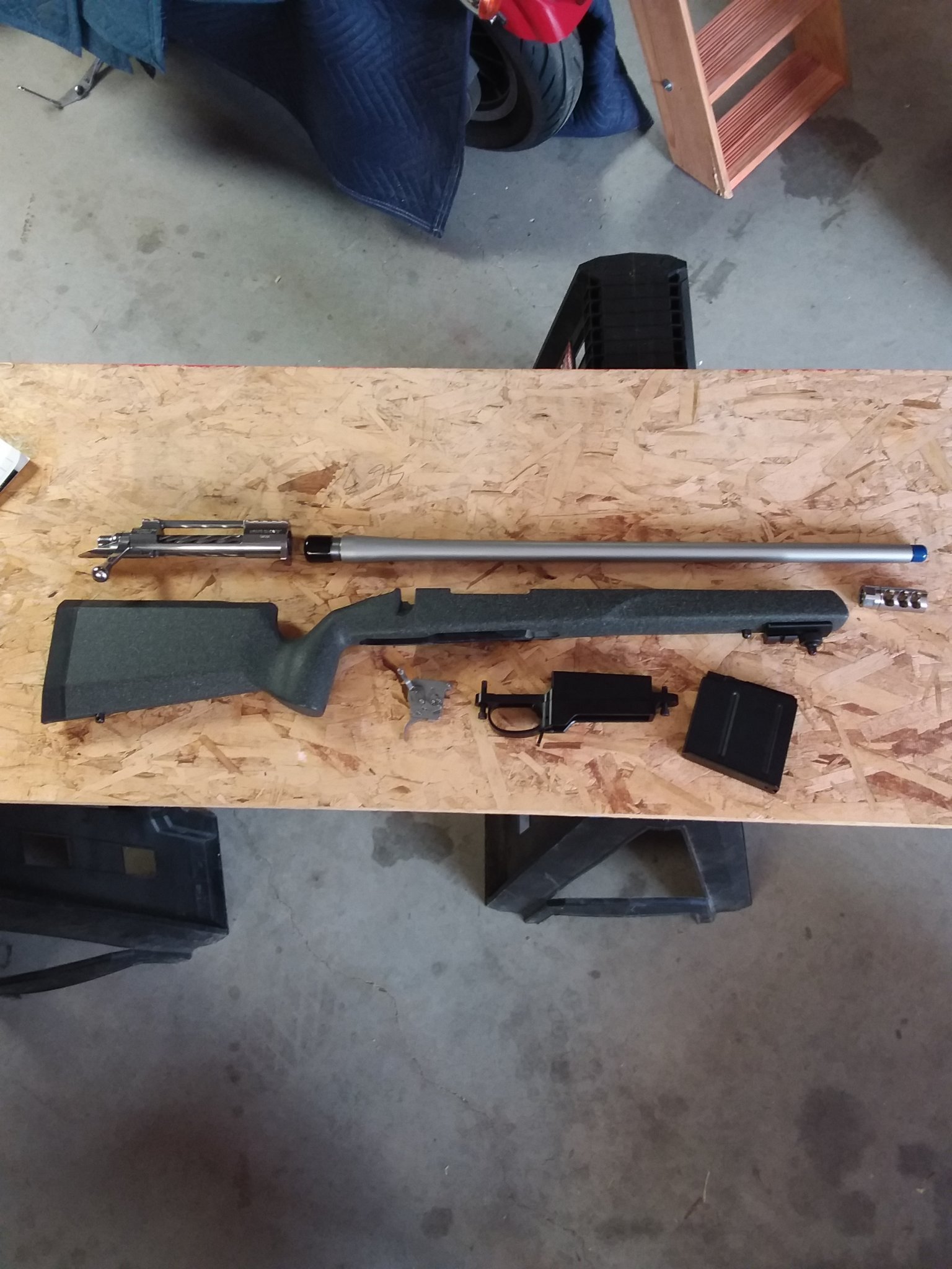

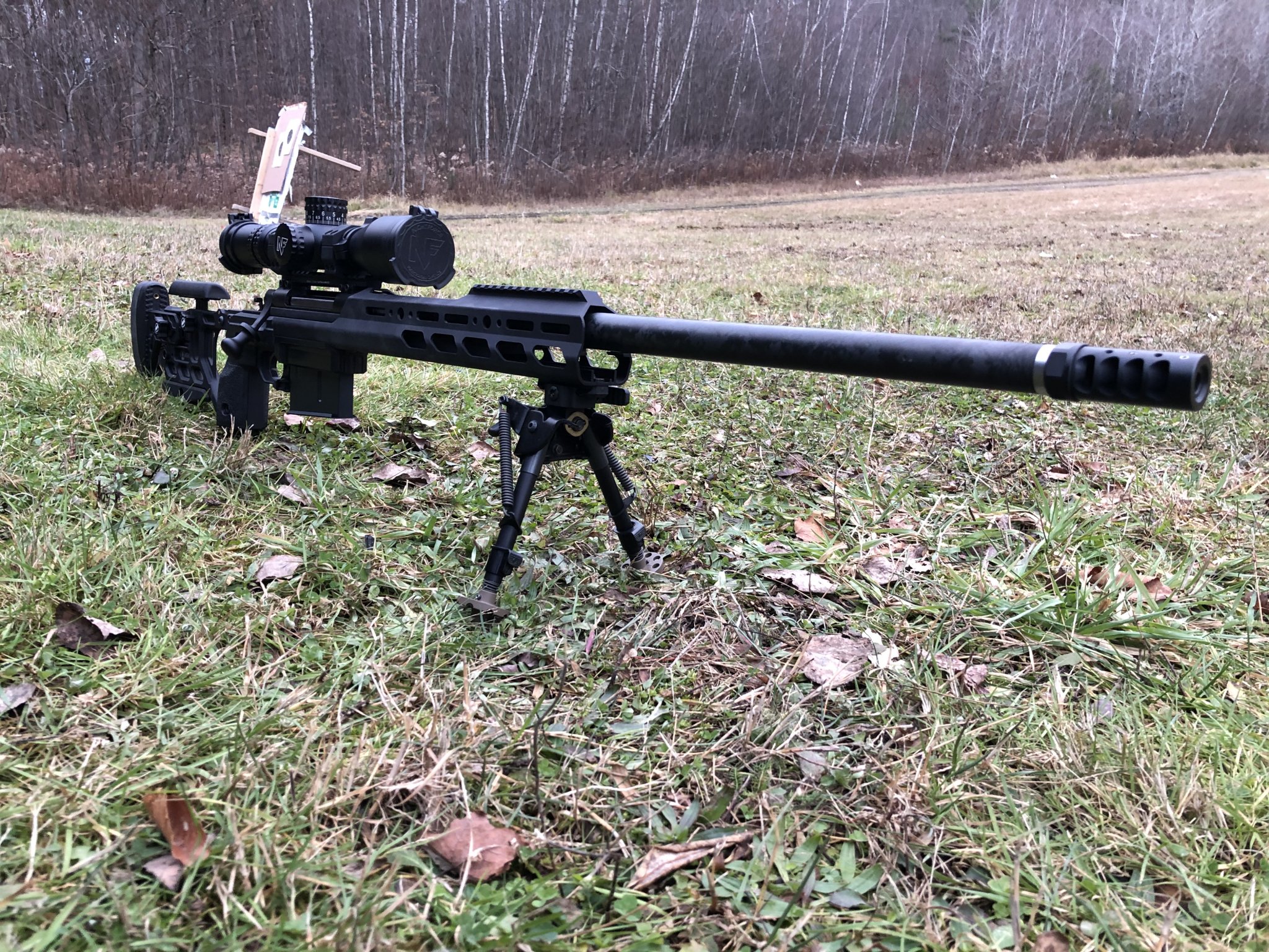

I wrote a few weeks back that I'm doing a new 300 PRC build to go up a notch in rifle quality over my current 300 PRC.
This weekend I ordered a custom stock from Manners - I know this will take a while, but long actions are non-existent and I think finding one that meets my needs will take just as long as ordering one.
I also ordered M5 bottom metal and the same barrel I have on my current (M24, 1-9).

I went to range today with RCC brass and 230gr A-Tip to see how will brass hold pressure.
This is my load and in my rifle, please be careful because it might be different in your rifle.
RCC Brass loaded with H1000, CCI BR-2 primers and 230gr A-TiP.
Like i said in part one i will do concentricity of rounds loaded and i did, not to write out all numbers but out of 10 rounds 8 rounds where with 1 thousands of an inch and 2 rounds were runout of 1.5 thousands of and inch. In my books that's very good.
My Weather 40 F, 28.6inHg, 64% Humidity My Altitude 1030ft
76.4 GN = 2869 FPS no pressure
76.7 GN = 2876 FPS no pressure
77.0 GN = 2896 FPS no pressure
77.3 GN = 2899 FPS no pressure
77.6 GN = 2890 FPS no pressure
77.9 GN = 2913 FPS no pressure
78.2 GN = 2940 FPS no pressure NODE
78.5 GN = 2938 FPS no pressure NODE
78.8 GN = 2945 FPS no pressure NODE
80.1 GN = 2966 FPS no pressure
