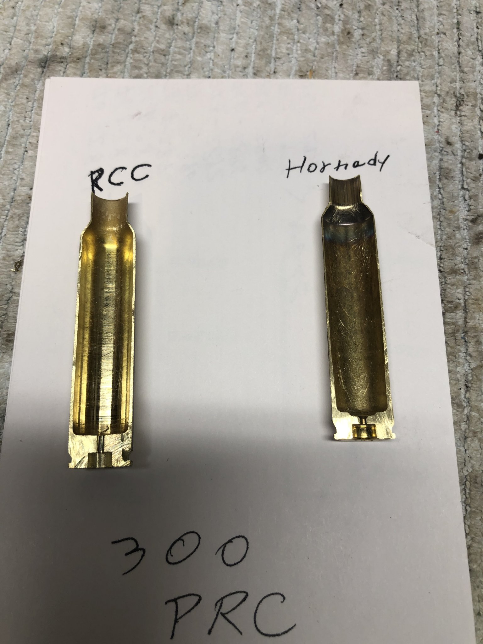

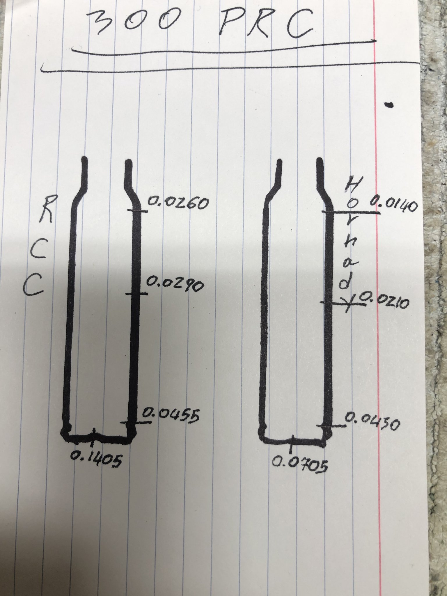

Today i had some time so i cut open Hornady and RCC brass. RCC brass as i stated in previous post holds pressure much better. I did some measurements and it was impressive. At 80.01 no pressure with RCC brass. I also called Jeff at RCC to gather more info on this brass and everything made more sense. After i cut them open, here on picture you can see side by side RCC constructed like a Tank. Especially around primer pocket its very visible, difference is huge and here are pictures.
As you can see RCC constructed much much stronger and better. But not only that RCC brass is made out of stronger material. Primer pockets hold much better because around primer pocket its much more thicker material than Hornady Brass.

That is excellent information conveyed by the cut away brass. That case head is huge. The only questions I have for you is: 1. Do you plan on counter sinking the inside flash hole? 2. Normally I use Federal #210 match primers...but the length of that flash hole...man...can you see if there is much difference between a regular and a magnum primer?
Thanks for the post. I don't think a lot of people truly understand...or maybe appreciate the difference in retail brass and the huge difference in both the materials used and the process that RCC uses to produce this brass.

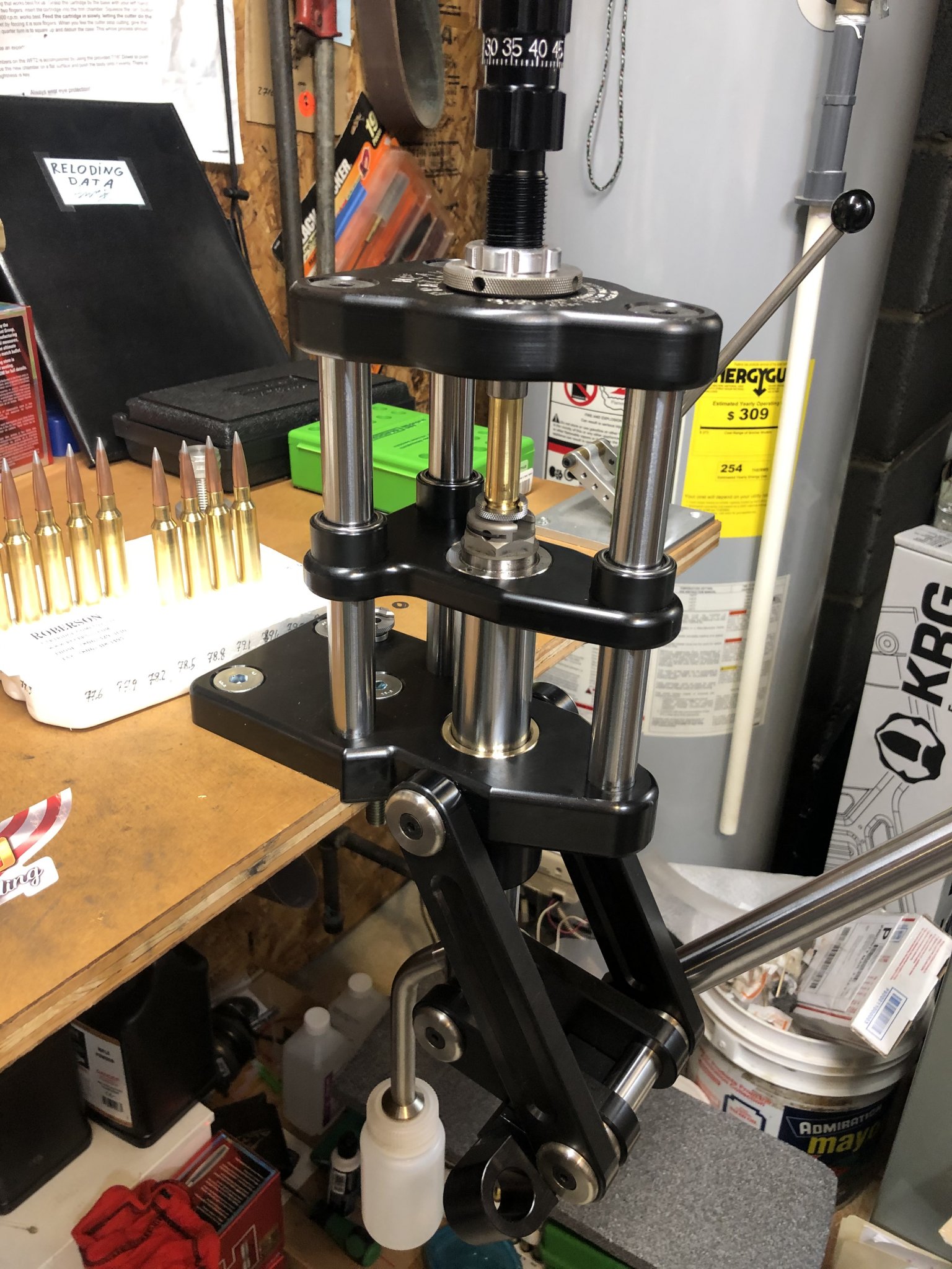

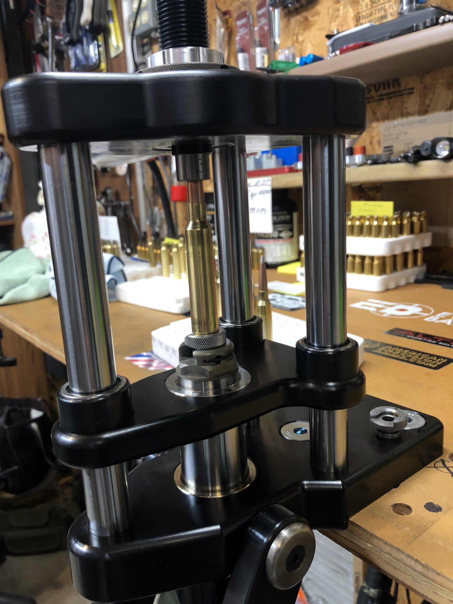

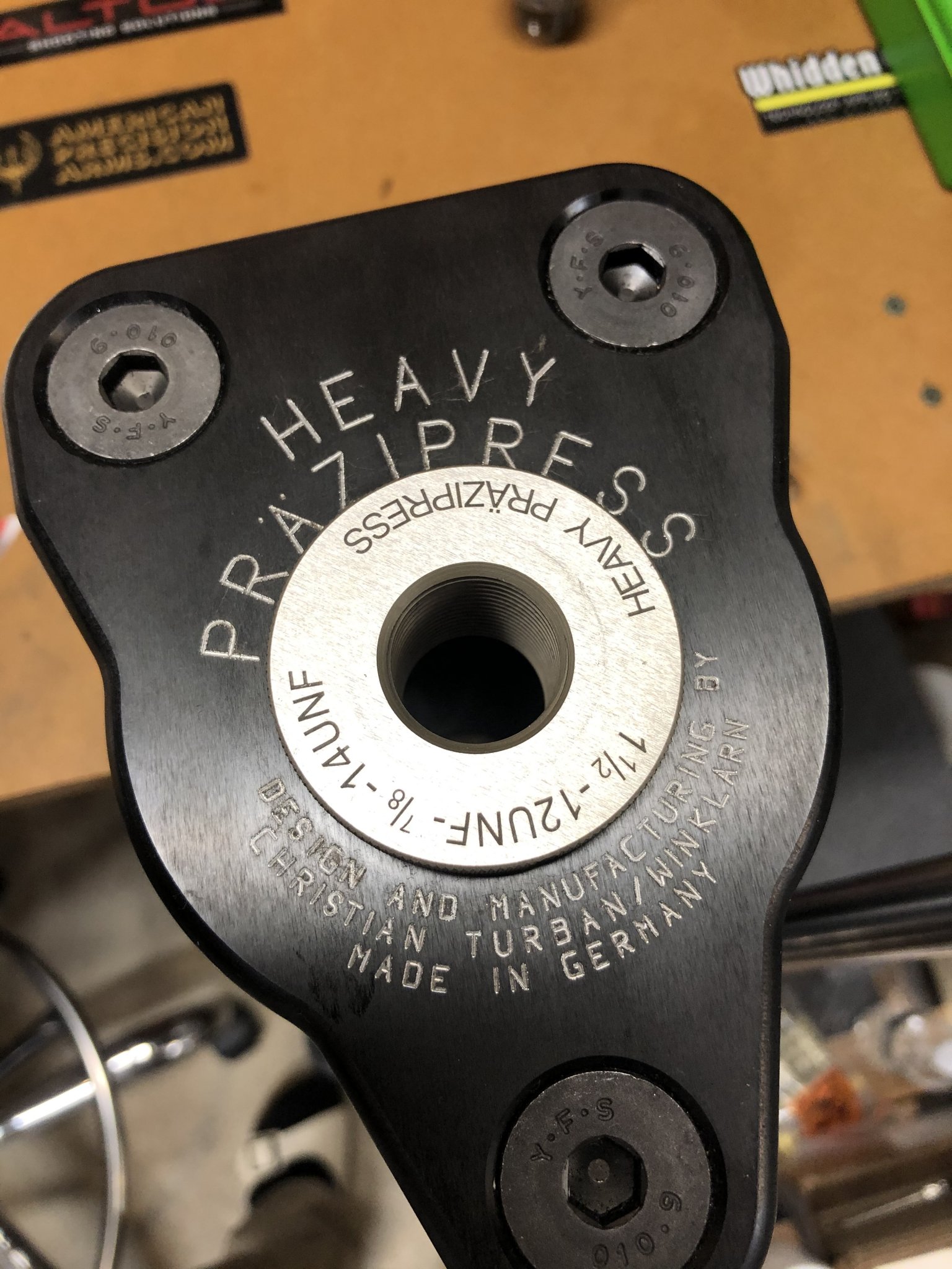

RCC brass ready for range will keep you posted about extreme spread and SD.
Runout on this press is 0.0005
I'm hoping for extreme spread to be under 5FPS or SD or 1 or 2.
Will keep you posted guys.
Using 120mm Heavy PraziPress results are mazing. Just like brass you get what you pay for concentricity of bullet seated 0.0005 :) :) :)
