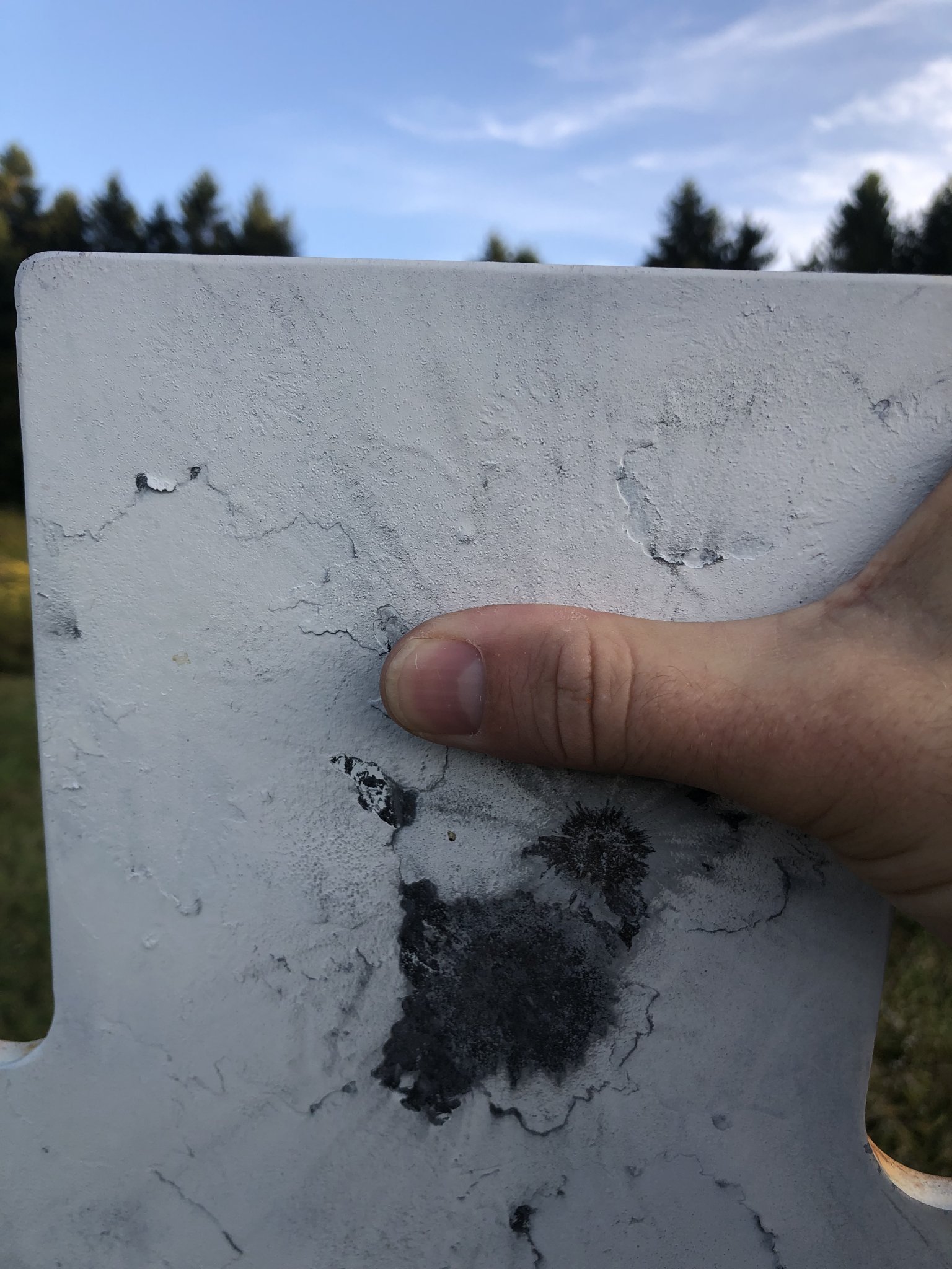

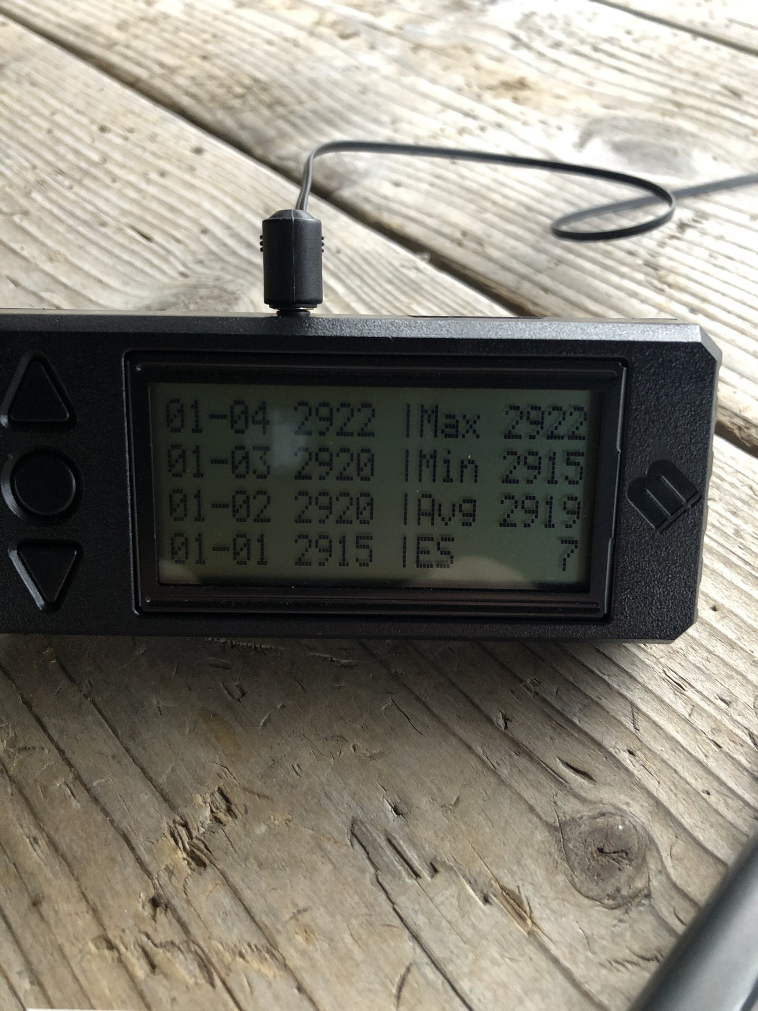

Range todan with RCC brass and 230 A-Tip H1000 powder. Extreme spread of 7FPS with 5 rounds. I’m more than happy with performance.
Also 3 shoots group at 800 yards.
I can’t ask for more than this I’m very happy with results.

@LakuNoc Here I am at work and getting jealous of that 800yd group. Nice! I'm assuming you are doing that accuracy node around 78.5 grains. Nice ES and MV. With the holidays coming up...I may get to stretch out to 1500yd next week...maybe. 600-800yds for sure.
I'm sorry that you have to work. But I'm sure you will be replicating same groups very soon with your 300 PRC.
Yes that is node
78.5Gr of H1000
230 A-Tip
RCC brass
