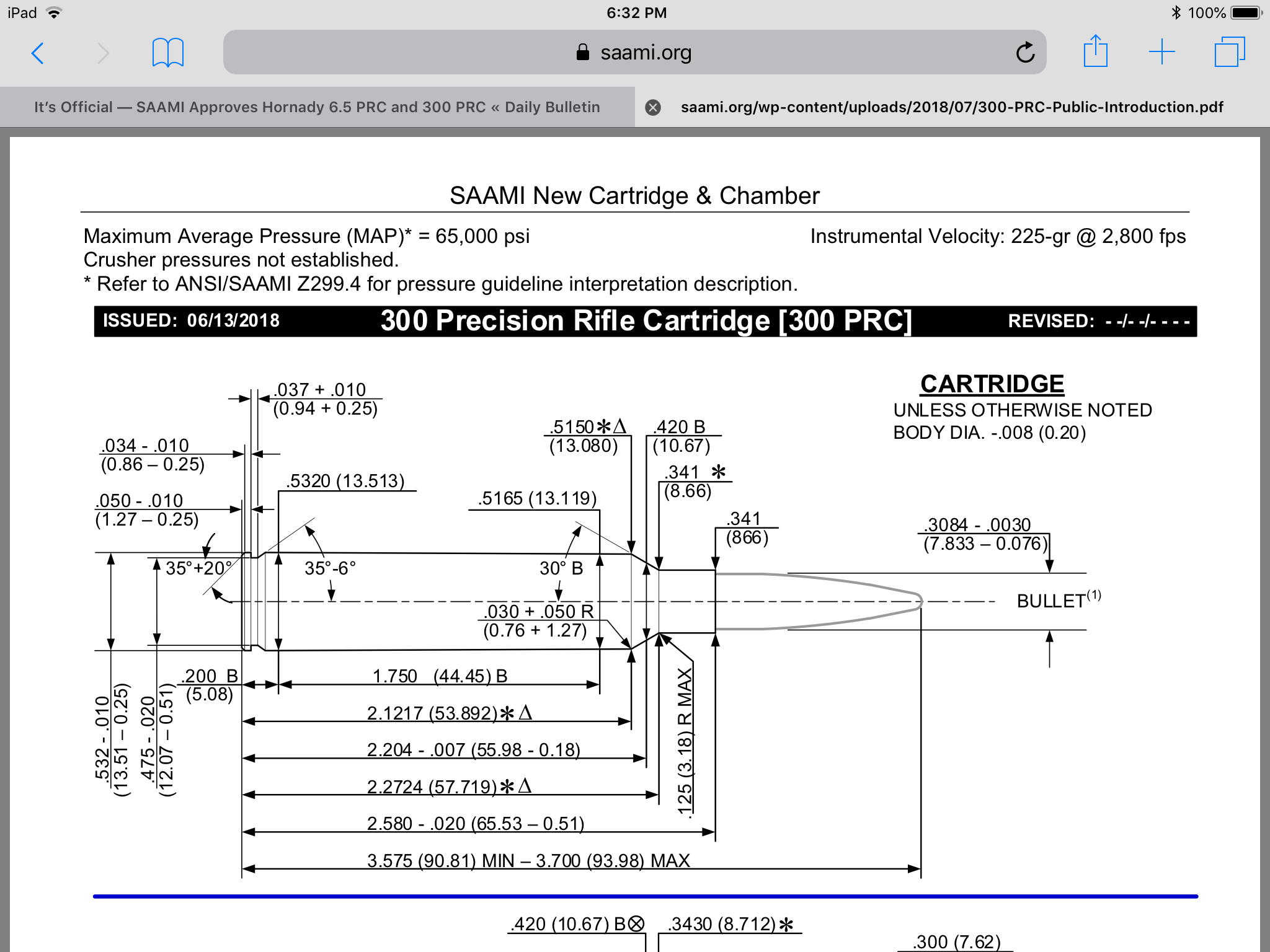

If you have a long action with a magnum (.532" bolt face) bolt then all you need is a new barrel.
300 PRC brass hasn't really hit the streets yet, @steve123 has been necking down the 375 Ruger for years with excellent case life and winning matches with it (as have others), Steve shared the process with me pre dark ages (the Scout years) and it's fairly simple.
Dave Tooley can and does build whatever he wants and has more time on big magnums than most shooters on this site combined (counting me) and is excited about the round, AI jumped on this particular bandwagon after seeing the results too.
300 Win Mag:
That shit is everywhere, components and loaded rounds.
The belt, the fucking belt.
A Win Mag case is 2.62" long compared to 2.580" for the PRC and many shooters have run out of magazine length when chasing the lands in an ever wearing throat and had to single load or get a new barrel.
