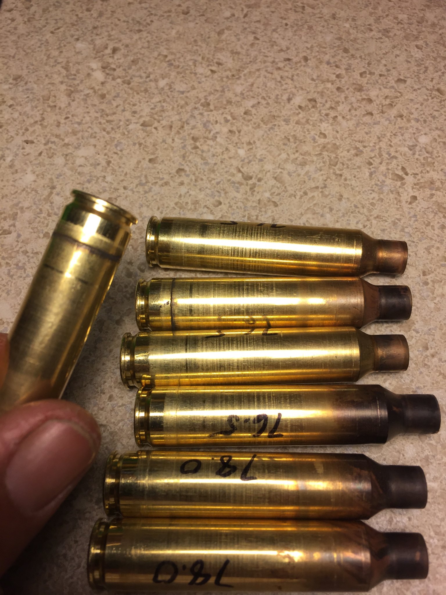

I just had to scrap 25 h cases with 6x fired with 8 of them completely separated.
I don’t get it?
I did rum up bout 3000+FPS mv during load development.
Recommendations? Ideas? Is my chamber “clogged”and it’s building pressure?
I don’t get it?
I have a custom Curtis action and mpa barrel
What was powder used? How many grains and what bullet? There is a difference between 3000fps with N565 and H1000.
What was the growth of brass from second firing on? what was your trim length? What was bolt lift like? What kind of SD's and ES's were you getting?
H1000 Berger 215, 76.0-80.5 (throughout LD) I have to check notes on growth, trimmed to about 2.566, bolt lift has gotten (harder) SD from 20-7 ES bought the same (I’ll double check my notes tmw)
At 80.5 grains with H1k is too hot with the 215s. Back it down a grain or more and you will be ok. I lost primer pockets after 3 firings at over 80 grains. If you want 3k, use RL26 or another powder like n565.

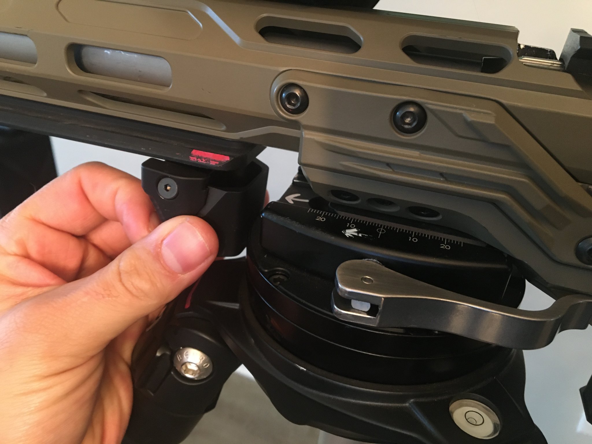

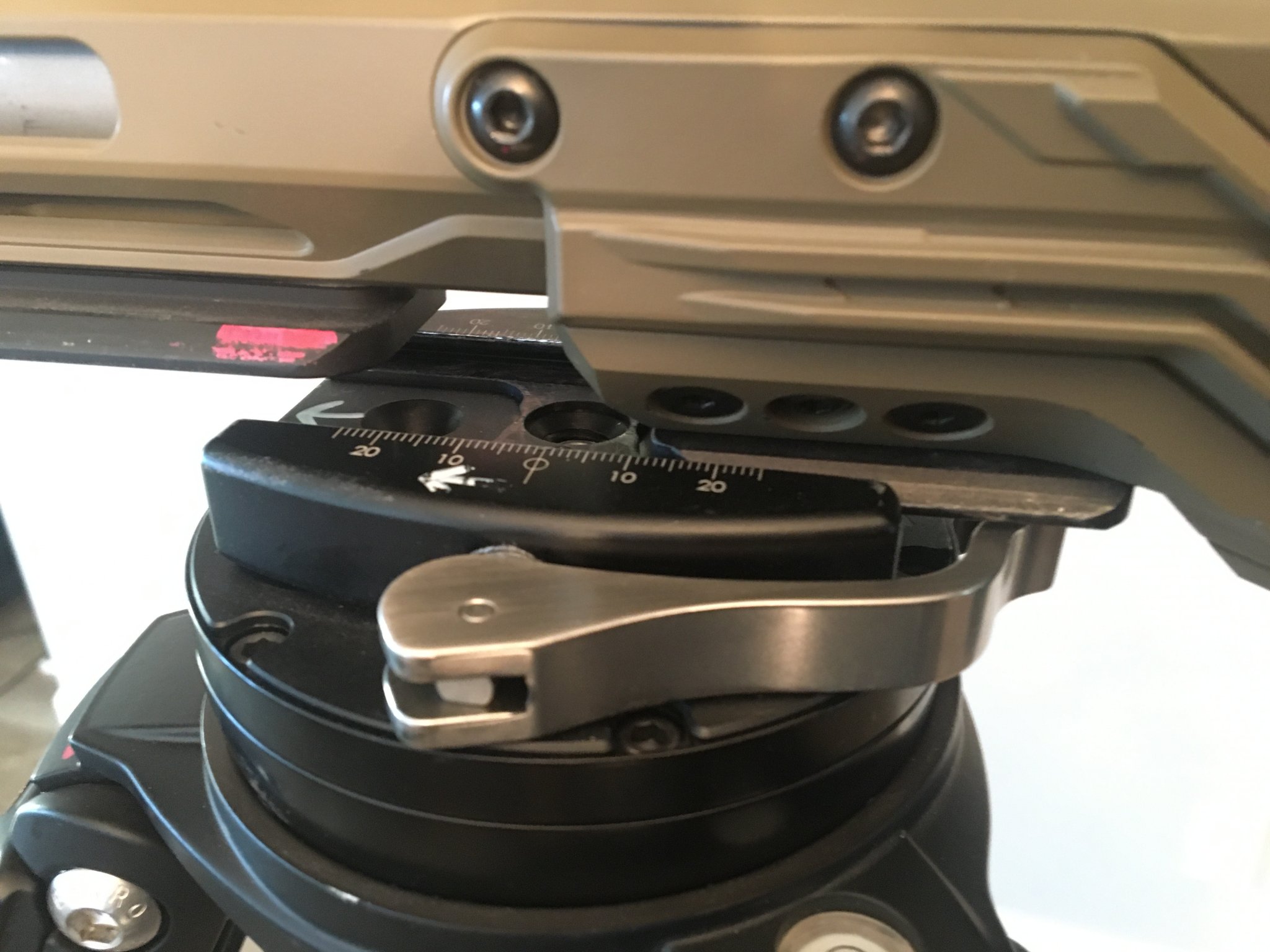

So while shooting my 300PRC suppressed off my tripod that uses an ARCA rail/clamp, I noticed several times the RRS ARCA clamp wasn’t providing enough clamping force to keep the arca rail from sliding back. Was thinking about installing an arca barricade stop to wedge the clamp. But truthfully I rarely shoot off a tripod. The ground was muddy yesterday so it called for it.

I've had some imminent separations but caught them before they split. Kind of special situation though as my first chamber was a touch out of spec. The brass never quite recovered. Had around a 30% loss rate at 4X if I remember right. Would be interested to see pictures. May help figure out what's happening.
The rings around the body are from poor chamber finish. The sooty neck/ shoulder looks strange. Doesn’t look like powder fouling at all. Has a lacquer like appearance.
Prw, head separations are not caused by excessive pressure. Excessive sizing causes that.
Like Jwknutson17 said, need details.
Reactions: IdealJoe and abn31c
What are you using to measure your powder? Complete component list and your process? Verified powder weight on another scale? Who chambered your barrel? Heavy carbon ring in your barrel? Round count? Cleaning regiment?
Triple beam/digital. De prime anneal (torch) trim, tumble,resize. H1000 berger 215. .334 neck bushing. Barrel is damn clean. Got it from MPA. Less than 400 rounds. Clean it per mpa regiments

1. How exactly are you cleaning your brass (unit + media)? 2. What's your cartridge headspace measurement? 4. How many firings before the rings showed up?
Your annealing needs some work. You need more experience/consistency if you're gong to continue by hand and in all sincerity 300 PRC isn't a good annealing training round IMHO. Buy some Tempil paint or a stick at least then download a metronome app for your phone.
Those rings are no bueno, you need to eliminate all other potential causes and then send that back to MPA.
Reactions: abn31c
@Prw , here is where I would start,
You may be sizing the brass too much.
.002 is plenty.
If that brass came out of my rifle I would send it back, it should not have those rings scored around it.
If you have a swithchlug on your mpa, make sure it is tight.
I think you may be over heating your brass, shouldnt be black.
Just my thoughts.......

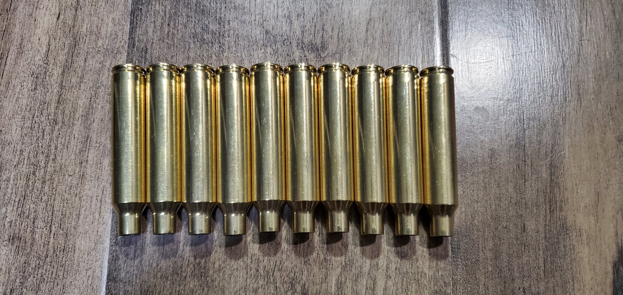

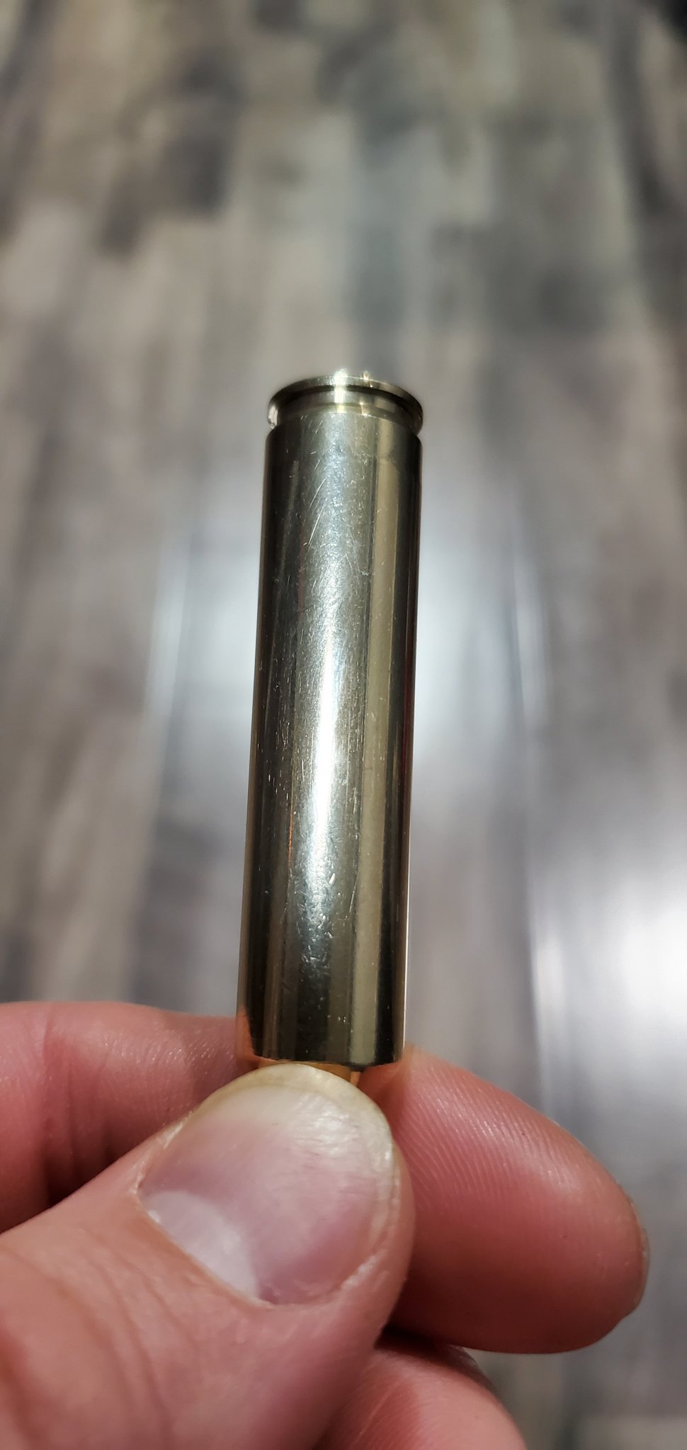

I retired this brass. 7 or 8 reloads (cant remember) on this lot in one of my guns. 79.5gr of H1k. Full length size every time. Pockets went before any separation. This was the worst piece and there is barely any indication of separation. Just grabbed 10 pieces out of my recycling bin.
