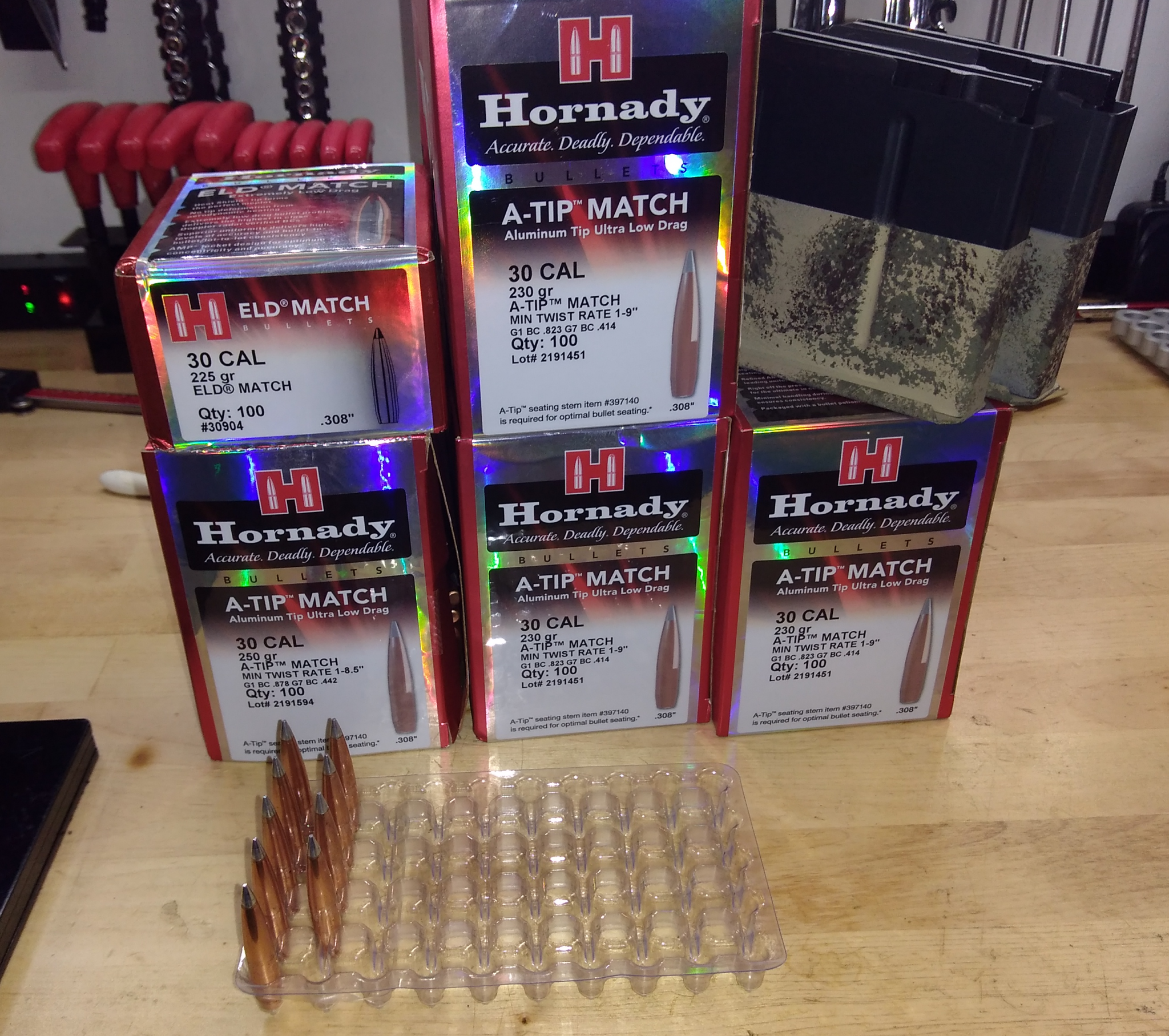

I CIP magazine feed the 230 A-Tips...they don't really care about jump at all...unless you are shooting paper at 1000 yards...you may not see a difference in seating depth on the 230's....the 250's...yep...have to single feed them.
If Thunder Valley Precision is open this weekend...I will most likely be there shooting some 230 A-Tips out to a mile.
Reactions: Mk32784
Just got off the phone... ordered a Orgin Action + 1-8 twist Bartlein barrel for a 300 PRC build. Goal is to shoot it at the NF ELR Match in June.
Probably gonna go for the 230 A-Tips. Would prefer to mag feed it so hopefully they run well that way.

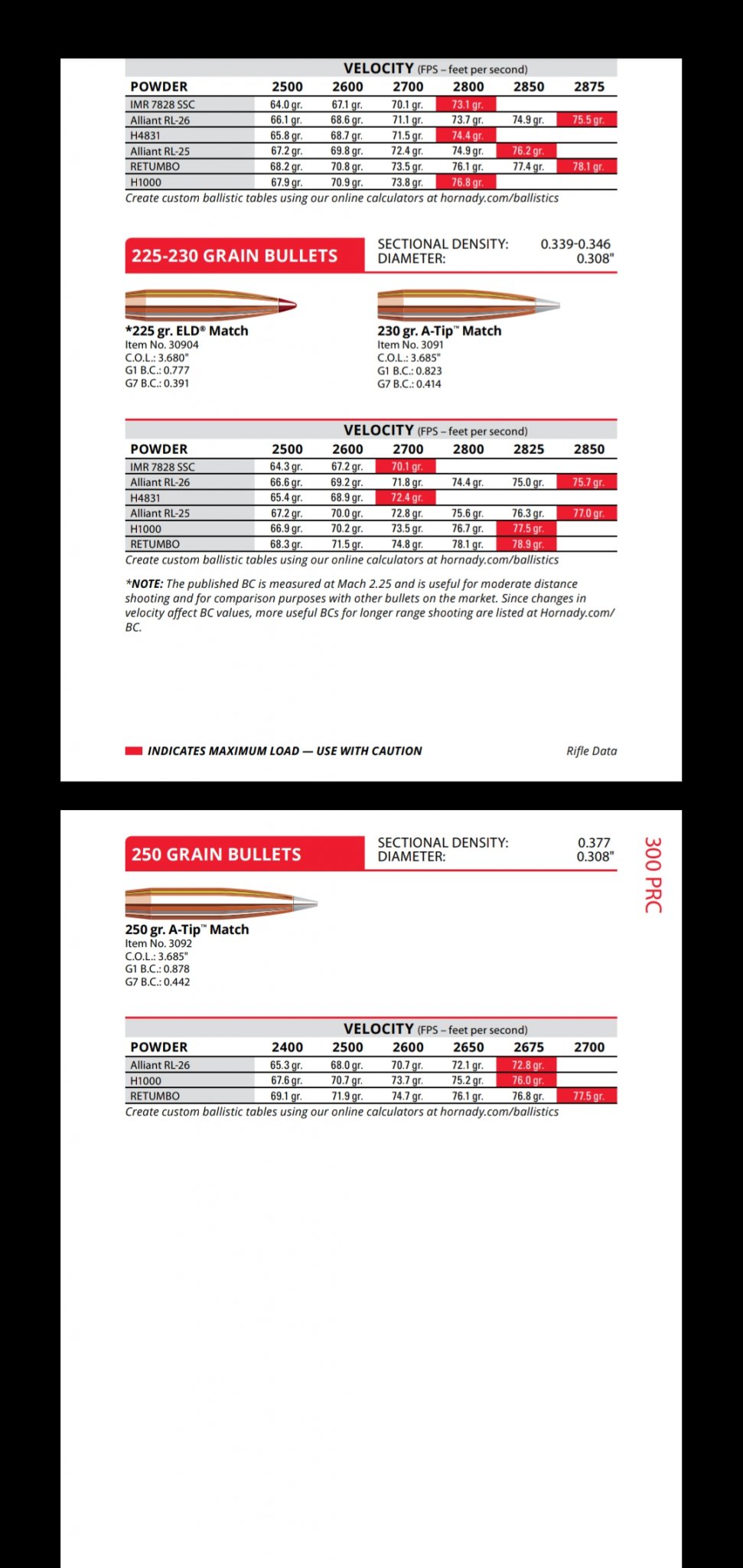

3300-3350 is more like 168-175gr territory for a 24" barrel. Just tested some stuff this week; 165gr @ 3360 avg. 62ksi with 81.5gr of RL-26. YMMV. Sorry to dash your dreams.
My 30" gets ~120-130fps faster than 24" published load data. Might put you in the 3200-3250 range. Subtract 30-40fps for a 28".

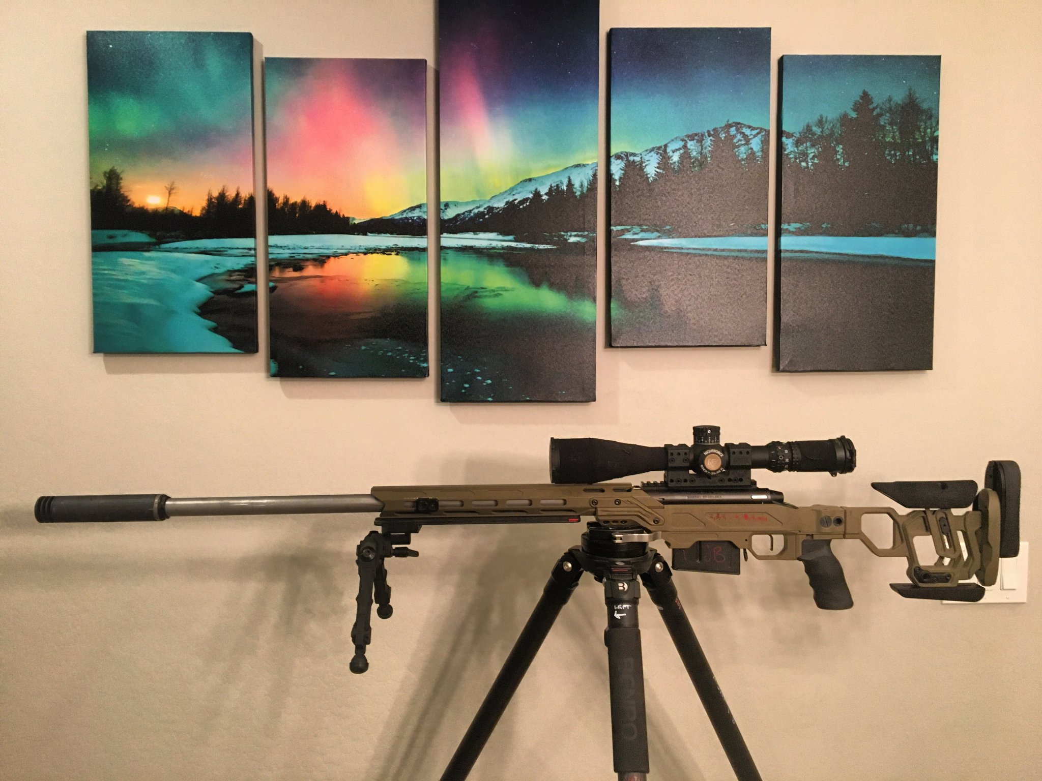

So, after following this thread for awhile I wanted a 300 prc. I just took delivery of a Badrock Southfork, trying to keep this as a budget friendly endeavor. I pulled a scope off an ar laying aroud and this is the first 3 out the tube..
Going to MHS tomorrow to get proper glass and a brake. Pretty excited to get load development started! Thanks to all that posted data, it's much appreciated.

So, after following this thread for awhile I wanted a 300 prc. I just took delivery of a Badrock Southfork, trying to keep this as a budget friendly endeavor. I pulled a scope off an ar laying aroud and this is the first 3 out the tube.. View attachment 7243924
How does the tenacity action feel? Bolt lift? Does their chassis accept CIP length magazines? (3.85) Contemplating on the getting a southfork myself.
Action is great, it's a 90° which is new for me, but it is smooth. Yes it is cut for CIP mags as that is what they sell for it. I think it's a great package for the money. I was going to use one of my mk V actions but this was cheaper and faster. I think it would be hard to be disappointed with what I got.

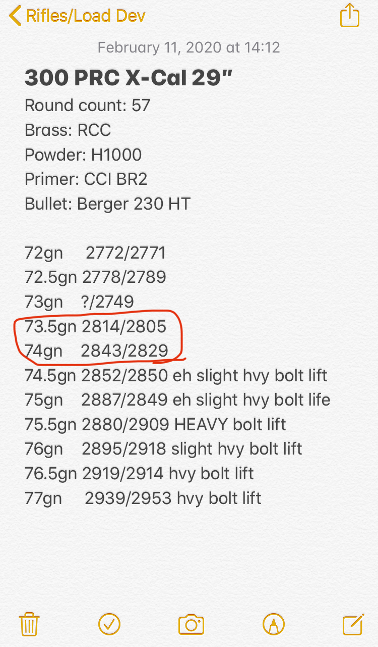

Just installed 29” 300PRC barrel.
anyone have a light brake in load with h1000?
Supplies I have for brake in:
230 Bergers
CCI BR2 or Fed GM215M
H1000
was thinking something around 70gns. Have to check case fill. Don’t need a double ignition.
Im going to load some 225 at 72g H1000 to break in my barrel and sight in. Probably 25 rounds. Then work up to 77. There’s should be a node around 76-76.5 grains running around 2900. I’ll use Hornady brass and cci200 primers. Brass has been blueprinted.
Reactions: JB.IC
i was thinking the same. I’m in Arizona so I don’t want to load near max but it’ll be interesting to see what speeds I get at a heavy bolt life.

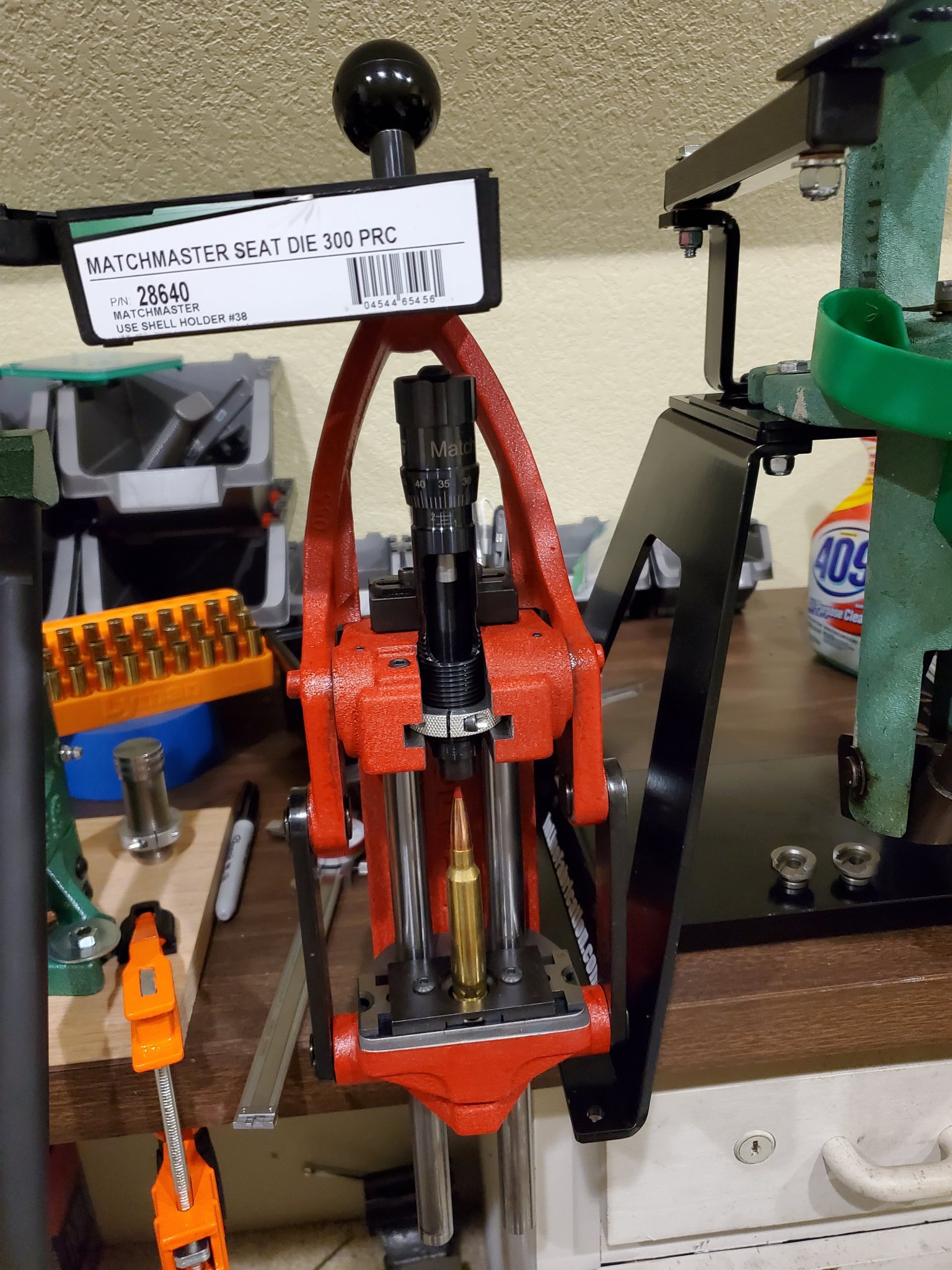

Anyone using the Forster Co-Ax with the Redding 300 PRC competition seating die? If so, with what length of bullet? Any clearance issues?
I have 1800 empty cases ready to load but my Hornady seating die with micrometer is too tall for the press. Looking for an alternative with micrometer. Thanks, Kendal
Try the the rcbs matchmaster....
I’m using the RCBS matchmaster
Here’s my load test.
29” barrel suppressed
my magnetospeed was giving me some off the wall readings. Some as high as 4K FPS. The velocities below are from my LR.
my next test will be between 73.5 to 74gn.
