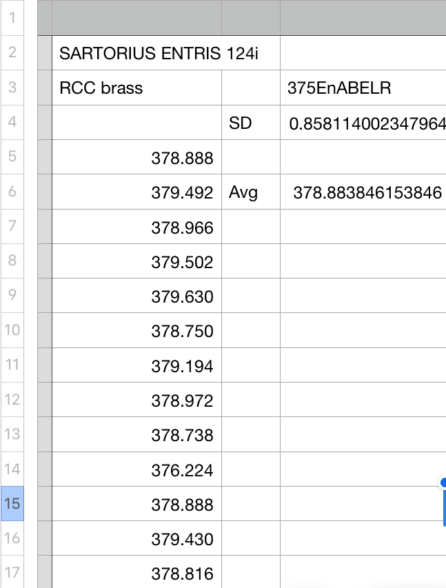

Just got 60 pieces of 300PRC and 60 pieces of 375 EnABELR brass. It’ll be a week or so before I get a chance to use the brass. Below is 13 pieces of 375 EnABELR brass weighed on my un-warmed scale.

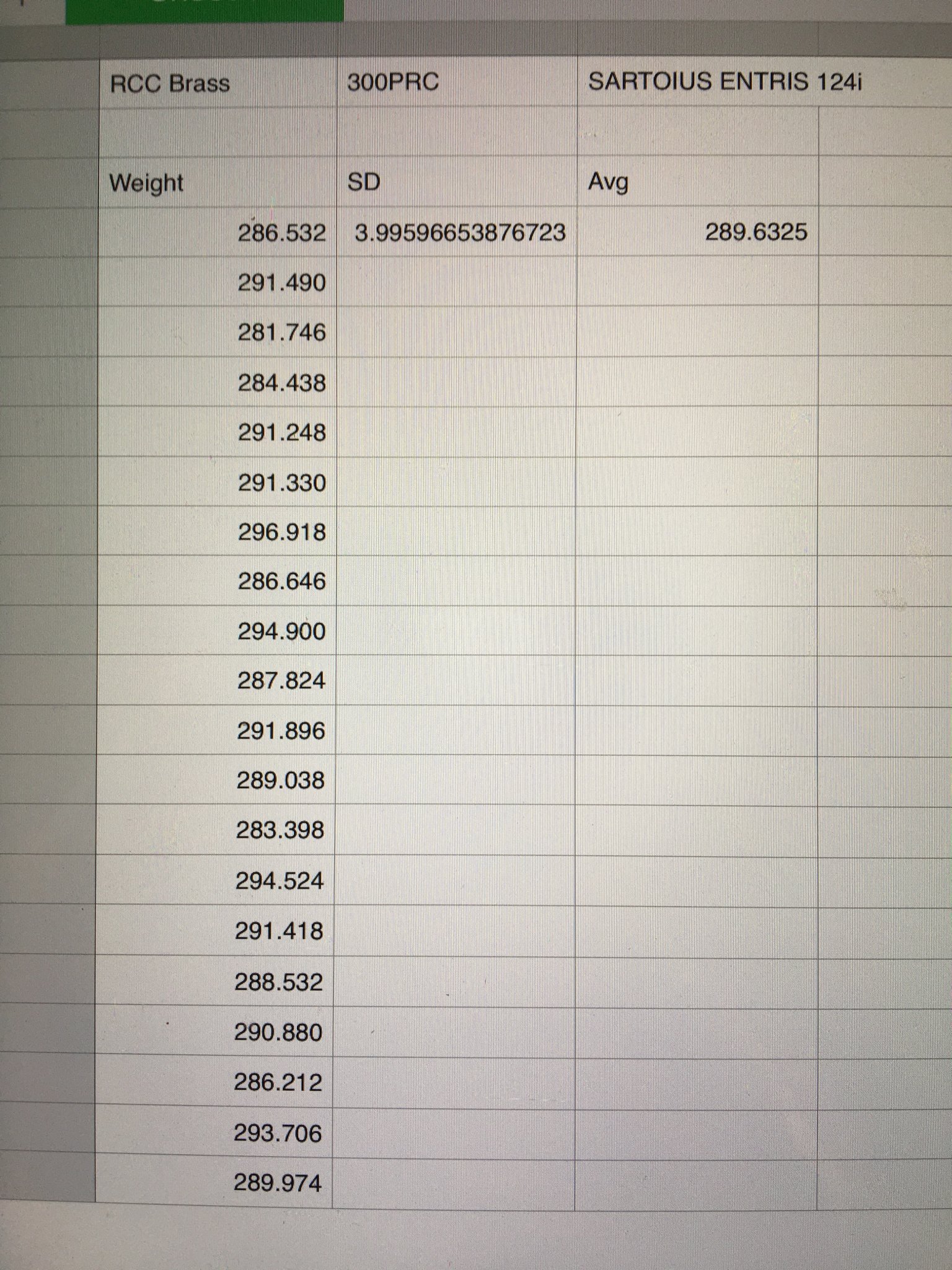

20 pieces of RCC brass weighted on my warmed and calibrated Sartorius ENTRIS 124i
That’s interesting, out of 200 pieces of Hornady 300 PRC brass my low weight was 284.x and high was 289.x most were 286-287
As long as internal volume is consistent, weight doesn’t matter. But it is interesting to see that much SD. I never trimmed the brass to the same length so that’s probably a primary reasons for the deviation.
Reactions: rockin randy
A friend has done testing where he weighed and volume checked a LOT of cases and his conclusion was that sorting by weight is very near to the same thing as internal volume. Obviously very dependent on the case, maker, lot, process, whatever... But it makes sense. The external dimensions are almost identical, primer pockets are near identical, extractor groove does not vary by much, and material density variability is negligible within the same lot of cups/cases. So it makes sense then, that by and large the internal volume changing, is directly related to the weight of the finished product. In my weighing of ~200 Hornady cases I think I saw an ES of about 6 grains, and most fell within a 2-3gr range.
Sorting them did nothing that I could see on paper or the lab radar, FWIW.
That last part is why some people stopped separating them by weight. They found out that based off the data they recorded, it didn’t make any sense to weight sort. But it makes some people feel better if they do it.
Probably because the delta in volume of a series of cases is negligible next to the volume of the bore as the gas is expanding down it, and velocity is, barring some inefficiencies, pretty directly related to area under the curve on a pressure vs. distance or pressure vs. time graph. In other words, that tiny change in volume is both small, and a small part of the total velocity gain of the bullet.
I don't know it for a fact but I have suspicion that powder energy density/uniformity may play the biggest part of the equation.
All that is beyond my knowledge lol. But yes that sounds about right.
