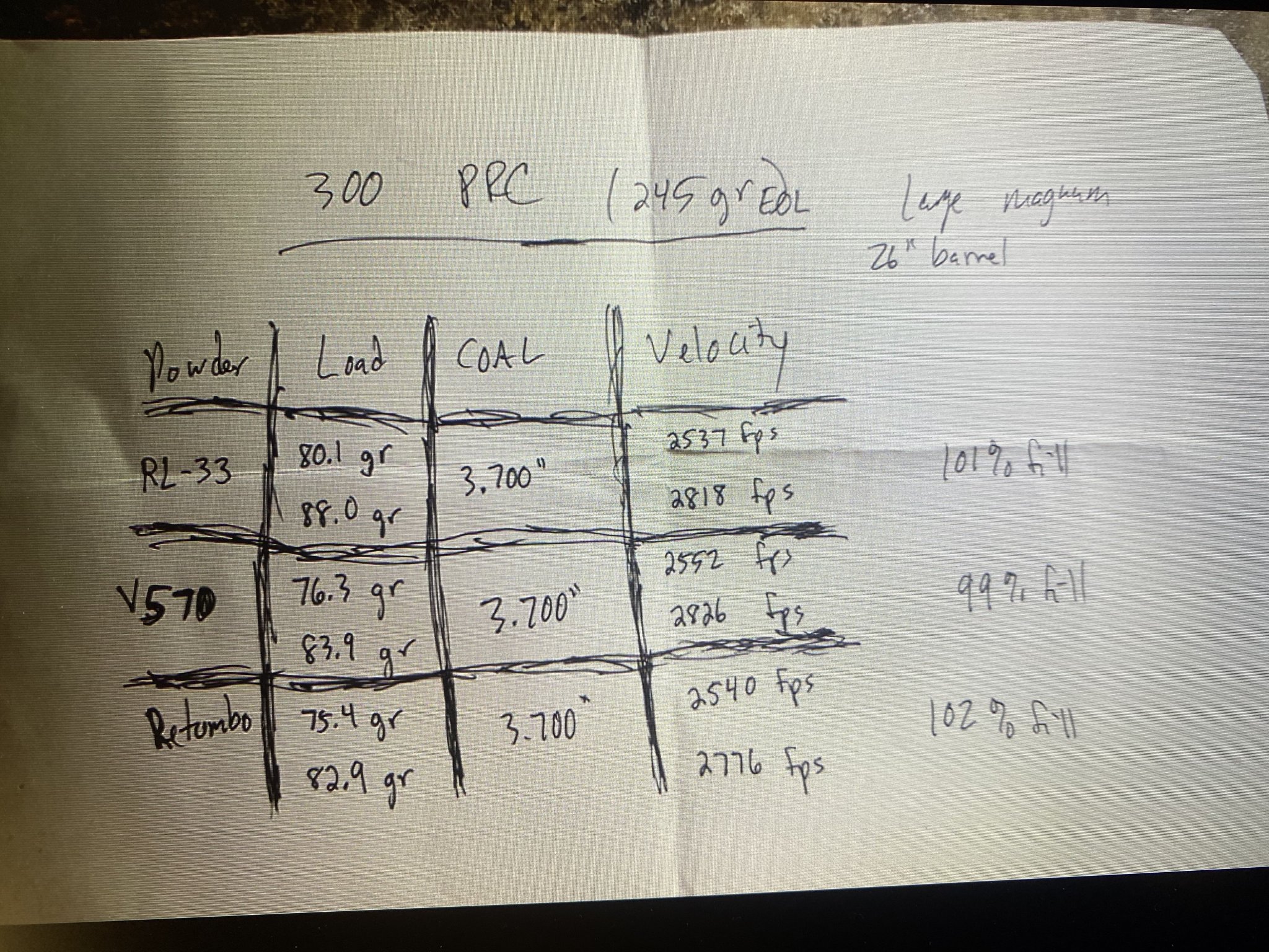

How does Retumbo compare to RL26 for velocities on the 225/230? I got Retumbo left over... but I can't seem to find RL26.
Don't know...this weekend I should have some load data on RL-26...so I can probably give it to you after Sunday. So far....for me it is N565, Retumbo, Maybe RL -26 when I get data........ big gap... H1000.....HUGE GAP.... RL-33.
I've yet to find anything as good as N565 for me...in my gun....in my conditions....for my developed loads.

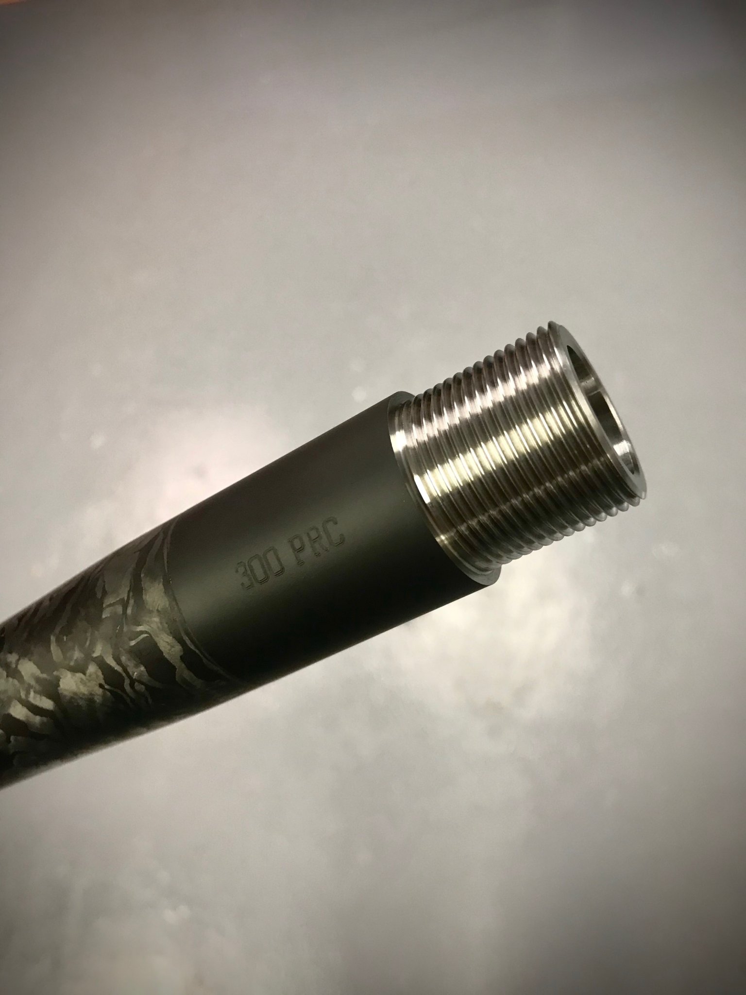

For the Lone Peak Fusion TI hunting rifle... few more days til I can go pick it up.

I think the Retumbo is completely burned by about 20 inches....you may have better speeds with RL-33. RL-33 sucks donkey butt for me...however...it may be great for you with that long barrel that needs a more prolonged powder burn. If you lived closer..I'd give you some to try out.
