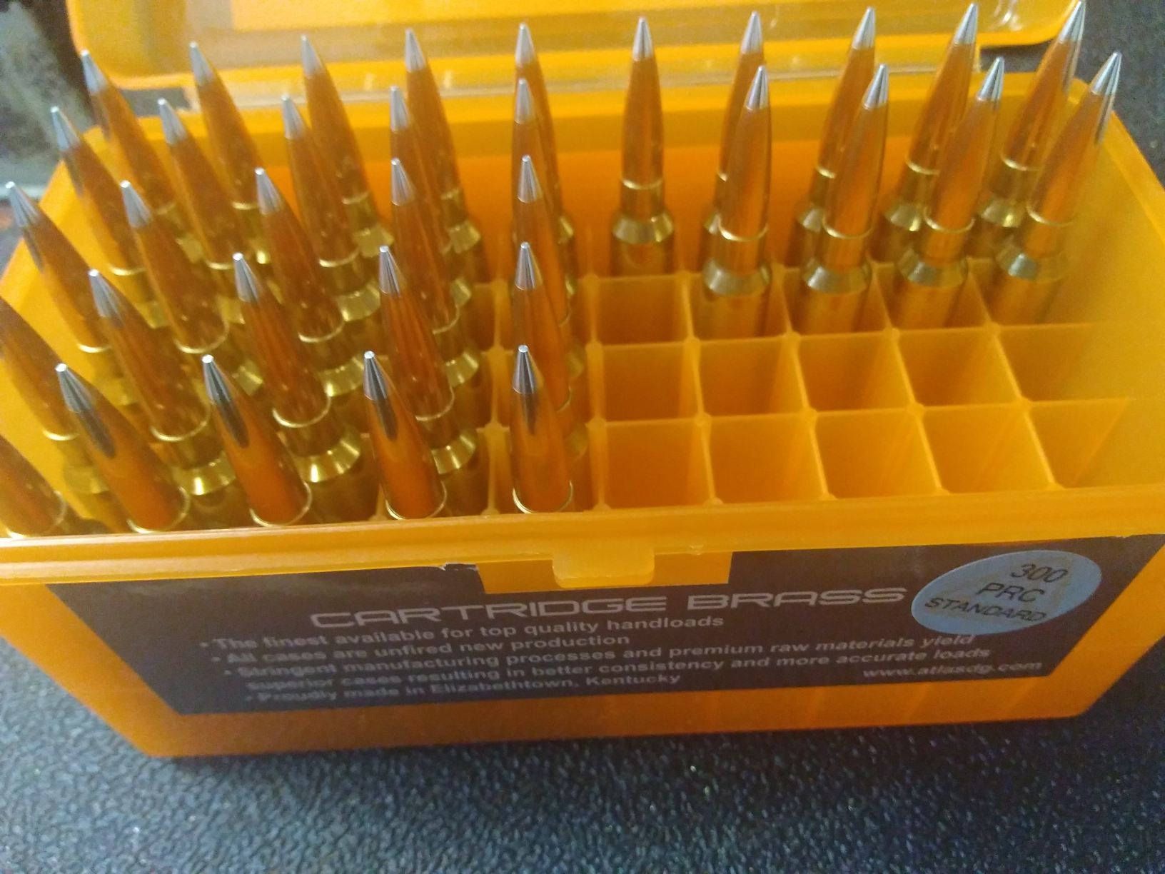

Brass: ADG Virgin brass. Was full length resized mostly due to the necks being a little small...a little too tight for the the bullets.
Bullets: Hornady A-Tip 230gr

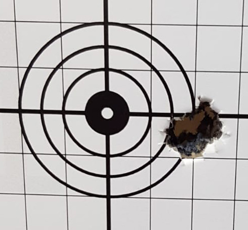

N565 Target Pic:
What's that in the bottom right? It is a 'control' group...heh...actually it is 5 rounds of mixed powder and bullets that I was fouling the barrel with. I had just done a good scrubbing of the barrel the night before. You don't see 5 holes? The first shot was off paper to the right due to not looking at my scope dials and having the windage turrets moved 2 mils. IT's good to have those mistakes when not on the clock...when it doesn't matter.

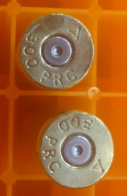

I am backing down from the max I tested. As you can see below... 79.0 grains of N565 and RL-26 is no bueno.
N565 on top....RL-26 on bottom
Purchasing a string gauge is on my list of things to buy....Trying to be a good steward and help with powder development for the GordonsReloadingTool software.

Length grew by 2thou on the RL-26 and 2.5thou on the N565. Base...I can't see any measurable expansion in any other direction...if anything...since I didn't measure these exact ones before firing... half a thou?

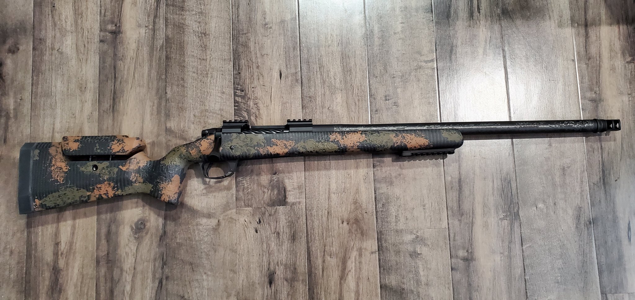

I'll get some numbers for everyone on the 22" I picked up yesterday with RL26 and the 215s. Fritz does some great work. This will be my first non Tooley 300 PRC barrel but I have no doubt it will hammer.
Lone peak fusion TI in a manners EH1A cip mini chassis. 22" 10twist proof. Went with the 10 for the altitudes I hunt at and only shooting the 200 accubonds and hybrid 215s.
Well see how she does.

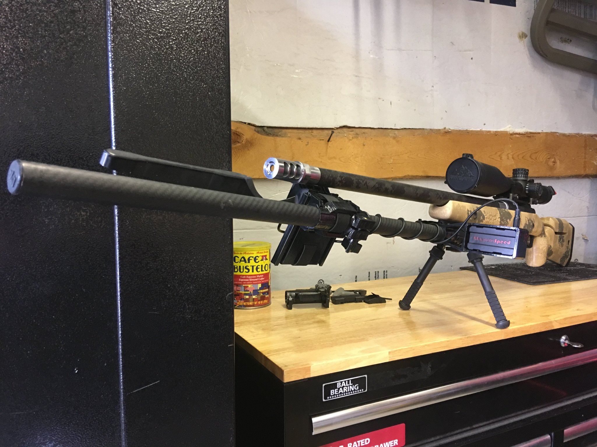

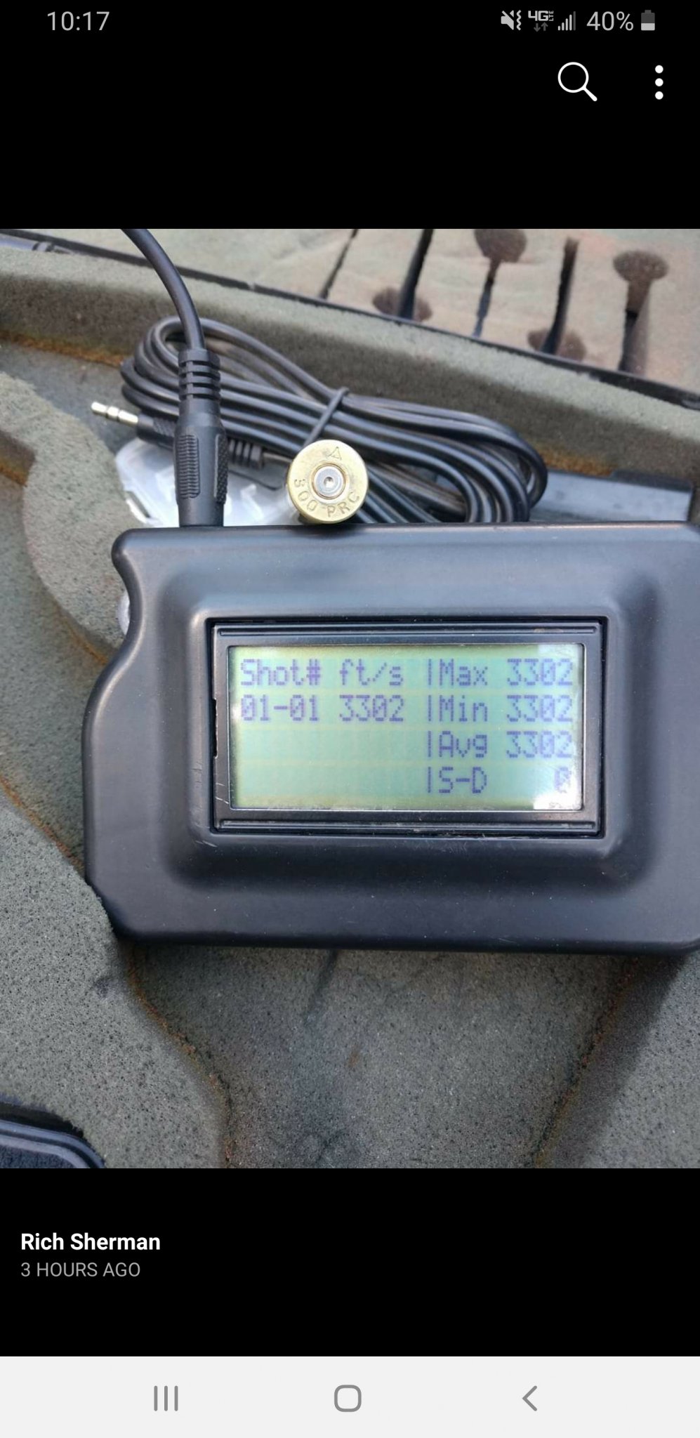

Go to Wiser Precision and buy this magnetospeed Mount. Causes zero poi shift.
Honestly I just like my lab radar. Works with every gun I own. Don't need an mount.
I have both LR and Magnetospeed V3 with rod mount. I hated the LR until I got the peep sight. I was doing some side by side testing and discovered my MS v3 was giving me incorrect MV. I figured it out by plugging the speeds each one said and the one that got me to connect to 1000yd target with my 18” 6.5CM was the LR.
I then tested both with my 300PRC and I started to get 100+ FPS variation between the two.
Disclaimer, I’ve owned the MSv3 since it was first released so it may finally be failing because I’ve never had an issue up until a few months ago. All the reports I’ve seen between the two is they’re within 10fps of each other and generally I see that when the MSv3 wasn’t giving me off the wall readings.
Yep learning how the LR likes to be setup is the biggest key. I haven't really ever had trigger issues.
I used to own a MS and they read +- 10 fps for me.

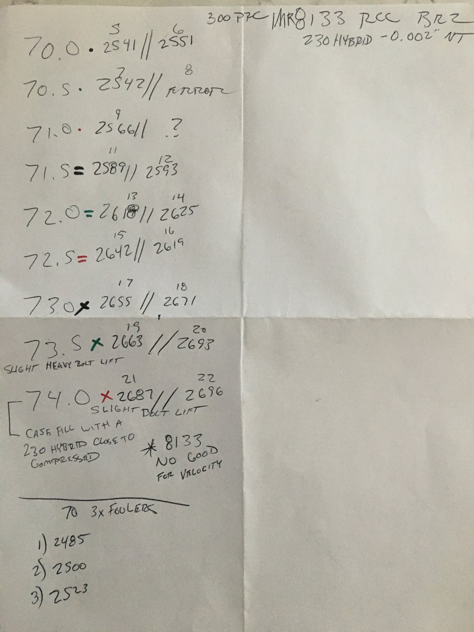

You didn’t look hard enough. I already posted 8133 pressuring out too soon.
73.5gn of 8133 with a 230 Berger got a heavy bolt lift at 2663fps in a 29” barrel.

I Would NOT try that RL-33 load. To me...that looks very dangerous considering my testing with the 250gr A-Tips. 80gr was WAY too much pressure for that bullet. I mean WAY TOO MUCH.
I’ve seen posts from 2 different shooters using 86.5 grains of RL33 with the 245 Berger.
I also read your post with the 250 and RL 33. Maybe you got a bad lot or something else was going on?
Could be...but still I'd be careful putting that much powder into a case. That is a LOT of powder... What if you reload with the same or similar lot?
If it does work out for you..and you live close to KY...I'll give ya the rest of the bottle...heh
OAL = 3.770
Barrel = 26"
N565
min: 71.3gr. max: 78.3gr. 2501-2731fps
H1000
min: 72.1gr. max: 79.2gr. 2495-2732fps
Retumbo
min: 75.4gr. max: 82.9gr. 2540-2776fps
Data obtained from Berger.

So I contacted Berger regarding load data for the 245 EOL, and they do not recommend RL 26.
“...due to the fact that it is simply to fast of a burn rate powder to be useful due to its actual burn rate being very close to RE-19. At what would be considered a maximum charge with either powder there would be to much air space left over that leaves a potential for a detonation condition...”
Yet Hornady lists it as a viable powder for the 250. Why aren't they worried about a detonation condition?
