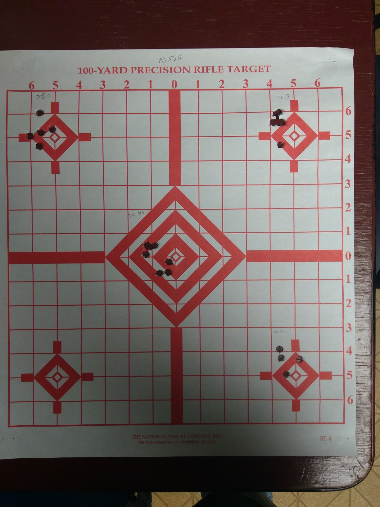

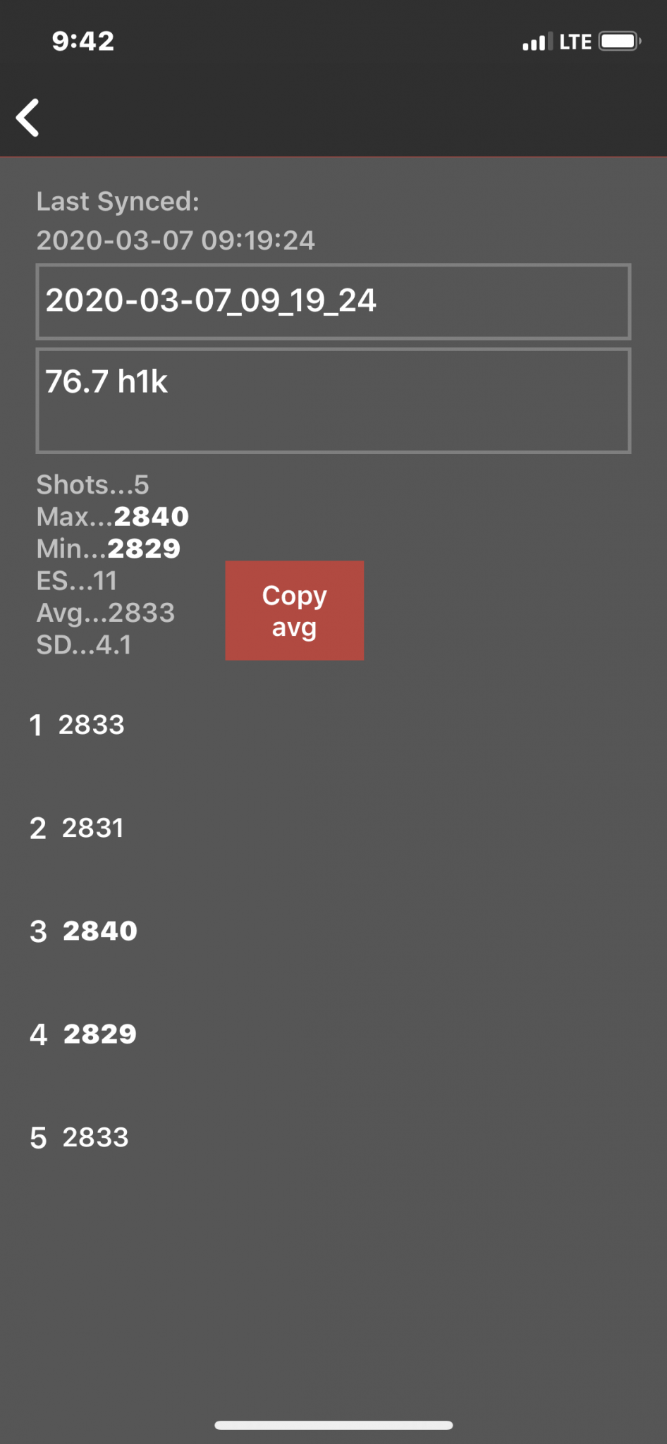

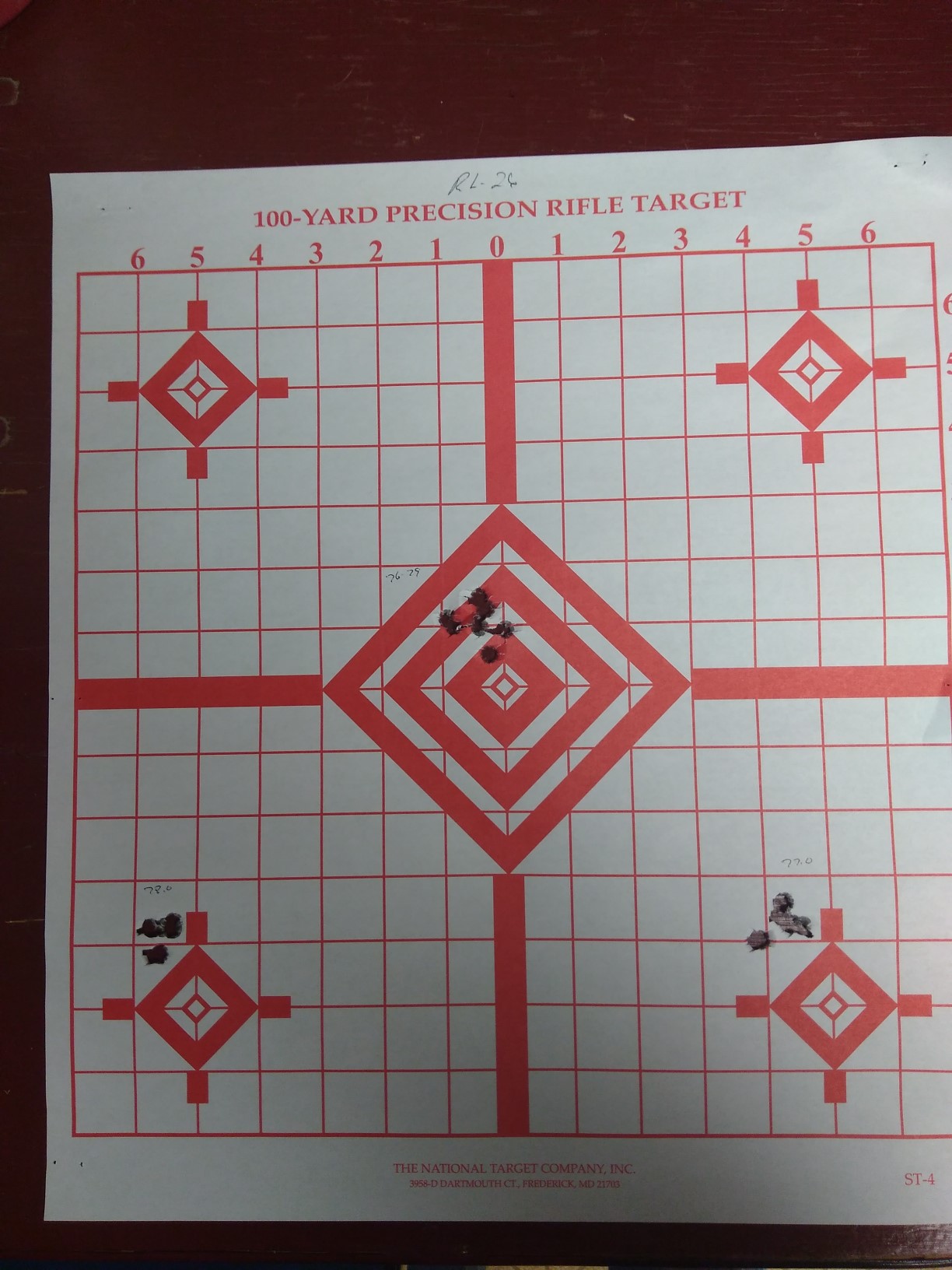

Went out and ran a ladder with the new ADG/N565/ 230 A-Tips . Velocity was outright amazing , accuracy was the worst I thing I have ever seen out of any of my rifles EVER !! Not even sure the last time it was cleaned as it has been on the back burner for so long. I guess I should have ran a mandrel through the new brass as well , it was running about .003-.004 neck tension out of the box. I know the rifle will shoot as it would easily hold 1/2 with RL-26 and 230 A-tips with Hornady brass .....
Proof 26” prefit
Elevation 4650
Humidity 43%
Temp 46F
OVERCAST
Coal 3.810 @ .020 jump
Velocitytaken from LabRadar
76gr /2836/10/5.5
76.5gr/2872/31/16
77gr /2889/46/19
77.5gr/2908/23/18
78gr /2925/30/15.1
78.5gr/ 2946/17/8.5
79 gr /2960/ 10/4.5
79.5gr/2963/10/4.6
80gr /3005/9/4.3
80.5gr / 3023/20/9.4
Reactions: 4KDOA
As mentioned above, did the range thing today.
RL-26
Brass: ADG first-fire
Temp: 50
Elevation: 600'
28" 1-9 barrel
EDIT: Bullet: Berger 230
First group of 15:
71.2 - 2789 fps
71.4 - No register
71.6 - 2795
71.8 - 2800
72.0 - 2817
72.2 - 2808
72.4 - 2807
72.6 - 2822
72.8 - 2835
73.0 - 2850
73.2 - No register
73.4 - 2849
73.6 - 2858
73.8 - 2860
74.0 - 2869
Second group of 15:
71.2 - 2790 fps
71.4 - 2790
71.6 - 2795
71.8 - 2797
72.0 - 2807
72.2 - 2809
72.4 - 2828
72.6 - 2834
72.8 - 2841
73.0 - 2837
73.2 - 2853
73.4 - 2855
73.6 - 2858
73.8 - 2862
74.0 - 2868
My shots with my semi-arbitrary 72.2 load:
Average: 2815
Highest: 2826
Lowest: 2807
ES: 19
SD: 6.6
Shots: 13
I was a little low guessing my load. I'll probably play at 73.4 for now.

Thanks for the advice. Unfortunately, I didn’t get that far today. Found out my primer tool takes proprietary shell holders <sigh>.
I saw the question asked, but I didn’t see a response, or I missed the response... did anyone share Aztek settings for ADG?
I’m jealous of everyone who has reached close to 3000fps with a 26” barrel and a 230gn bullet. RL26 and N565 seem to be the velocity winners

N565 Target Pic:
What's that in the bottom right? It is a 'control' group...heh...actually it is 5 rounds of mixed powder and bullets that I was fouling the barrel with. I had just done a good scrubbing of the barrel the night before. You don't see 5 holes? The first shot was off paper to the right due to not looking at my scope dials and having the windage turrets moved 2 mils. IT's good to have those mistakes when not on the clock...when it doesn't matter.

N565 Target Pic:

Reloader 26 Target:
So...this is a VERY small data set. However, RL-26 with these 230 grain A-Tips look real promising for the upcoming ELR events. I'll take this now fire formed brass and do some more load development in the coming week and see if the data stays the same or changes slightly.
