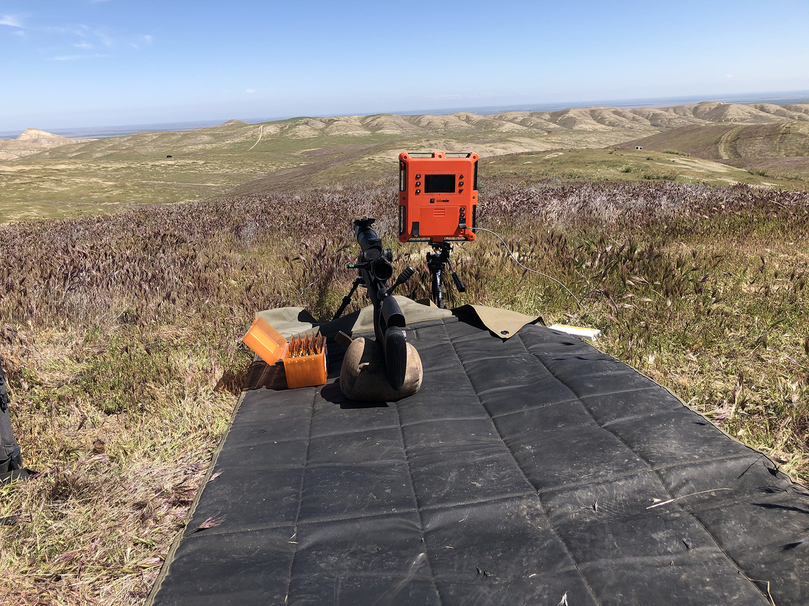

@Mk32784 Man I'm jealous now....my 300PRC is sleeping in the safe because I can't take it out past 242 yards with Ohio in lock down....can't wait to get back out to Thunder Valley. I loved watching the trace...what was the black round? 8"?
Lucky we are stilled allowed to drive out to BLM land, which is about the only place I can shoot at the moment.
6 inches. It was a tough little bugger.

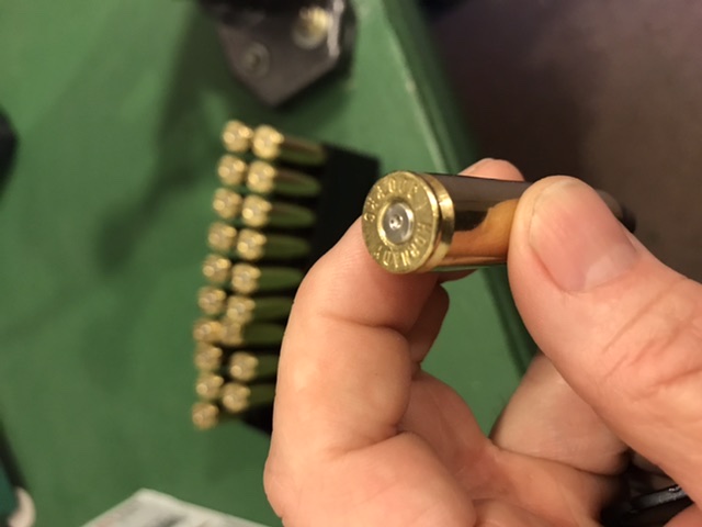

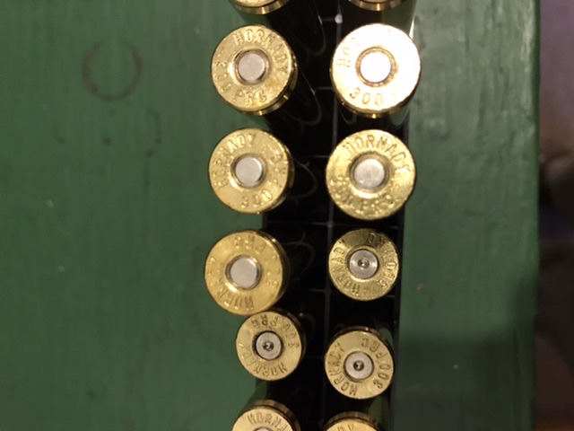

I just bought a Christensen arms Mesa LR in 300 prc. I bought a couple boxes of factory 225’s for barrel break in and brass and I noticed the primers were pretty flat. I noticed the same thing with a 6.5 creedmoor when I ran some factory through it.Wondering if anybody else has noticed this ?
I have never fired a factory 6.5 prc round that primer wasn’t flat as a hammer after firing

How's the bolt lift? If normal, run it. I see you have ejector marks on there also but usually from how soft the Hornady brass is. The Hornady factory ammo is loaded on the warmer side also.
Ya, I noticed it with my creedmoor with factory ammo. I haven’t had a chance to see how much the brass grew. For the guys that are using hornady brass, are you loading to this same flatness? If so, how many firings before the pocket gets loose
I have gotten hard bolt lift with precision hunter, and I stopped running that but without hard bolt lift I run it (6.5prc)

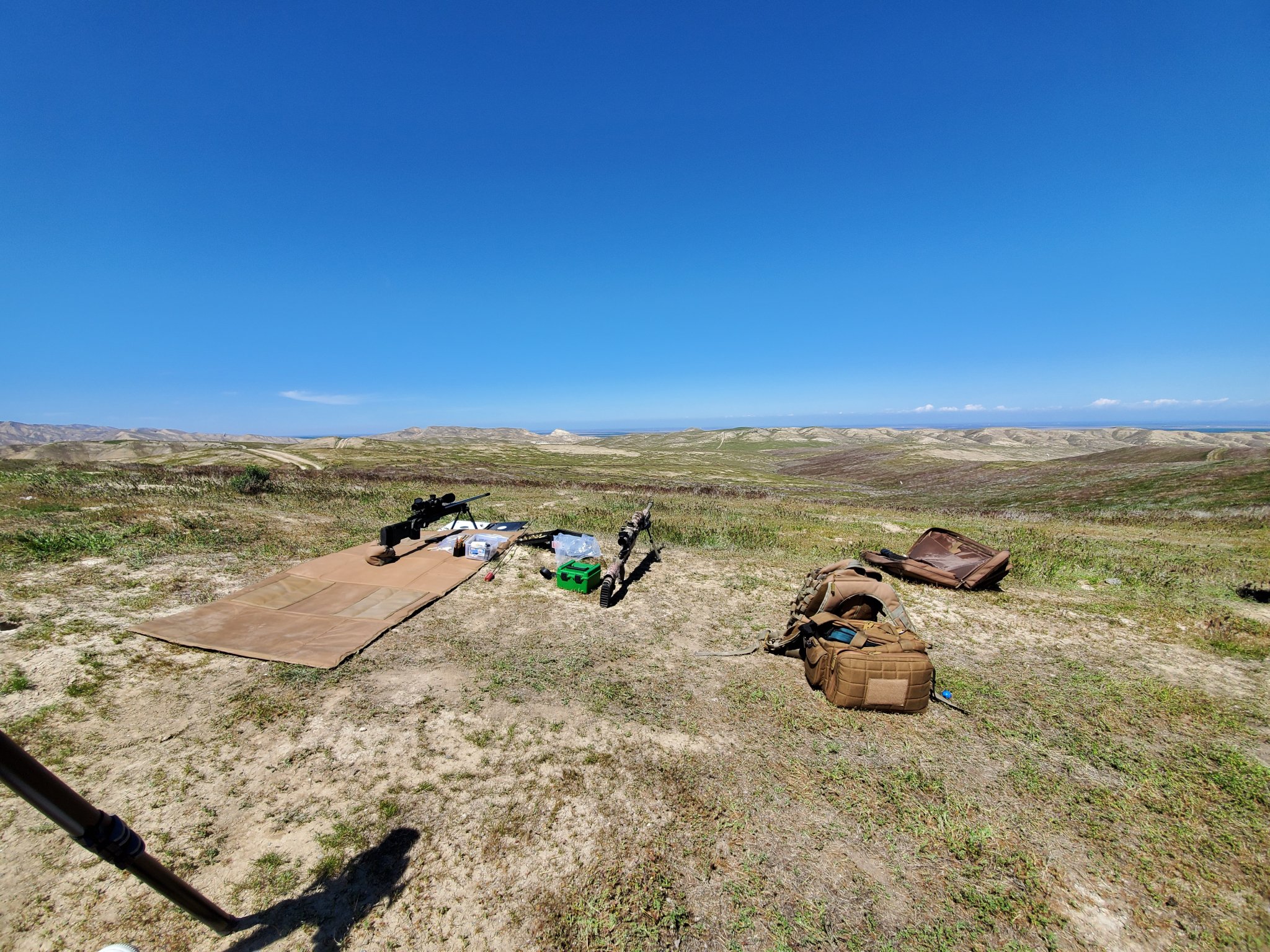

So, I'm working on a video from my shooting trip yesterday, but ahead of that I need to post a pic - and a quick WTF story...
This is where we were shooting - we were at 1500 yards, and I think we can hit a mile by setting up targets in some of the gullies to the right:
Now the story:
It's getting on about lunch time and this black Tahoe rolls up on the road near us and stops. We're thinking he wants to drive on, so we stop shooting and wave for him to go through. He gets out and comes over to talk about where to shoot - he's with his son and their original spot was getting closed down, so they needed another. We tell him that we can break for lunch if he wants to set up steel here - so we do and he goes to set up.

I get a PM on Snipers Hide from @2aBaCa asking if it was me up in the hills yesterday. Seriously... what are the odds?
Video coming soon.
Bolt lift wasn’t horrible
Snag some ADG brass and load workup with that. Stash that Hornady factory stuff away for a rainy day. Now that you have an option, just don't waste your time with the Hornady if your starting fresh from the beginning right now on a new rifle.

What are the odds 100sq miles of back country and we end up on the same hill. Beautiful day, thanks again for sharing the spot.

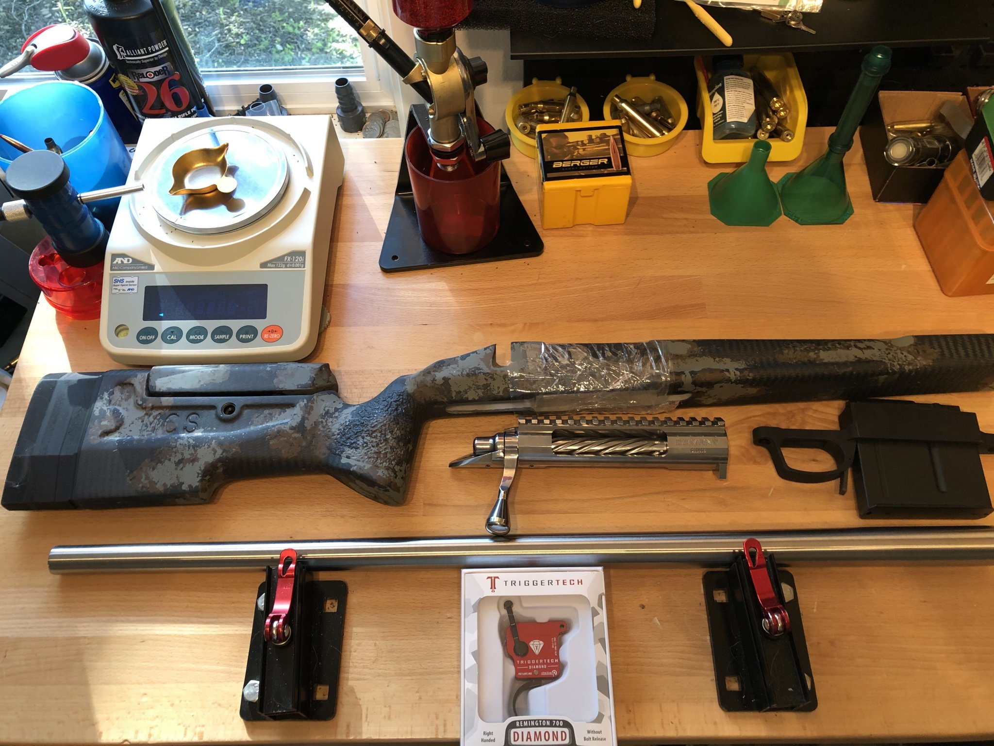

Ok, so I have some spare time on my hands. Delivery of my 22” 300PRC barrel is still at least three weeks out but I have both Hornady and ADG brass, and H1000, RL26 and Retumbo powders. For bullets some 212 ELD-X, 210 VLD’s and 215 Hybrids. Primers Fed and CCI.
Planning to load up some rounds for barrel break and to get a feel on where to start load development. I’ll load the bullets really long so I can adjust after I get the barrel and take some measurements.
For the 212 ELD-X bullets I was able to pull up Hornady’s load data for all three powders and the charge weights seem reasonable, so I think I’ve got all I need to get started with this bullet.
On the 210 VLD’s I was able to find a post listing a charge weight of 78 – 81.9 of RL26. This was said to come from Berger. That seems high to me for RL26.
For the 215 Hybrids basically the same as the 210’s. Berger charge weight of 76 – 80.3 of RL26. Again, that seems high to me.
Going over recipe’s you guys have mentioned on this thread most are shooting heavier bullets but I did find a few for the 215 using H-1000 at 78.5 and RL26 at 76.6 – 76.9.
So, if anyone has any data or starting load recommendations using these powders and Berger bullet combinations that you don’t mind sharing it will be appreciated.
