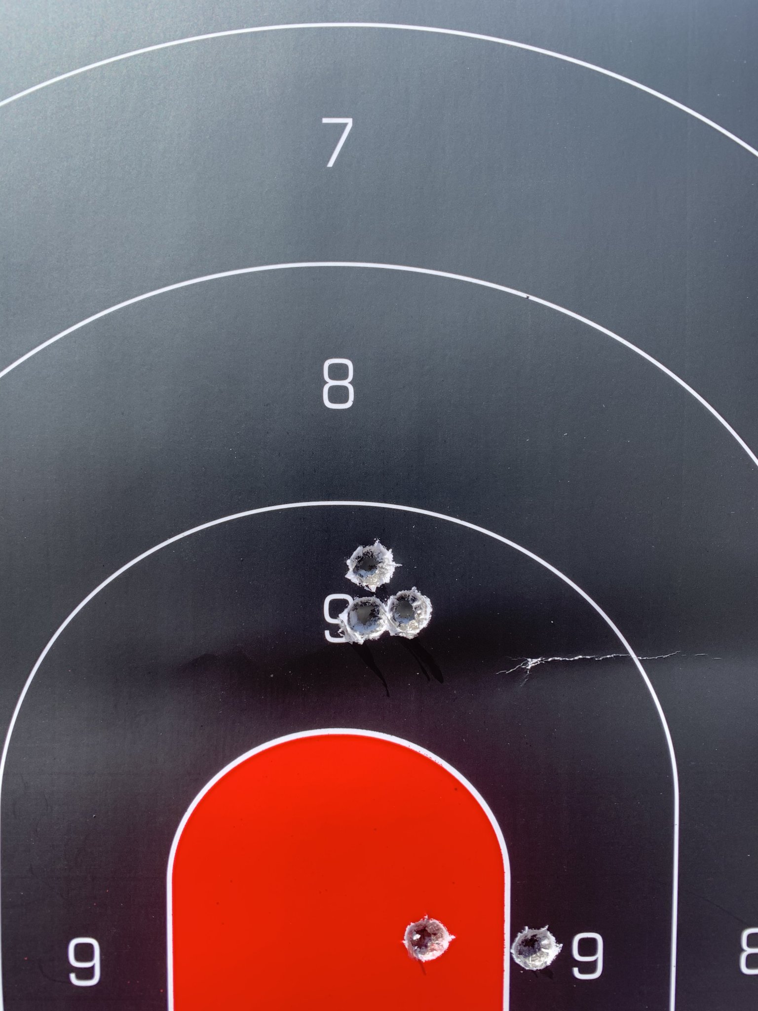

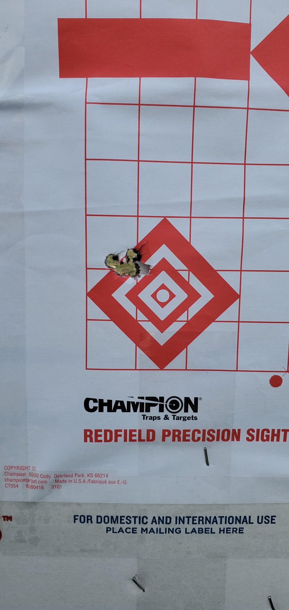

Sighters and first group with the new rifle. 75.5 gr rl26 and 215 berger about 20 thousandths off. Will probably load a range to find pressure next time, but for a first group and a dart at the wall group I’m happy

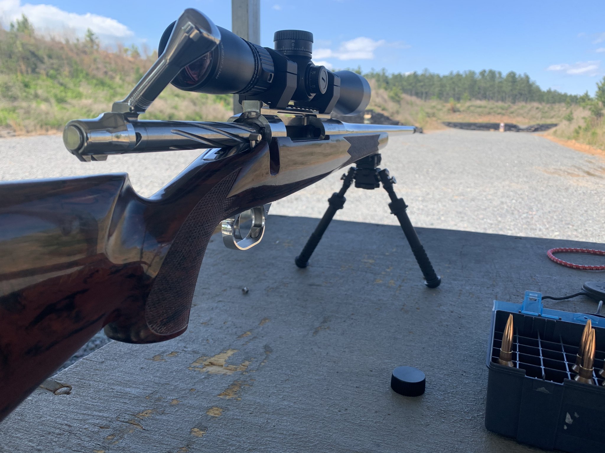

Got the new 300PRC broken in.

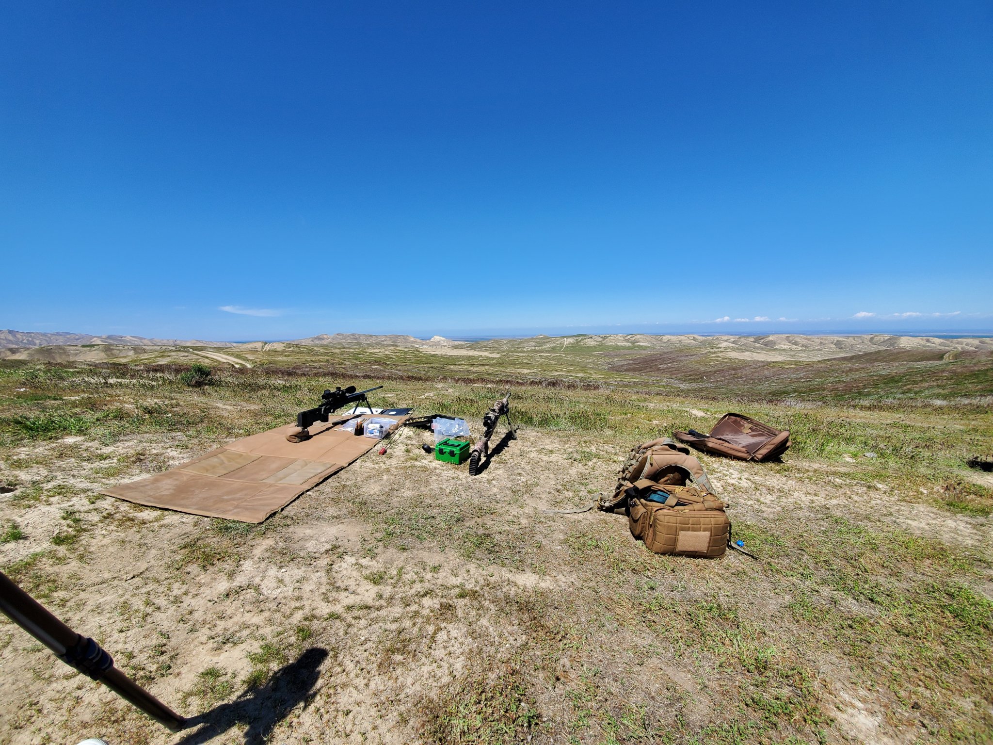

Maybe a couple feet max, but about 8-10 feet back. I set up the PhoneSkope on the spotter, hit the play button, then went to shoot. I've also got video of my shooting buddy and his 338. I was probably 10 feet left of him.
By the way, this was the first time I had once-fired ADG brass. Went with 73.4gr of RL 26 with 230 Bergers. Had a 2863 fps average over the 15 shots I measured. ES 16, SD 6. I think this load was a little warmer than I'd like - likely due to the increased temps where we were shooting. I'm probably going to drop down to 73.2 for the next batch.

Doing some load workup today in the AXMC quick in some 5 round test groups..
Best 5 round group was 76.6 gr of RL26 at the lands at .45 for 5 rounds. Started at 75 gr and went to 77.2 in .4 grain increments. This is new virgin PRC brass.. Mirage was really weird coming off the ground but this group was good enough for now. Seating the 215s at the lands. When I have more time ill work up some more 5 round test groups at 10 and 20 thou off and also shoot some of the ones that were over the .5 moa when I'm not in weird mirage. And use some once fired brass. No pressure at all even at the 77.2 but didn't shoot the best.
