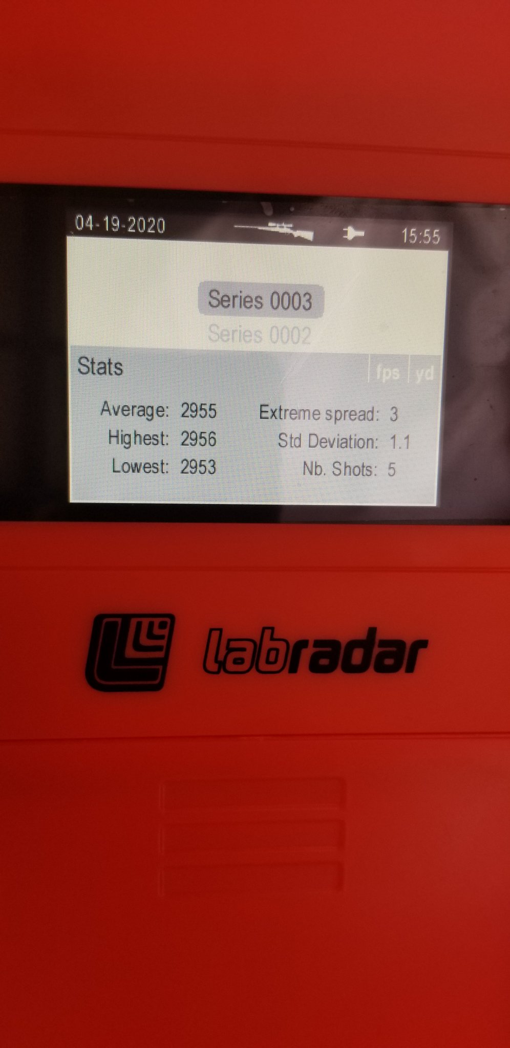

Ive never shot the 215s that far off. I'll give it a try next time. How many round groups are you shooting.
I tested 60, 70, 80, 90etc, no difference so im loading 70 off and not gonna worry about chasing
215 hybrid
Rl26
CCI250
215 hybrid
Rl26
CCI250
Yea not too worried about it. I'm usually in the high .3" to high .4" for 5 round groups right now with my final load and SDs in the mid to low single digits. Seated at the lands. Never tried anything more then 20 off in the last 3 rifles I worked up. But I guess taking a few of my already loaded up rounds and seat em deeper for a quick try never hurts.

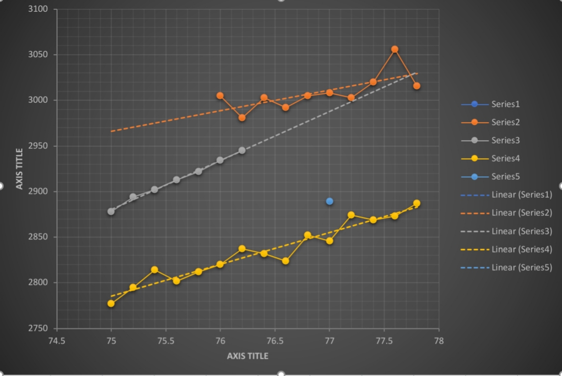

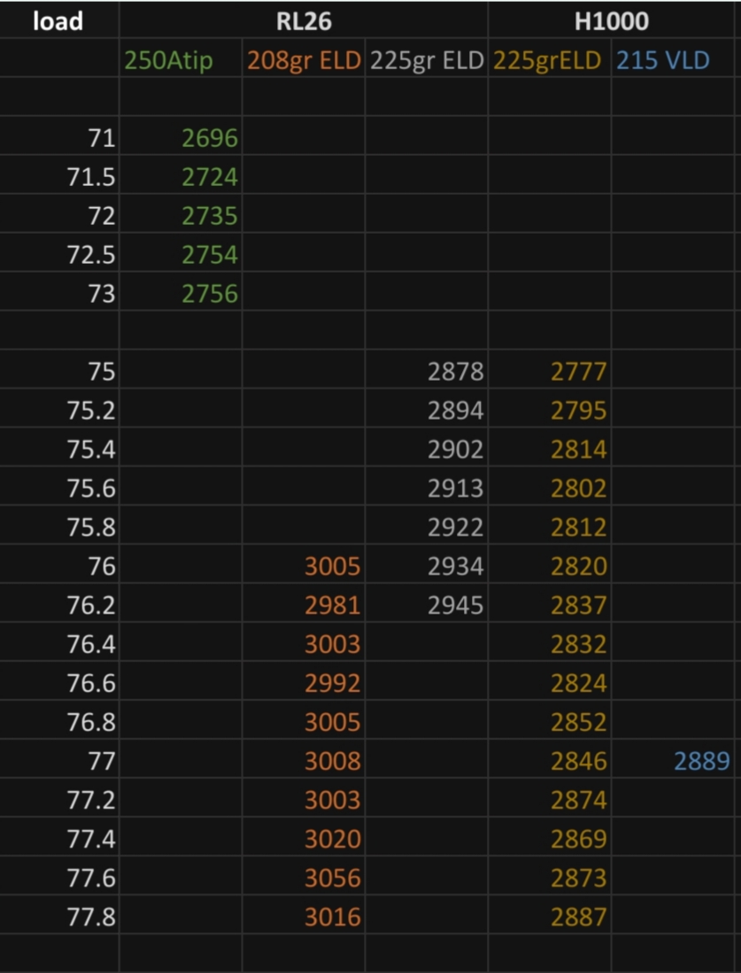

Finally got to shoot over a chrono. This is what I'm working with so far.
24" 9t
Nice results, looks like a nice flat spot with the 225 at 77.5 H1000. That gives me hope I can get to 2850 with the 215 HYB with a 22.5" bbl.
It might not be so bad. I wanted to load up a couple rounds to take some measurements and I was able to use my RCBS 308 seater with the bullet window and after measuring a couple pieces of ADG brass with bullets seated I got .337 which is perfect since I already have a .335 bushing. So two less things to buy.
Sounds like you'll have a nice rifle soon.
I don't see why not, I did run into some pressure signs with RL26/225ELD at 75.8gr as in more felt recoil, heavy bolt and ejector marks so I'll drop it down. I didn't hit pressure signs on anything else. The 208 ELD numbers are what impressed me and recoil was significantly less. I'll run a better test on the 215s next time.
