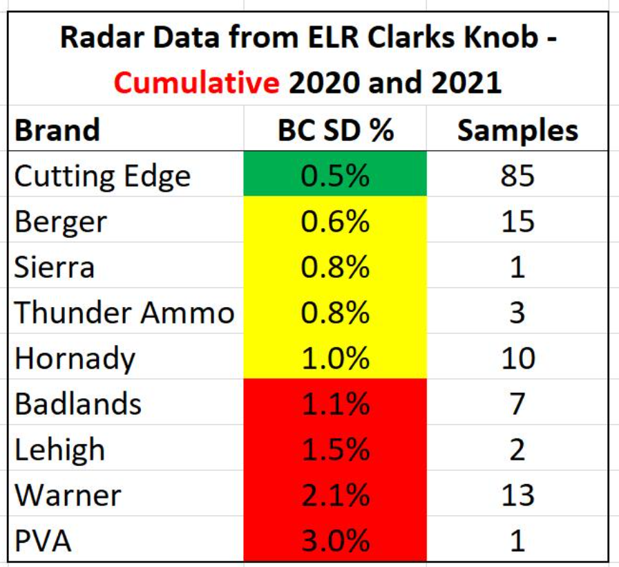

Litz posted a bunch of info from the Knobs creek ELR 2020 and 2021 matches, they radar-ed almost everyone's gun. Looks like only one PVA bullet made it into the testing, i thought it was more. But PVA (Josh), also designed the Warren tool solids I believe, and they were the bottom two in consistency. Litz has commented that no matter the twist rate they can't get the warren tool to be consistent.

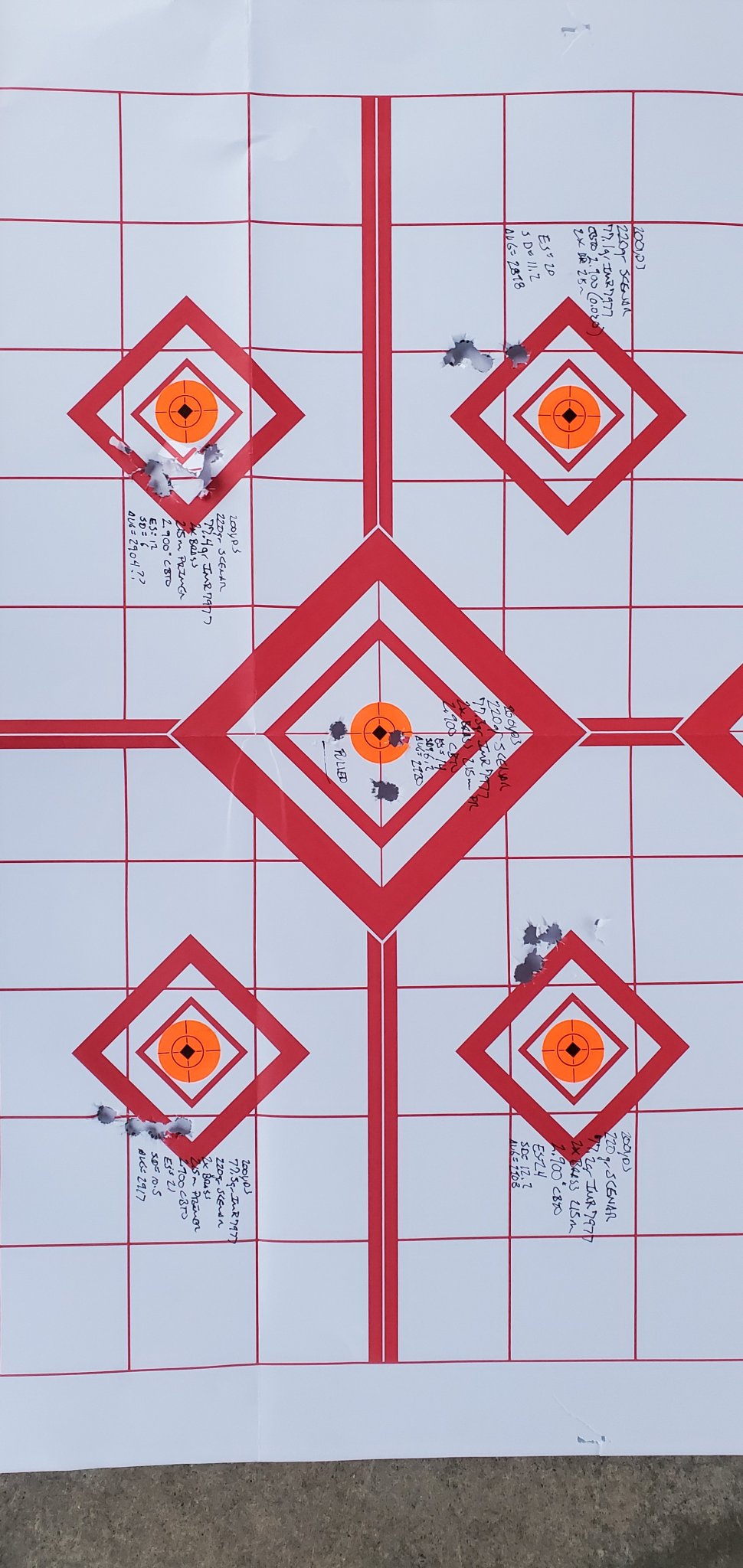

So, my ladder test struck me as a bit odd. The good news is that the last nine of the ten rounds were exactly the same POI. Less than .5 inches. The lowest charge was same windage, about 3/4 inch up. The weird news is that they were absolutely humming. I set the ladder to start around 2800 and go to 2950 or so according to QL and Gordons. The first round came out at 3009. This is with 215s. I shot 5 rounds, then loaded up 5 at lower charges to finish off. The lowest was still 2973. Only pressure signs are a tiny bit of primer flow back, but it is in an AXMC, so this is par for the course. I have a big flat spot at 2990, so I guess I will see what that looks like SD wise. These are definitely running hotter than I imagined. This ends up at 76.9 grains of RL26 with 215 hybrids.
Any comments or ideas please let me know.

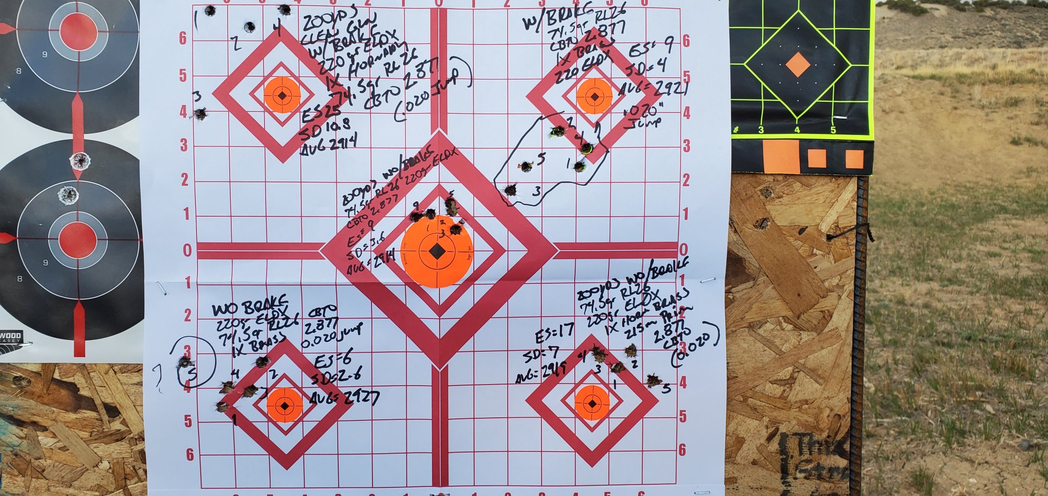

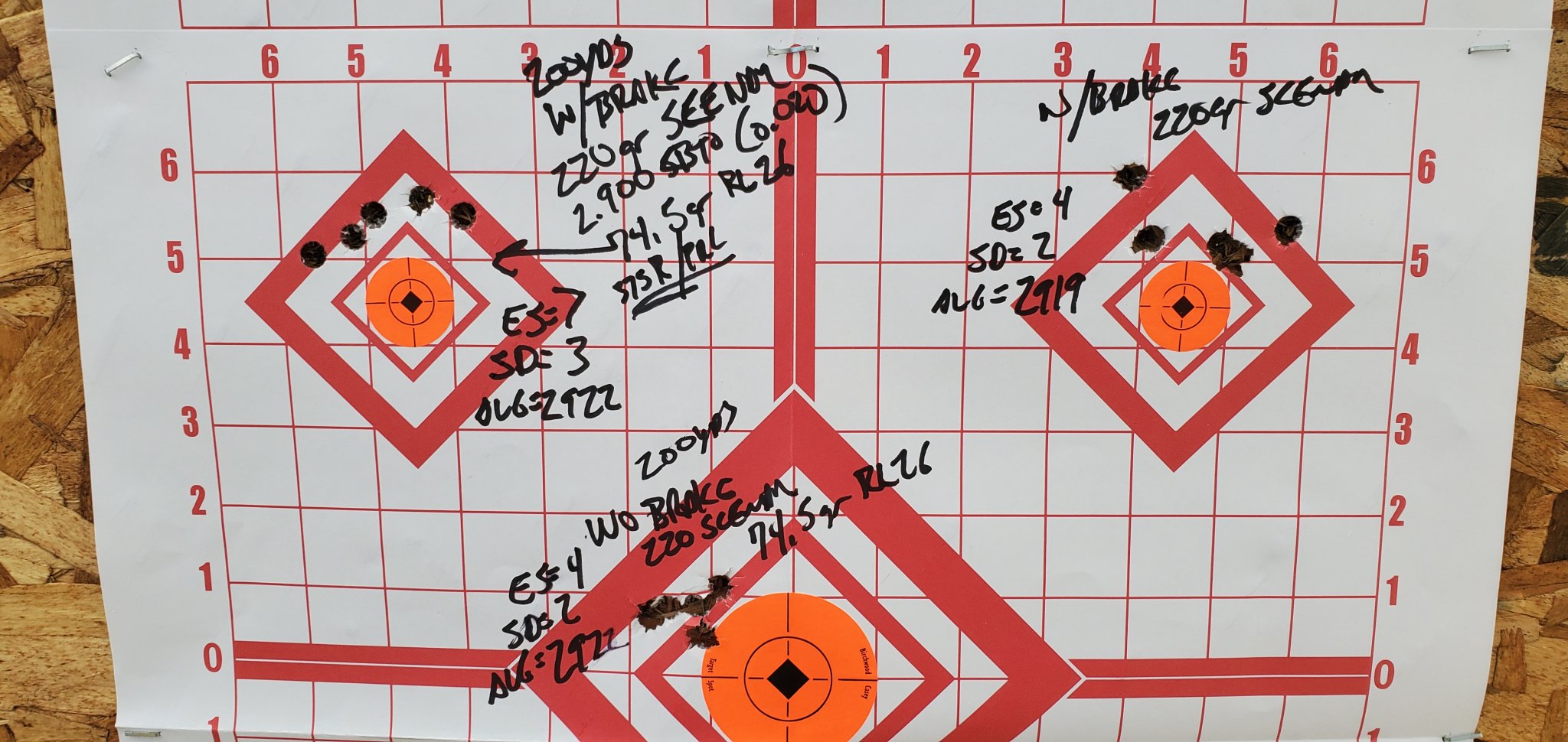

I've had quite a few issues come up with my 300PRC during load development. So starting out I had just under a 1 minute rifle which really pissed me off. Granted I was shooting factory ammo for the brass. So when I switched to load development I found my powder charges. I'm using H1000, RL26 and IMR7977. I'm down to a pound of RL26 now so am usingtheothers. I did my seating depth test. I was shooting at 200 yards and still couldn't get it to group worth a shit. If I was lucky to have a group under 1 minute. I tried multiple powders with multiple bullets and was racking up the round count with no answers. I've ran 220gr ELDX, 220gr MK's, 220gr scenars, 200gr ELDX and 225gr ELDM's. I was working with and talking to my smith during all of this and we were about to recrown or rechamber my barrel. I'm running a 28" 9 twist M24 SS proof barrel on an Archimedes action. I couldn't find anything wrong with the crown or chamber. I decided to try one more thing which was to pull the muzzle brake and see what it changed. I loaded up generic loads with.. 2x Hornady brass, 215m primers, 220gr ELDX with 0.020" jump pushed by 74.5gr RL26 and another with 220gr scenars 0.020" jump pushed by 74.5gr RL26.
The 220gr ELDX with the brake shot about 1.5moa and without shot 0.750moa. The 220gr scenars shot right at 1 minute with the muzzle brake and shot about 0.500moa without. All shot data was taken at 200 yards. Another thing to note is I was getting single digit ES and SD's. The concentricity was checked,, bullets and cases were weight sorted for the above rounds. See attached pictures.
220gr ELDX...edited from 225gr ELDM's
220gr scenars
I was surprised and relieved that I had found the issue. I purchased a Area 419 Sidewinder muzzle brake and I now have a shooter. My rifles only problem is now me. It shoots me 1/2moa consistently as long as I'm doing my part.
Here is some load workup with H1000 and 225gr ELDM's now
And with IMR7977 and 220gr scenars
All data taken at 200 yards. That is the furthest distance I was able to shoot at the range. It sucks that I put almost 400 rounds on the barrel before I looked at some obvious things. Next time I will start going through the rifle a bit sooner and use this experience as a training tool.

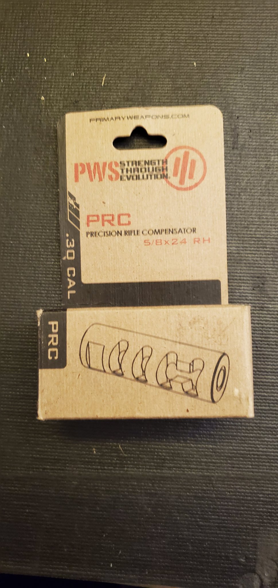

Here is the muzzle brake that I had on my rifle.
And the one on it now during load development.
Hope my post wasn't too long and helps someone else down the road. I've definitely learned a lot with my first build. Don't go cheap on anything!
220gr scenars
220gr scenars

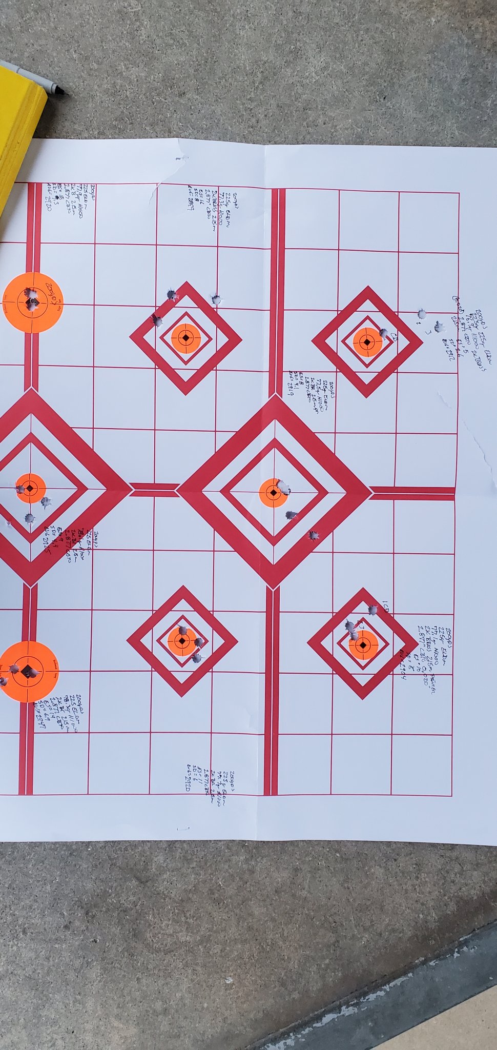

Just for an FYI...I did some load testing today...barrel was already fouled when I ran this test group. Brass is virgin Lapua...so that may be a factor...and I could probably dial in the group with seating depth testing and/or barrel tuner...but the differences in MV with ES and SD are just too far out of line with what I want to do with them...which is 1k paper. They failed in that regard...but I'll post the pics for your entertainment.
168gr Open Tip Match Bullets:
I could probably dial this group ^^^ in...a little shotgun-ish for me...the two in one hole looks good...but the horizontal is way out of line for me.
ES of 32 is WAY WAY too much for me. I can dial my 245 EOL Bergers down below an ES of 10....but yea...this is virgin Lapua brass....I may revisit tomorrow when I go back and do some more testing of other components. But to see a MV of over 3500 fps.....makes you think...but nope...these won't be accurate enough for the purpose I need them for.

Update from testing the 168 match bullets in the 300PRC. I added an entire grain of RL-26...and the speeds were much better on ES/SD...but just a tad faster....average was 3520fps. ES was 27 across 15 shots. This was on non-virgin Lapua.....groups were barely under and inch though....3 5shot groups...and they weren't very pretty.
