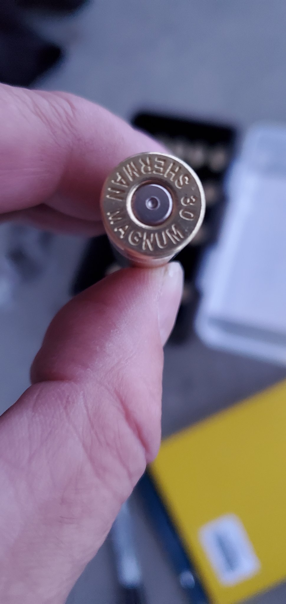

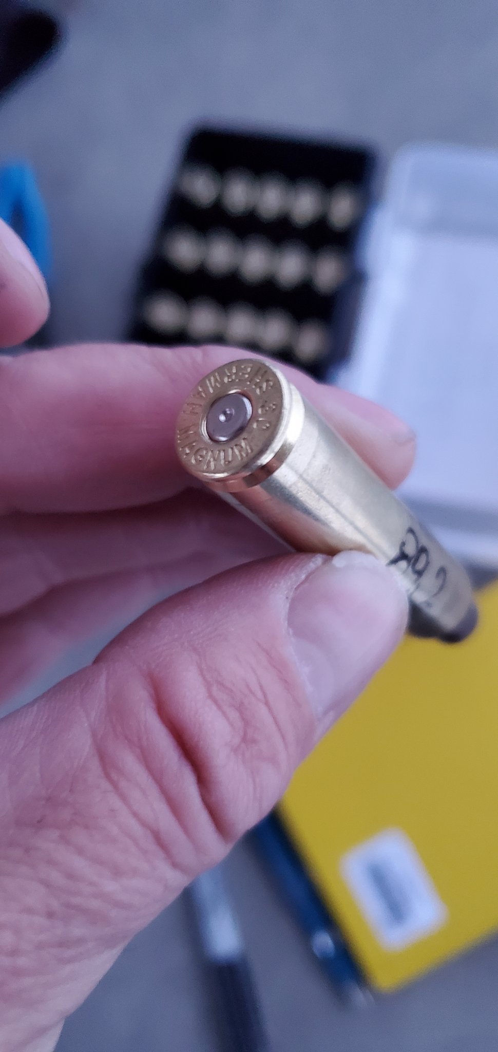

With some hand files and a LOT of elbow grease, you can remove enough material from the Inside of the magazine to accommodate the Hornady 212 gr ELD-X loaded to the factory 3.650” C.O.L.
Just used a flat file on the rear and a very small round to essentially cut a channel for the tip.
Was able to load all 5 rounds and cycle with no feeding issues
The mag has not lost any integrity

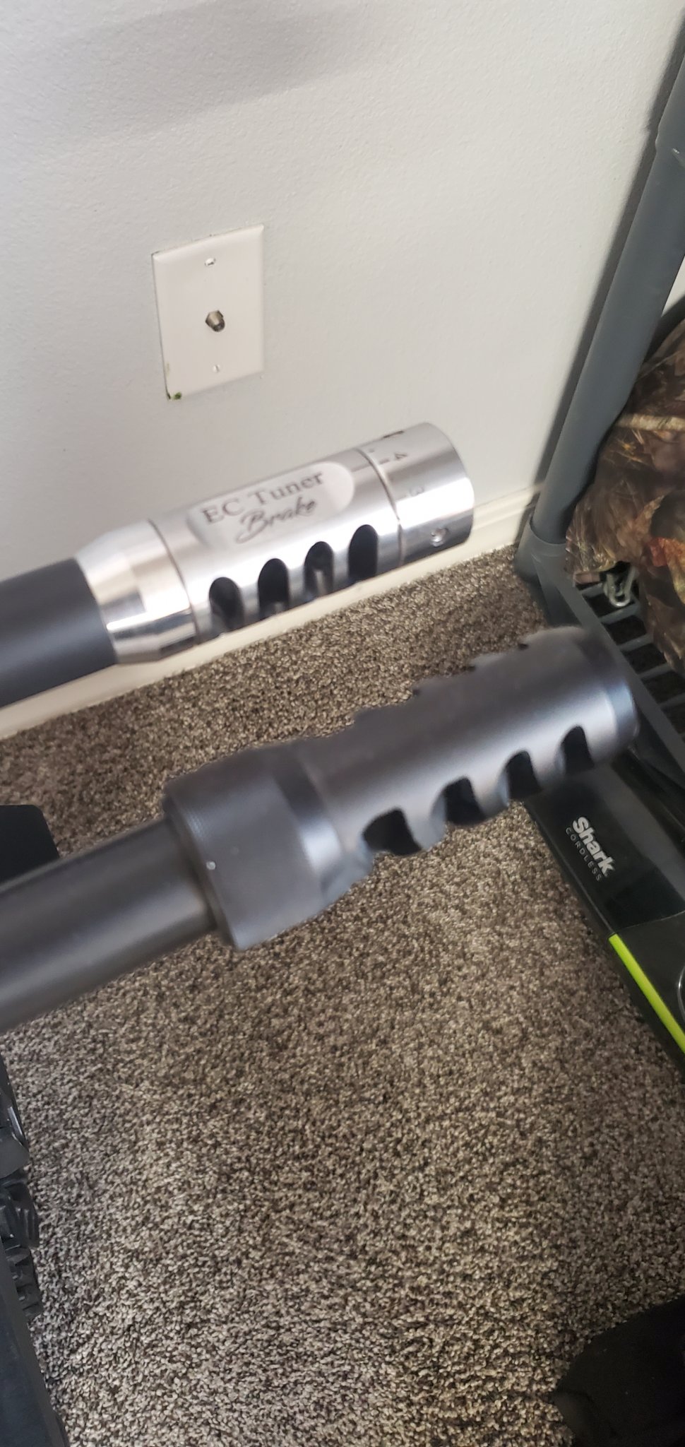

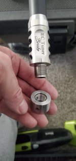

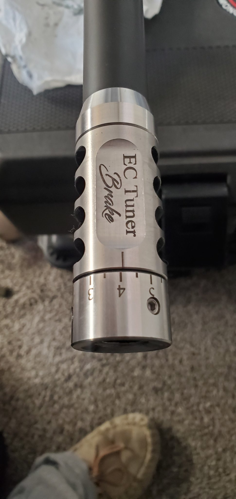

Ec tuner brake on my 30SM. 300PRC Ackley improved.. pics show the size next to an area 419 Sidewinder muzzle brake and how the tuner end comes apart and works. Great piece of kit.

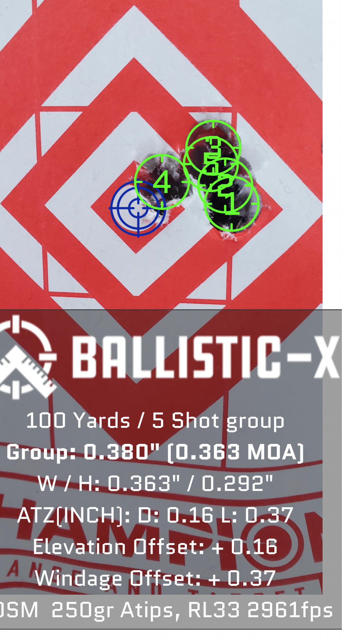

One load is 77.8gr RL26 @3020fps and the other is with I believe 84.3gr RL33 @3028fps. Both running 225gr ELDM'S with 0.035" jump, ADG brass, Federal 215m primers. Both have reasonable ES around 15 and SD numbers in the low single digits.
After shooting a match this past weekend and talking to a few accomplished shooters I am going to shoot out to 1k on paper and measure my vertical. I think it will help me to figure out if I need to make load adjustments or not.
I am going to check my data book and verify my exact loads. I believe I might be off on my RL33 load description.
