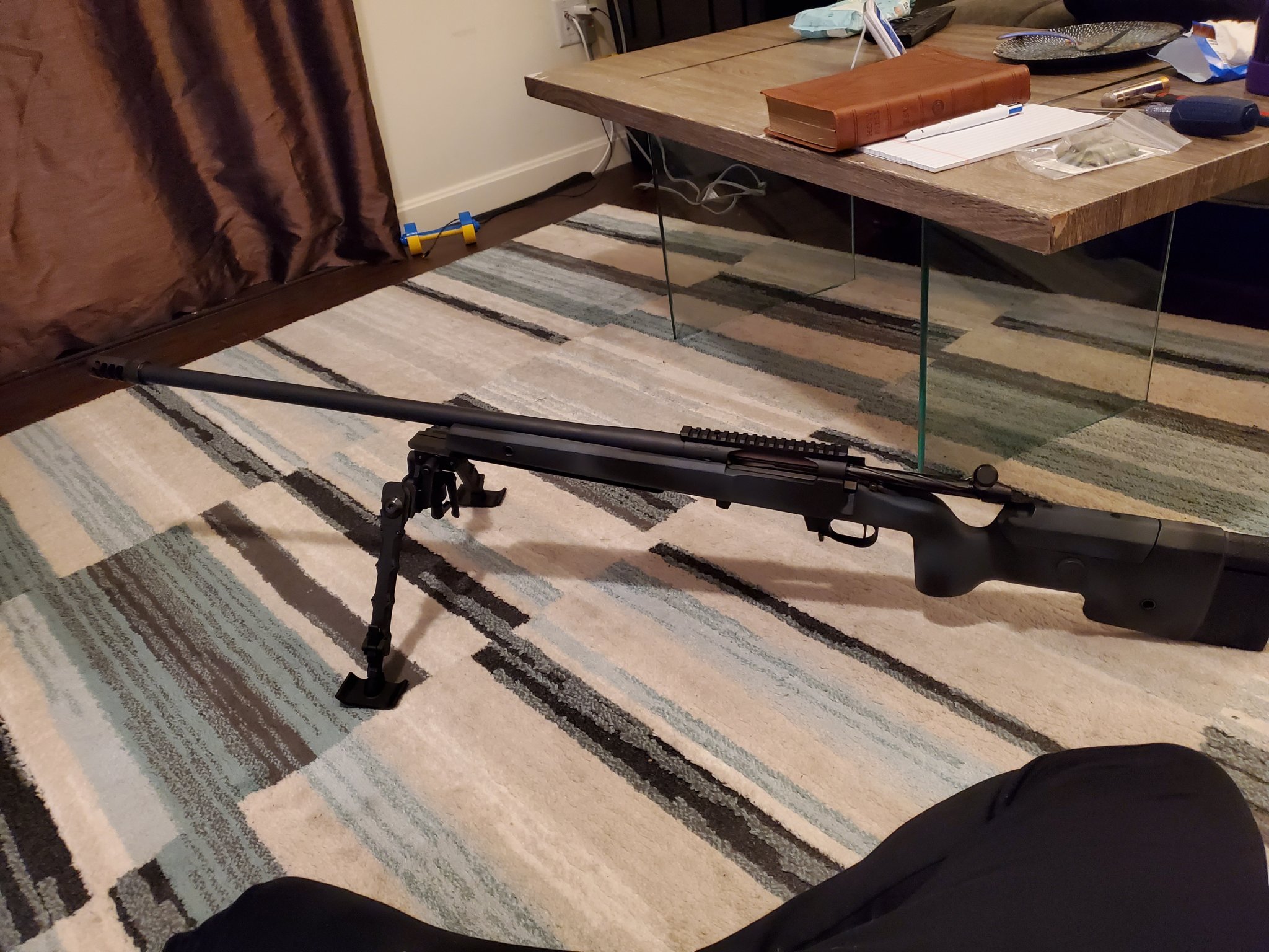

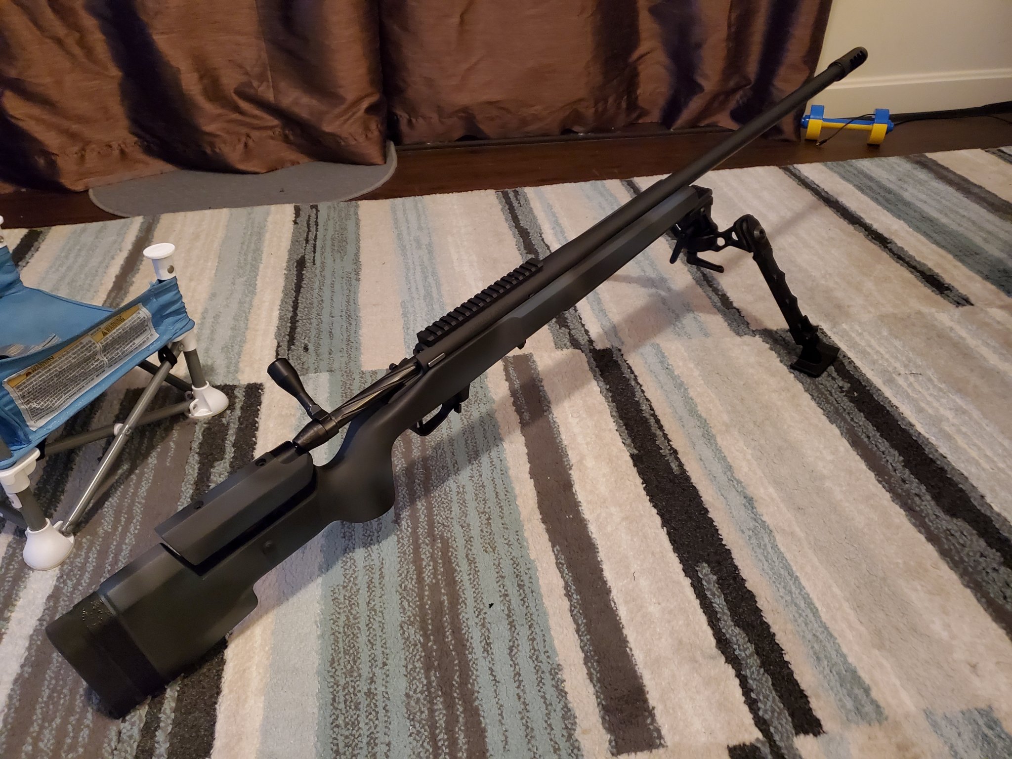

Finally got this beast put together. Will be reporting how LD goes with LRT and 7828ssc and 230gr atips in the Bartlein 1:8 @ 28"

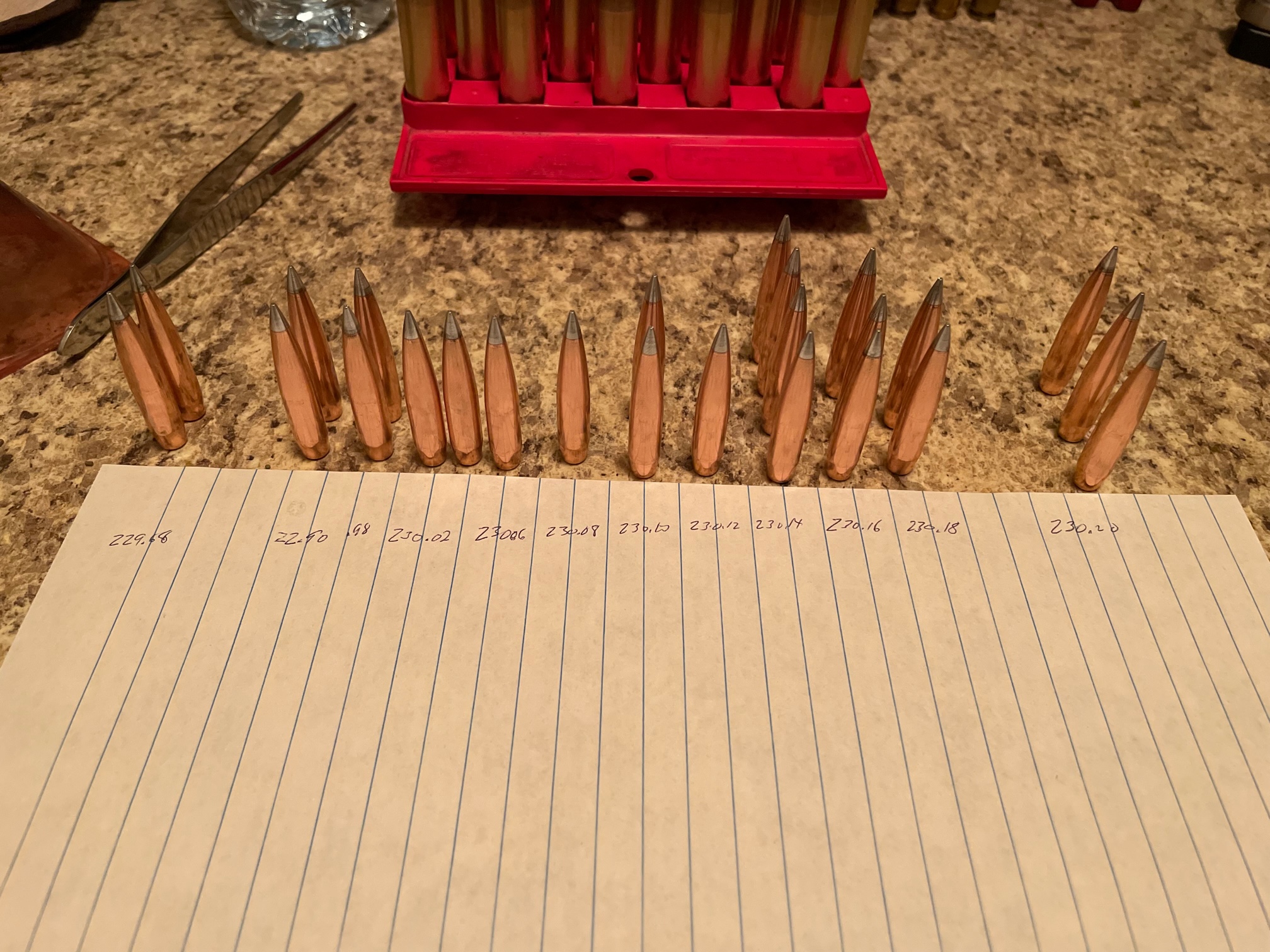

So I got curious tonight and weighed some bullets.... I was surprised by the weight spread I found on just 25 230 atips. Wondering if this spread in bullet weight might be a variable that I'm fighting?
I found a .52gr spread from high to low and weights pretty across the board.
That’s less than 0.5%. And bullet weight variations are self compensating to an extent because BC and velocity are inversely correlated. Applied Ballistics did a ton of testing and found weight sorting was a waste of time.
