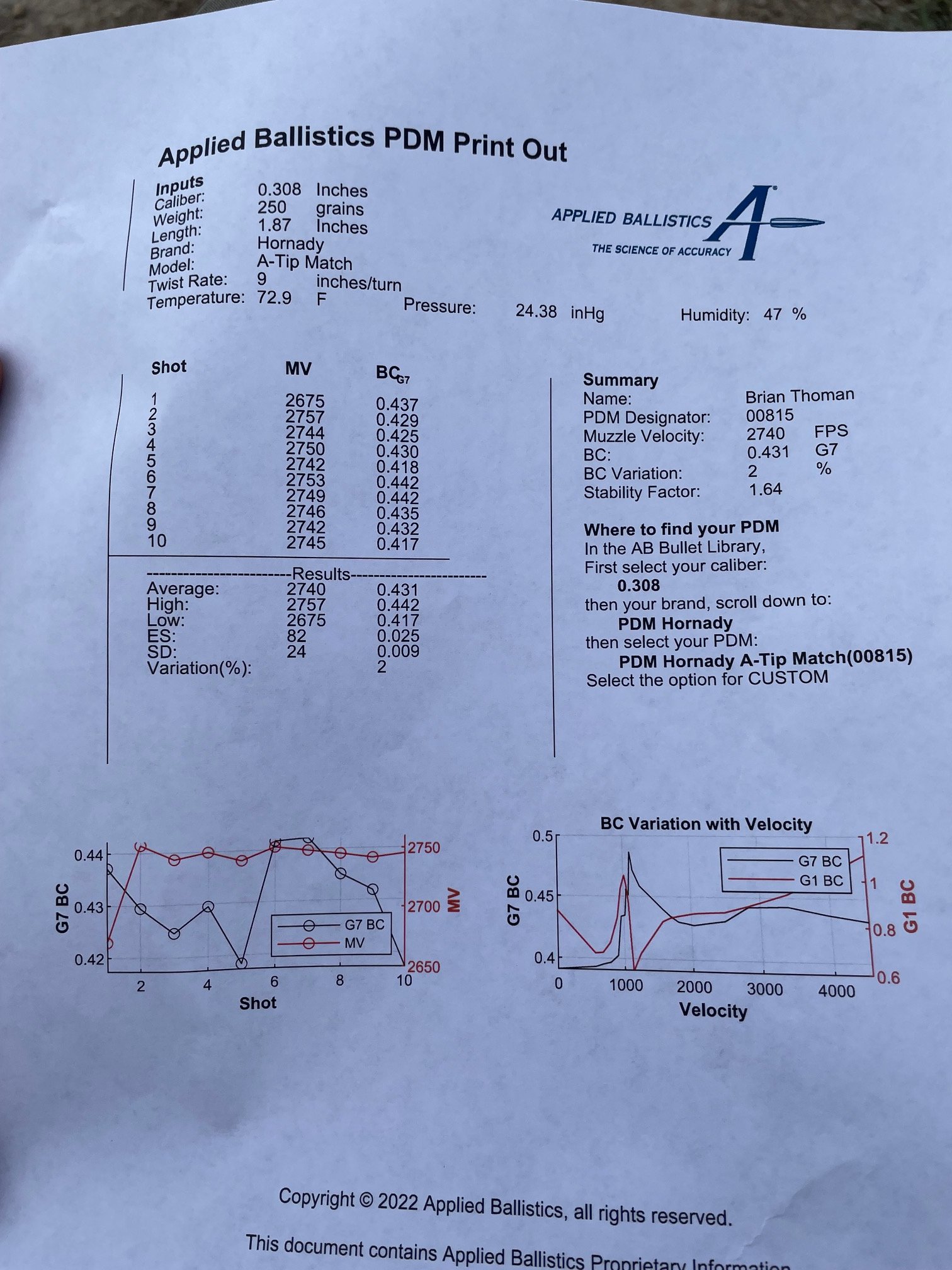

I ran the 300 PRC with 250 a-tips around 2724 at the NF ELR as well. Here's the AB output. I had to reduce the velocity to 2724 after the first four stages. Once I adjusted waterline was good. I'd removed the first shot velocity and recalculated. That was a clean barrel. We had a few folks' that looked like that and it was due to a clean barrel. This is 76.5 grains N570.
Incidentally, I ran this load over my Oehler 89 back in September and had much better BC SD and a higher BC. Something definitely changed. I was shooting 1.5" groups at sight-in when it had been .6" last fall.
That 250 a-tip bc is all over the place I'm pretty shocked at those numbers.

For the atips I would of expected 1% not 2%. It would be cool to see if the bergers are in the 1% or less as they claim. Either way @parshal still Held it down and shot really well overall at the match with his set up.

granted he shot a 9 twist but the BC was much lower than advertised and would have questionable stability at sea level
Fair points, makes sense I ran the 230s in an 1:8 and when I trued up my BC I went up to .425 from .414 to get it to line up and there were a few stages at 1400 and beyond I was still a couple tenths over the top of the targets.

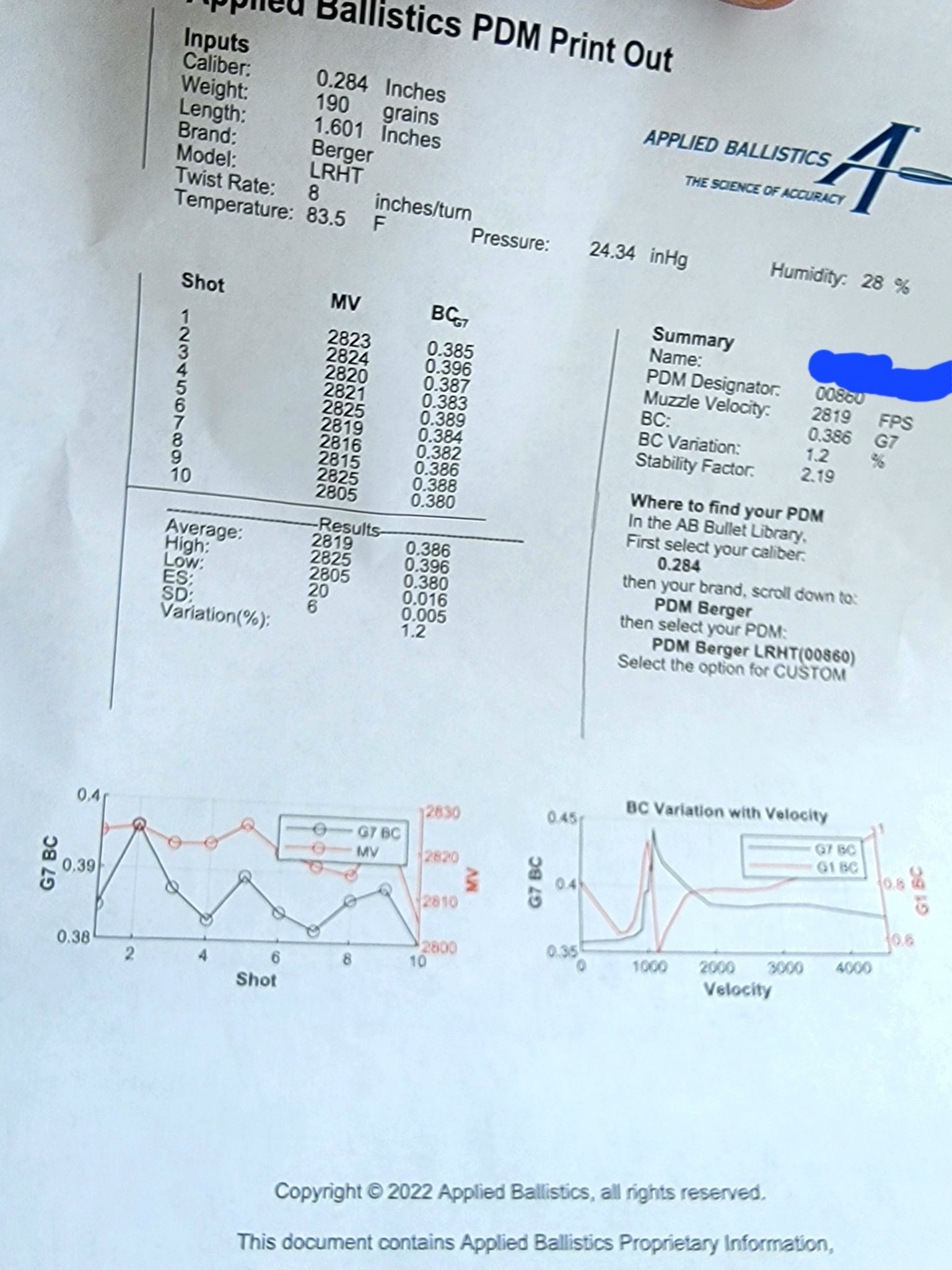

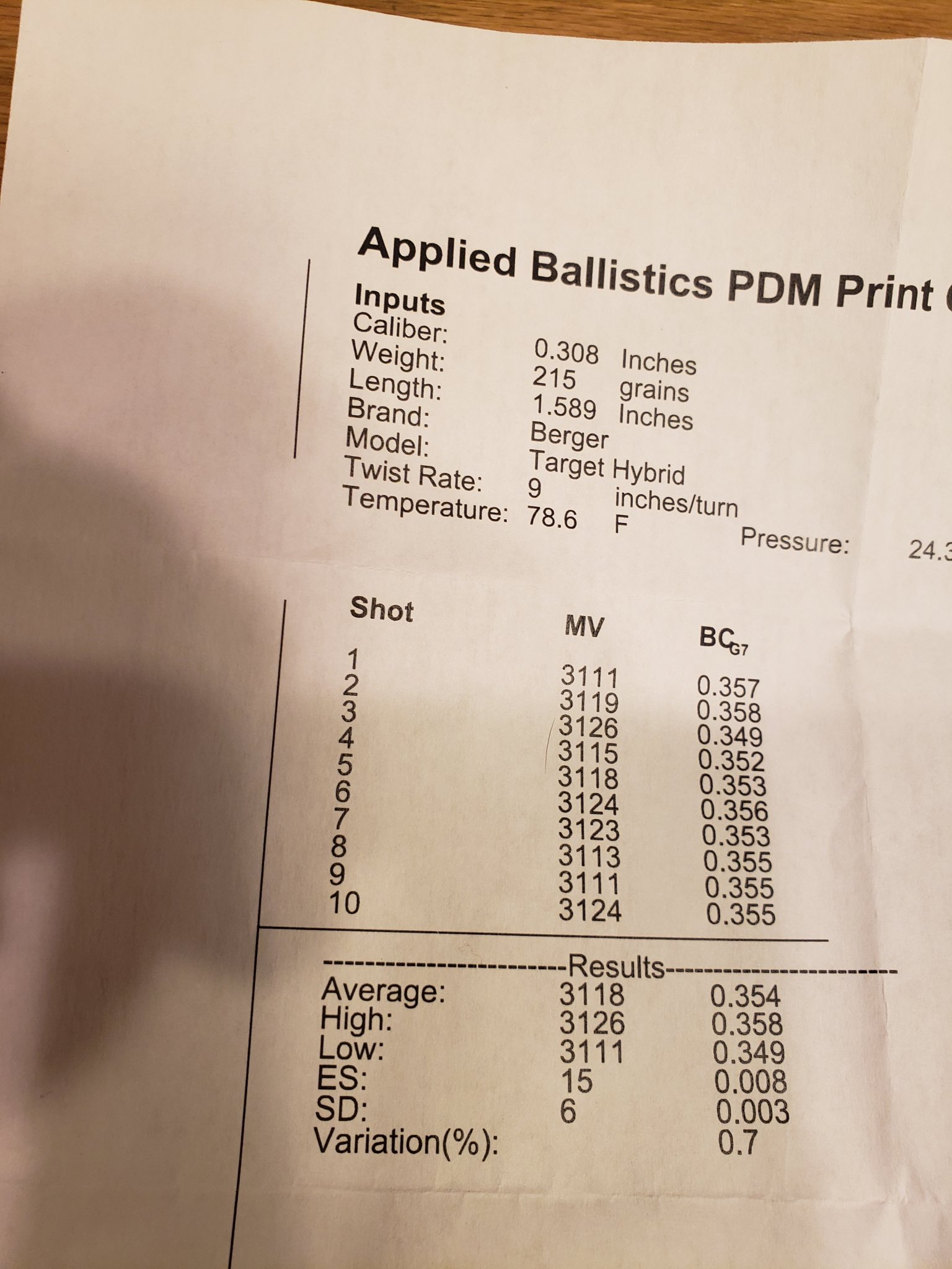

What's interesting is the 215 Berger has less variation than the 190 LRHT, which was designed to minimize BC variation. Obviously a very small sample size but still noteworthy.

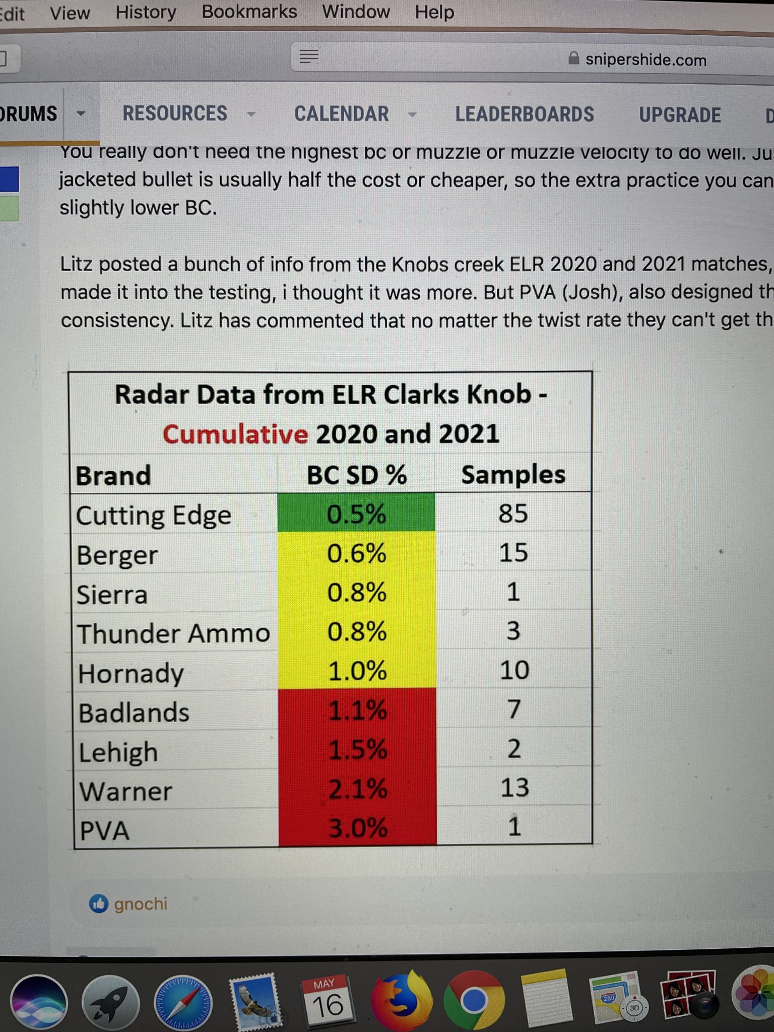

You have to remember that each gun shoots each bullet differently. It may have an SD of .8 in one gun a 1.3 in the next gun.
I'd love to see all the data gathered at each match for each bullet. I'd really like to see how many guns each bullet was run in and which was the most consistent across all those guns.
