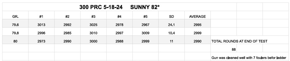

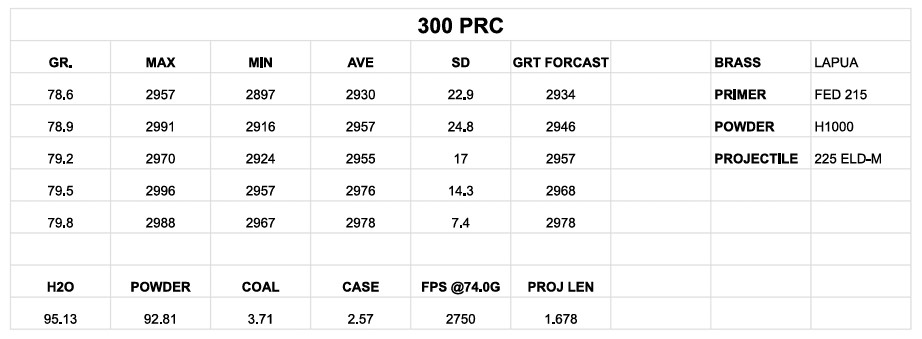

Here is my work up from Monday. I'm kicking myself for not loading 80.1gr. Would have been right at the pressure limit per GRT but might have been good SD too. This barrel only had 40 rounds on it when I started, so definitely some break in fluctuation to be expected along with large swings.
This was 6 rounds of each load. I attribute the abnormalities to new barrel. we will see as I surpass the 150-round mark.
Re tested each side of the 79.8 and that might be the go to point for right now as the barrel breaks in. Moving pretty fast and I like it. 1 round in the 80.0 group has a little extra lift required, but nothing else looked or felt off.

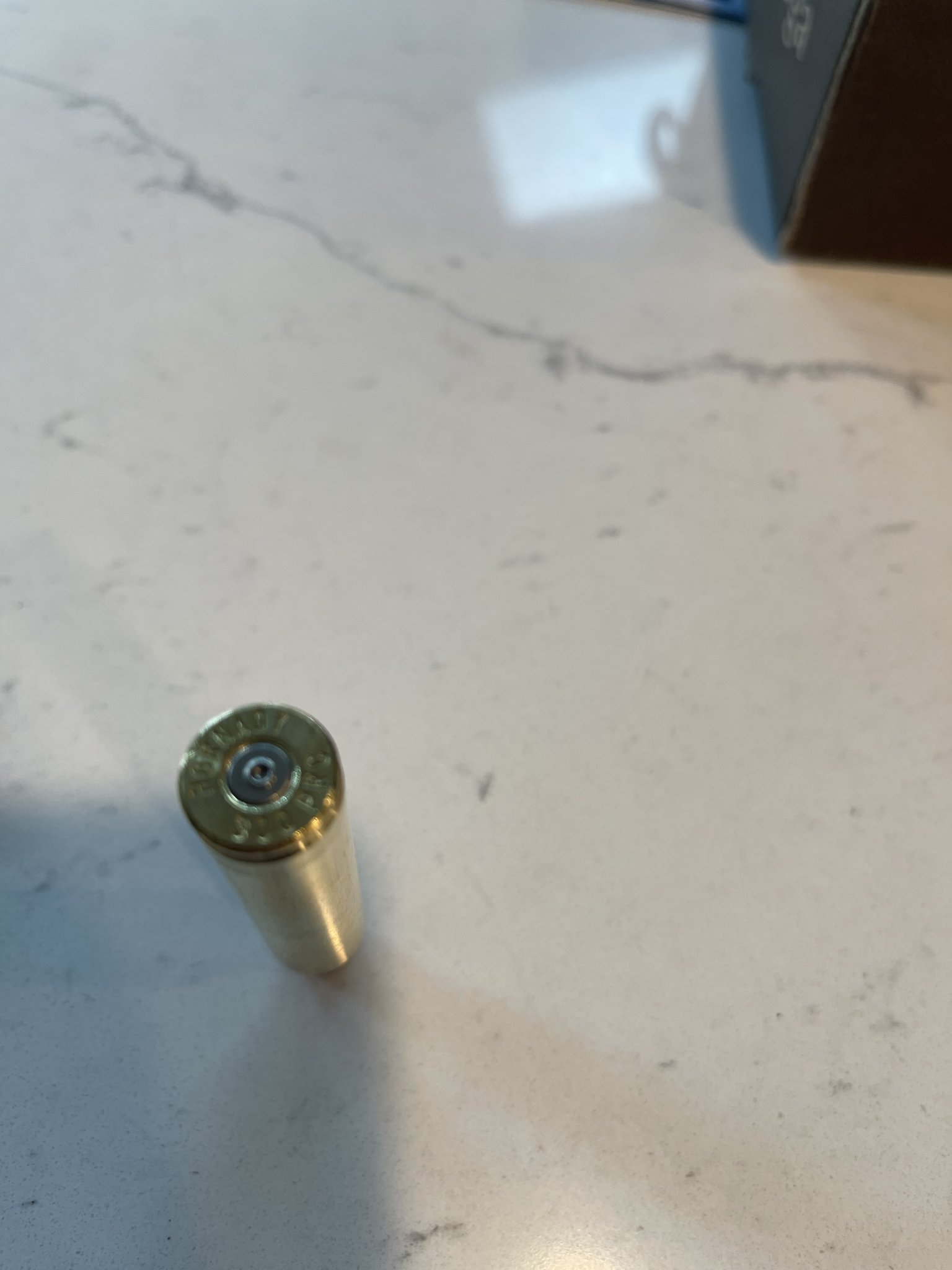

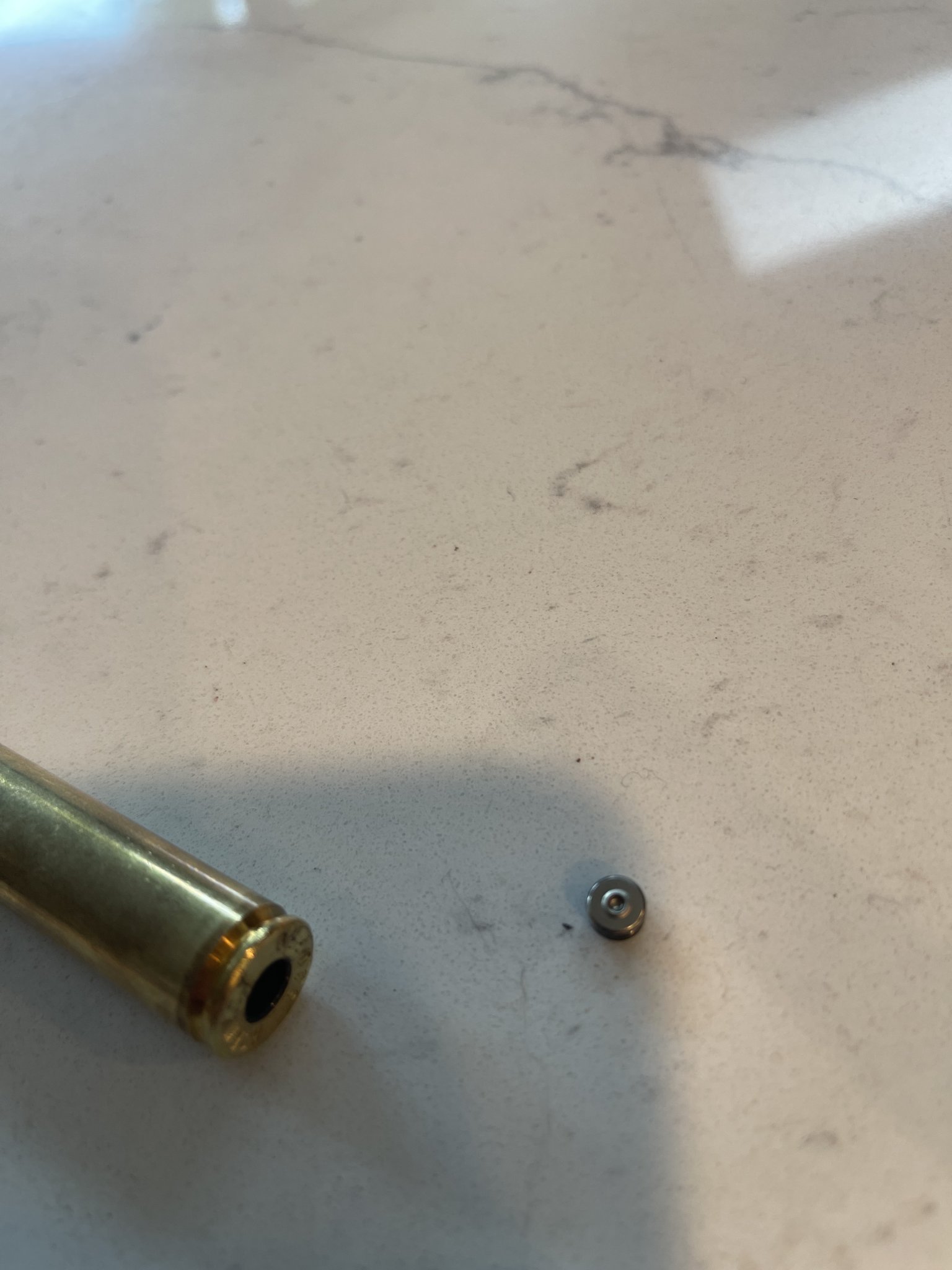

Hey guys, need some pro advice. I just got a new barrel for the SRS A1. Breaking it in and cleaning every round as usual.
Little hiccup. It’s blowing primers out of factory Hornady ammo. And I mean BLOWING them out. Massive cratering and piercing. Some primers were stuck in the bolt, some would fly out when spent shell was ejected. I shot 1 suppressed and it seemed fine. Started the cleaning process and didn’t want to fiddle with the suppressor every round, so I shot 5 unsupressed.
Those are the 5 that were blowing like crazy and had massive bolt lift etc.
Any ideas on this? Any insight you may have is much appreciated.
Ive never had a barrel do this before with factory ammo. Barrel was cut with a Manson reamer. I contacted the barrel maker and asked for more detailed specs. Waiting on a response. Here are 2 fired brass.

Got a response from the barrel maker.
“It is a K&P cut rifled barrel. The chamber is also a SAAMI speck chamber.
There is no reason for the blown primers other than ammo. Shooting with a suppressor will actually cause slightly more pressure. So it should be worse with that.”
How could factory ammo be THAT high pressure? Should I contact Hornady and ask about this batch? I bought 400 rounds

Hold the phone for a second.... It could have nothing to do with the ammo.
You need to know to the 4th decimal place what the barrels bore and groove sizes are made to! If it's a tight bore/tight groove at all that can easily drive up pressures and blow primers.
The OP might want to consider calling K&P and sending the barrel back to have the bore and groove size rechecked.
Also you don't know how many barrels that chamber reamer has done. If the throat is cutting undersize that will cause issues also.
You could have both of those things going on and compounding the problem.
A barrel with a bore and groove size just a .0005" undersize will drive up pressures about 10k psi.
Having a throat area of the chamber even just .0001" to .0002" undersize and bullets at max tolerance.... that drives up pressures about another 6k psi.
If both of those things are going on.... you take a 65K psi round and add another 16k to it... now your in the 80k psi range.

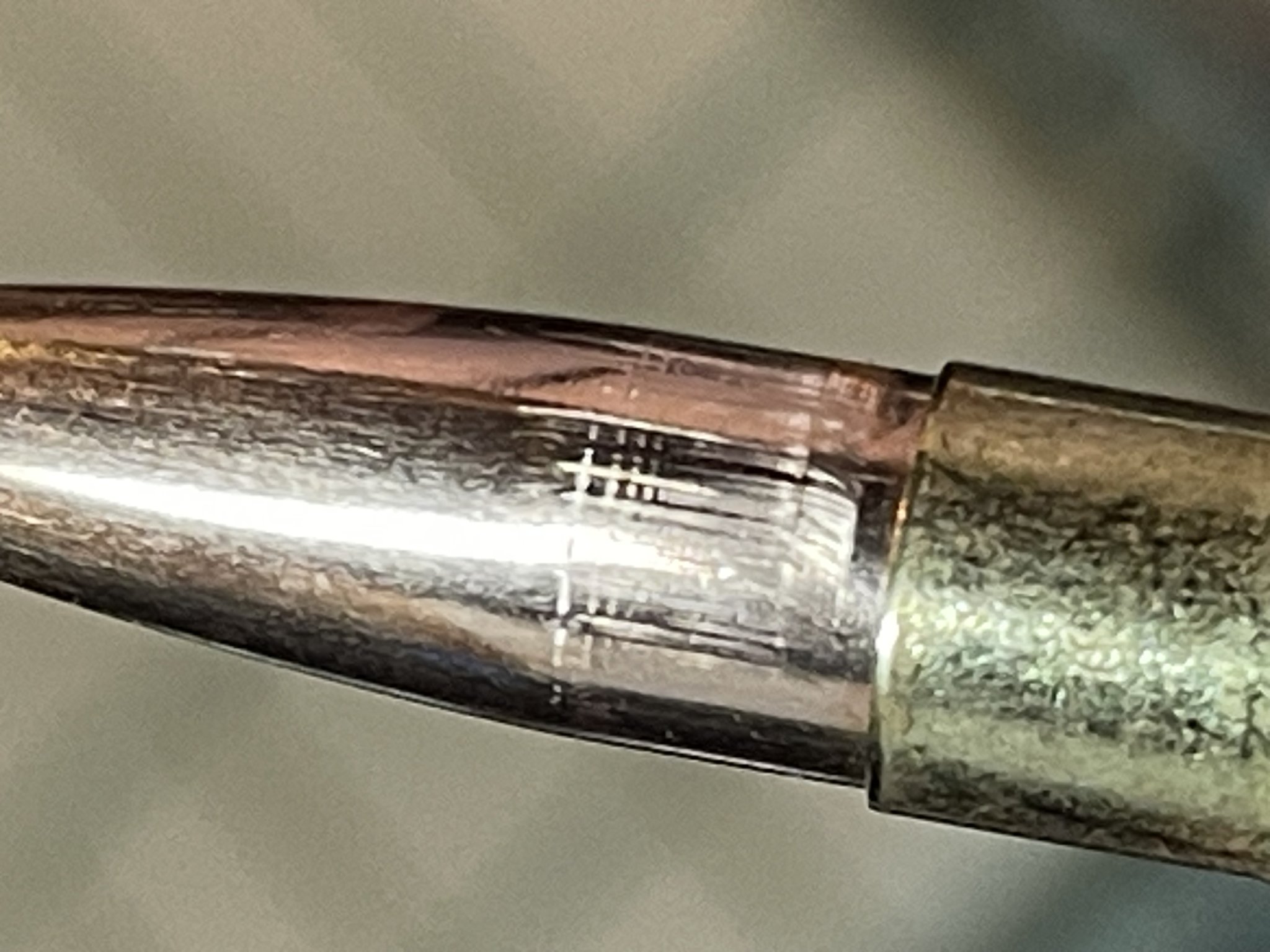

Factory Hornady 225 ammo.
What is the BTO measurement on one of the factory Hornady rounds, that has not been chambered?...
What's the BTO measurement of the Hornady round that was chambered?
What are you guys normally seeing for BTO measurements for a SAAMI chambered in 300 PRC...while reloading for the 225 ELD?
I only weigh and measure factory ammo, but I’ve stopped measuring Hdy 225 as every single one I’ve measured has been 3.65 on the button. Weight, that’s a different story lol
The chambered round still measures 3.65, so it didn’t pull the bullet. That’s how tight barreling in the barrel is that it caused that much damage to the bullet.
The minor measurement was less than .2995!!! Probably .2993, we just didn’t have a pilot that size. Imagine the pressure this added for all 28” being 7/thousandths too small!!!!
BOOOOOM!!!
