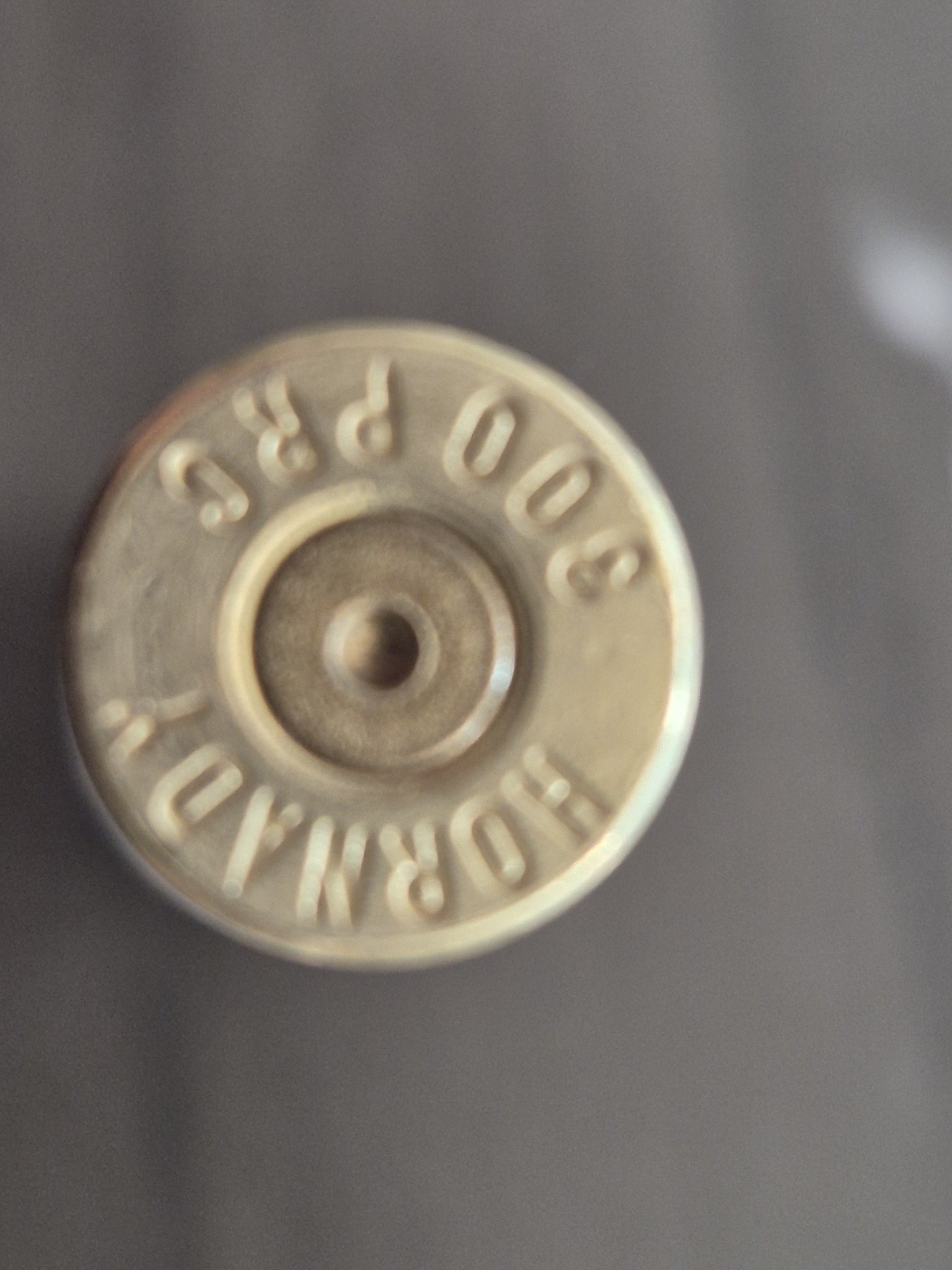

If you get "clickers" when opening your bolt, the sammi chamber is too tight. The Alex Wheeler 2 "AW2" reamer opens the back of your chamber a couple of thousands of an inch. This is to give more clearance for extraction.

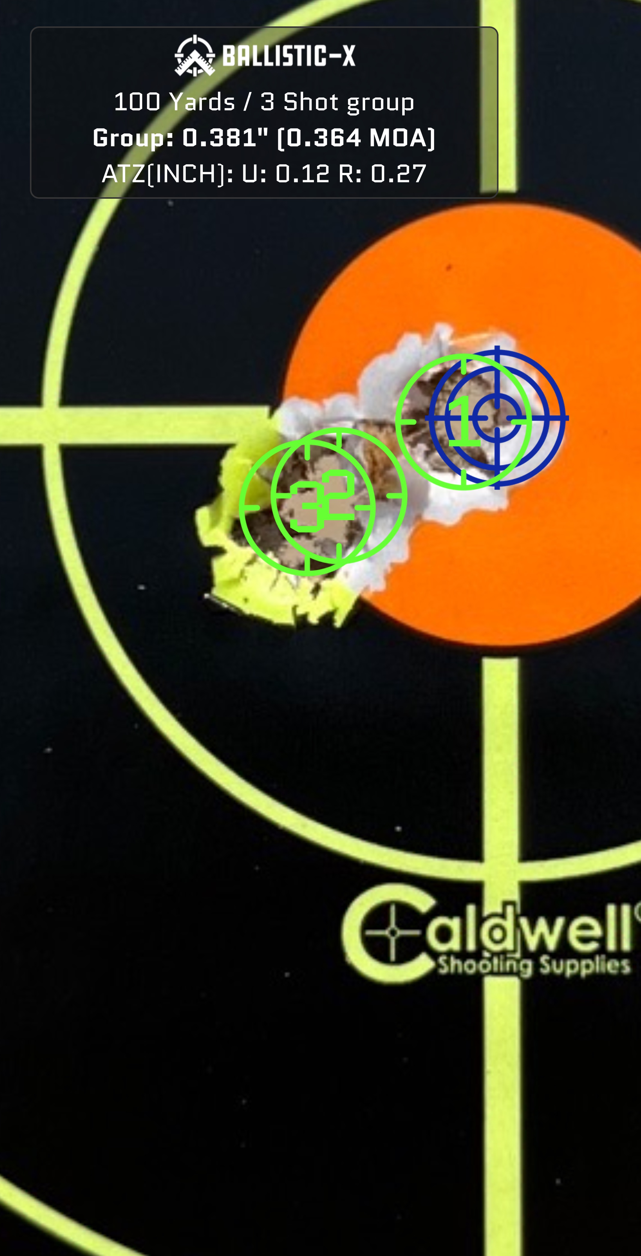

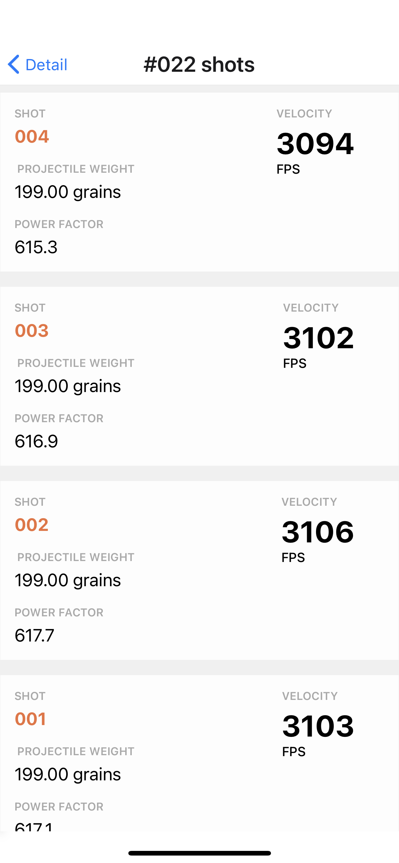

Did a velocity ladder test today, 75.6, 75.8, 76 and 76.2 was all within FPS!!!!! The second charge was 5fps slower, the other 3 charges was exactly the same speed! Ran the test all the way to 77.6gr and only then ran into a very faint ejector mark, primer still looked fine and bolt opened like everything else.
Zero pressure signs, touching the lands so I'm going to run 76gr and never look back!

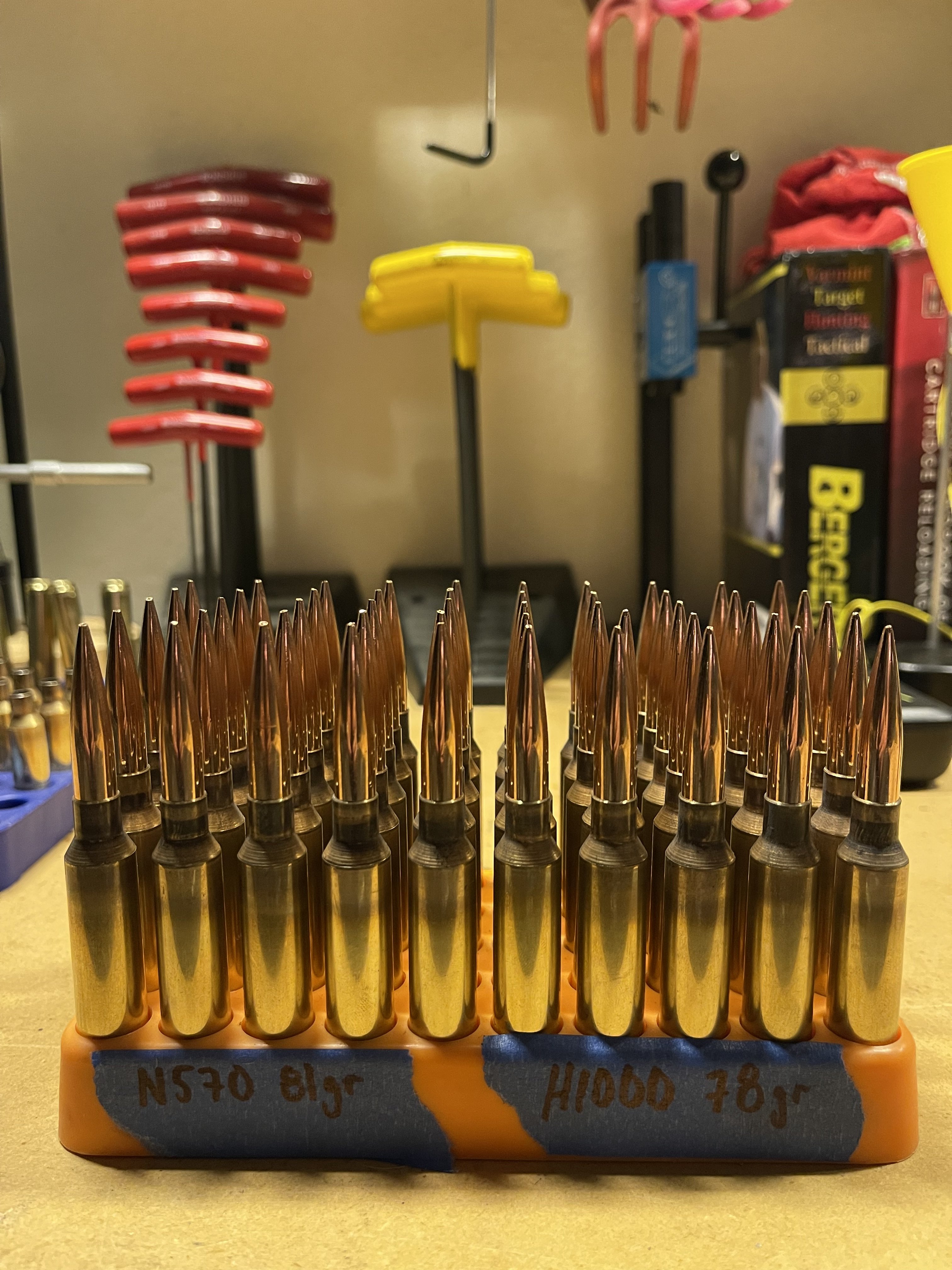

Hey everyone, I have an awesome load worked up for my 300prc, but its with H1000. I'm thinking of changing powder since I only have 2.5lbs of H1000 left. Main reason is, it seems to be easier to get Vihtavuori here in Canada, also its cheaper as well with H1000 at $100/ lb now. I started stock piling N570 for my 338 edge, other forums show great success with N570 in 300prc. N570, if I remember right is $160/ 2.2lbs.
Has anyone else found N570 a good powder for 300prc with 225gr eldm, or similar bullets? What main Vihtavuori powders are you guys using for 300prc?
