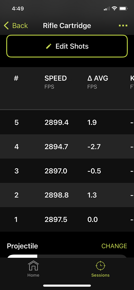

Testing a reduced powder charge today. I wasn't seeing any signs of overpressure, but 2953 fps seemed like it was probably too hot even for a 30" barrel - definitely not good for barrel life. I'll need to do further testing to verify, but 76.0 grains of H1000 looks promising!
The 2953fps load you mention, is that the 230Atip w/H1000 load you mentioned/posted a few months ago? That 30" barrel probably really helps with getting that velocity without being too hard on barrel, IMO.
I'm running the 230Atip @2940 using N565 out of 28" barrel. Probably max where I'm at but shoots well.
Yes 230 gr ATips over 77.1 gr of H1000. Frank had mentioned that my load might be too hot so I'm going to see what happens if I go with a bit less powder.

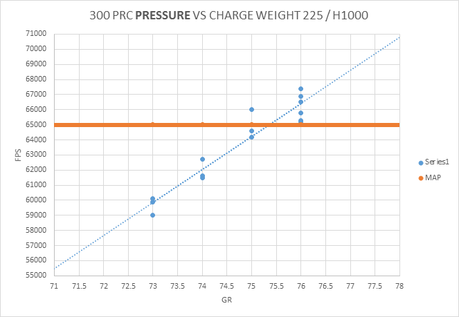

Your at max for sure. Are you over? Maybe maybe not.
My ammo in a pressure test barrel.... when I went to I think it was 76gr.... was right at or just over the max limit. I did shoot like 10 rounds prior to that at 78gr of H1000. Stupid accurate and no tell tale signs of pressure at all. Bolt lift etc... all ran like normal but after finding out what my loads where running at... I backed it off to 76 and running it there. Still stupid accurate.
The Hornady manual is showing a max load at 77.5.
Why did my ammo at 76 load go over by 5k psi? Different lot of powder, different primers, different lot of bullets, brass etc... all of these variables make a difference. Here is a pic of one of the data sheets....
