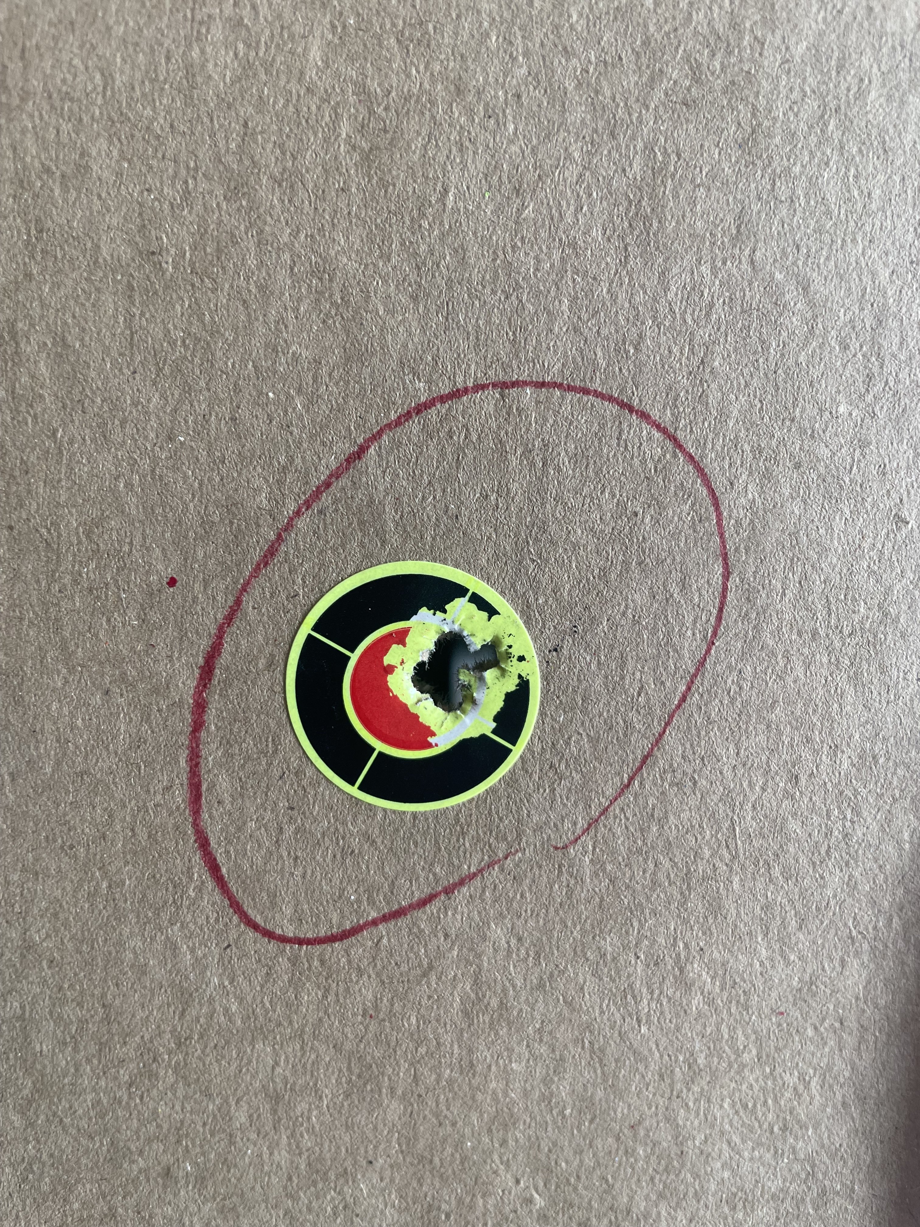

Haven’t done a formal one to date. All previous testing was basic.
Ex: get dope from kestrel, chrono shots, see what groupings look like and make the call if X ammo is better then Y in similar conditions.
Never felt the need to write a formal test report because I always thought my barrel was the item holding me back. This whole tuner subject has me wanting to do something more definitive. Environmental conditions are going to be my biggest variable.

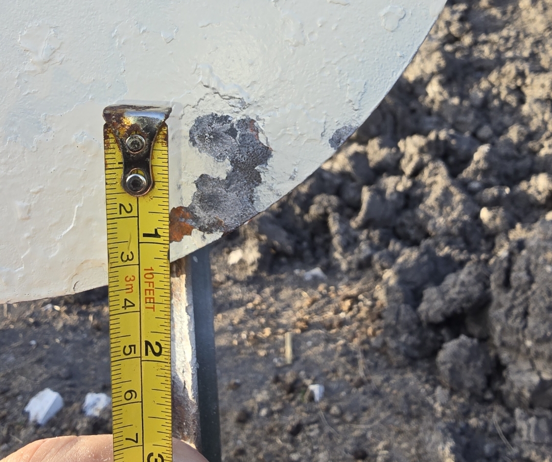

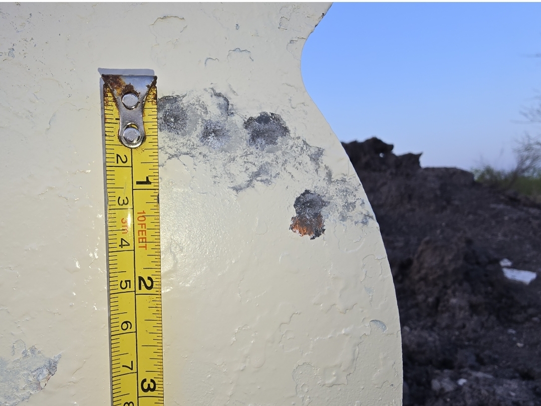

If it was worth the effort and I had some help, I could instrument the rifle to gather thermal and vibration data, mount in a sled, and set up an electronic trigger pull. I know my range has some electronic target devices that show round impacts but I’ve never used it. Using this for this would be a huge time and target cost saver.
Methodology: performance utilizing extremes
Determine best and worst ammo brand/type without tunner using 20rd shot groups @ 207yd and 307yd target distances.
Clean rifle between each 20rd string using a repeatable process. Could get photos with borescope for validation.
Install tuner and rerun best and worst ammo in the same 20rd strings with the same cleaning patterns.
Change tuner setting (x) degrees between strings (due to ammo quantities, I may have to test extremes of tuner or reduce round count per string).
Ideally I would like to keep barrel temps and shot interval timing equal but it’s just more stuff to track and process. Video recording of all of this would be helpful as well.
If instrumented properly It would be a lot of data requiring post processing. I’m not a SQL guru so it would take me some time to parse into something readable/meaningful.
