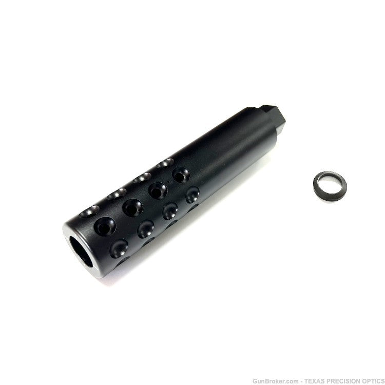

Thanks. I need one that is at least 4 inches long.
this is all i could come up with for now, but i'm sure there are other options
Thanks. I ordered one.
Reactions: Top O' Texas
kinda of a bummer as it defeats the purpose of a short barrel to make it 16" or longer, but should be flatter shooting. i have a 12# 12.5" 308win that kicks like none other. goes to show that weight doesn't help much. i have a 20" 5# 14oz (with optic in that weight) that recoils (felt or not) very soft with same ammo (m80 pmc 147bmj-bt).
Need some guidance on how to lengthen a 12.5 inch barrel to 16 inches. I want to pin and weld a muzzle brake but cannot find one long enough. The brake needs to be 4 inches
Why would you want a 16” barrel that performs like a 12.5”
Just buy a 16” barrel.
If this is some sort of Larper thing, disregard & carryon.
