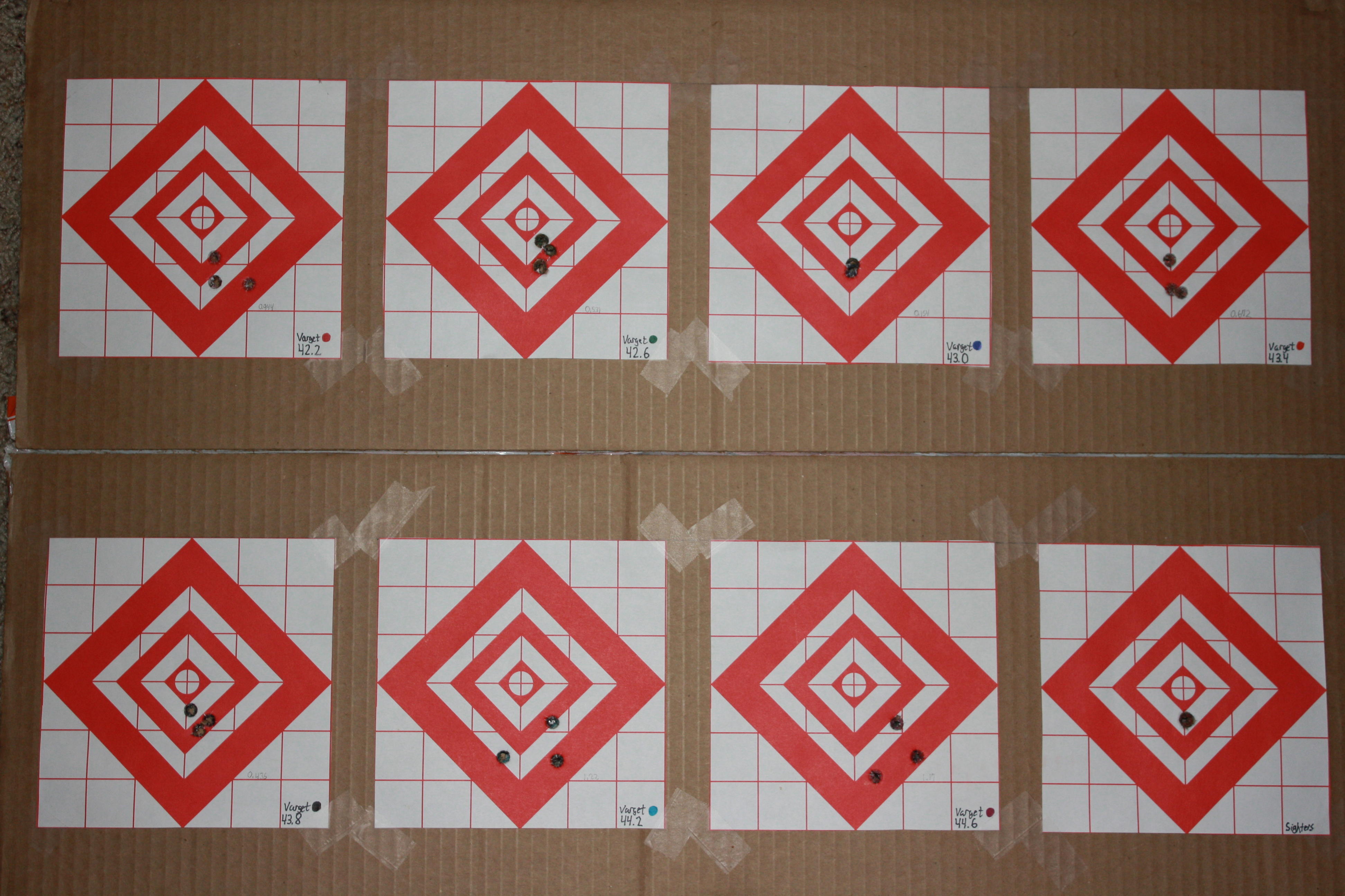

Well there ya go. These shots are my first reloads ever made by me. Guess all the internet research and attention to detail is paying off. Two of those groups are better than what FGMM 175gr ever did in this gun. The best I could do was 1MOA on average with FGMM. I'm going to explore around 43.0gr. That was just about where I was seeing light compression of the loads when seating the bullet. This was shot off of bags made of T-shirts filled with rice. I ran Hoppes #9 through the gun followed by 2 dry patches and finally 1 oiled patch the night before shooting. There was very little wind this morning. Shot 4 fouling shots, ~2min between shots and then 15-20min between low-high, high-low, low-high. I thought I had a hang fire on my second shot, found out a round didn't chamber because the mag wasn't locked in all the way... idiot... ;)
Studying the target further I'm temped to play around 43.0gr. Maybe try 3 of 42.8, 42.9, 43.0, 43.1, 43.2? What do you guys think? I'm trying not to bias myself by the awesome group at 43.0. 42.6 and 43.8 were suggested in another load workup on here, but that person was loading longer than mag length.
Parsky1,
Based on your results 42.6, 43.0, 43.4 & 43.8 have similar POI's. I like to run OCW on one straight horizontal line as I have found multiple lines can shift POI.
Maybe consider 42.8, 43.2 & 43.6 which are in between your loads above. This should show which direction to then go to .1 increments followed by seating depth changes if applicable.
Just some quick thoughts after viewing your results.
