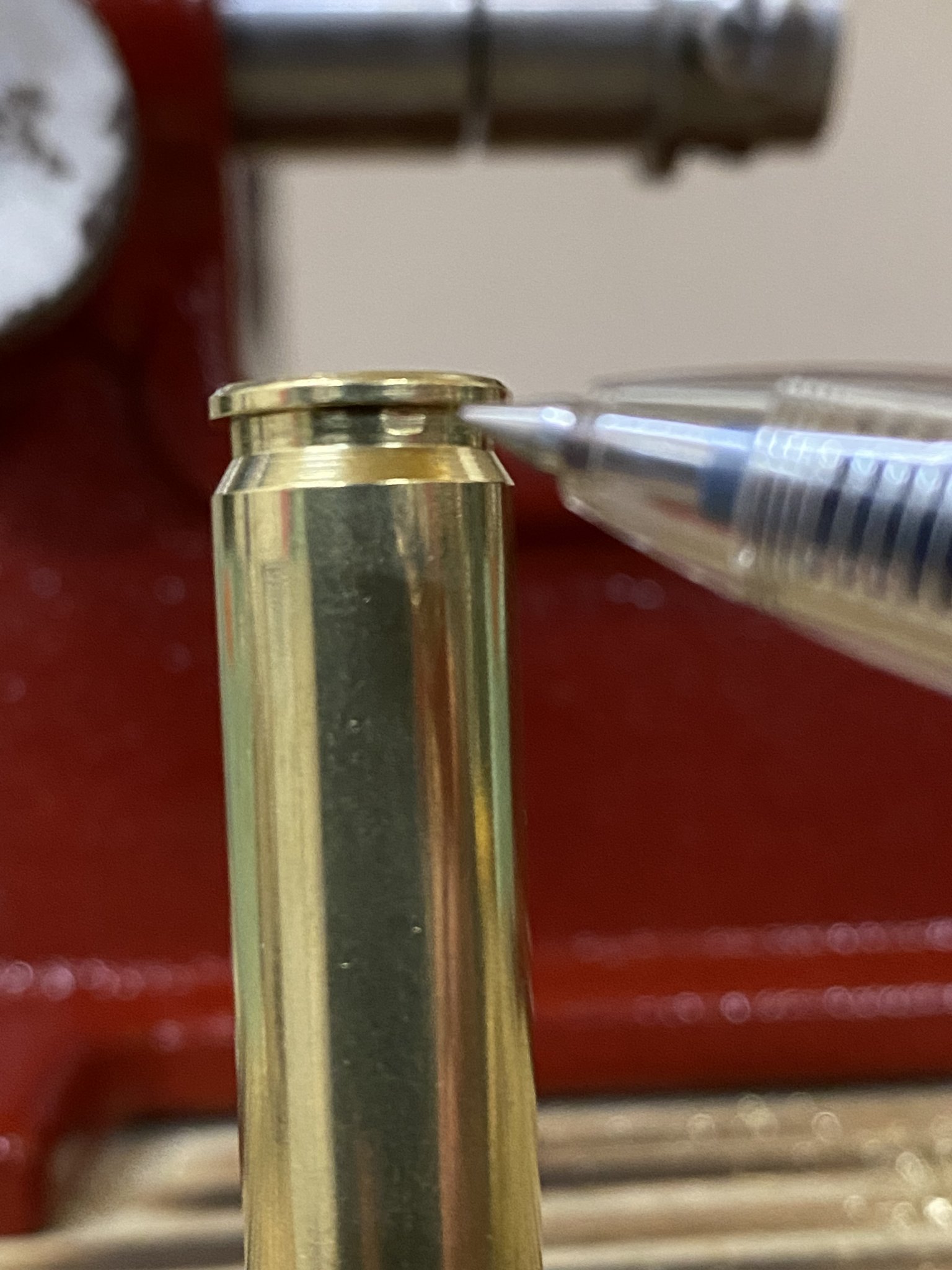

You can see from the painted brass where it is sticking. It is just kind of confusing to look at, at first, because it should not be sticking on the outside diameter of the shoulder like that. I was corn-fused when there wasn't a ring around the base of the painted case. :ROFLMAO:
I did it once loading some 308 ammo for an FAL a friend was trying to sell me. That beast just rammed them home anyway.
If you attached an FAL carrier to a stick, you have have a pretty formidable hammer.
You can see from the painted brass where it is sticking. It just kind of confusing to look at, at first, because it should be sticking on the outside diameter of the shoulder like that. I was corn-fused when there wasn't a ring around the base of the painted case. :ROFLMAO:

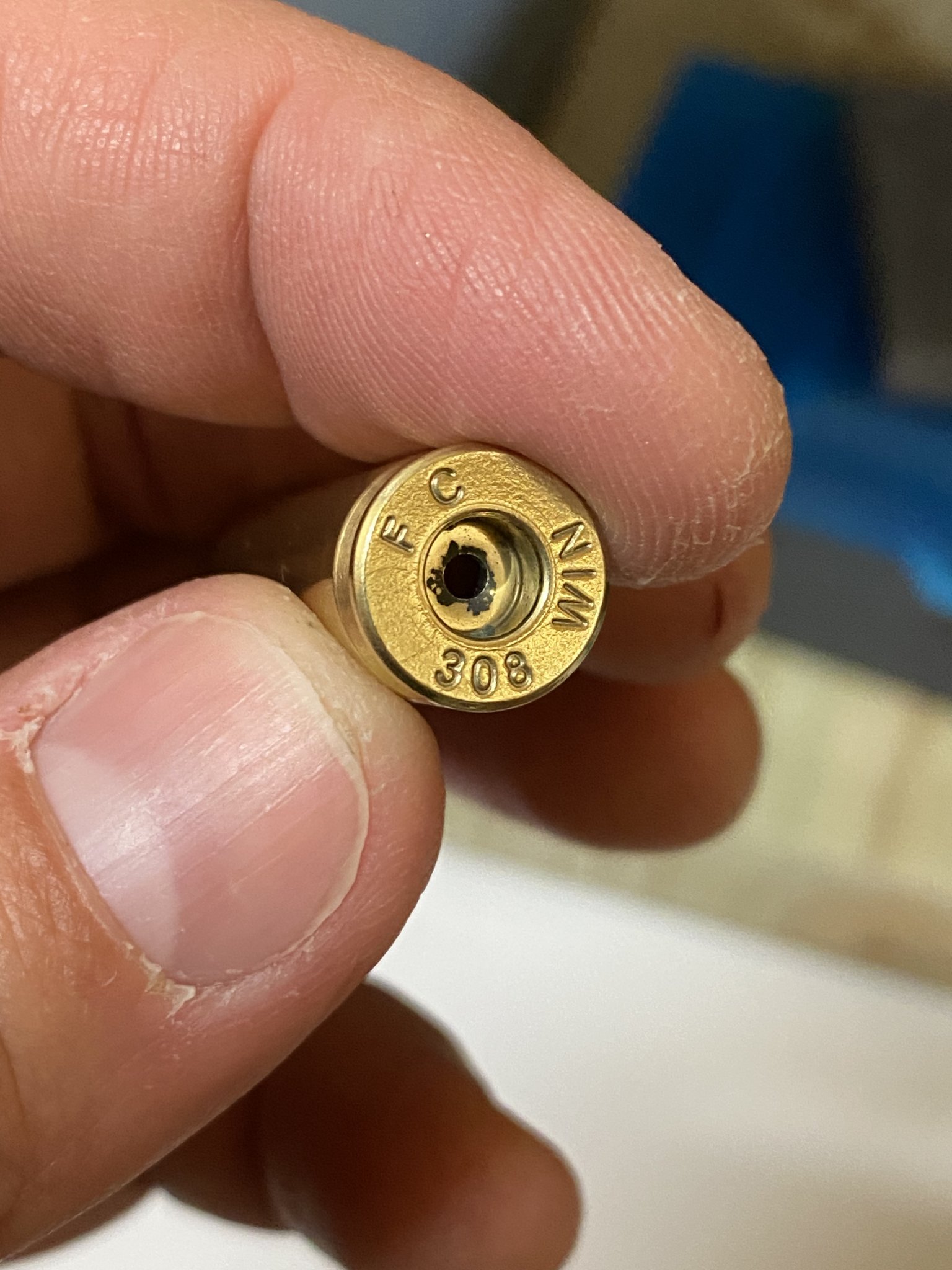

School me on these marks. Faint line near case head, what looks like an ejector plunger mark, and an extractor claw mark? What’s it all mean? Is FGMM brass as soft as I’ve read? Anything to worry about? Am I reaching max pressure on factory FGMM 175gr SMK factory loads?
**edit** these are not all pics of the same case.
