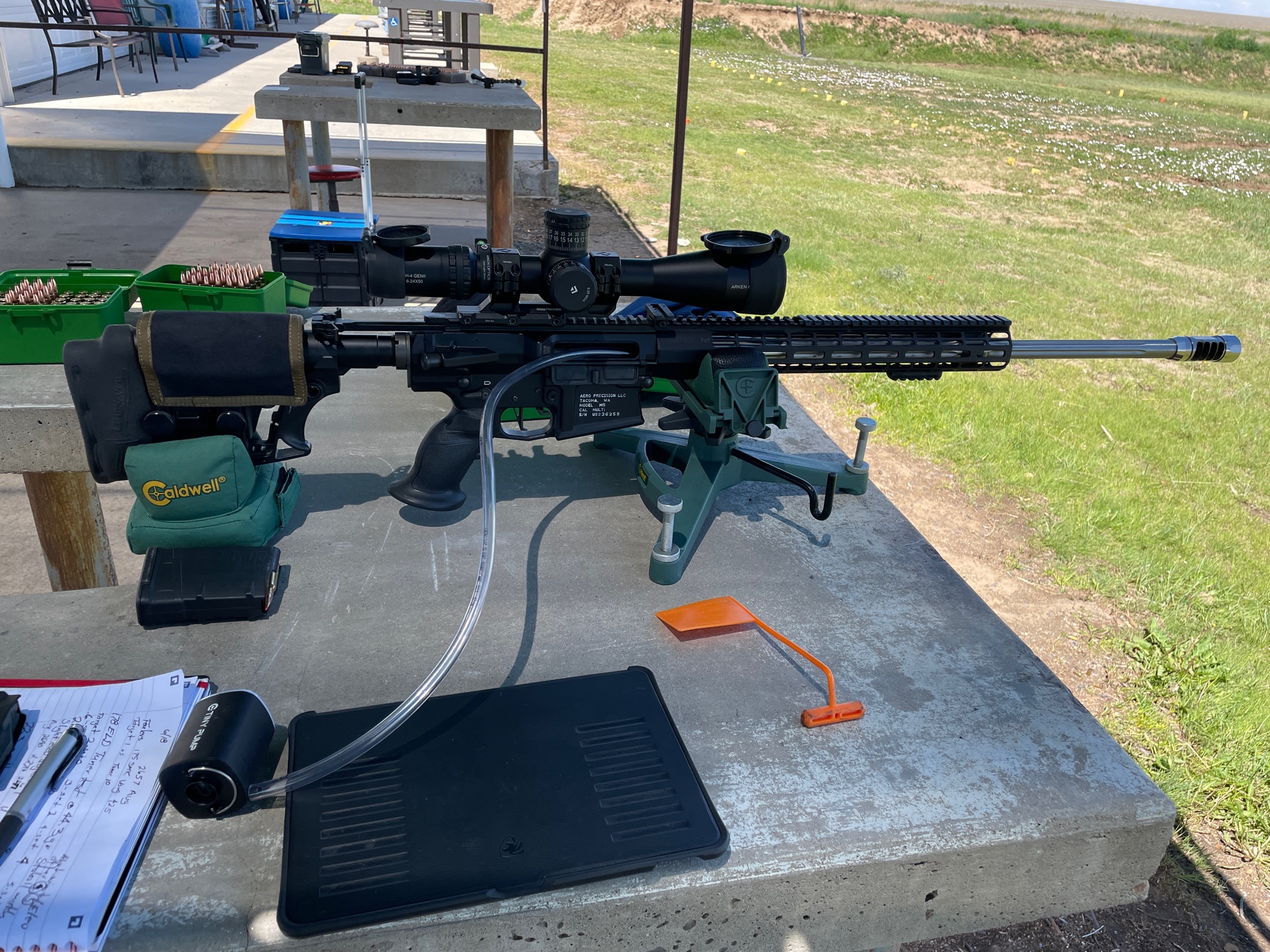

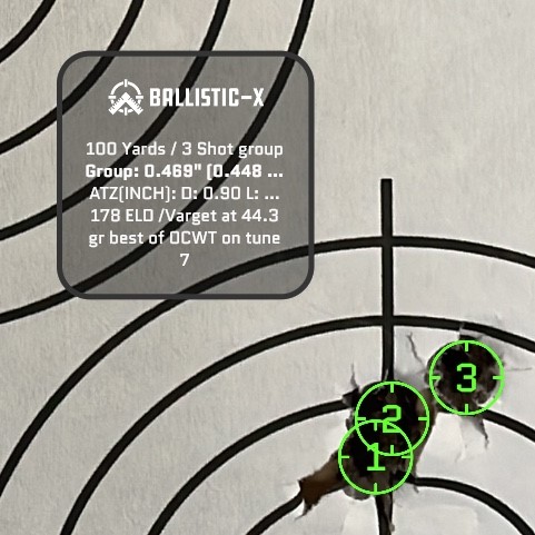

I have the EC next gen tuner / brake and they do work. I just recently started working with it and have already done some OCW tests and went right to the tuner. I'm likely going to back up and do some seating depth work with my best charge weights and get back into doing tuner tests with the best of the seating depth results.

View attachment 8172432With the 178 ELD M and the 44.3 Varget , aren't you limited to a Mag length of 2.800" OAL , and I'm guessing that is already a compressed load ? So I'm also guessing that the only you can test different OAL's in to seat the bullets deeper ?

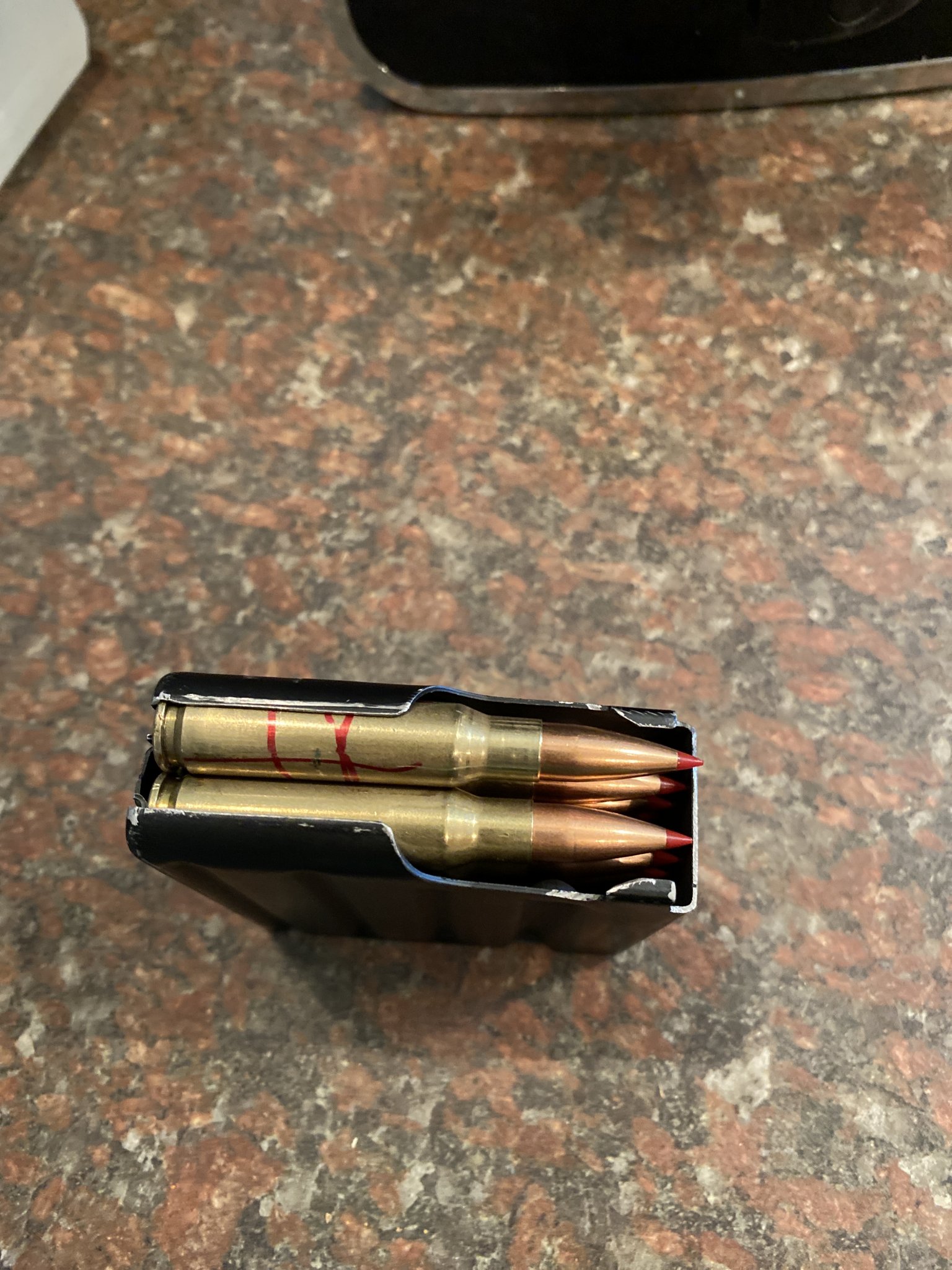

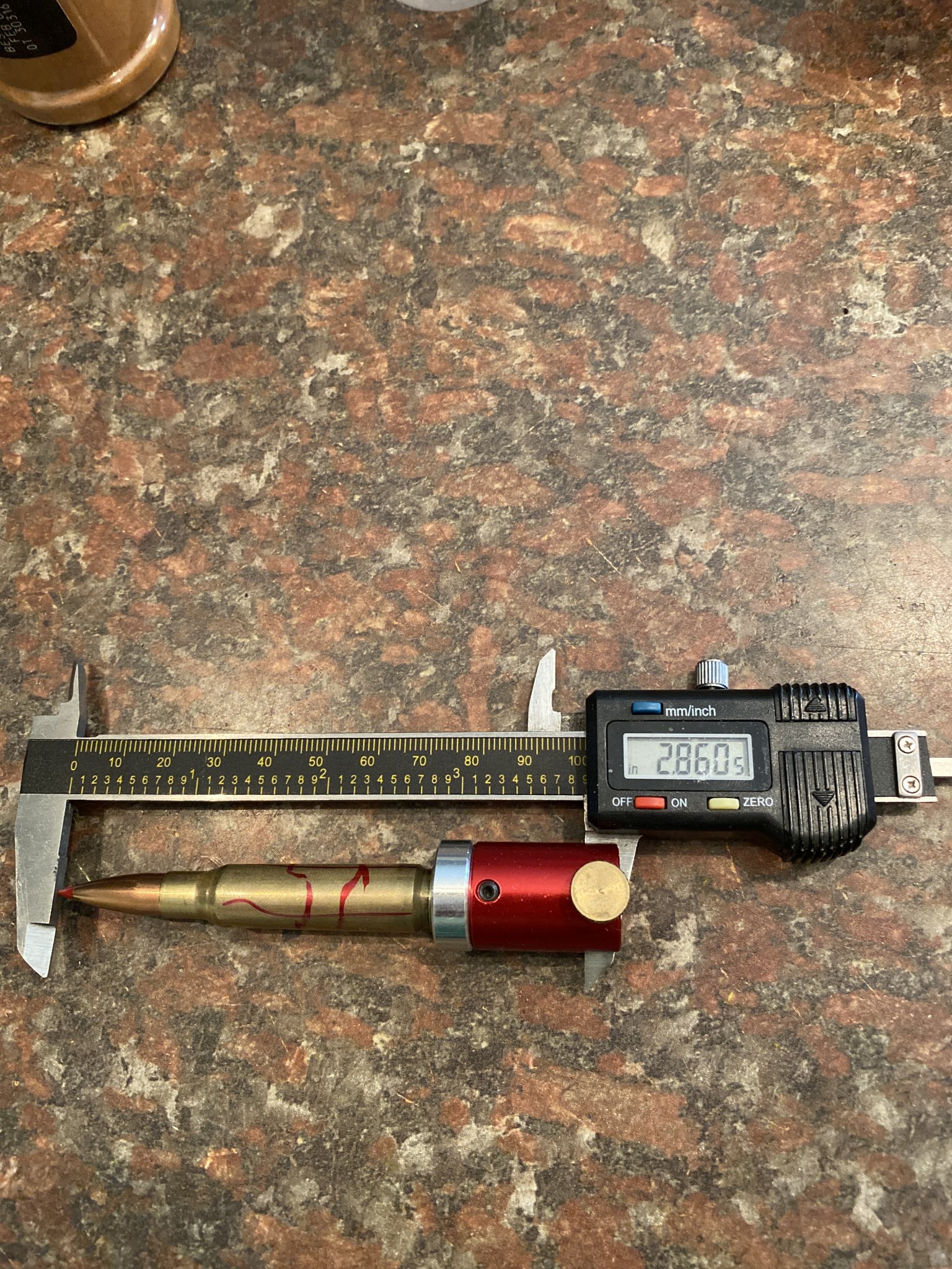

Knights Armament mags will let me load longer to 2.87" and yes, 44.3 is beginning to compress that load a bit.
FC Cases with 178 ELDM and 44.1gr Varget are right around 100% capacity at 2.86 for me. And shoot pretty well.
Tamping/tapping them down and shaking near my ear, about 1/2 still have a very minor amount of movement and the other half I can't hear any movement of powered in the case.

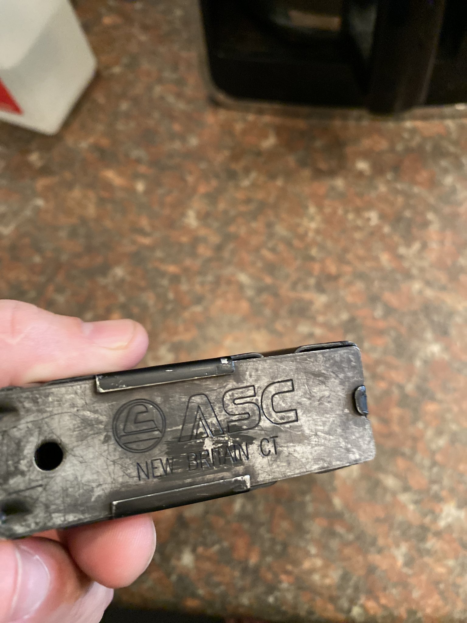

What issues did you have with your asc mags? I've had issues from some 20 rd mags myself, and am curious if it's the same problems. I use asc mags in other calibers for ar-15's and they run great.
The spring and the follower do not hold round flat against the feed lips. It would be crooked allowing the rear of the round to "sag" and the bolt would not catch the next round.
I cut the spring, about a coil and a half and played with bending it and got it to work, so the spring tension was more rearward but does not inspire confidence.
I bought a couple of them and they all did it.

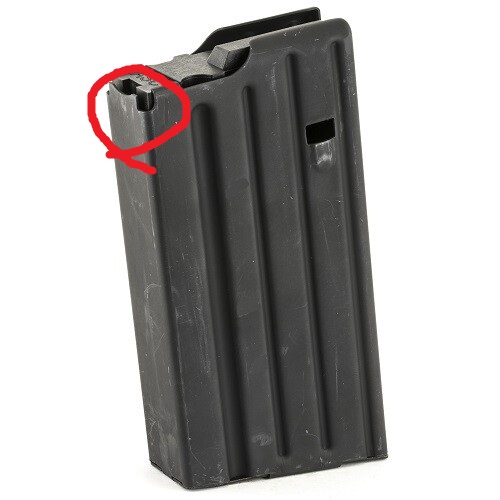

ASC mags the front area is a little higher and can cause feeding issues in some rifles. Maybe its been changed since then I dunno, my 308 mags are all pmags and e-lander:
I actually ground that down too. Forgot to mention that, if you look at the pic a few posts back you can see its been "massaged".
View attachment 8172432View attachment 8172433
The EC Tuner shrank my group size by half and is repeatable. They really make sense for the AR platform with the long throat and being restricted to magazine length Ammo.

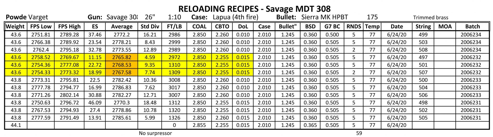

I'm a long time reloader but new to long range shooting. My current 308AR is based on the S&W MP-10. I say based, because the only parts original to the S&W are the upper/lower and ambi controls. It currently sports a Wilson Combat 20" barrel and BCG. I had to back the loads down from the previous barrel; unknown as to why. Anyway, here's my current loading on 150gr for up to 600 yards. Shoots 1/2" at 100yds if I do my part.
Bullet is Hornady #3037 150gr FMG-BT with cannelure.
killizyrag: Must be your own spreadsheet for your data as I don't recognize it. I've been doing my own spreadsheets for every single firearm and they keep evolving. Haven't done anything with the 308 in quit a while but here's a sample of what I use.
