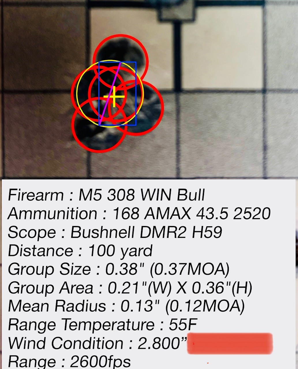

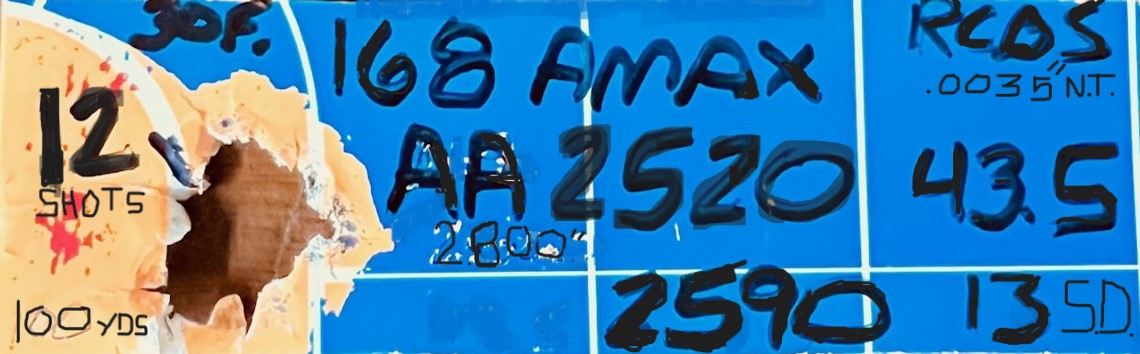

Barrel: 20" Ballistic Advantage Bull 1/10T (.930 at muzzle, SA Adj gas block)
Bullet: 168 Amax
COAL: 2.800
Powder: AA2520 @43.5gr
Case: FGMM
Primer: WLR/Fed 215
MV: 2650fps
Ele: 750ft
Temp: 70 F.
Groups at various temps:

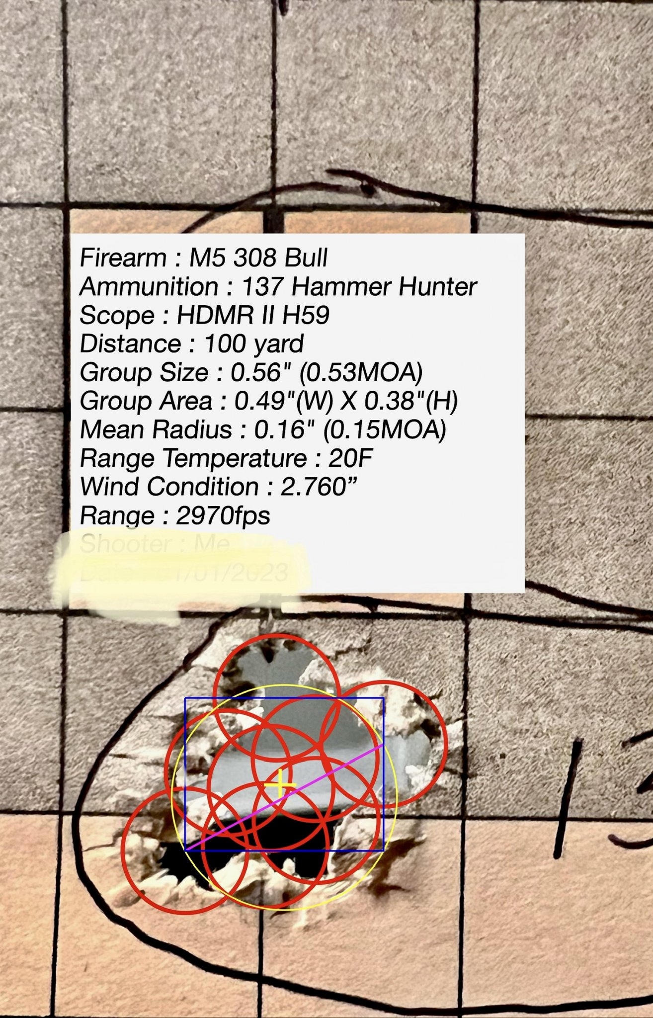

Bullet: 137 Hammer Hunter
COAL: 2.760
Powder: AA2520 @49.5gr
Case: FGMM
Primer: WLR/Fed 215
MV: 2970fps
Ele: 750ft
Group: 13 shots

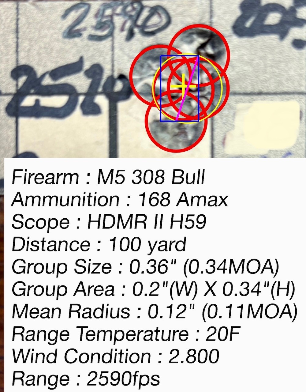

Bullet: 168 Amax
COAL: 2.800
Case: FGMM
Primer: WLR/Fed 215
MV: 2650fps
Ele: 750ft
Temp: 70 F.

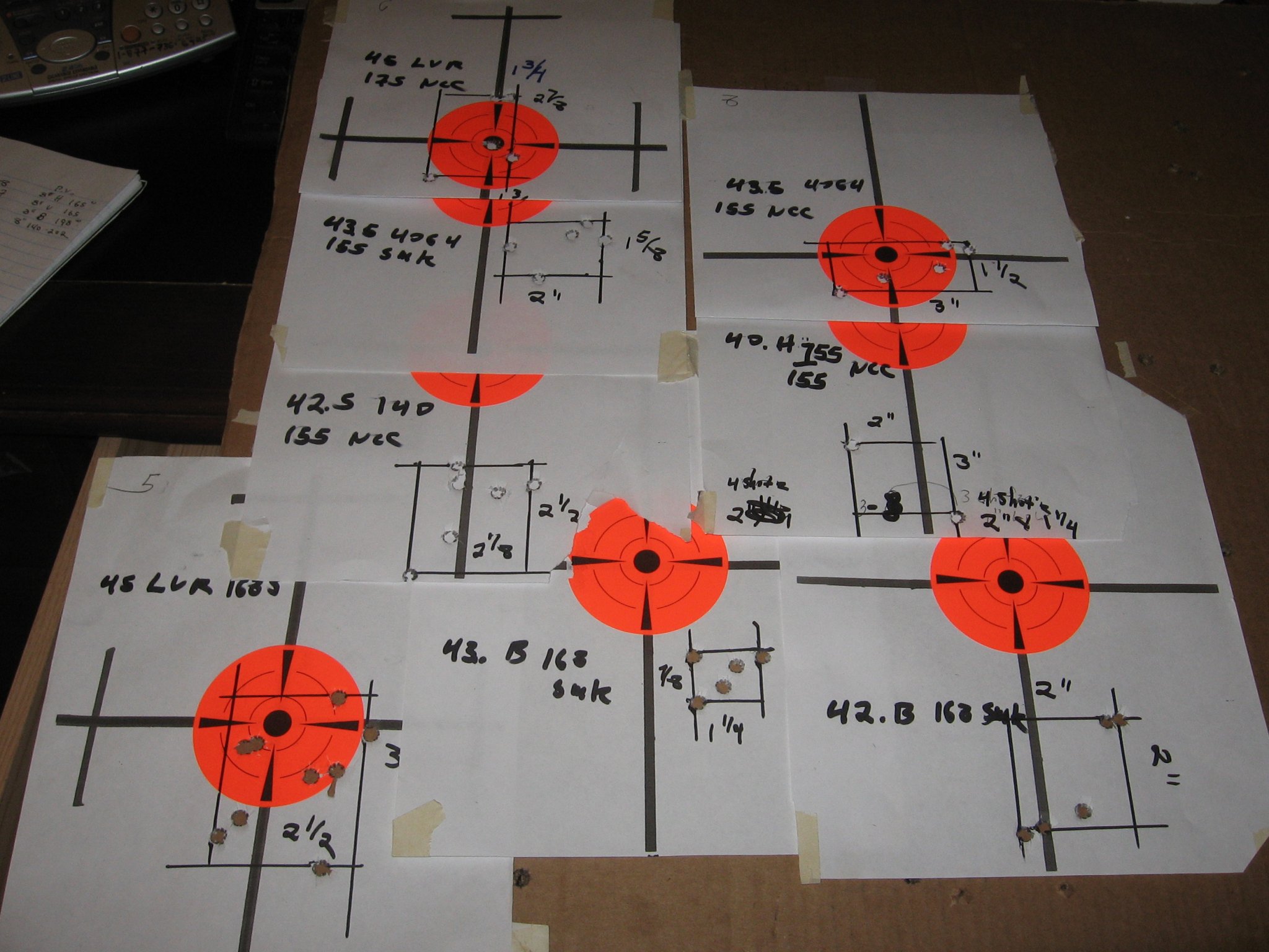

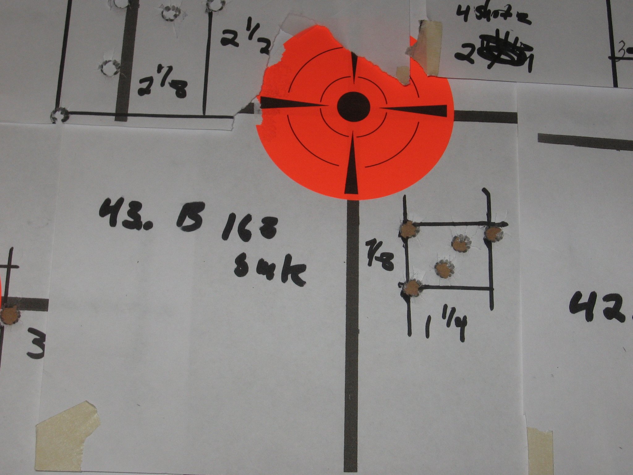

All these were shot at 300 yds from an AR10T that was re barreled with a 26" Shilen 1-12 T .930 @the muzzle . All the NCC & SMK bullets were "blems" either from Noslers Pro shop or Powder Valley.

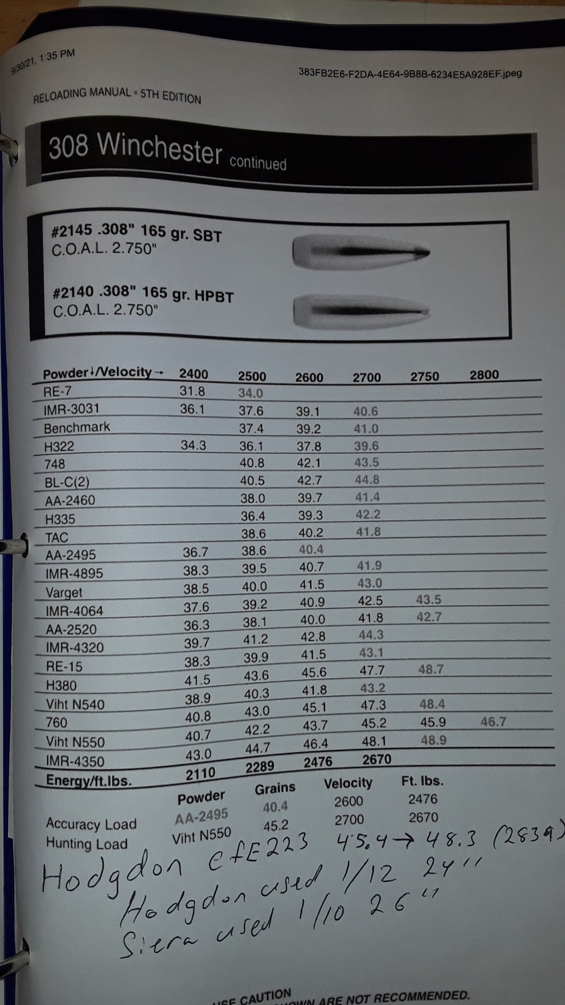

Any information on 150 grain SST's or even 165 grain
@RDahlstrom
My 165g sgk's need re-done.
They were right at 1 moa but slow.
A last minute hunting load that got loaded up enough for a season. My son dictated the load good enough make me a box got a thing gotta go.
You can use this as a reference but probably needs more powder.
CBC brass fed #210 primer
39.6g varget
BTO 2.100
Coal 2.715
Fps 2461 chrono in 20 inches 1/10 twist.

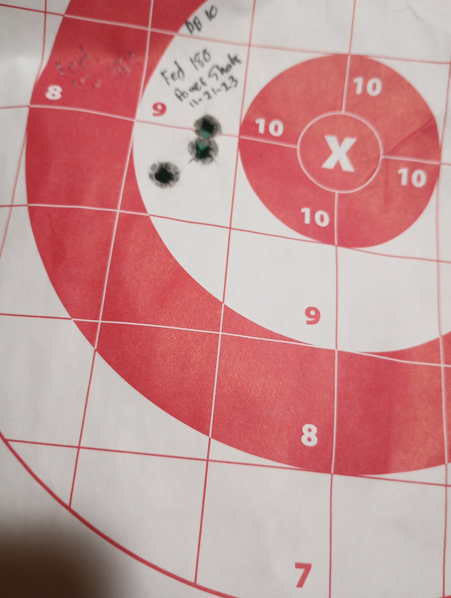

I may have mentioned this before but when I was cleaning the barrel on my .308 gasser a few months back I was pondering a few things, like... Why is this thing so damn slow?
I received this rifle as a Christmas present a few years ago and I could swear I was told it had an 18" barrel. Never bothered to check.
So I measured from muzzle to chamber: 16"
Things are making sense now.
So 16" x 1::10 twist.
Except in a very few "lucky" circumstances this barrel refuses to shoot 150, 155, and 168 gr bullets with any consistent groups.
Try 175's...
Starting to see improvement. Maybe go heavier just to see.
Dug around in a box of "Miscellaneous" 308 ammo I had on the shelf.
Blue box Federal 180 gr Power Shok... The cheap stuff. Or used to be.
Unbelievable. 3 shot group. Velocity was predictably low, but no ES to speak of... 2414, 2414, 2413.
It grouped well for low end factory hunting ammo... I can probably do better with handloads.
Next stop... Break open the box of 177 SMK's on the shelf and see what they do. They won't be going anywhere in a hurry but we'll see what happens.
Might even try some 185 Juggs if I can get my hands on any.
Mike

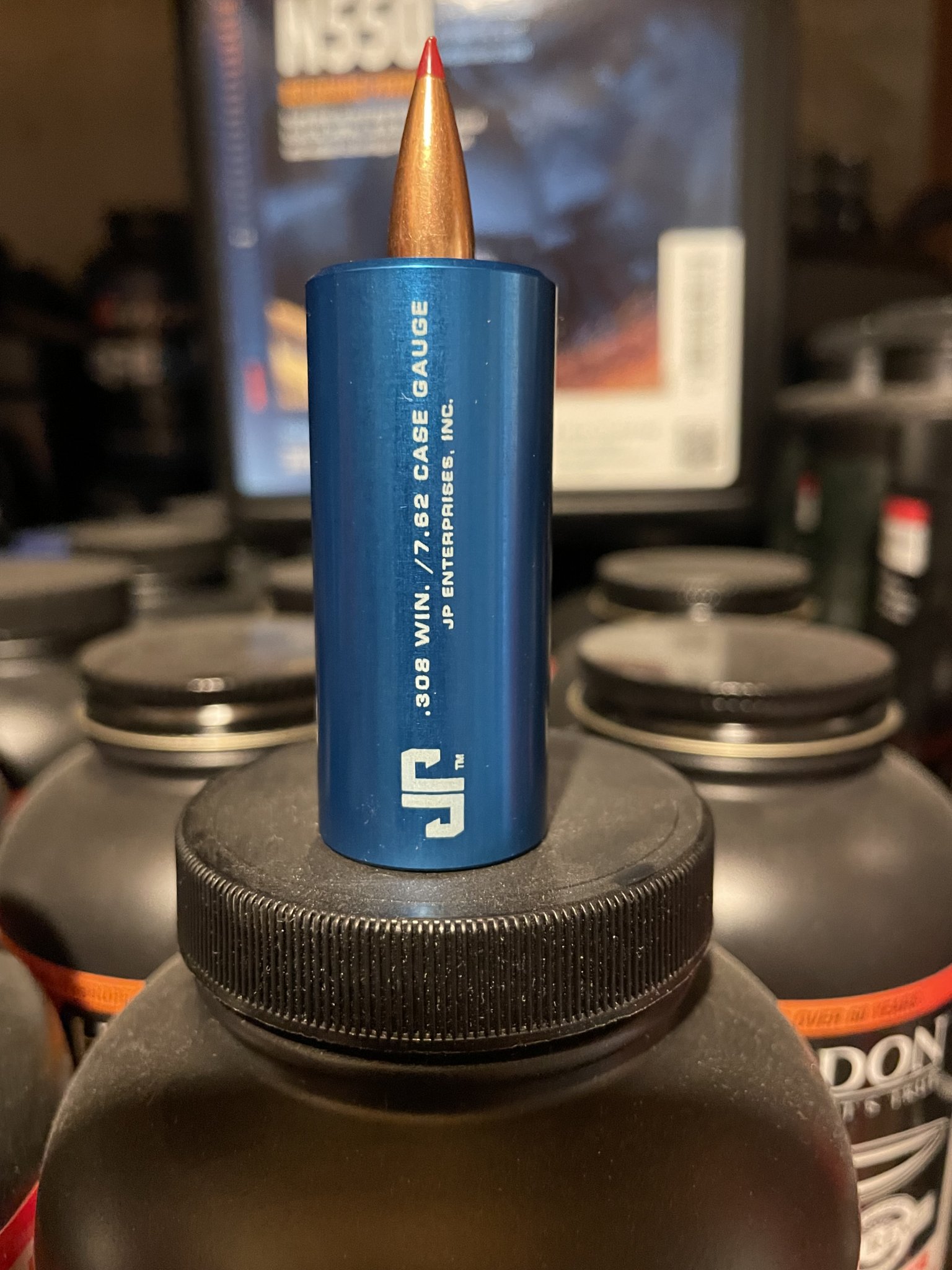

Hey there- Wondering what your reloading process is for your JP LRP-07 / gasser in .308?
I’m an experienced reloader but have not loaded .308 for a JP / gas gun.
JP recommends a small base die. I know some don‘t use sb dies, but if you do are you using a FL or body small base die? If FL SB die, which small base die and how much does it bump the shoulder and what are you running for neck tension?
If only using a body SB die, are you using a neck bushing resizing die after the body die to set the neck tension? Are you using a mandrel?
Appreciate the help.

I went through alot of 7.62x51 ammo and 308. I got a box of horaday 168 gr. A max match.
It shot them at Round 1/2 inch at 100 yards I was impressed.
So, I lapped the bore using lead plug. It was tight at the gas block. Went back and shot 5 more of the a max one hole at 100 yards . So, I set out to figure out the powder they used. After a year I found it in a old reloading book .
168 gr.a max
Hornaday brass
2.8 oal
42 gr. 3031
2800 fps

Using sierra 155s I have Ar Comp and Varget. GRT showing Varget would be a little less pressure and more velocity. Any idea where to start with a gas gun? Looking at 45ish gr of Varget and 43ish gr of AR COMP.
What brass? Because there's a world of difference between Lake City and Winchester brass.
For Varget, Hodgdon's .308 Service Rifle data shows a starting load of 43.0 and 44.0 max charge.
IME gas guns are just different and won't handle the same charges as your bolt guns. The service rifle data is geared more toward the M1 and M14 rifles... But probably a good place to start with an AR-10/.308
Can't help you with AR-Comp. But I bet someone else can chime in.
