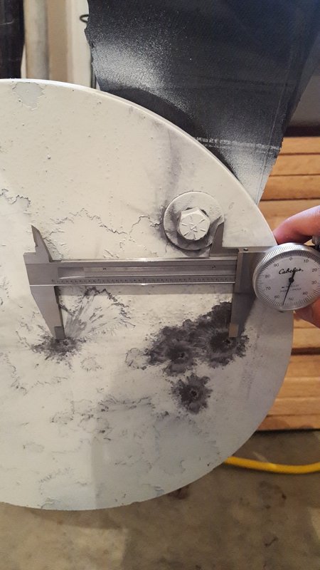

09/12/2015
208 AMAX at 2.900". Lapua brass, fgm210 m. 46.1 Pp2000mr.
28" 1:11.25 twist. Stiller Tac 30 action. Shot .325" ctc.
[IMG2=JSON]{"alt":" photo C613779A-8BA9-4222-AB0D-191A38325F27_zpssqalhlxu.jpg","data-align":"none","data-size":"full","src":"http:\/\/i1355.photobucket.com\/albums\/q715\/Todd_Ellis\/shooting%20pics\/C613779A-8BA9-4222-AB0D-191A38325F27_zpssqalhlxu.jpg"}[/IMG2]
[IMG2=JSON]{"alt":" photo 14283B1E-0AEA-4215-8516-D49A562C6B4E_zpsoqpubtll.jpg","data-align":"none","data-size":"full","src":"http:\/\/i1355.photobucket.com\/albums\/q715\/Todd_Ellis\/shooting%20pics\/14283B1E-0AEA-4215-8516-D49A562C6B4E_zpsoqpubtll.jpg"}[/IMG2]

BHA Brass 2.005"
43.0gr IMR 4064
2.815" COAL
CCI200 Primer
175gr SMK
Shoots 2.79" Center to Center at 565 yards.

Custom Built .308. 28" HV 1:11.25 bartlein
Tac 30 action in aics.
208 amax @ 2.225 to ogive. Lapua brass
FGM210m
45 grains PP2000MR
200 yards
First 4 went in same hole. Blew it on the 5th
[IMG2=JSON]{"alt":" photo D96C53E5-D34D-459A-A0BB-021E589B3DA8_zpsg2fucynu.png","data-align":"none","data-size":"full","src":"http:\/\/i802.photobucket.com\/albums\/yy305\/stewartellis3007\/D96C53E5-D34D-459A-A0BB-021E589B3DA8_zpsg2fucynu.png"}[/IMG2]
[IMG2=JSON]{"alt":" photo 512B6055-F81B-4EB9-95F0-926768C21346_zps1vkwrjvs.png","data-align":"none","data-size":"full","src":"http:\/\/i802.photobucket.com\/albums\/yy305\/stewartellis3007\/512B6055-F81B-4EB9-95F0-926768C21346_zps1vkwrjvs.png"}[/IMG2]

Doh!
Were you the same person who posted a while back (6-8mo) on using the 2000 powder and the 185 juggs? Picking up where I left off last season with that. The 208's sound interesting as well. Would you mind posting some load performance specs??

44.2 R15. 4 shots 185 juggernaut. 2.205 to ogive Lapua brass.
[IMG2=JSON]{"alt":" photo 2E294495-7AB8-41CF-BD69-CB4D47D4F177_zps3b6srumz.png","data-align":"none","data-size":"full","src":"http:\/\/i802.photobucket.com\/albums\/yy305\/stewartellis3007\/2E294495-7AB8-41CF-BD69-CB4D47D4F177_zps3b6srumz.png"}[/IMG2]

Geeze, AimSmall!!! Do you ever shoot a group out of the .1 or .2's?
I am going to work up a load for the 185 jugs as well. I just ordered up a 28" Bartlett from PVA.
What have you found to work best for the 185's? I've got some Varget, R15 and 4064.
Great shooting!

Lol.... Hell yeah I do... Just don't post them ?
Honestly I've had GREAT luck with 43.3 and 43.5 grains of varget. Out of my 28" bartlein I'm at 2700 fps.
This was kind of me trying out R15. I've always used varget. But I'm going to chrono tomorrow and I'll report back.

10 rounds @100 yds, X ring = 1 inch diameter. I suck based on the two shanked upwards.
100 - 4X on NRA 600 yd F class target, no picture of that. 10 ring = 6" diameter, X ring = 3" diameter on the F class target.
