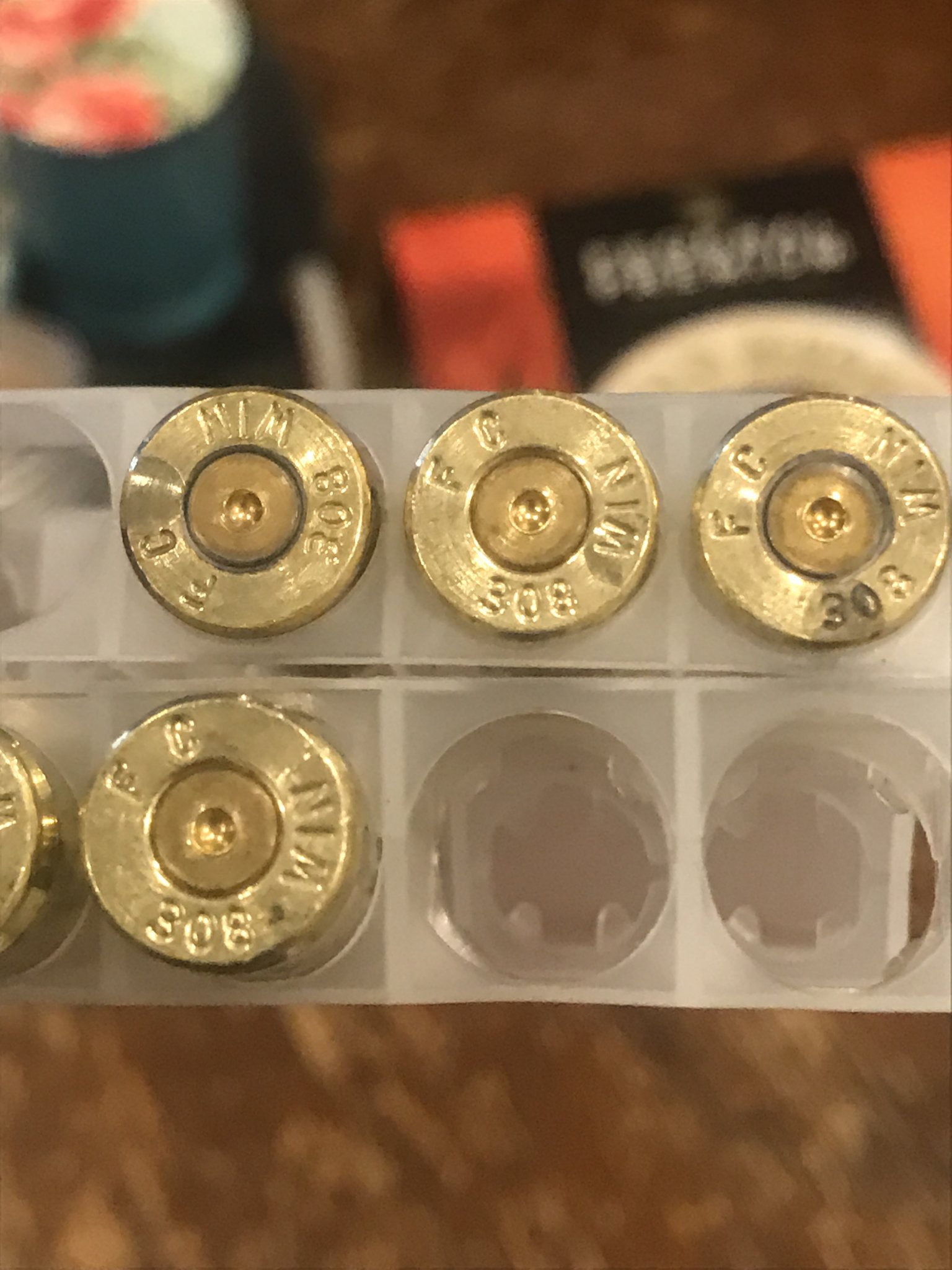

Working up some 175 smk over varget, fed brass and wlr primers. At 44.9 started gettingsoot rings around primers and ejector marks. Being its federal brass wasn't sure if the soot was from pressure or loose pockets. Haveing the ejector marks I called it pressure and stopped, going back down to 43.5-44.5 and check closer.
I don’t know what you think you’re doing, but you need to learn how to understand brass weight and internal case volume and how it relates to data found in reloading manuals.
FYI, 43.5 is max in these cases and you’ve just destroyed them.
