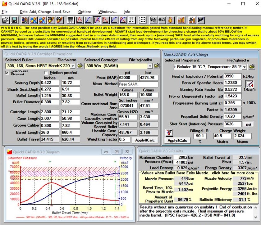

308 168 SMK, 41 Grains RL 15,
New Winchester Brass

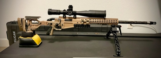

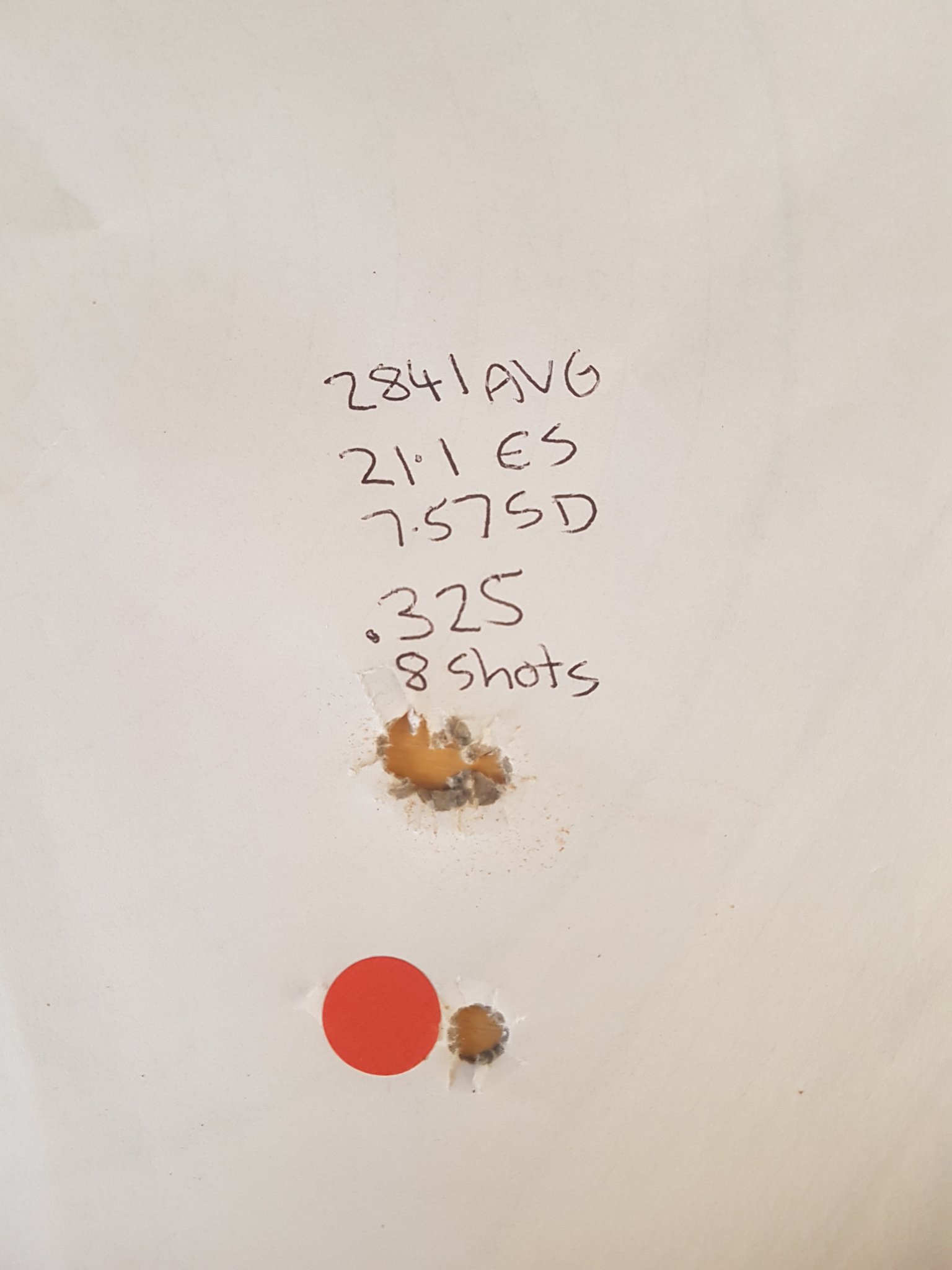

Load development for the AI AE2, 155gr Palma SMK, 8208xbr, federal gold medal match primers, Lapua Palma brass
What’s the twist on your barrel? And what kind of mv your getting? I have a 26” 1:12 coming and wondering which bullet to launch with it. I have a box of 500 in 155 smk (#2156), 168 smk, and 175 smk. Will be taking it out to 1000+ yards
The 168 probably want make it unless you're at elevation, probably somewhere around 2000 ft or so. the 155 and 175 should make it. But if things open up and the BC is correct the 169SMK would probably be the ticket. Better BC and probably the optimum weight for a 1 in 12.
Reactions: Rhed
Really want to try the 169. But been outta stock for some time now. So I’ll just work with what I have on hand. I’m shooting around elevation 900. If I can push the Palma’s to 2900, I should be good at the distance right? Got XBR, Varget, TAC, CFE 223, and RL15. I’m thinking the CFE?
The stock AI barrel is 1:12 the bullet is the 2156 the velocity is about 2840

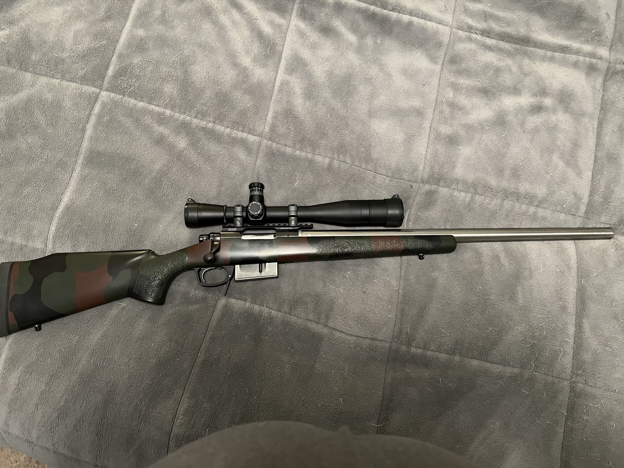

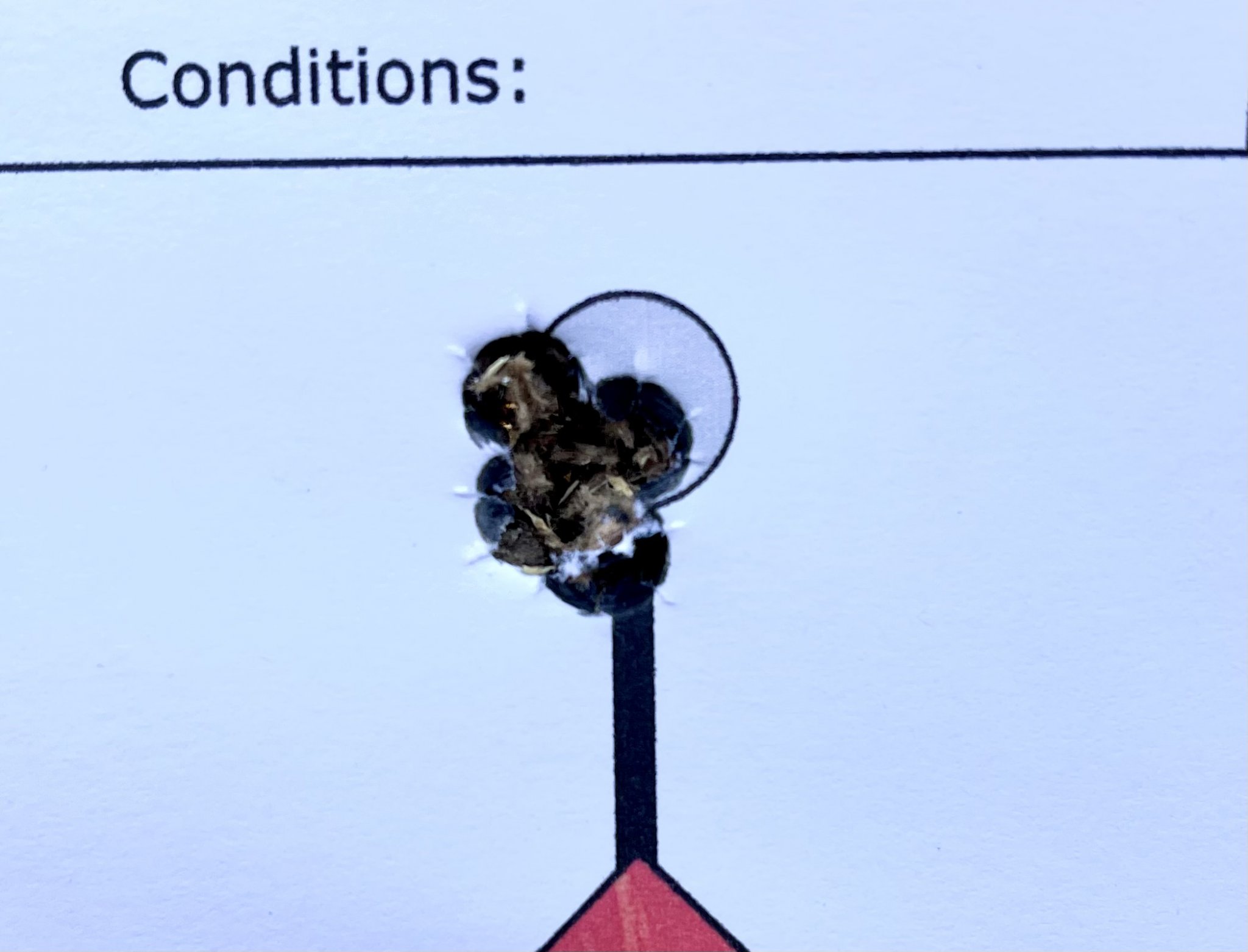

Started shooting my new Rifle, AX308 with Proof Carbon Fiber 26”
First target picture is 5 rounds of Sierra MatchKings 168gr HPBT, its a laser with this ammo. Second target is load I started working on; it's 3 shots, but showing a lots of Promise.
.308W
168 Hornady AMAX
RL-15 -41 grains
Lapua Case
FM 205 Primer
