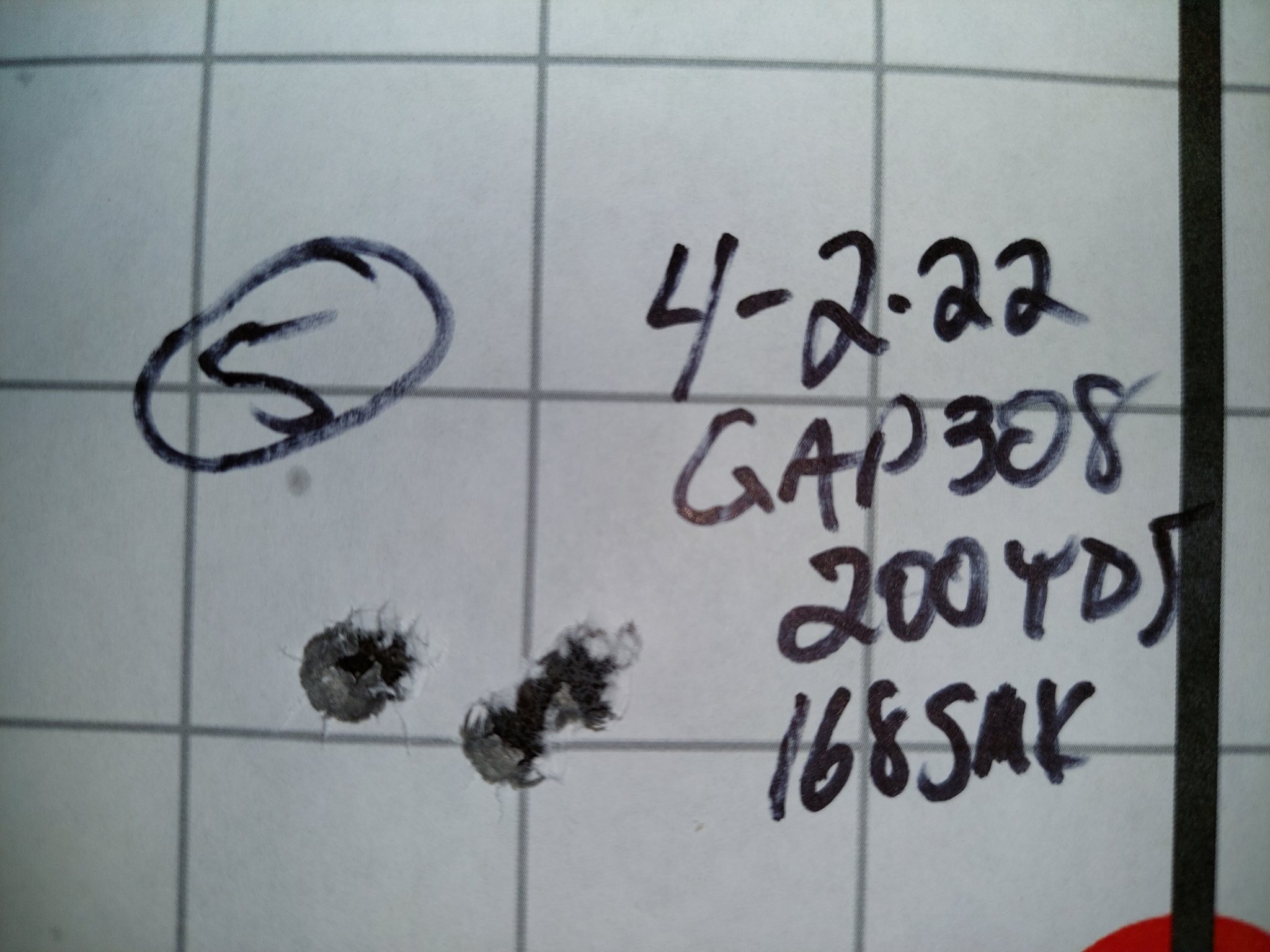

Here's a new GAP I picked up Friday. 18 inch barrel, first 5 on paper @ 200 yards. Reloder 15 and 168 SMK. Added the HellFire Match to it.
Shot it for a second time on Monday. This load is just from a batch of 500 I made to use up some powder in November. Not worked up for any rifle.
Nice rifle! That 18" barrel looks sharp. Any idea on velocity?

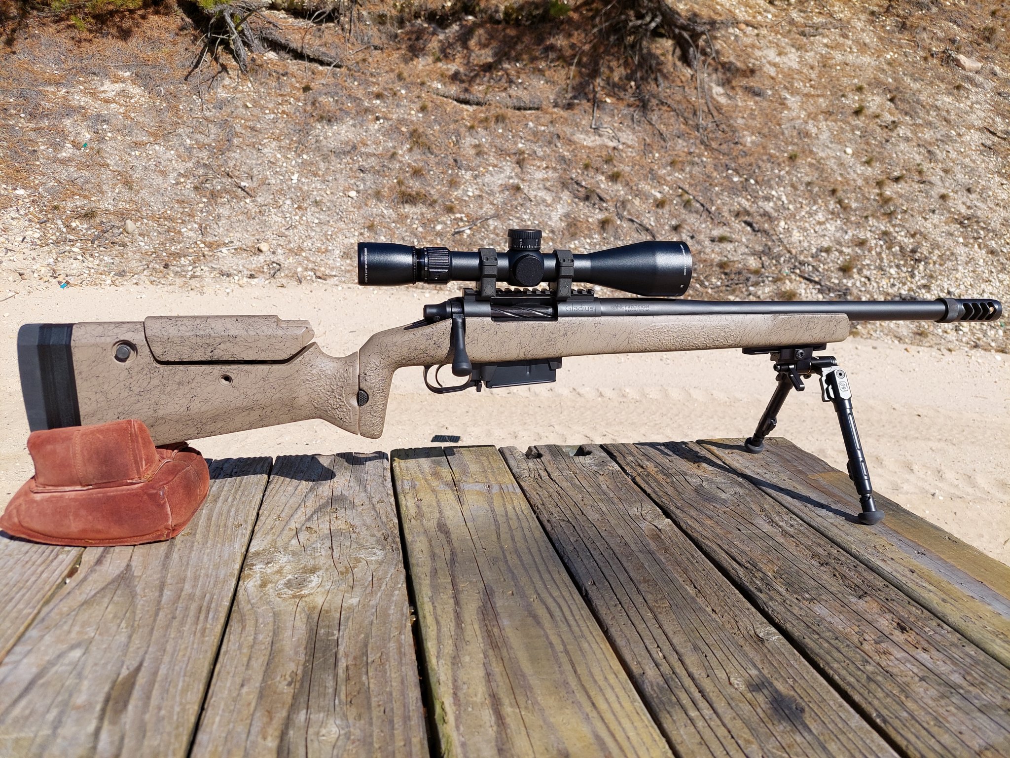

Do it. Shorty 308s are great. My 16” shot 175otm (44.8g Varget) @ 2595fps. I generally shoot to 500m max and it would hit a 6” plate over and over. I even won a club 600m f class match with it. Fun rifles.

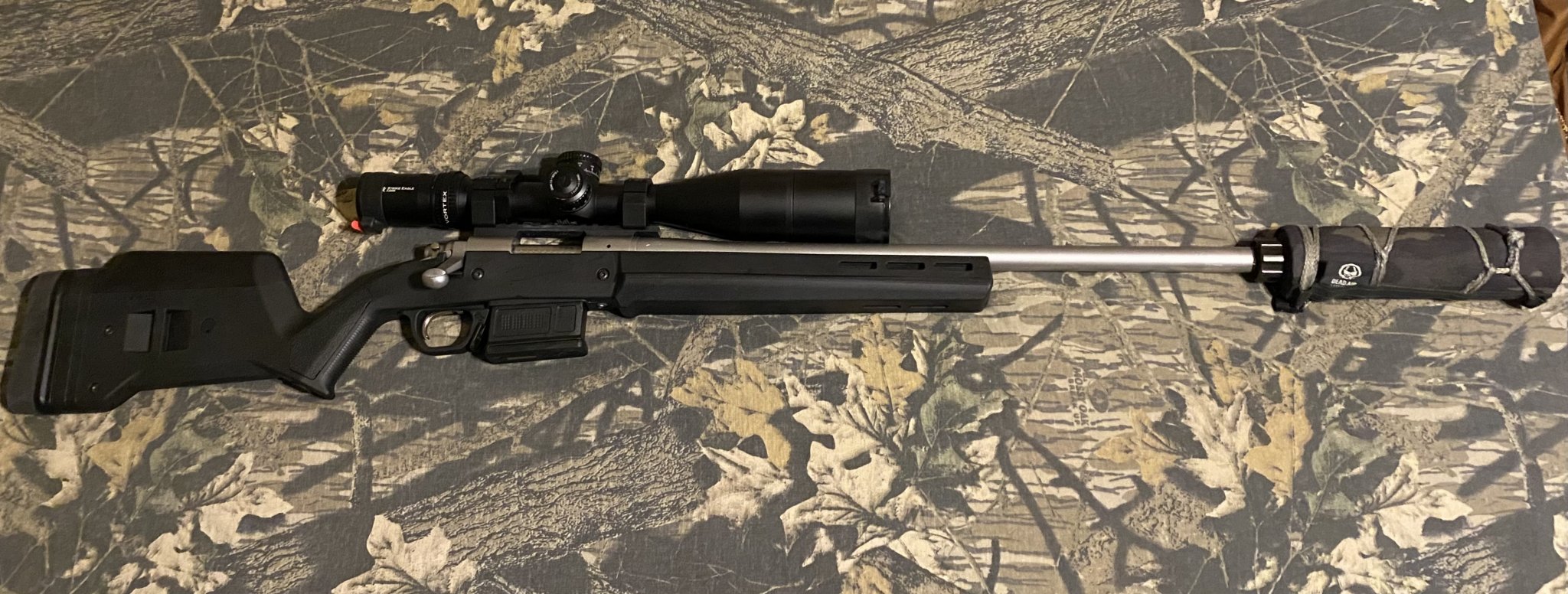

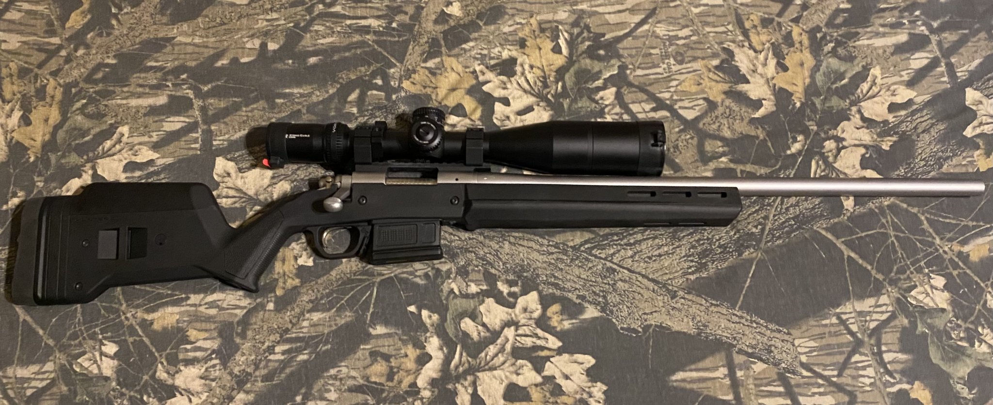

Picked up my old Gen1 R700 5R Milspec .308 Win from the smith yesterday afternoon.
Had him chop 2” off, and thread it, and install a DA KeyMount Brake and time it (no shims). So now it’s a 22” barrel, versus the original 24”. I was going to chop it down to 20”, but he would have had to break the barrel & action apart to do so, and price would have gone up.
It’s strictly a target/range gun, and it’s always shot off of bags or a bipod anyway, so barrel length really isn’t a big deal. But I’m very pleased with the outcome.

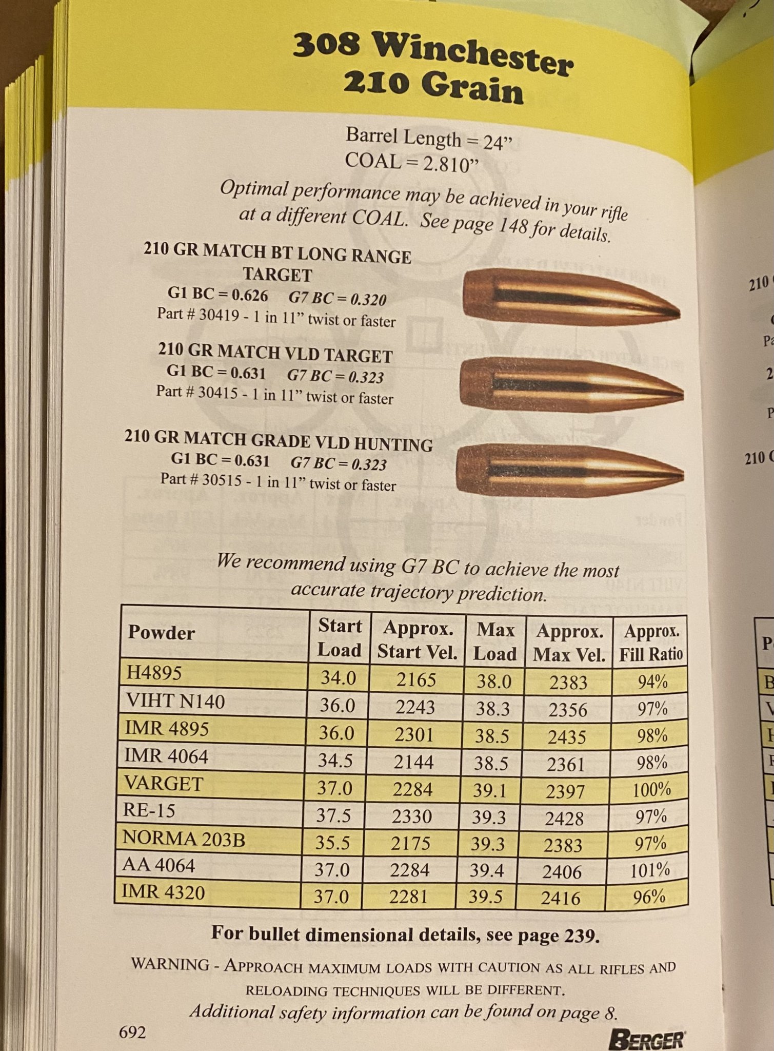

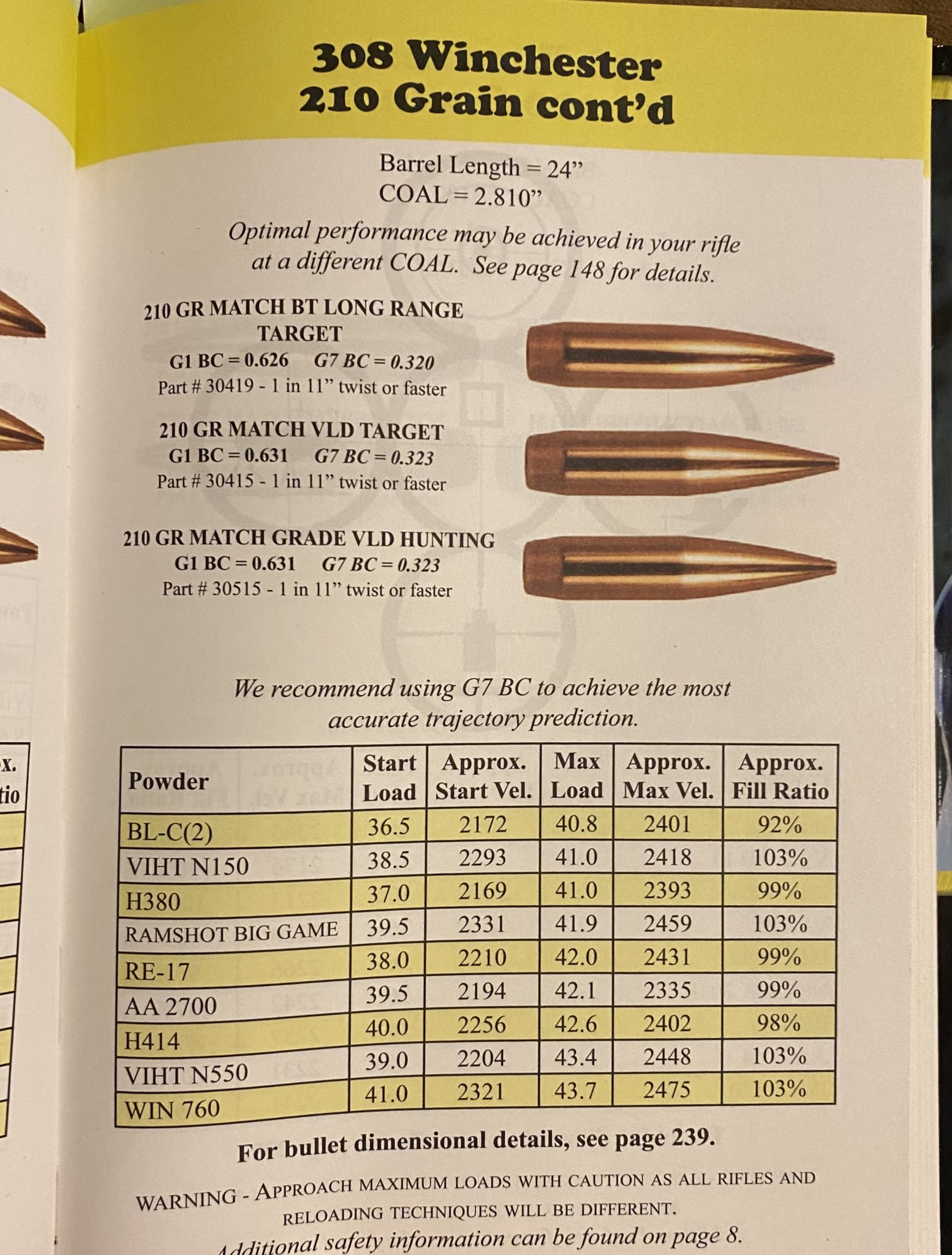

Whoa, whoa, whoa.......Hold on....Wait a second....Everyone just relax! :LOL:
You're using 210 and/or 215 grain bullets in a .308 Win? :unsure: What kind of velocity are you getting? I'm dying to know the recipe! I have a s**t ton of Varget. I haven't been able to find any Berger 175 VLD's ANYWHERE online. So if I can find some 210's or 215's to push the distance, i'm all ears! My .308 Win. barrel is 1:9
Been shooting them for over a decade...In a 5R 11.25" twist barrel with amazing results. Years ago, Brian Litz (the head ballistician for Berger) used to converse with me over on Long Range Hunting before I got banned, and he ended up using them in his .308 Win for his first 1,000 yard match...And won. 😏
Velocities will vary due to any number of factors, but I was averaging around 2,400-2,500 FPS MV with the 24" barrel. If you run out a 215 Hybrid on a ballistics chart at 2,500 FPS MV, you'll be shocked when it busts the 6.5CM's ass at around 600 yards, and then there is no comparison out to 1,000 yards...The .308 Win 215 Hybrid wins hands-down in both drop and windage.
If you have a suppressor, you can also make a cool 215 Hybrid subsonic load with CCI 200's and TrailBoss powder. Sounds like an old Red Ryder BB gun if you get it down around 1,000 FPS MV. 😉
I have no desire to have a subsonic rifle out of the muzzle. That's what my pistols are for :) I'm running a 24" M24 contour 1:9 barrel on a Rem. 700 action.
What's your load recipe for powder with the 210s & 215's? Many thanks!
That info I will not give. That's one of those work up at your own risk. To find a starting point, look into the Berger reloading manual. 👍🏼
You're missing out on the suppressed subsonic rifle part... Subs are VERY fun, even out to 200-500 yards with a precision rifle.
