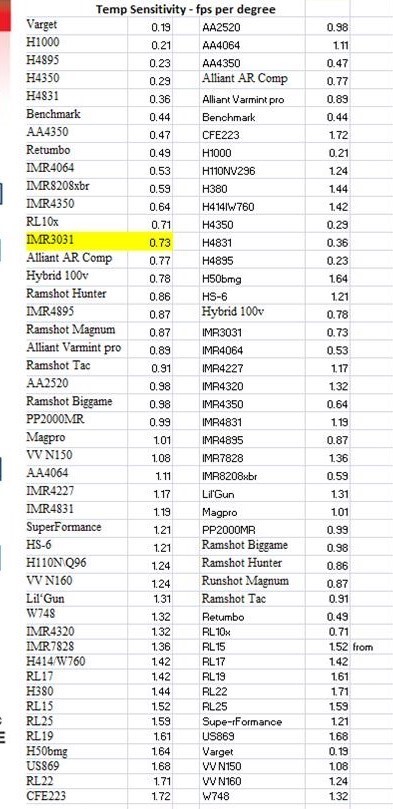

Temp sensitivity is why I haven’t used my ball powders since early December. I’m working up loads of varget but still haven’t gotten to same accuracy I was getting from the X-Term

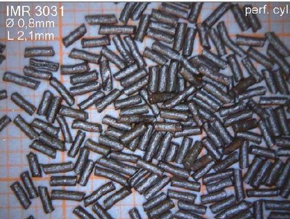

Is IMR 3031 any good, is it spherical?
It's an extruded powder, not spherical . . . and yes, it's a good powder for a .308.

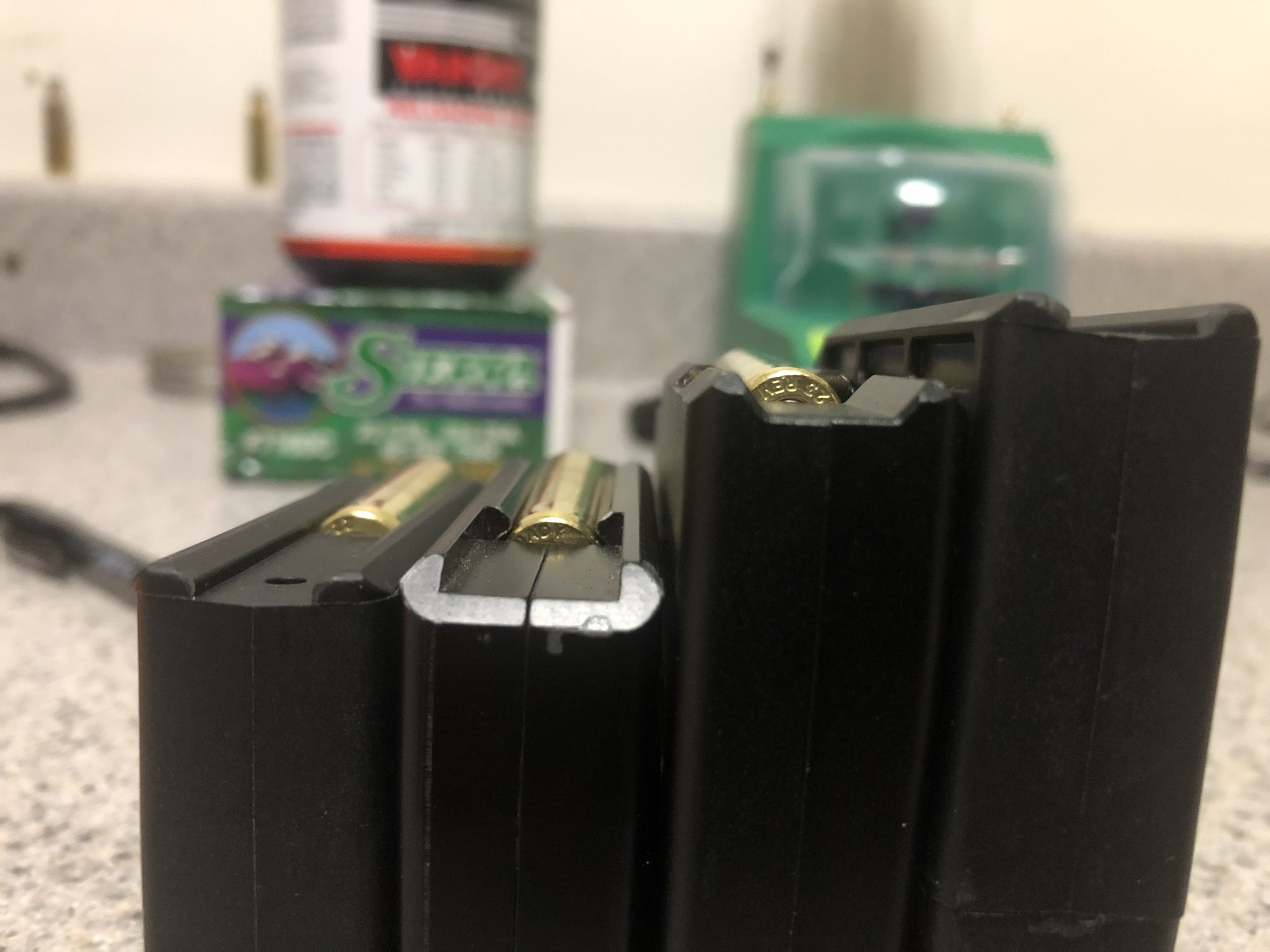

View attachment 7746521More mag options for 223 users. Picked up a waters rifleman 2.6” 223 mag, was supposed to be a ten rounder but got sent a 6, 10 should be s route from Australia soon. Sucker goes in tite! But is well made and seems to feed well, time will tell. Suckers are not cheap, but to have the option to go from a ten round, to a flush 4 round for different hunting applications I’m hoping it works.
I’m hoping the 10 will allow me to shoot a match with the rifle if I want to. That and less reloading in prairie dog towns.

Anyone know about the temperature sensitivity?

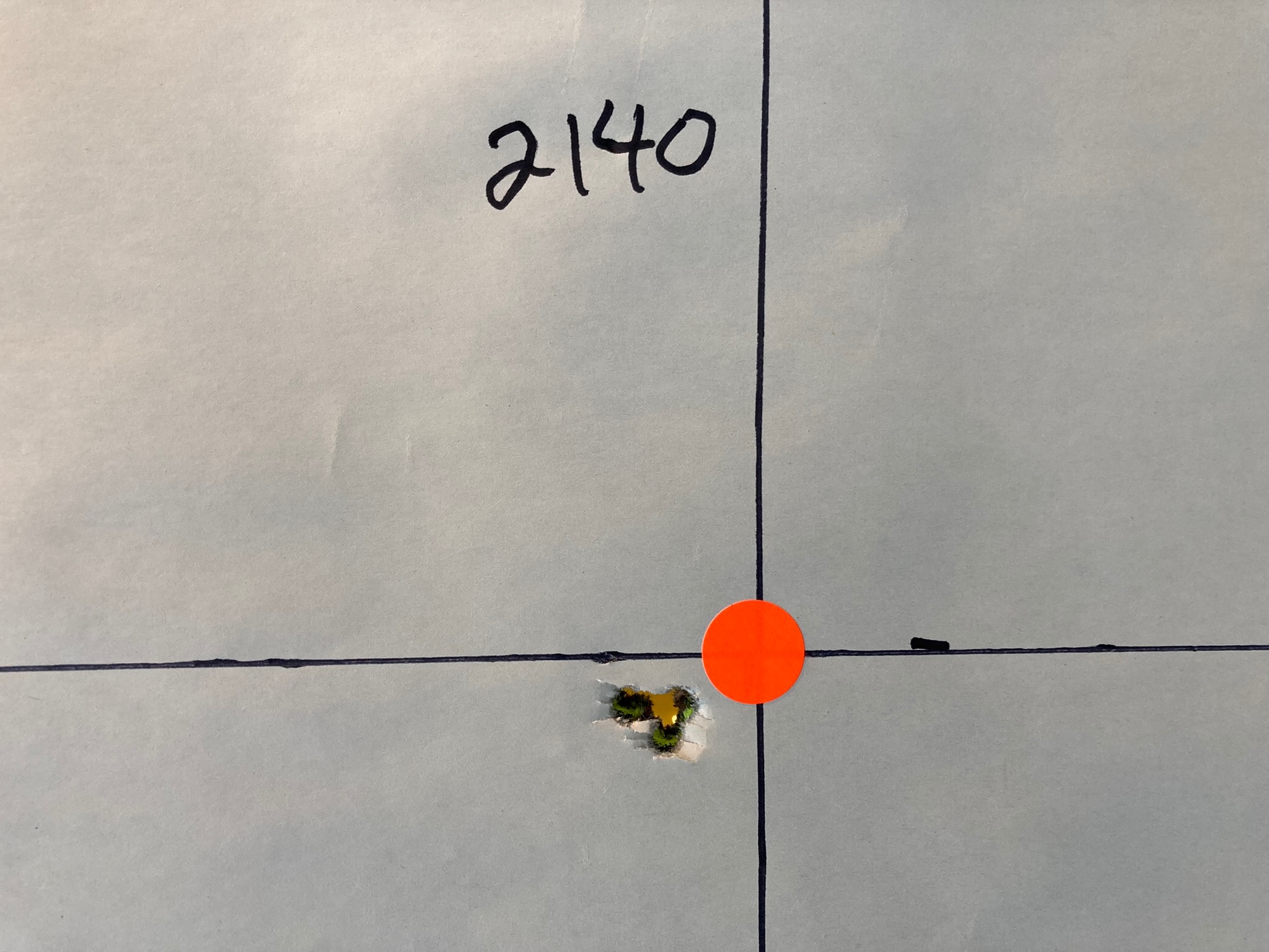

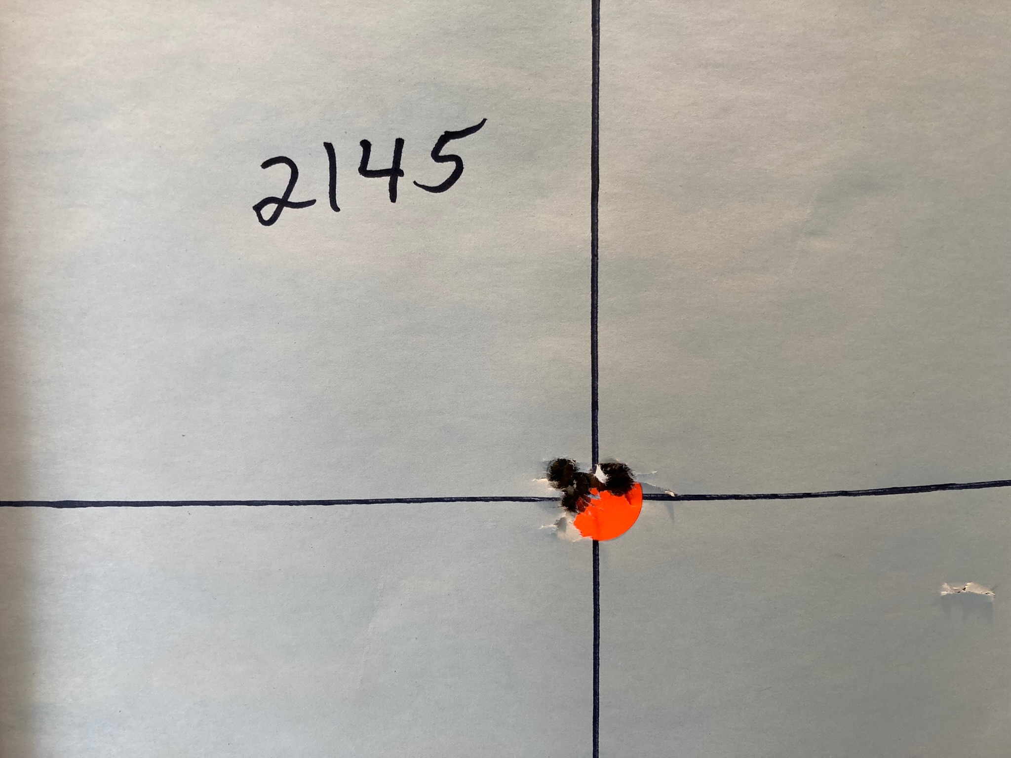

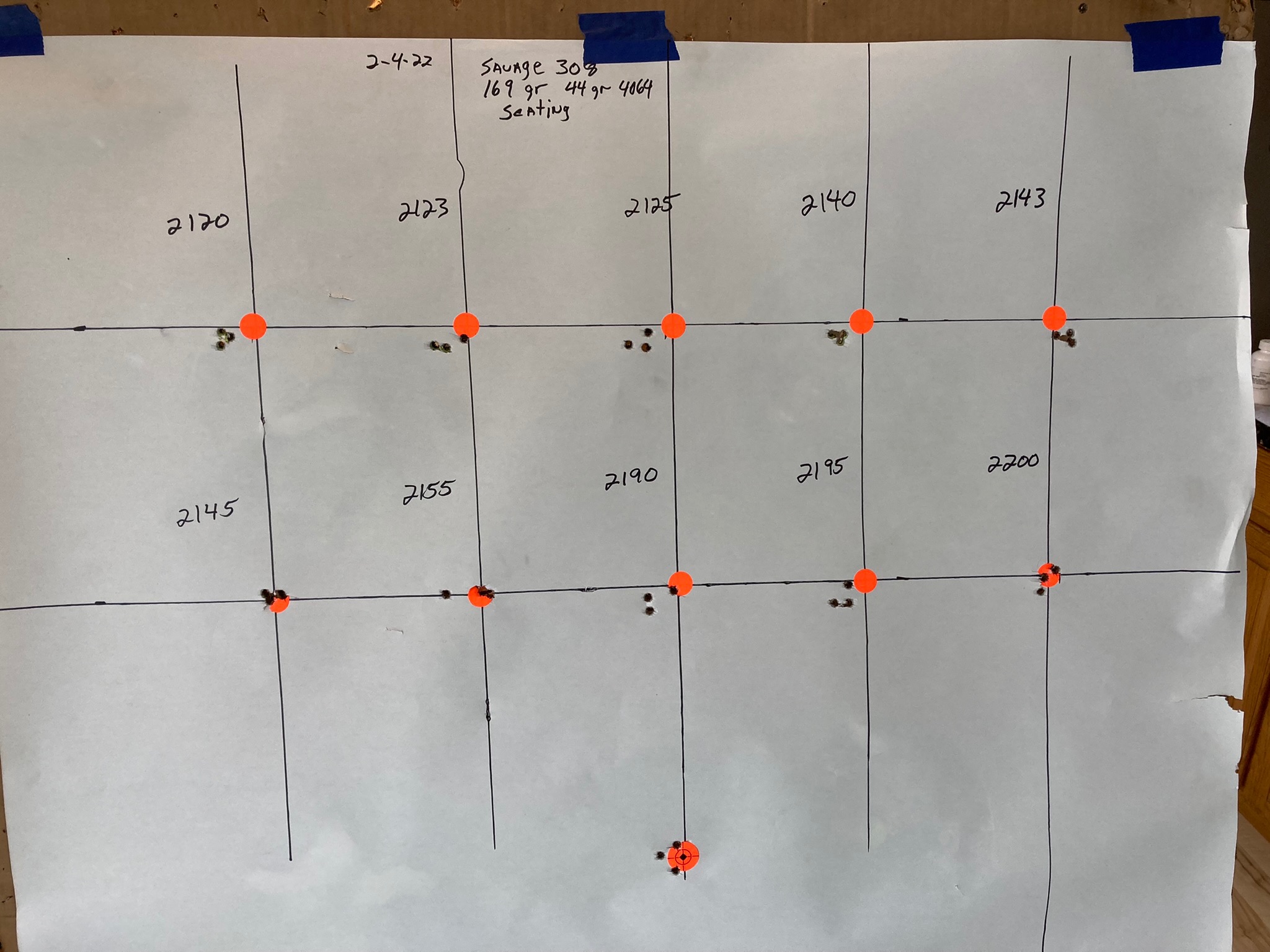

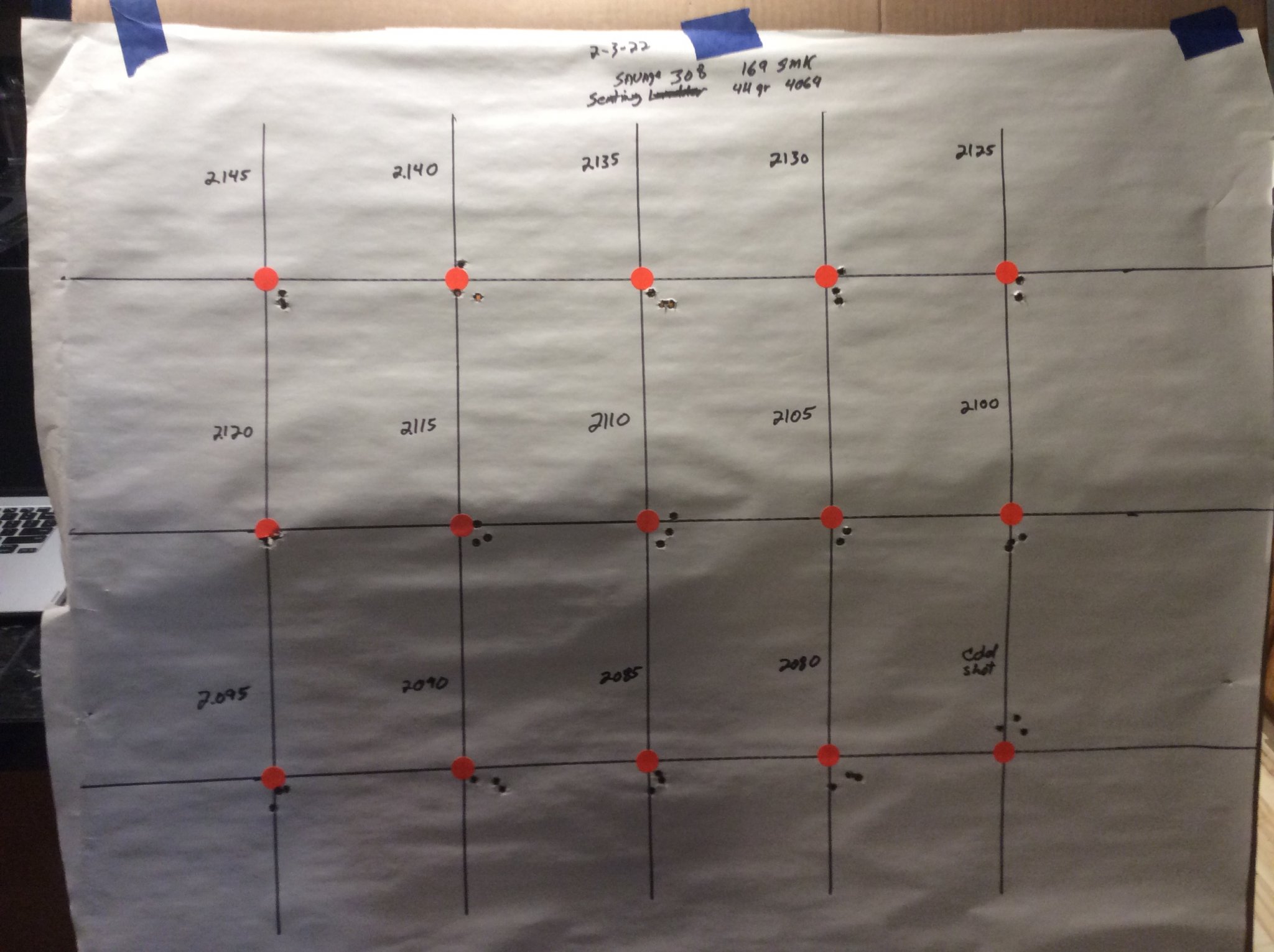

I finally found enough powder to do load development for the SMK 169 gr. The seating depth took most of the time. I started at jam and went to from there to .100. They like to jump a lot. The best groups were .065-.070 out of jam.
Winchester brass
CCI 200
44 gr. IMR 4064
Coal: 2.869
Ogive: 2.140 Sinclair comparator
2770 FPS

Yeah, IMR-4064 works really well for me too with the 169's. With Federal brass loaded to a COAL of 2.929 (COAL: 2.284 @ .011 off the lands), 43.2 grs gives me 2745 fps and 5 round groups around .3" @ 100 yds. I have yet to test them at distance.
A little milder load of AR-Comp (40.5 gr) gives me similar results on paper with a little less velocity.
Last fall before I ran out of powder(varget) at 600 yards the 169 gr was shooting 2 MOA higher than the 168 gr. It’s finally getting light and warm enough up here in Alaska to get out and do some testing. I did find a node at .010 out(2.200) and one at 2.145(.065 out) and another at 2.120(.110 out)
