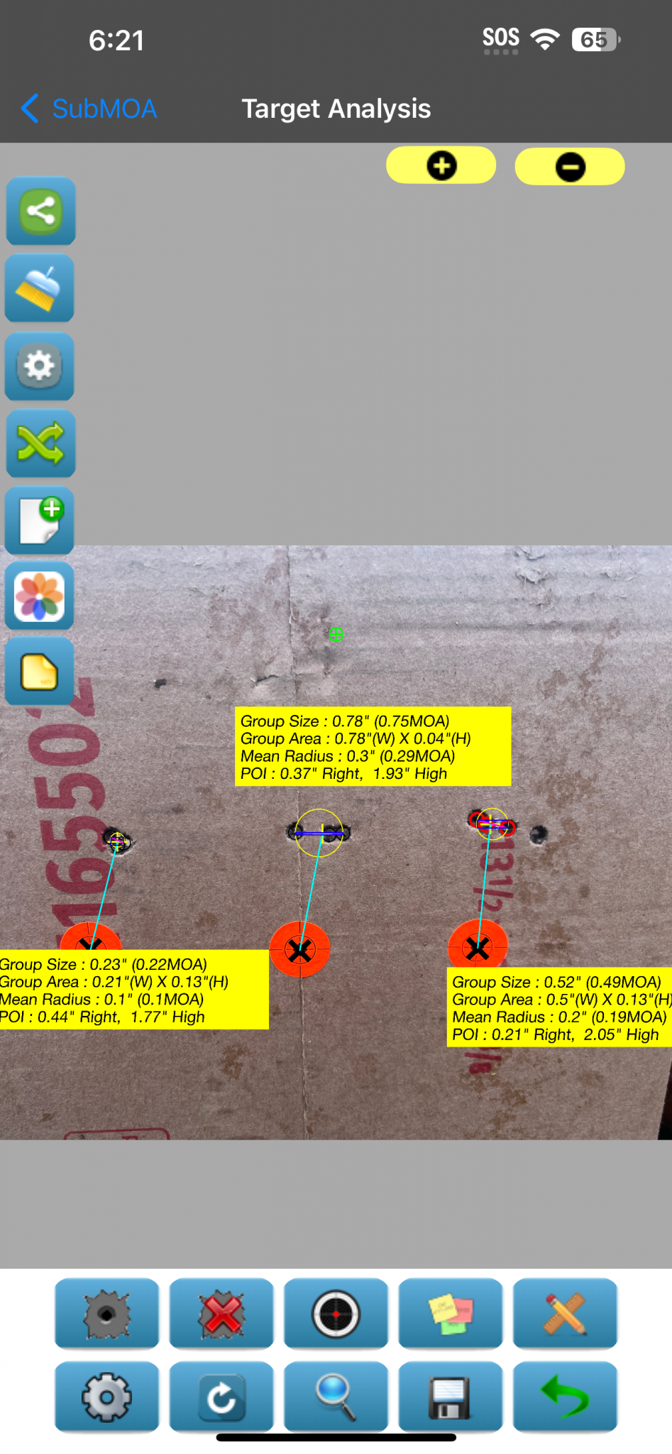

Going back out for some confirmations this morning, but here are some results with my Savage 110 Elite Precision that I chopped to 18” and run exclusively with a YHM Resonator K. These are the 2 that shot the best for me out of 8 different loads I tested. Loaded 20 of each to see how they do. Also just for shits and grins I loaded 5 rounds of the N540 load at 41.8 to see if it holds together. Since 41.2 didn’t shoot too hot, 41.5 may be the start of the node or an anomaly. Really grown to love N540. It is super versatile and usually has pretty tiny SD’s. It has worked in every caliber I have tried it in but really seems to shine in 223, 308, and 6.5x47.
All Lapua 1x fired with a 210 primer and a 175RDF at 2.288BTO
Varget 43.5
Average 2595
ES 15.2
SD 6.5
Shot a .141 but only a 3 shot group
N540 41.5
Average 2512
ES 7.3
SD 3.3
Shot a .207 but only a 3 shot group

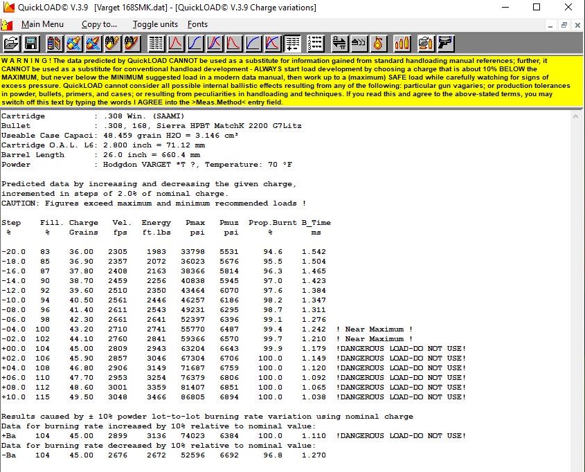

Would anyone here consider 45 grains of varget too much for a 168 in a properly executed standard saami chamber? I'm having some issues with my bolt lift after 50 of this load this weekend. Peterson srp brass, 45 of varget, cci br4, 168 match, 2.8 coal l. Bolt is now difficult to lift, rough on empty chamber. Only with FP forward
What do you think when looking at this (note the psi pressures and temperature):
Your bolt lift is hard on an empty chamber?
It was about 50 degrees out
I havent got quickload so thank you
Perhaps a little warm then.
Hodgedon lists 46gr as a safe max. Brass has no signs of pressure. Tikka action. And now the bolt is super hard to open. Both of my bolts. With the barrel off too
Reactions: straightshooter1
