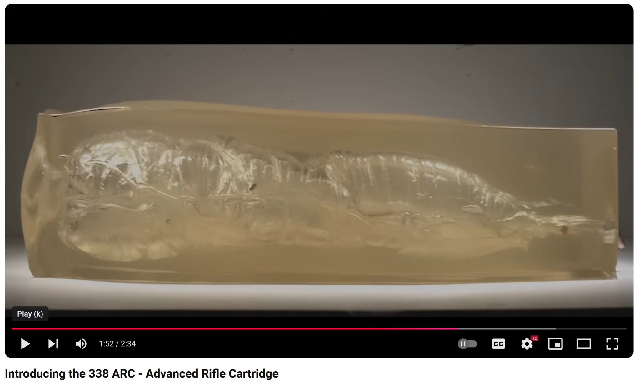

Hornady is stating that the new .338 ARC is capable of anything someone would use a 44 Magnum for.
I think that will make it more mainstream than it otherwise would be.

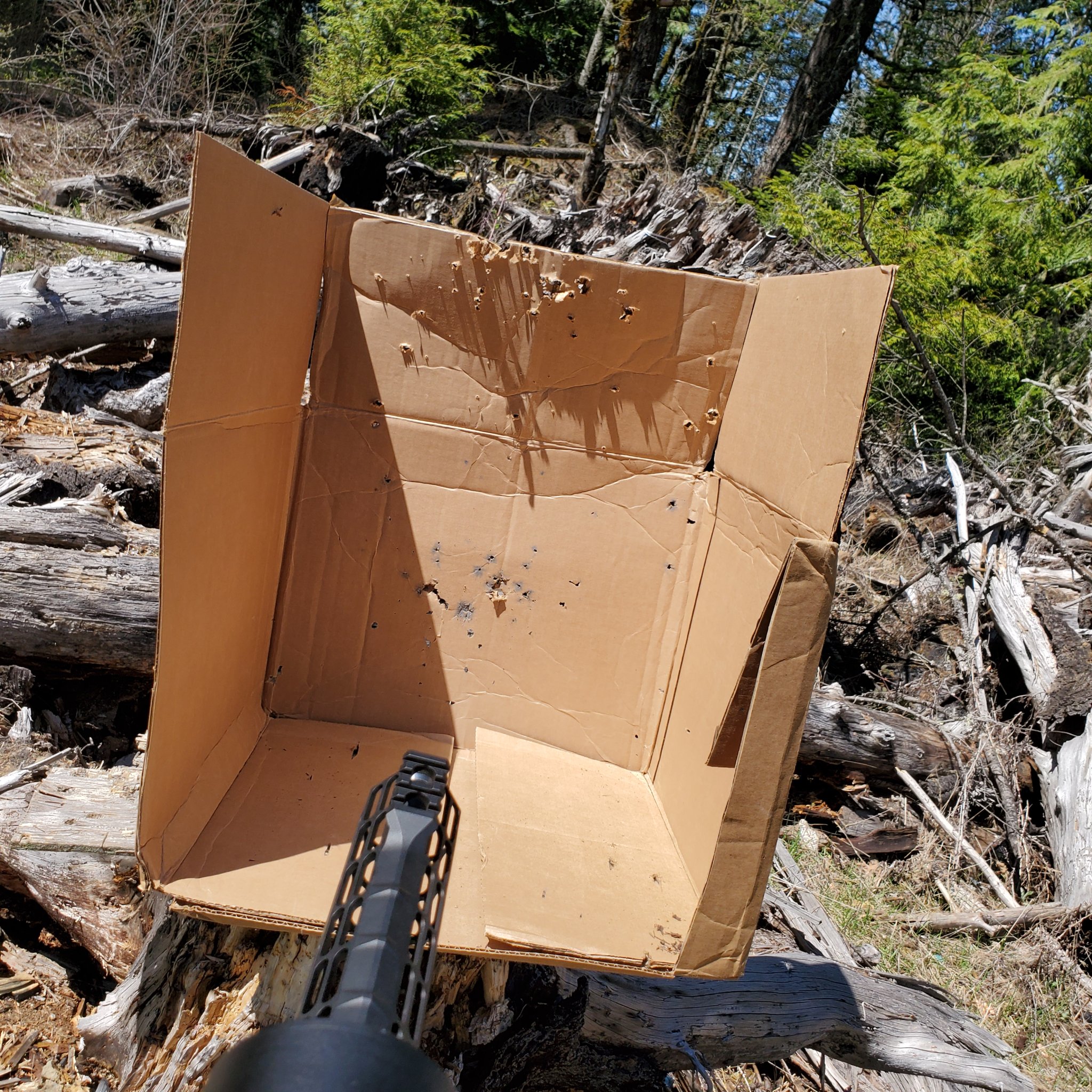

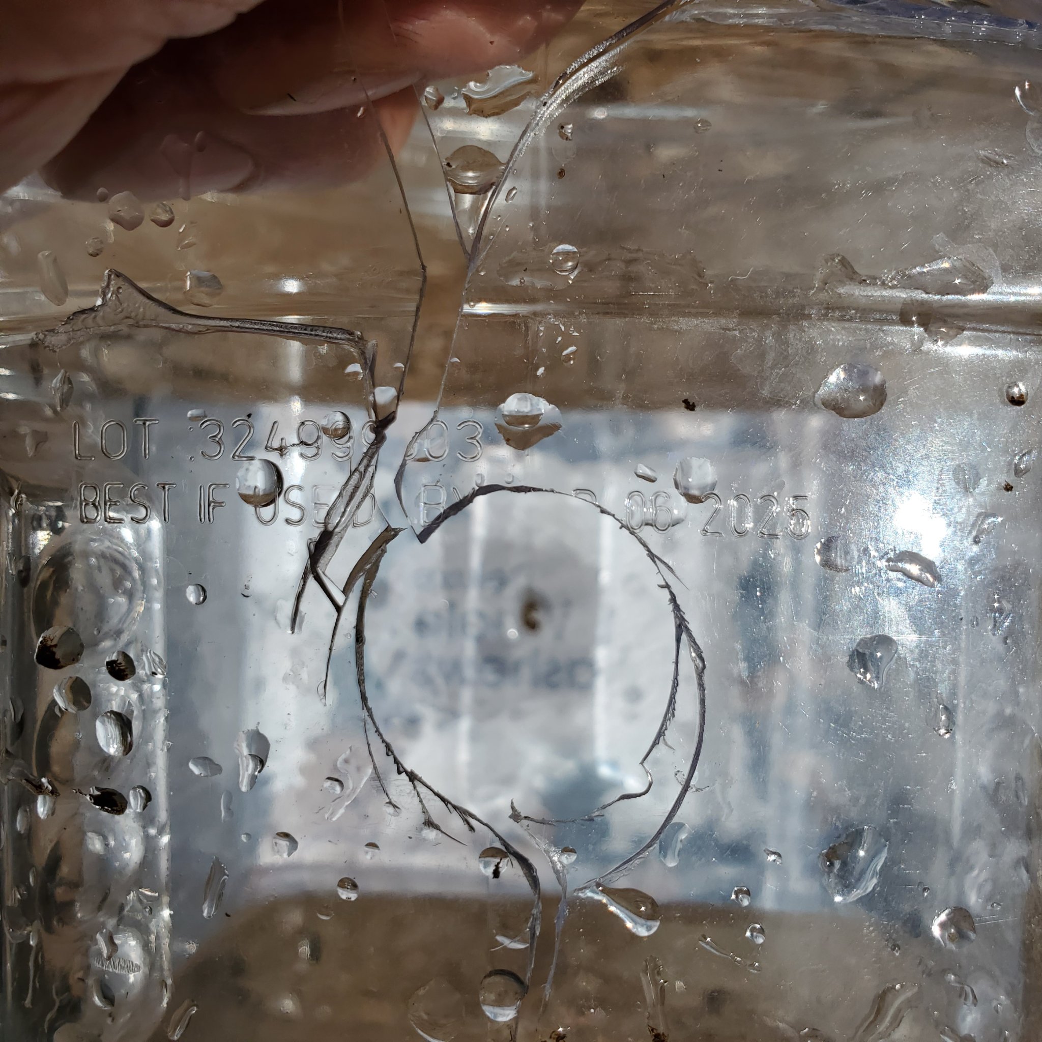

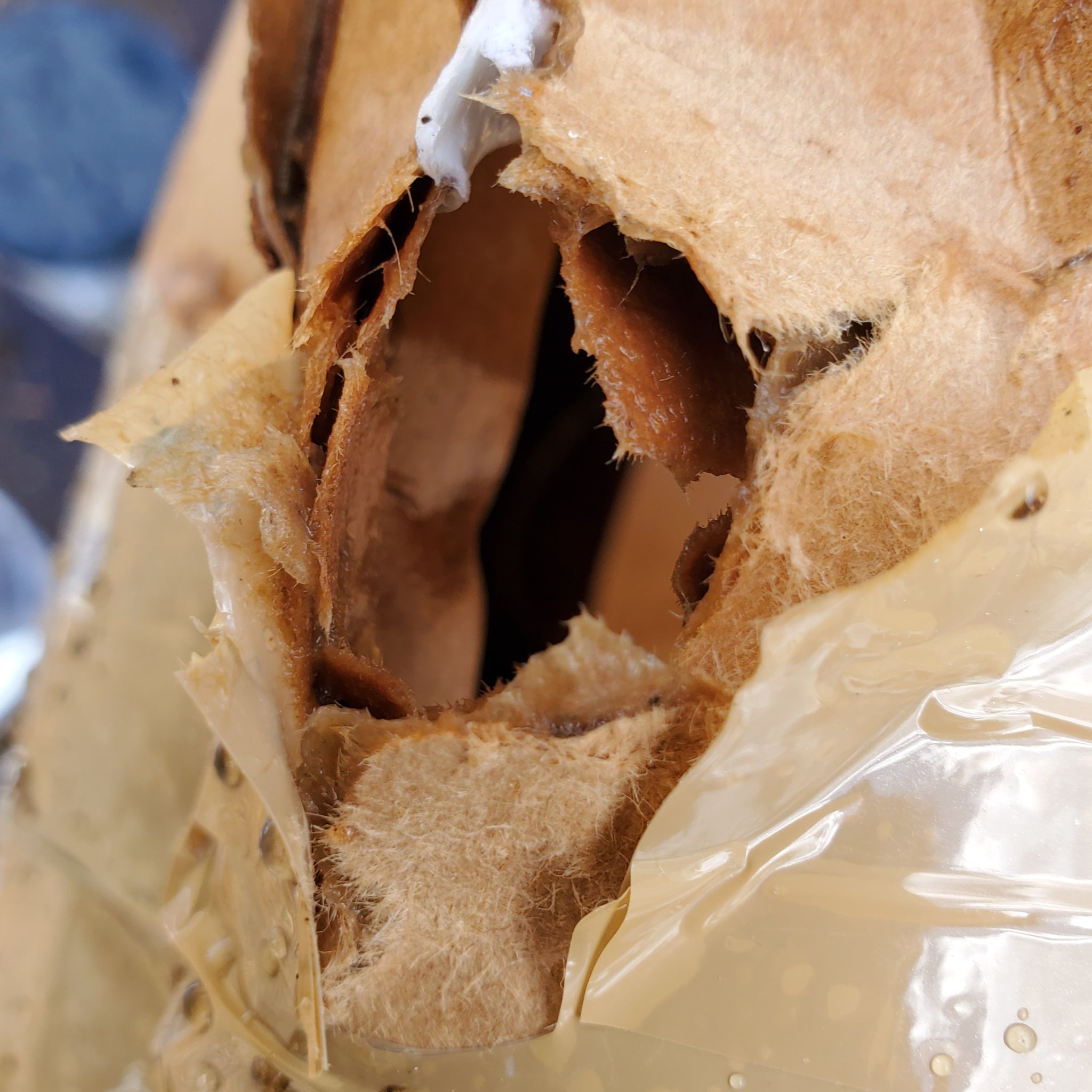

Apparently plexiglass in front of a wet cardboard box, with maybe some shaving cream or glue in there lol
It was a 2 liter bottle of water...lol.

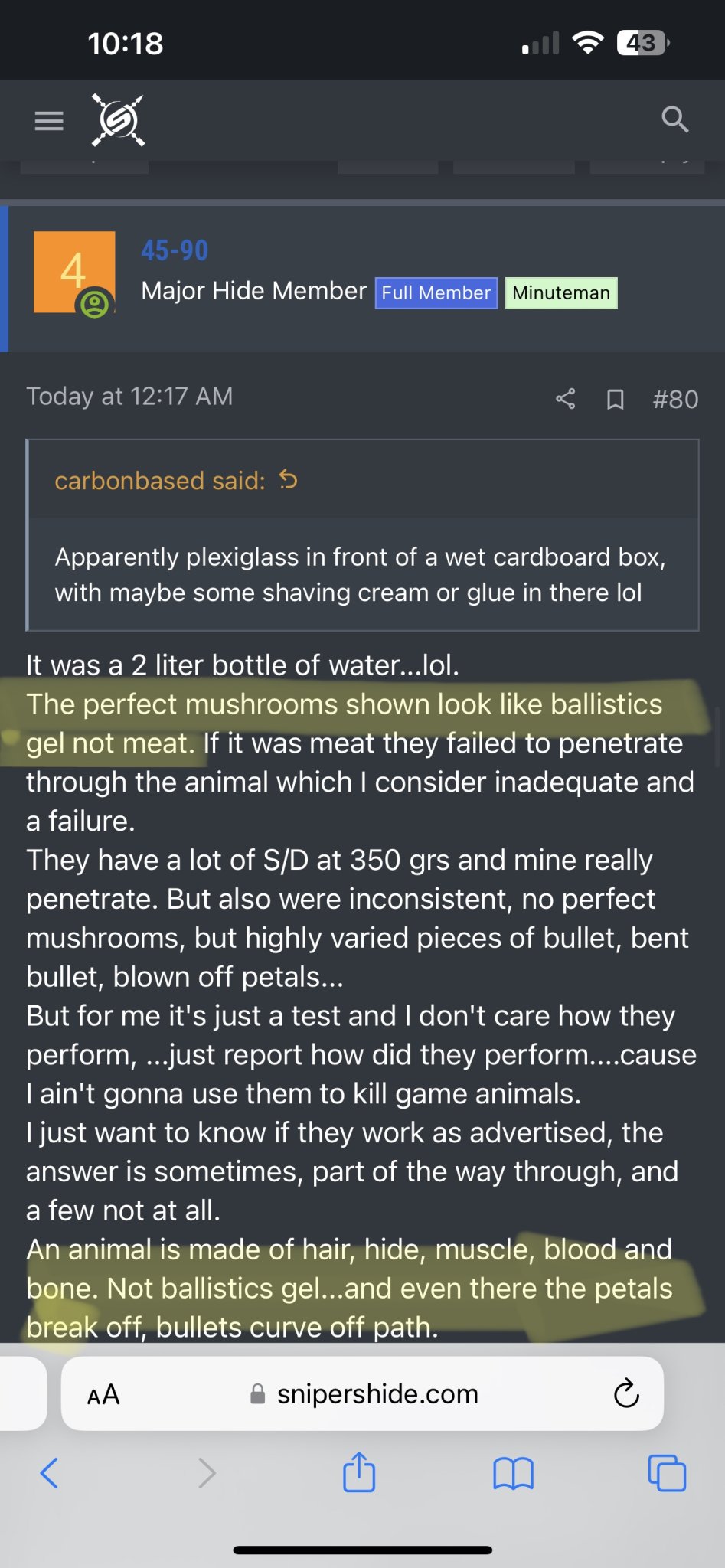

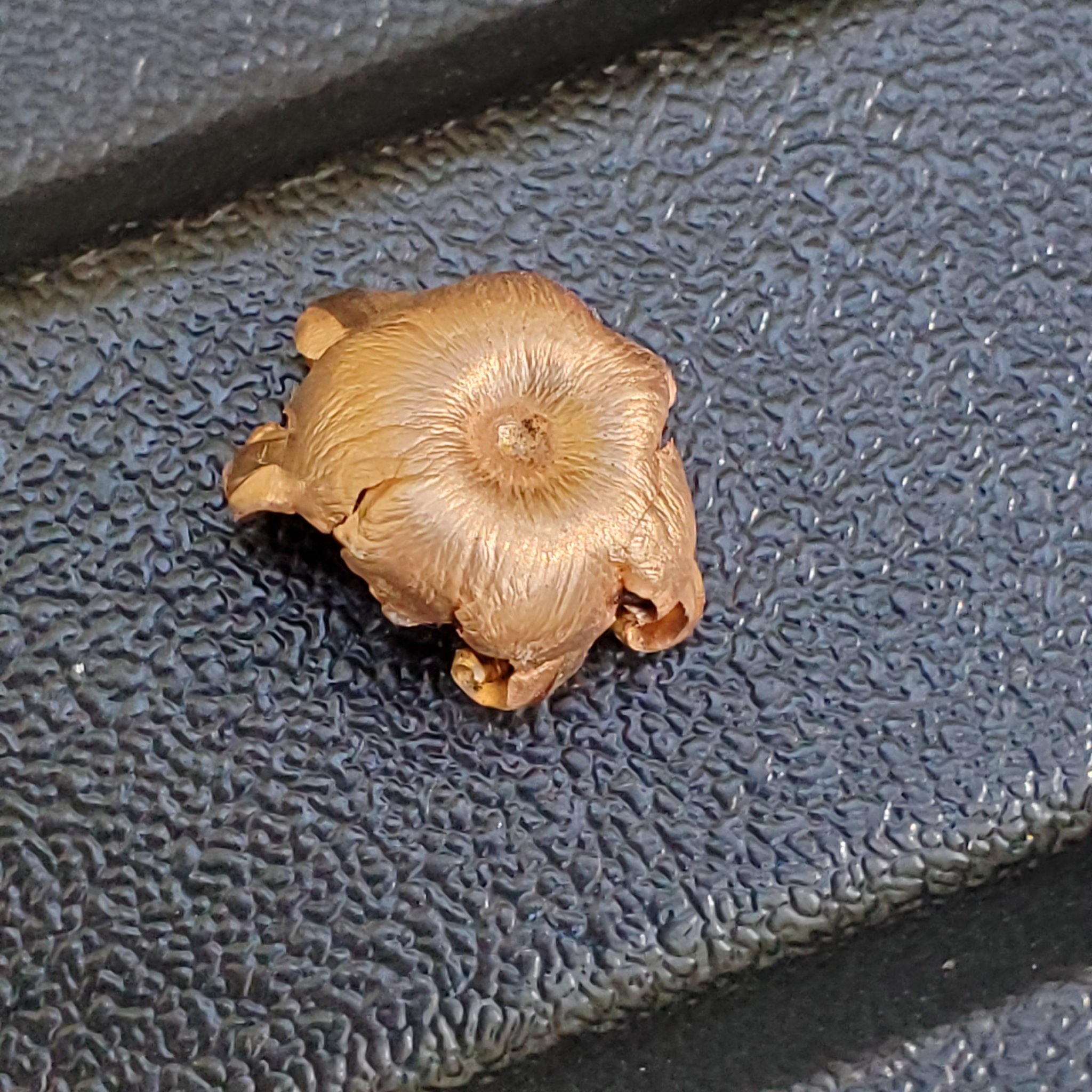

The perfect mushrooms shown look like ballistics gel not meat. If it was meat they failed to penetrate through the animal which I consider inadequate and a failure.
They have a lot of S/D at 350 grs and mine really penetrate. But also were inconsistent, no perfect mushrooms, but highly varied pieces of bullet, bent bullet, blown off petals...
But for me it's just a test and I don't care how they perform, ...just report how did they perform....cause I ain't gonna use them to kill game animals.
I just want to know if they work as advertised, the answer is sometimes, part of the way through, and a few not at all.
An animal is made of hair, hide, muscle, blood and bone. Not ballistics gel...and even there the petals break off, bullets curve off path.

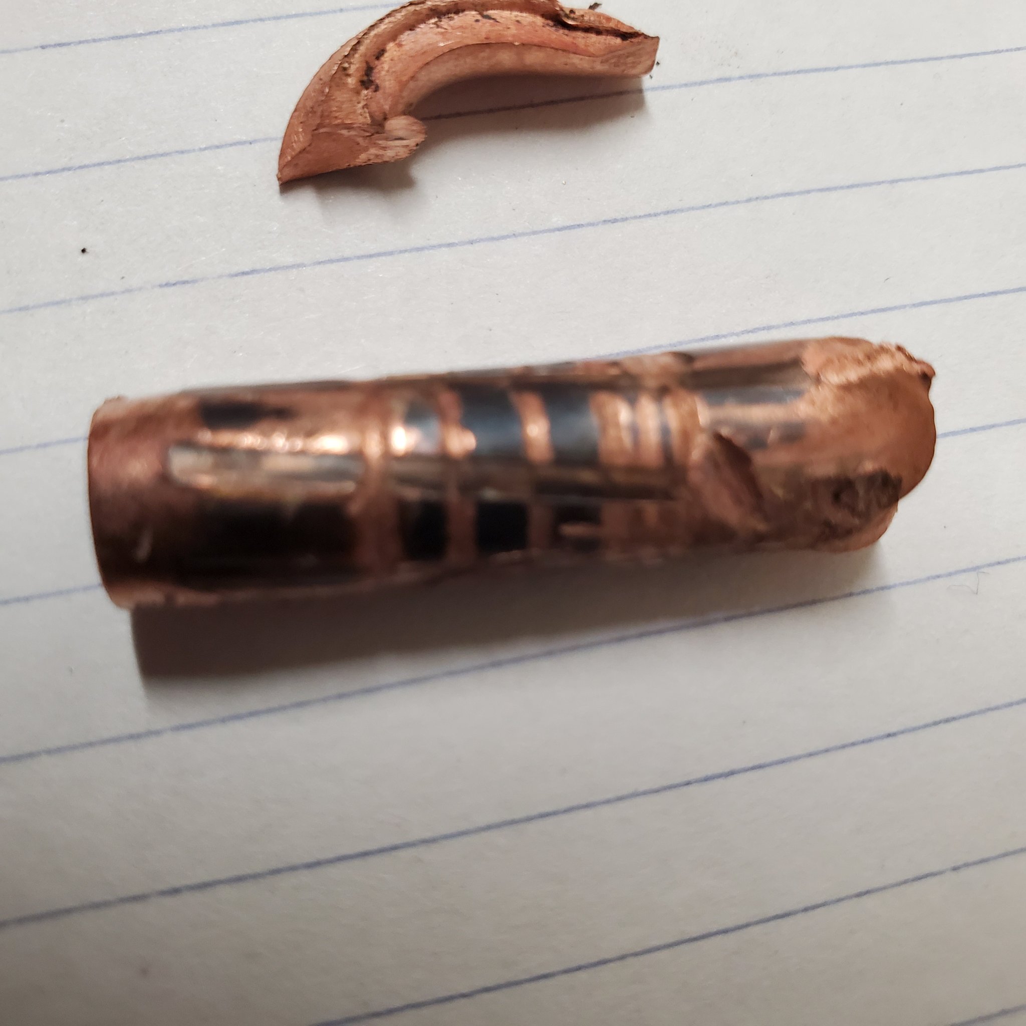

They had trouble with the 3 twist 1000 fps a new lot says 1050 max fps... cause the petals blow off before reaching the target.
Like my muzzle brake and magneto speed bayonet.
Very dangerous, csuse ya don't know which way all the shrapnel is going, bullet fragments and muzzle brake fragments.
The 338 ARC will be better here with the 8 twist...but you'll have to get the correct bullets for it. As they may not open up with Maker 3 twist bullets, cause they make them for the 338 Spectre with 6.5 twist would be a better bet for performance, in your 338 ARC.

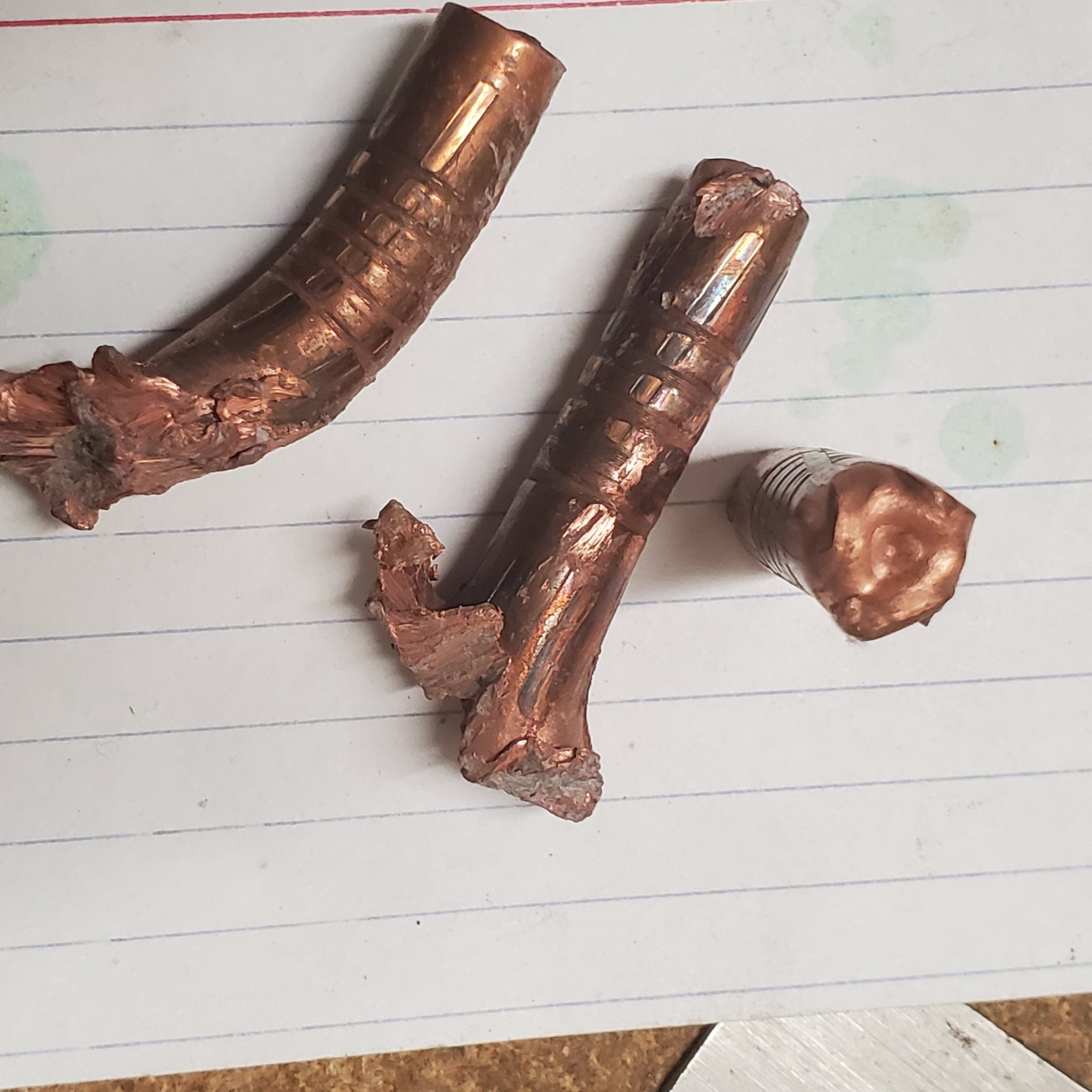

Yep, I tested blowing up bullets on purpose with a recommended load in the 3 twist.
This time no muzzle device or chronograph...barrel inside the box the bullet blows up as soon as it leaves the confines of the barrel...sending pieces of bullet to all sides of the box, back, top, bottom, & sides.

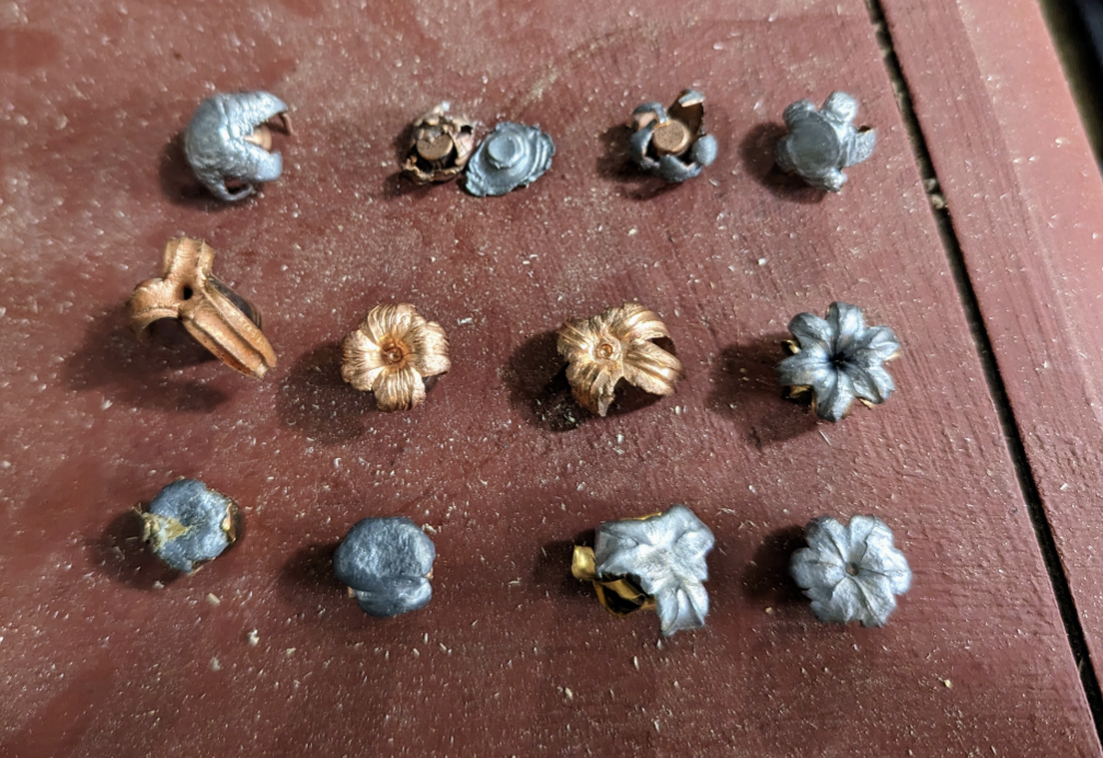

It was meat. I said it was meat. A bone in pork shoulder, taped up with black gorilla tape with three layers of denim taped to the front. Backed by water jugs and finally plywood to stop the bullets. I've tested a lot of bullets this way.
190gr SUBXs, 200gr Makers, RMR 9mm Nukes, 9mm Gold Dot HP's. All going between 1000fps and 1060fps.
120gr 6.5mm Speer GDHP, Hornady 55gr SP, 2 x 62gr Speer GDHP, 200gr Maker, Barnes 130gr TTSX, Barnes 110gr TAC TX, 124gr GDHP, 2x147gr GDHP, 124gr RMR Nuke, 115gr modified Nuke.
This medium shows some pretty consistent results with multiple bullets. And it show where some bullets fail. Like the Speer 147gr Gold Dots. Fail to expand well until they're over 1050fps. The Barnes 130gr TTSX is borderline at 2800fps. The TAC TX is phenomenal at 2450fps. The 200gr Maker has a bent petal from penetrating through the pork shoulder, three water jugs and bouncing off the wood backer.

So you're changing your goal post? First it was gel. Now it's because it wasn't a live animal? From the guy shooting water jugs... You can't even take a legible photo.
You won't have good data on bullets if you're only standard is live animals. Because you won't recover the majority of them. And in reality when you are talking about shooting people and animals, weird shit happens. People and animals live through some horrific things. Bones cause bullets to ricochet. We shot a guy with AH64's in the mountains of Afghanistan. 20-30rd burst. I watched the video. He lived, but it turned him into a vegetable. Weird shit happens. To isolate the weird shit, this type of testing really is the better way. And the only viable way. I agree about ballistic gel. It is like a comparator. It gives you a better idea about expansion and penetration compared to other bullets than it does how that bullet will actually perform in live tissue. So capturing after dead tissue is the only practical way of testing to provide empirical data.
You have done neither.
I didn't move any goal posts...just pointed out your "meat" target statement, and the phenomenal bullet recovery efforts, from implied big game animals.
I didn't imply anything. I said meat. You said I lied and shot gel. I clarified and then you tried to discount it because it wasn't live tissue. Yes. You did move goal posts. When confronted with facts and data you squirm and vacillate.
Only come clean after you're called out for your BS.... fact.
This is what you typed. You strongly suggest @JR1200W3 did not shoot them through any sort of meat, but through ballistic gel.
Then you hedge and say if it was through meat, well then it’s not good enough.
Why didn’t you just ask about what type of meat target it was before your accusation?

Meanwhile you shoot two-liter water jugs and post uncaptioned and often confusing pictures, as if others can read your mind?
That's why I said ainmal to clarify what I ment....as you all know to force him to come clean that he did not shoot live animals as implicated...by the meat statement.
And that his bullets would be considered a failure IMO, if they actually did not shoot through live animals, and he recovered that many from live animals, was highly unusual.
So he confesses, he only shot at target medium with some meat on it....as suspected. It Ain't the same as live animals bullet recovery and that's all I wanted to clarify, and that's all there is to it...The facts..
You talking about this post?
With these two pics?
He didn’t say these bullets were from live animals. Rather, he said they were from his meat target.
Am I missing a post here? Am I in…
He's talking about this post
See how the implication basically means shooting animals? Neither do I.
The reality is he got, got. He was corrected itn his BC comparison. He was corrected on the Maker bullets. He's just trying to hang in by his fingernails by concocting some sort of beef. He doesn't have a 338 Spectre. He doesn't really have anything to add but he feels like people need to listen to him. About a cartridge he has no experience with.
Oh yeah, I get that he’s “beefed” about the beef (meat) post you referenced.
I’m talking about all these bullets he said you supposedly recovered from dead animals (the quote in my post). Well, he said “live animals” but I assume he means “formally live animals” unless JR you are a fucking goddamn werewolf or some shit lol now I’m scared
