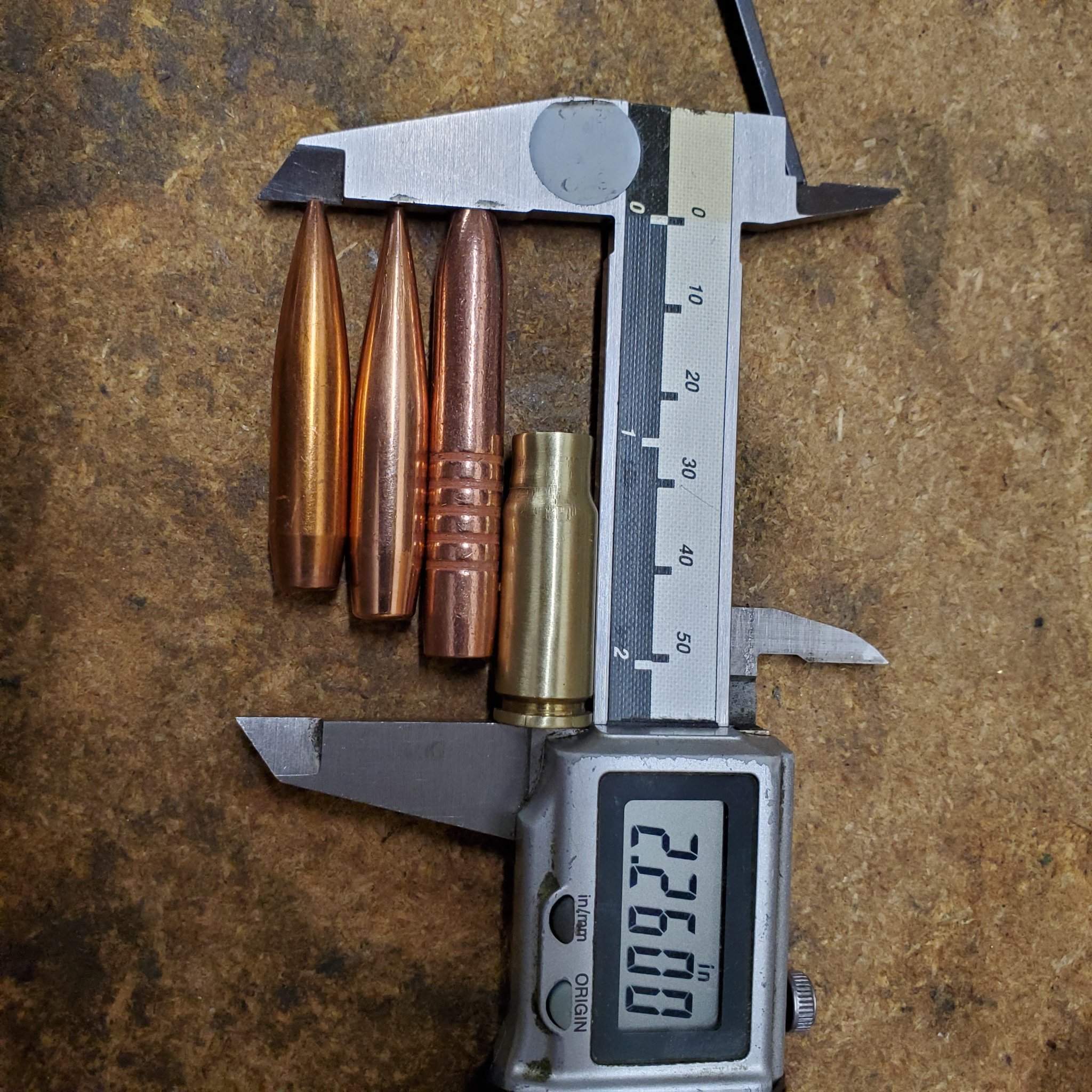

I made a die & mocked up an approximate case, as no dimensions but case overall length 1.293" was given 52, 000 psi operating pressure.
I made it .010" short to barley cover the 300 gr Berger ogive .3375" a slight crimp will take care of that, at 1.283"
I measured the case capacity of the cut down 6.5 Grendel case, shoulder dimensions & body taper may be off, but no print to go by.
The H2O capacity was 29.0 to 29.2 grains at 1.283" the case capacity for the 338 Spectre is listed at 28.8 in QL, as slight difference in COAL and body dia. There are 2 max pressures given one for pistol brass and one for 6.8 brass. QL uses the lower pistol brass load 37,500 psi and rifle brass was something like 55,000 psi...something to check out.
But just plug the numbers into the 338 spectre data, change the COAL, case capacity , & case overall length.
With 300 gr match bullets, in a 12" barrel QL predicts the pressures will be close to max with a variety of powders at around 1200 fps.
Which should give good sub accuracy, and consistency.
W296, 1680, AA9, AA 11FS, 2400, LILGUN, H4227, IMR 4227, CFE BLK, were all in the try area.
The 4227s, and CFEBLK were getting compressed at just over 107%
W296 and LilGun , ate the first I'd try, with 300 gr match bullets.
Charge weights look to be around 10 to 14 gr with those powders, & 300 gr match bullets.
200 gr in 12" barrel looks to be around 1600 fps
160 gr Barnes tops out at 1900 fps area.
All a guesstimate on what to expect.
The Spectre has a 6.5 twist and Maker makes a bullet for sub hunters to try in the Hornady 338 ARC 8 twist, that might work, the twist rate makes a difference on opening these bullets. (In my tests, LOL)
Maker also make a light 160 gr super expanding for the Spectre to try in the ARC, for those interested.
I think the 338 ARC will make a good sub sonic gun, with good barrels, and their may be a mag feed issue with the larger 338 bullets, plus barrel extension mods for proper feeding...the industry should take care of most problems, as they arise, as Hornady being behind this should help, if not you'll have to do your own modifications.

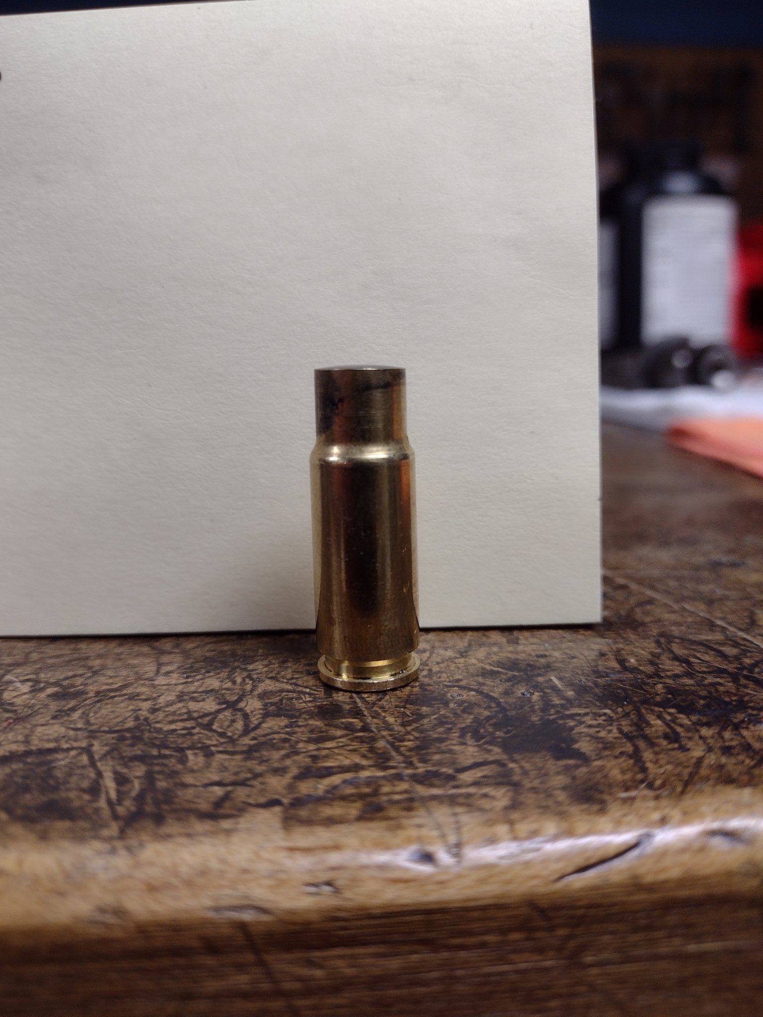

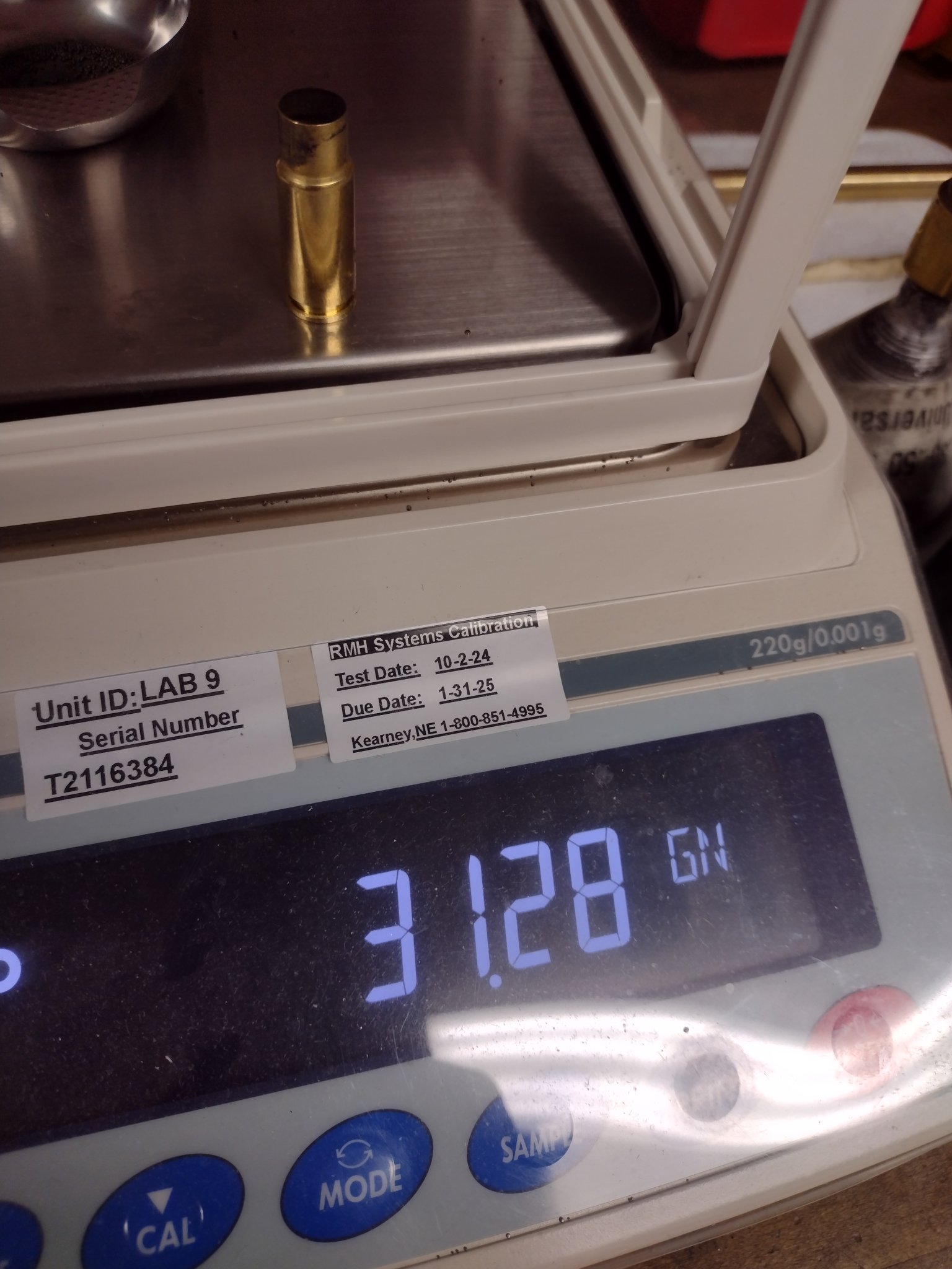

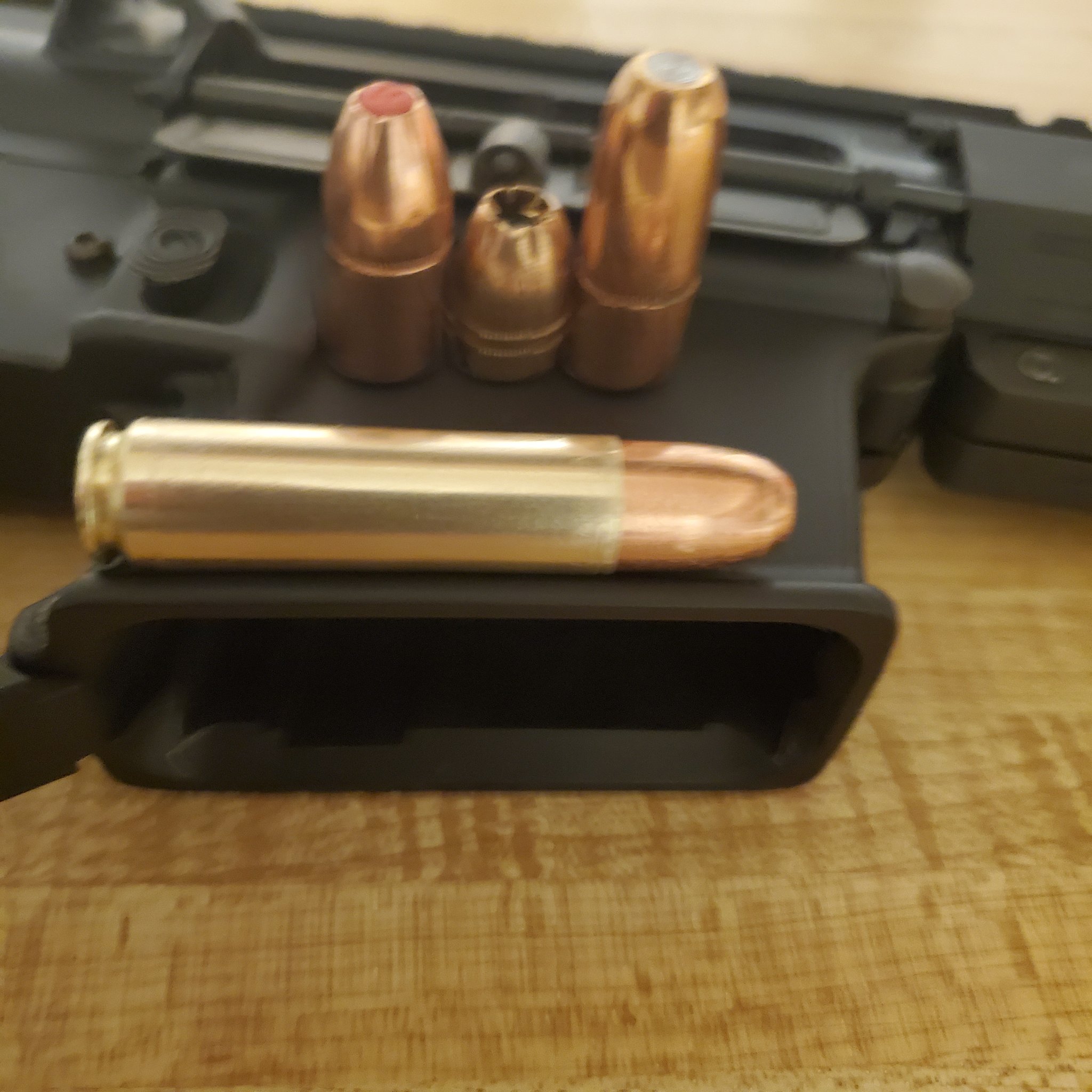

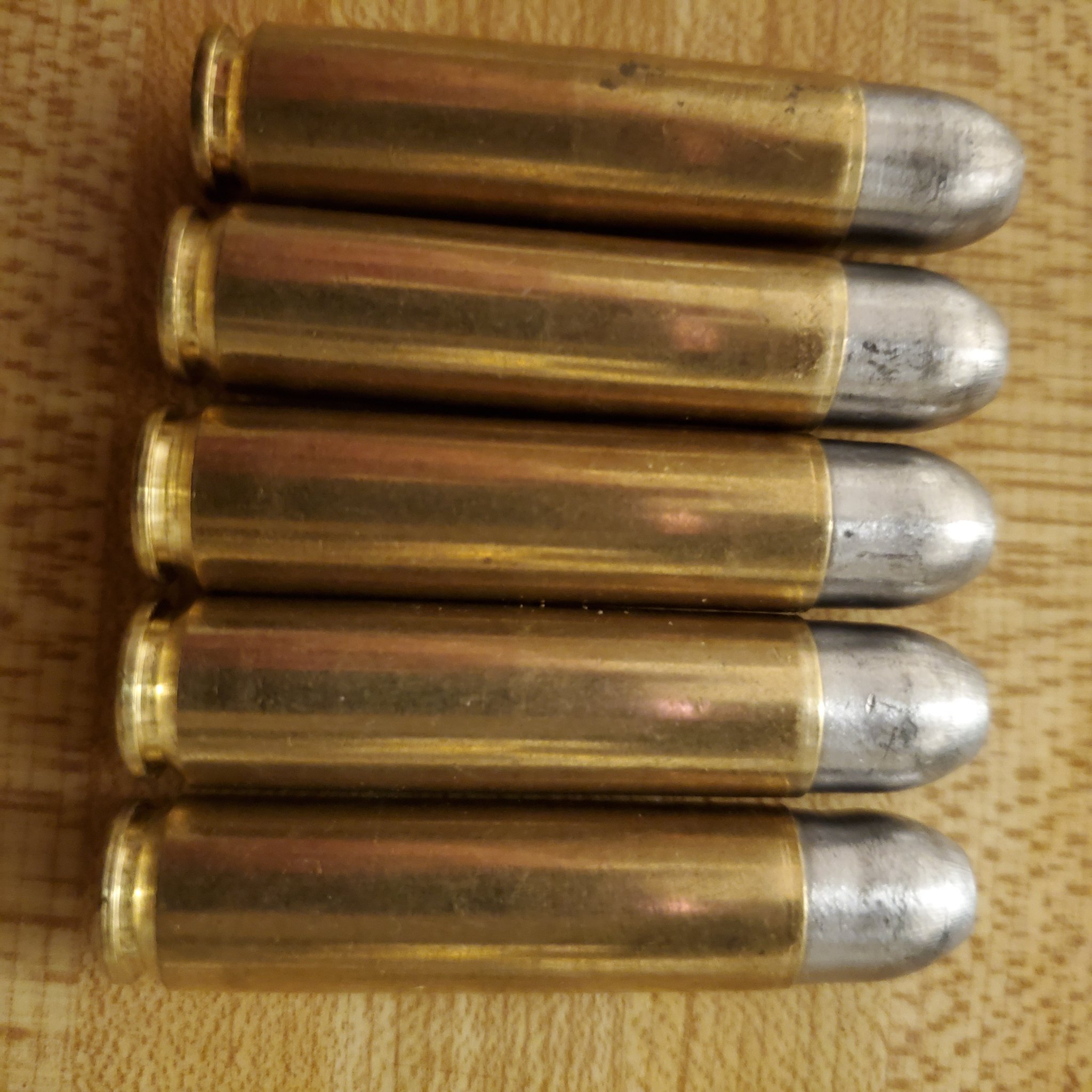

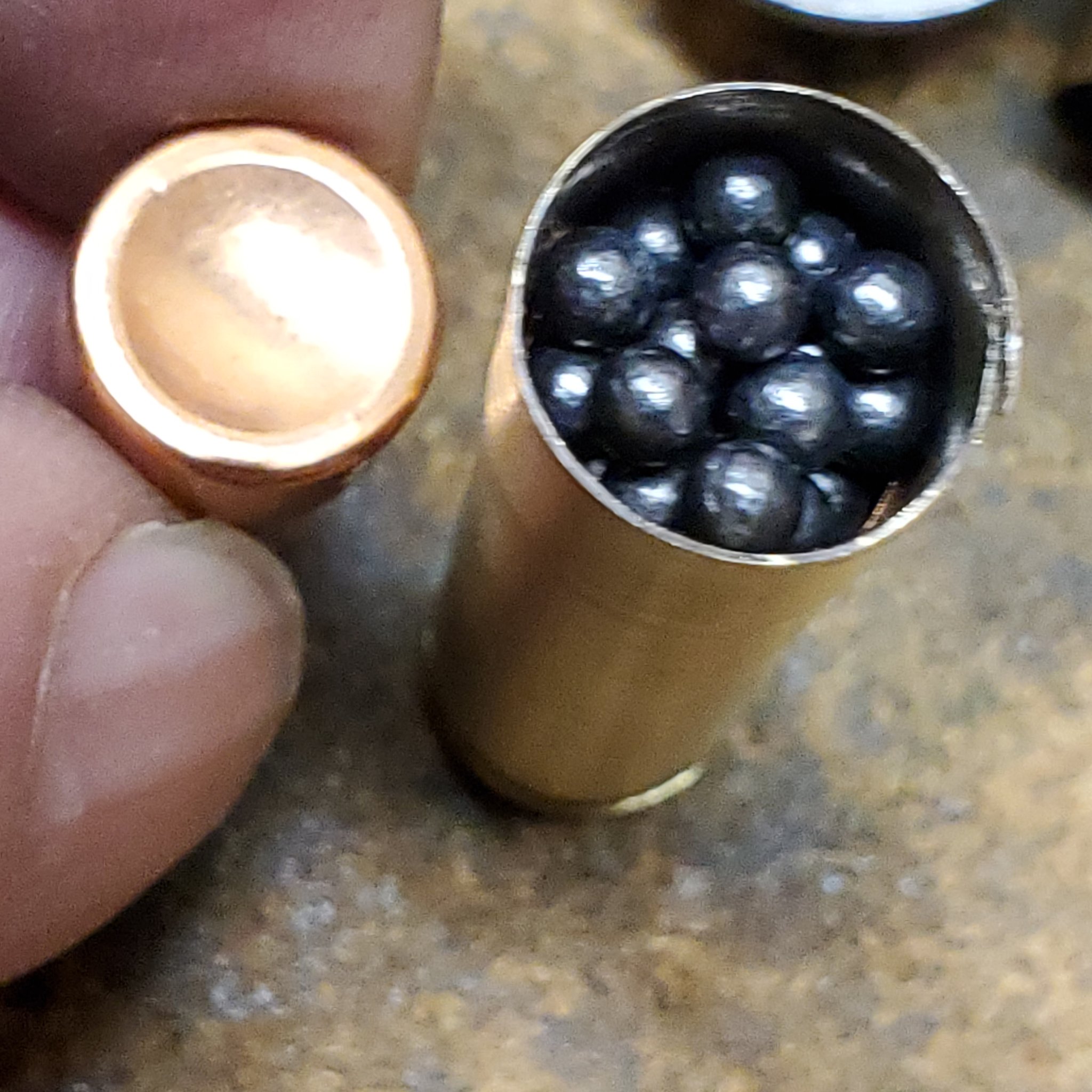

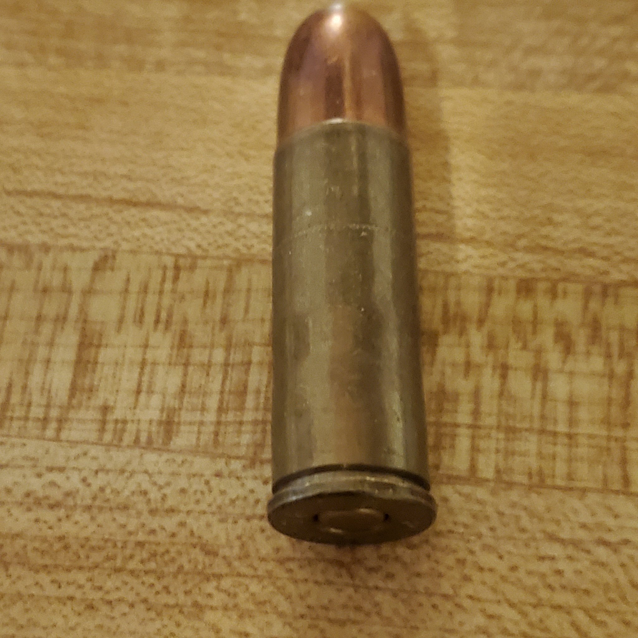

I'm a big fan of the 450 bushmaster, just installed a new 16 twist barrel on mine. Shoot every .451 to .458 bullet available from 185 gr up to 570 grs just resize them in cheap Lee resizing dies. Lots of supers are shot in mine including the 395 gr subsonic at 900 to super 1620 fps.
A favorite super is the 300 gr .458 Nosler silver tip resized .452 at 1970 fps.
Or weird loadings like shot and ball, for whatever...rats that invade your house?
Cheap 502 gr cast lead can be run up to 1350 fps area for Buffalo hunting with an ar 15 on the Great Plains.
Cheap bulk pistol bullets can be utilized use carbide 454 dies to neck em down tighter and a Lee light factory crimp die for a good powder burn on the 185/ 230 gr HP, mag dump plinkers.
The 338 ARC has nothing to offer over the 450 Bushmaster in killing power at sub ranges... My only interest in it is accuracy with match bullets, hoping it will be as accurate as my 6mm ARC. I ain't going hunting with it, but many others will.

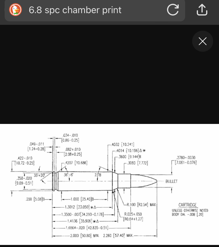

Some quick reading *seems to lend to the following-
6.8spc Bf is 0.422”
ARC is .445”.
I understood for a gas gun the BF are different.
It would be good someone who is at their stuff to verify. I’m out of pocket to confirm myself.
6.5 Grendel/6mm AR/6mm ARC/224 AR/22 ARC/338 ARC is .441” case head.
6.8 SPC/224 Valkyrie/338 Spectre is .422” or .425” for 10mm Auto Mag brass for the Spectre

Might as well go 450 ARC and use that 398gr .452 sub-x.
Basically a rimless 45LC, or a long 45 ACP
You can load 500 gr in 45 Colt 16" trapper win 94 but they go sideways...the 400 gr work great in win 94 and Rossi 454 carbine, 9 rounds of subs or high velocity.
