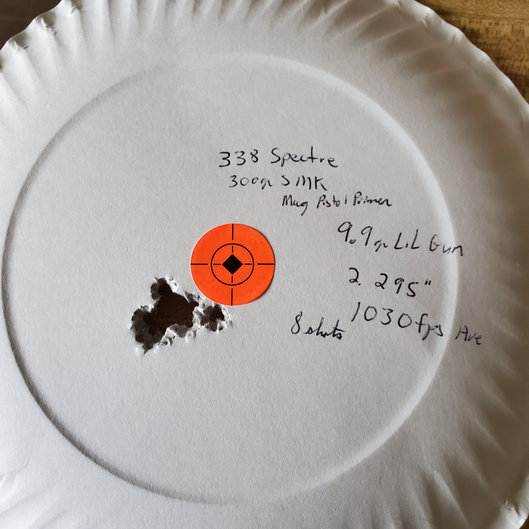

This 338 Spectre barrel has a 6.5 twist Hornady 338 ARC an 8 twist barrel.
I,m wondering if 8 twist is sufficient if you want to shoot say 300 gr SMK subsonic?

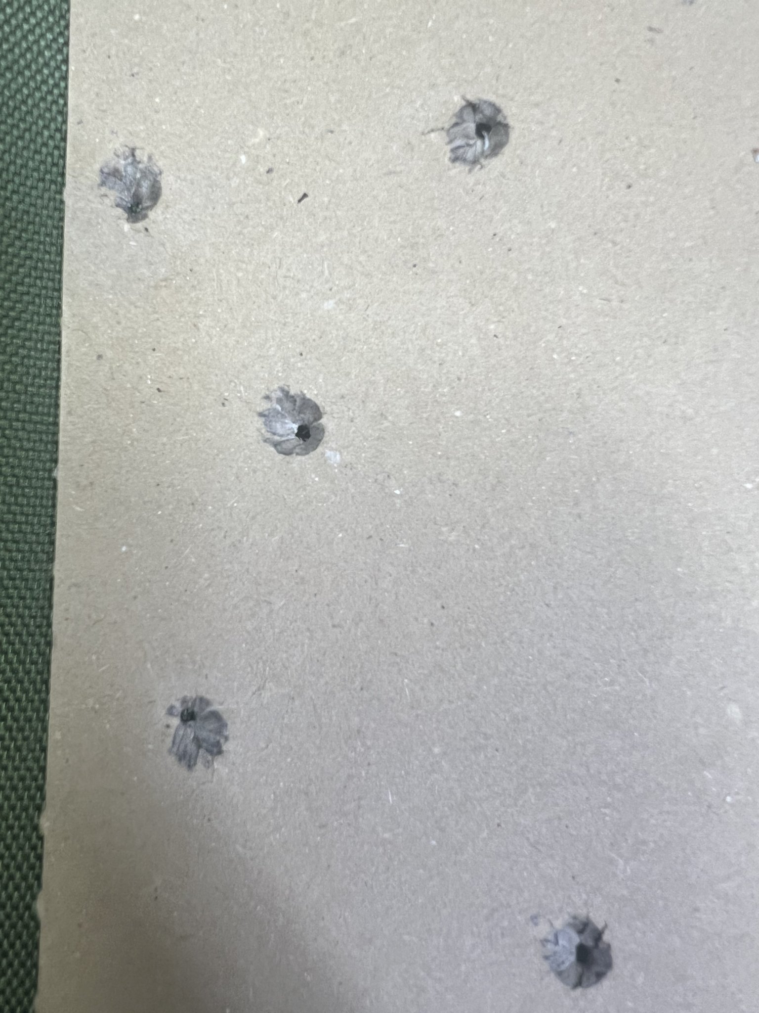

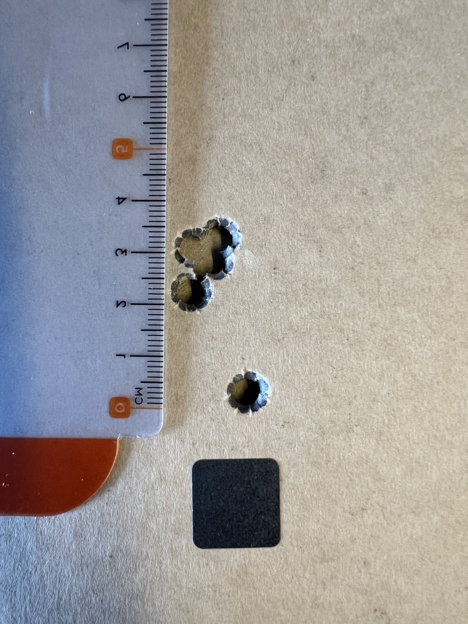

Here is 300 gr SMK at 300 meters in minus 5 degrees Celsius from a 7 twist barrel:
It’s not making a round hole, and if you look at several bullet holes in the same group, they’re entering whit different angles through the paper
At this point they don’t group well either..

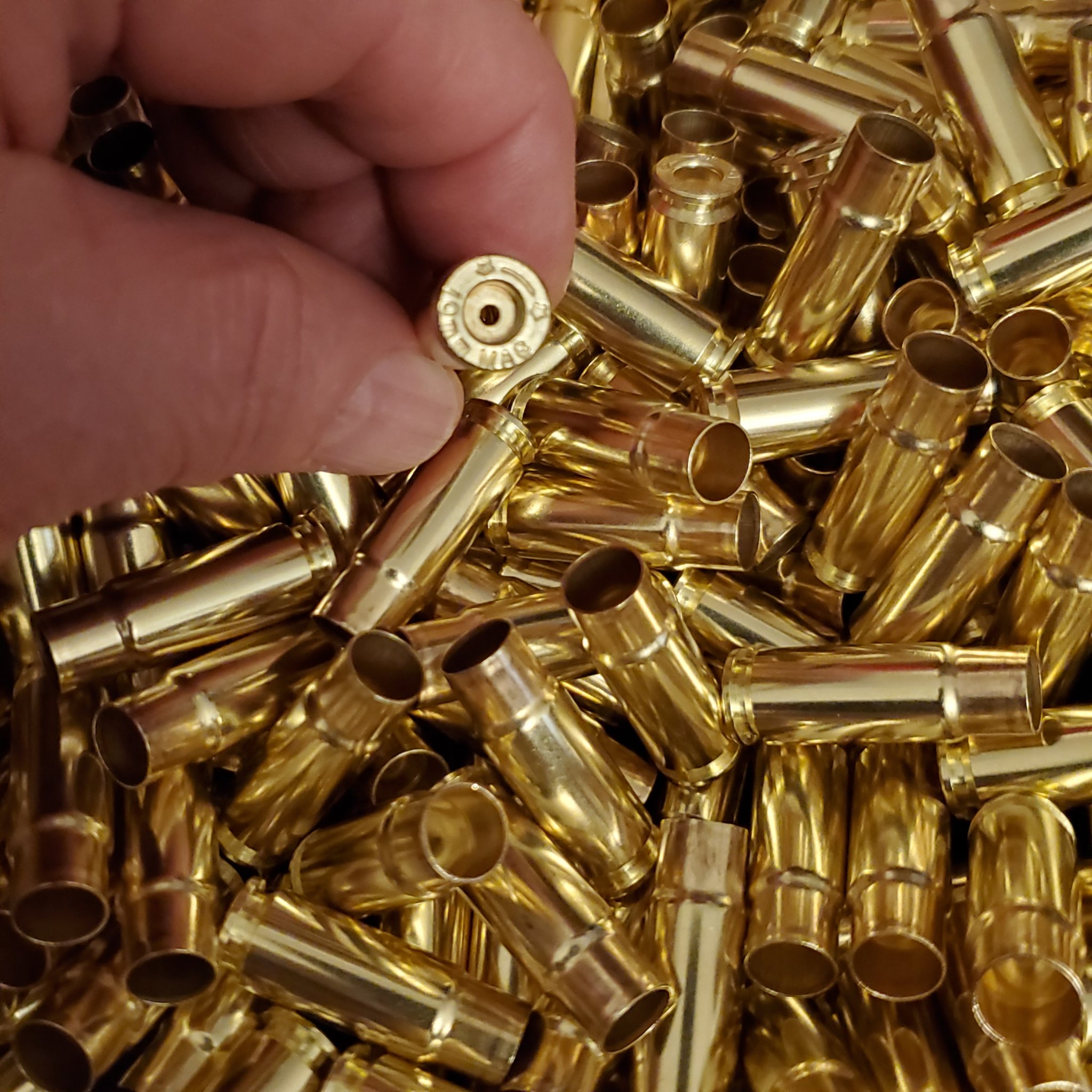

Based on a 10mm Magnum &/or 6.8 spc.
You can use either.

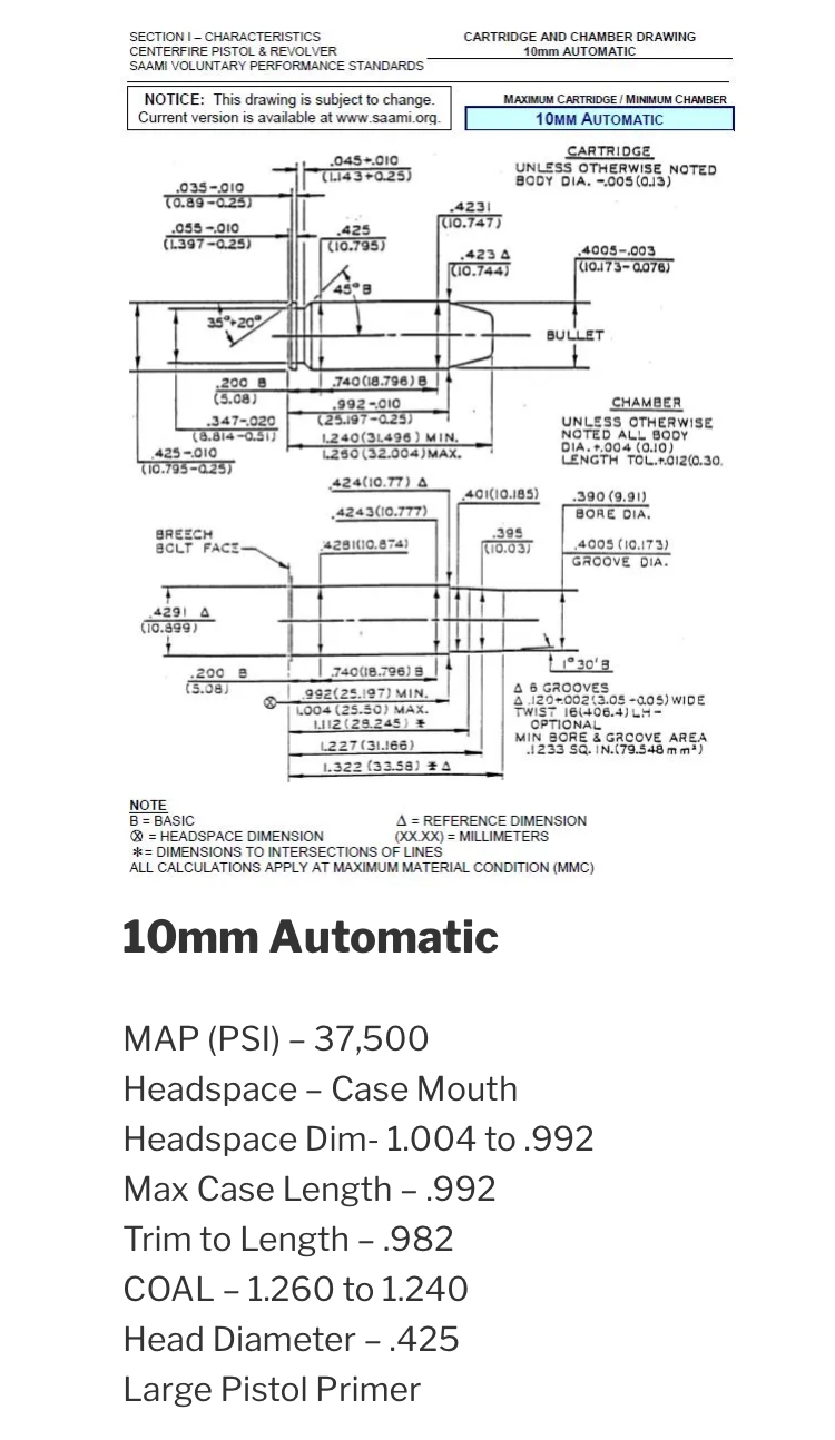

No the 338 ARC is .441-442" the 338 Spectre is .421 to .422" head area diameter. Grindel vs 224 Valkyrie, 6.8 SPC, 10MM Mag pistol, or 30 Remington, cut to length. With a short case their water capacities are very close. With in a grain or two, with only .019" to .020" different in head diameter. How deep the bullet is seated will make a big difference in either case.
A 10mm Auto is too short to be the parent case of the .338 Spectre, which has a case length of 1.250.
No its Starline 10 mm magnum, which are perfect... no trimming just anneal for best results and run through your 338 Spectre FL die $68 per set. Use on all sub loads up to 300 gr SMK then switch to SR cases the highest velocity for supers. They are so cheap ya don't care of ya lose a few.
The 8 twist is on the low end for subs with long 300 gr match bullets...a 7 twist should work according to Berger stability calculator.
But that doesn’t matter if you're have trouble.
So try a shorter bullet like the 250 SMK to see if things improve.
Hornady’s 307 gr sub is likely much shorter and will stablize in a 8 twist. But none are available, yet.

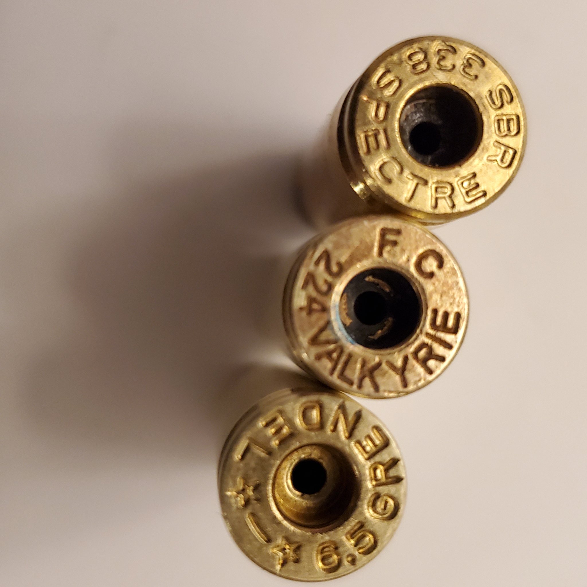

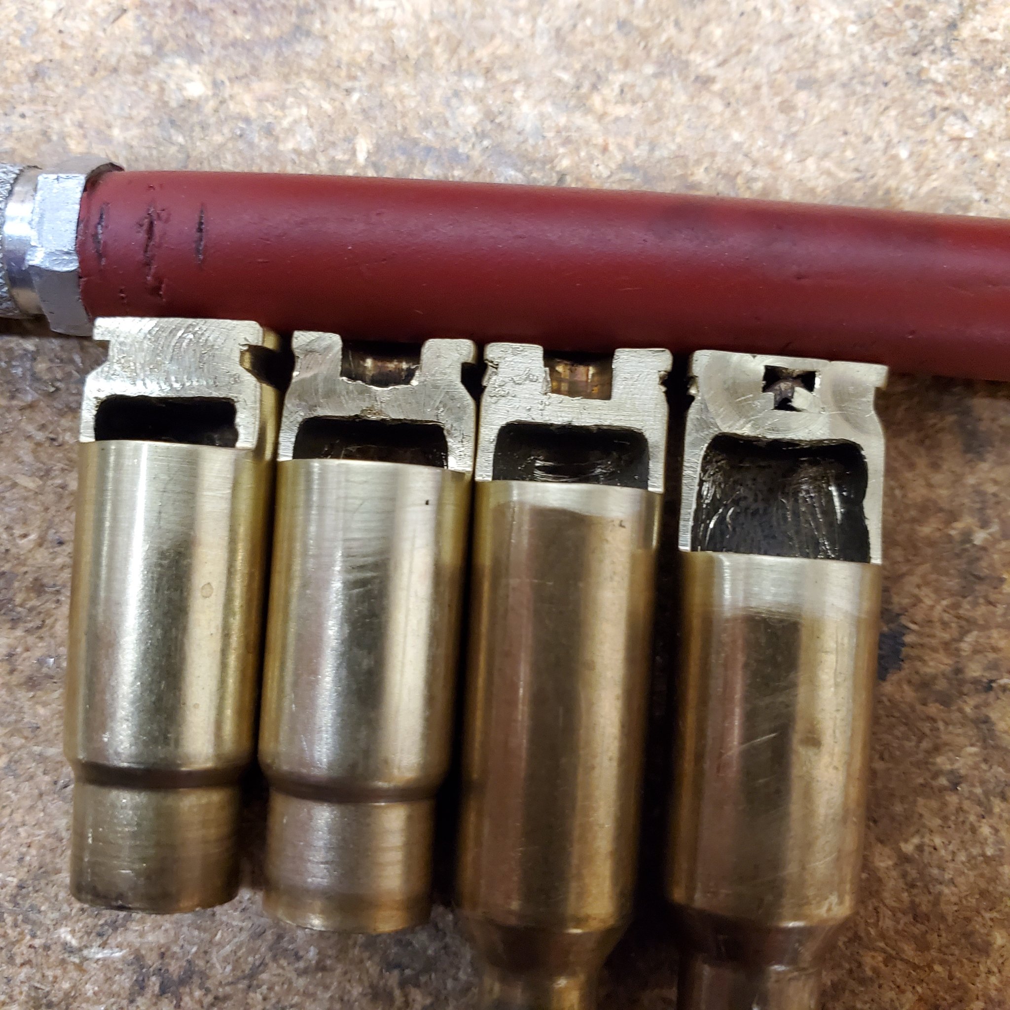

The SR Spectre brass and 10 mm Mag brass have basically the same case volume#1 & #2.
They all have the same solid head thickness 338 Spectre, 10 MM Mag, 224 Valkyrie, and the 6.5 Grendel.
I used the same collet to mill all the fired cases including the 6.5 Grendel, so the diameters of the fired cases are close enough for one collet to fit both.
So logically the brass head hardness, and alloy, plus firearm design will be the only factors in ability to take pressure, since they are all the same thickmess in the solid head.

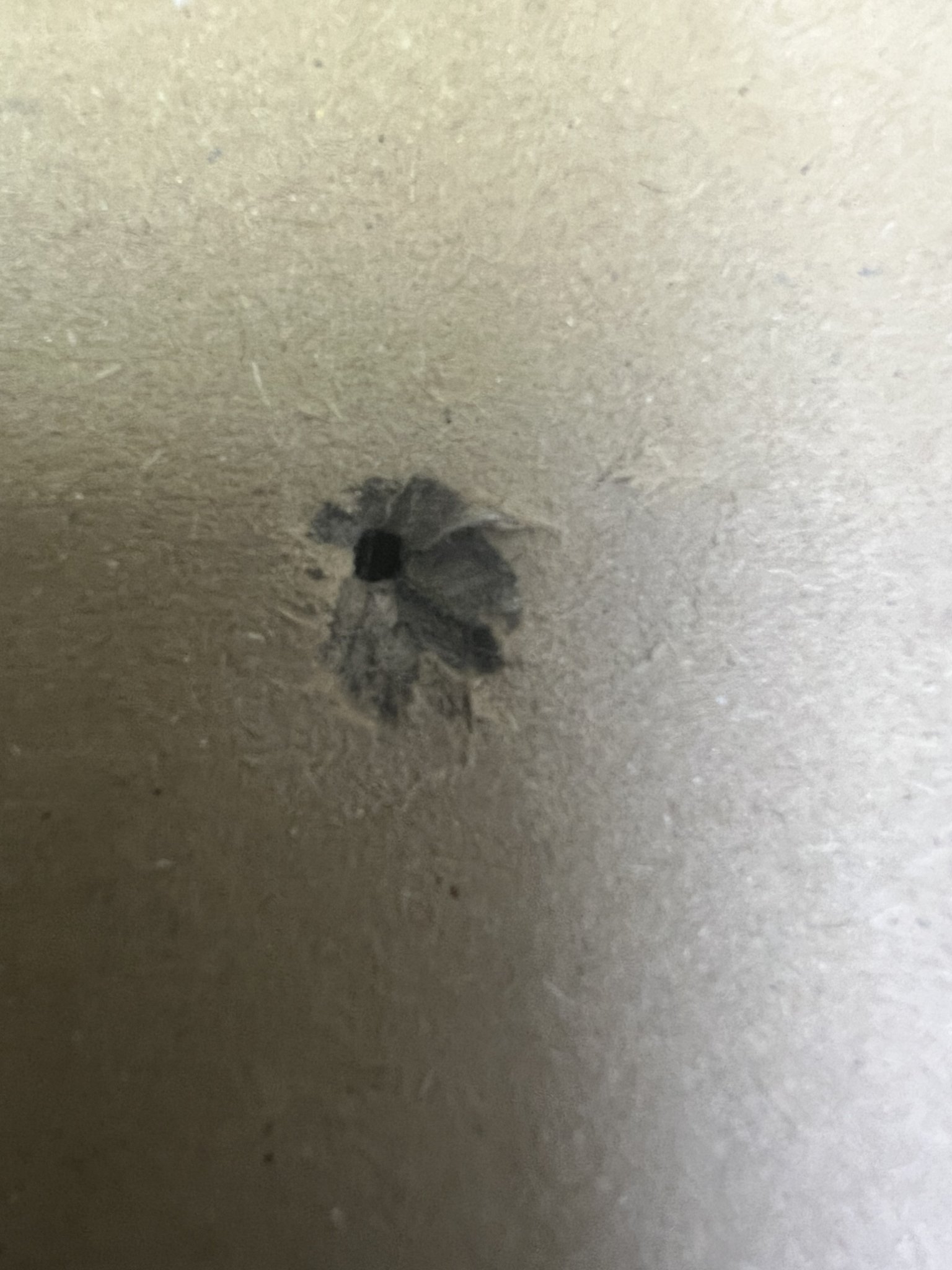

The Berger stability calculator uses the miller formula which is not intended for subsonic speed. It’s useless for that application according to Litz. I have not tried the 250 gr SMK or the Scenar/Lockbase, but I have tried to cut down the 300 gr SMK in the lathe. I chopped off 6mm of the tip, ending up with a bullet that looks like Hornady subX in the front.
At this point they make round holes again. Here at 100 meters
And here at 190 meters
I hope Hornady have tested the 338 Sub X thoroughly in 8 twist with Doppler radar before thy released it? Litz says subsonic flight is not yet fully understood, so I guess it’s all trial and error. I have examples of solids from Peregrine bullets that won’t fly straight in 7 twist that Peregrine says are stable in 9 and 8 twist.

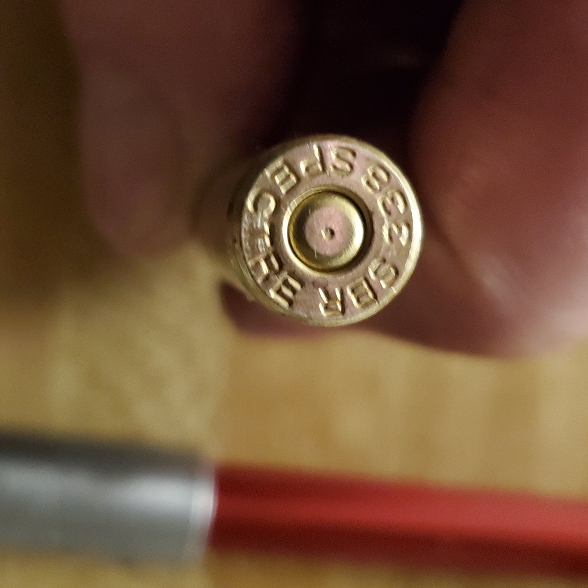

Because I'm not convinced of SBRs SR brass either. I think their brass may be soft but I haven't gotten through multiple firings on the 300 pieces I've bought to really see. And I think it remains to be seen how long SBR supplies it. They may have bought a huge batch from a brass manufacturer and it could be a one time availability. So If your option is to form it from also extinct 10mm Mag brass vs buying brass that you know is made from rifle brass a person should probably choose between the near identical cartridges based on brass quality and long term supply.
10 mm mag brass is available I just bought 500 rds, and formed it, and so is SBR SR brass.
The 10 mag brass has been great for subs and really cheap. So I'll use it for subs and moderate loads. The SR SBR brass appears to have a bit more strength so far, and is less than half price of Hornady.
Hornady has not been great brass either and I avoid it as much as possible. So you're right none of this brass is Lapua but it will do, for the intended purpose of the round, mostly subs. Mine is very accurate with a variety of reloads, especially 300 gr SMK.

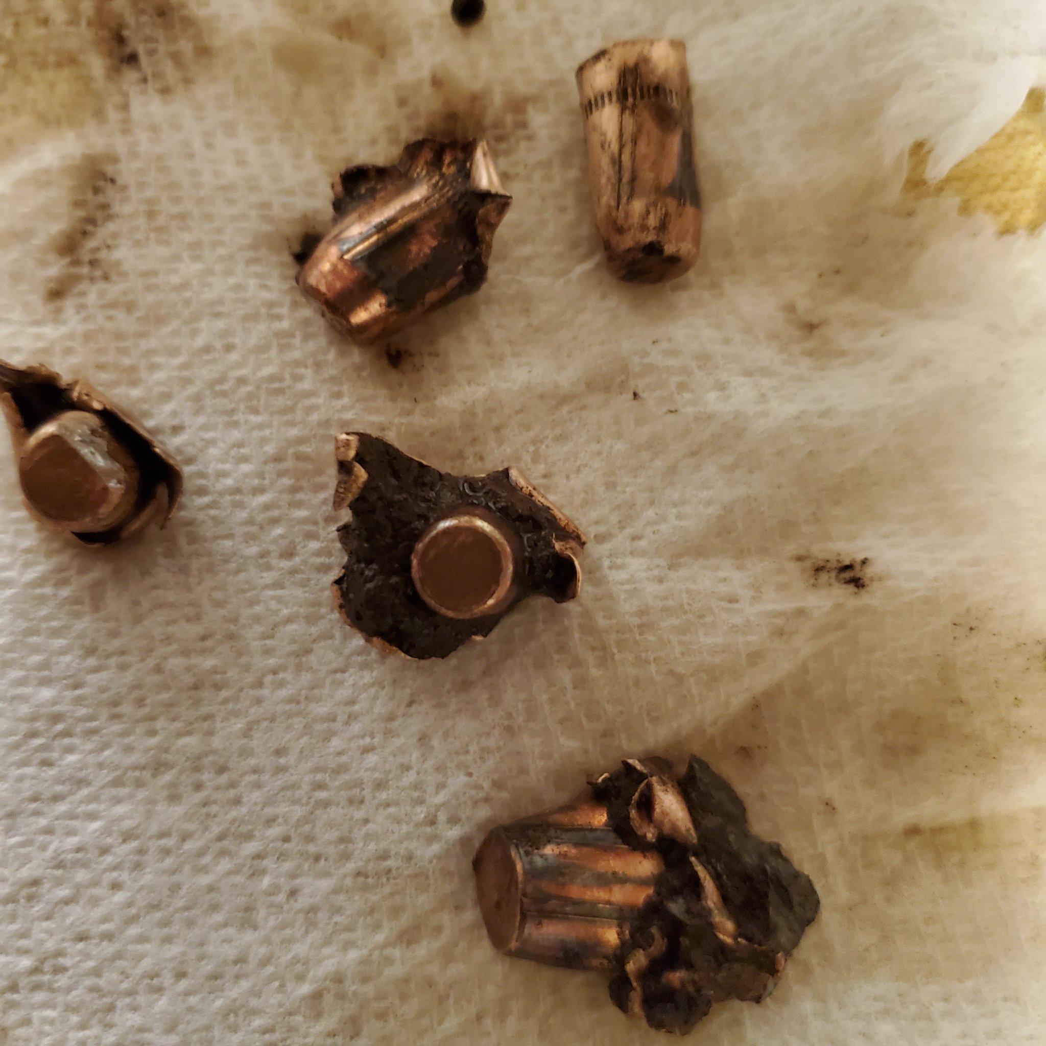

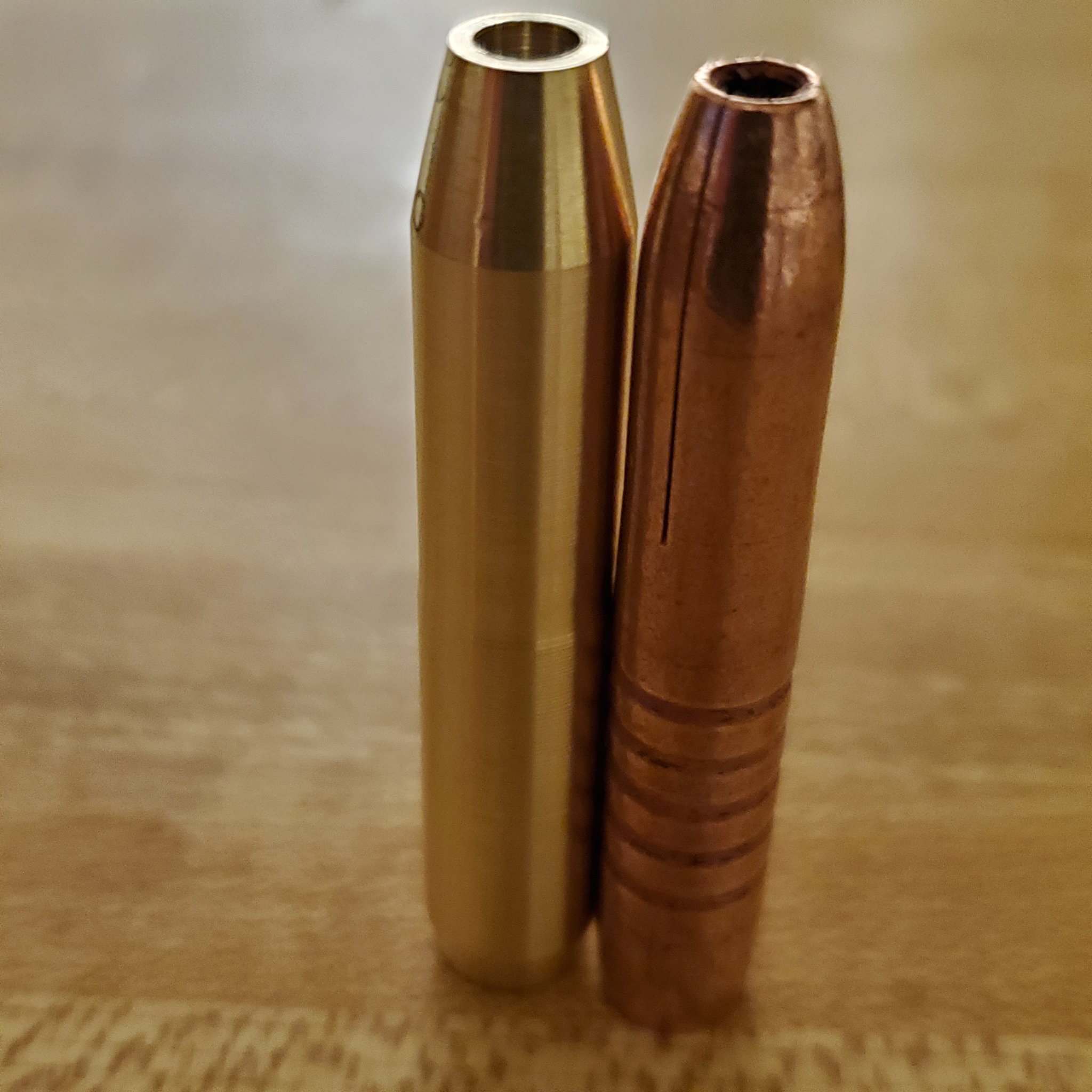

The 165 gr Maker super expanding bullet hit 2100 fps for a super load along with cheap 200 gr Speer at subs to 1900 fps with SR brass. The pistol brass will not make 1900 fps more than once, so 1750 or maybe 1800 fps would be a good max for it.
So I'm finding out what this brass will handle. May try some cut down 224 Valkyrie brass to see how it works for supers. But for subs the pistol brass works fine...so far in my experience.

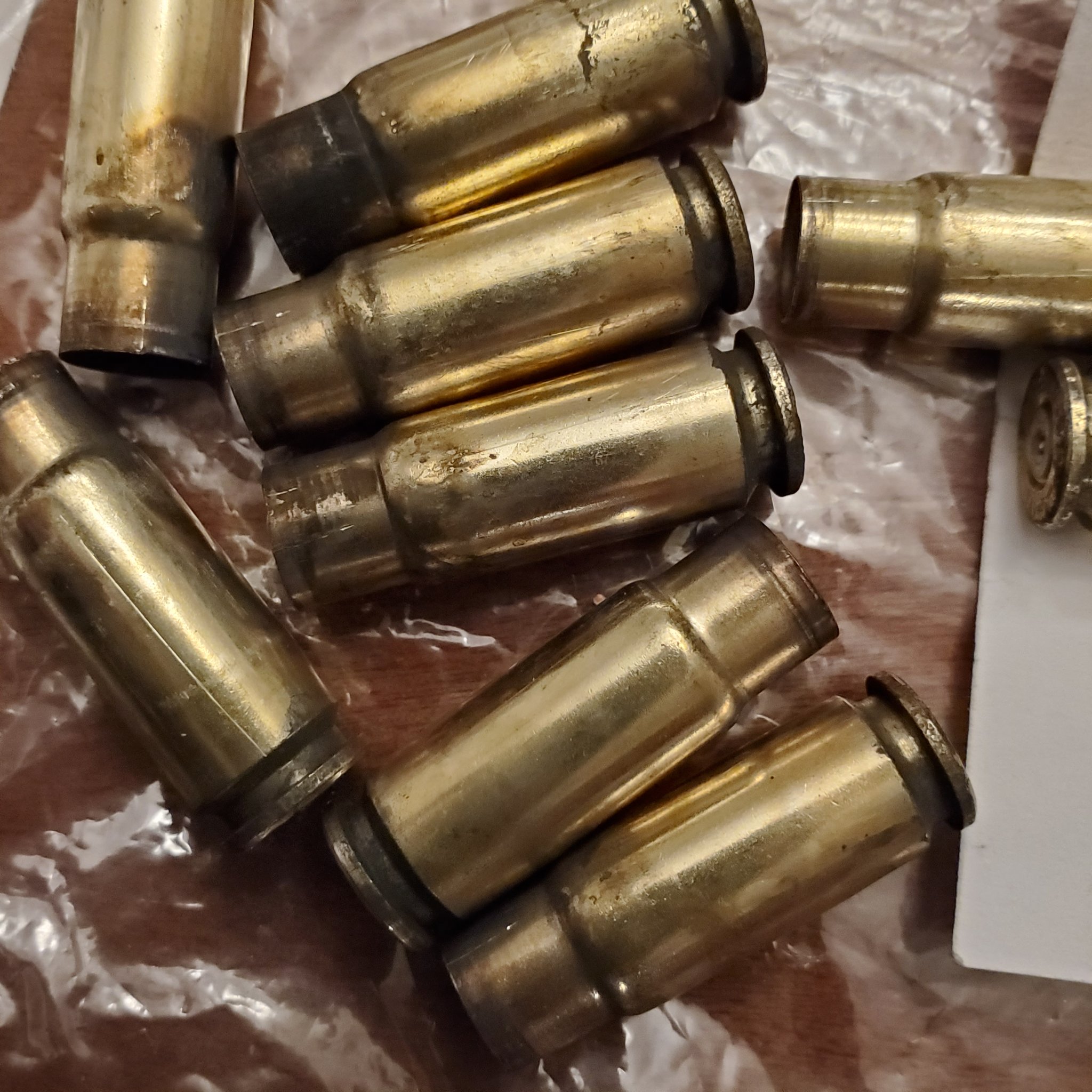

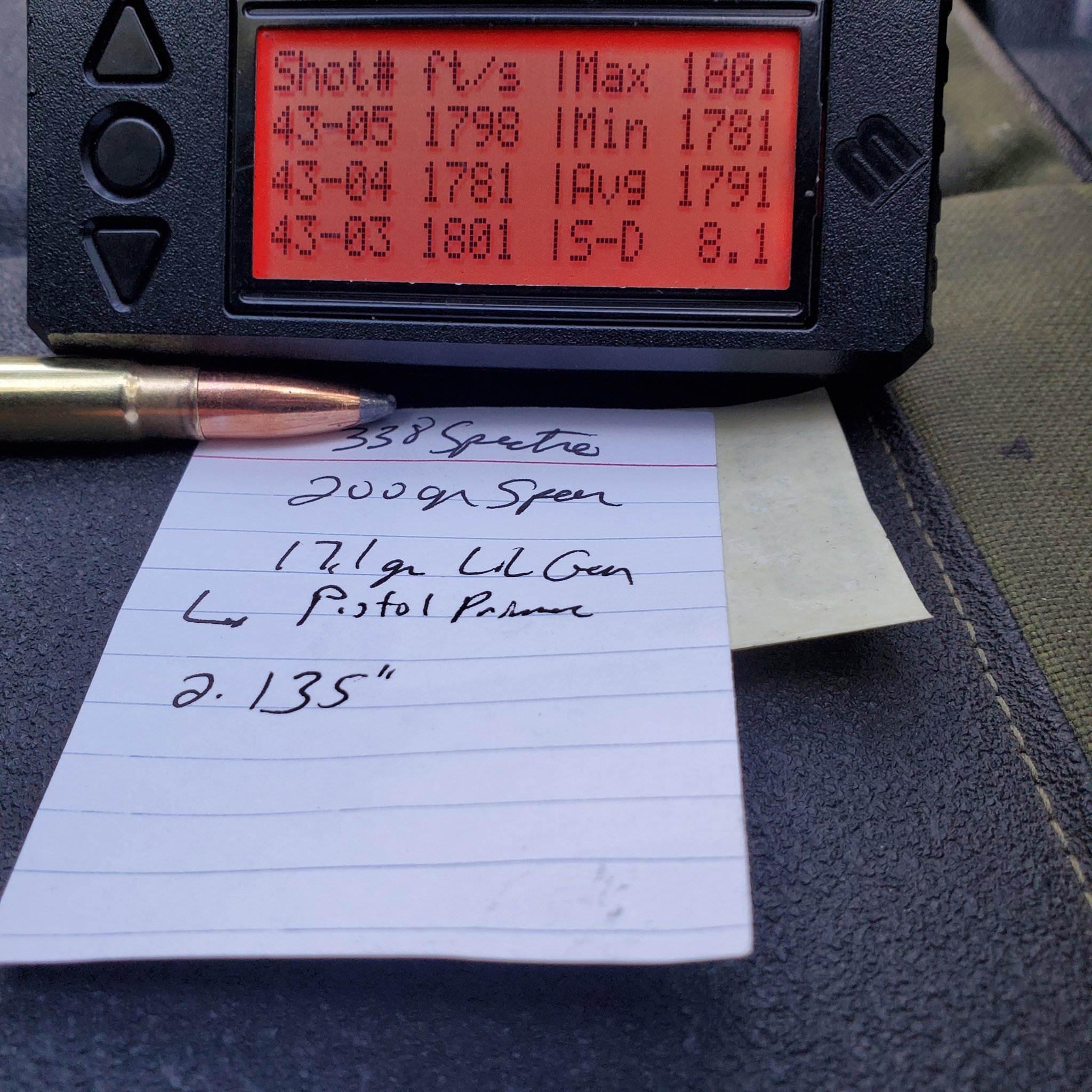

I think that you may have to allow that this could be a "your mileage may vary" type of thing because my subsonic load is less than 9gr of Lil Gun with 300gr Makers and one firing of that load significantly weakened the primer pockets on the large pistol primer pockets SBR brass that I have. I don't think I could load it a third time in that brass.
I checked the primer pockets on all these loads they appear as new after 1 firing with subs, and moderate loads, where they are giving excellent accuracy, with pistol primers, then checked the next batch from 2 days ago...all is good on the first loading, 300 gr SMK, 300 gr Maker, 272 gr FMJ plus a bunch of 200 gr Speer.
Out of all the loads I tried I lost 6 cases with too much case expansion on top loads with both primers
Like the 165 gr Maker at 2136 fps one was too loose and the others were a one shot more with the no go gauge, with the SR.
I noticed no case head expansion at all when miked at the case head, with AA 1680 cases came out very sooty as powder gas came back along the case toward the shooter...even felt it.
But velocity was still 1160 fps with the 200 gr Speer. It had large velocity variations and less accuracy...not the powder for light 200 gr subs.
Not very efficient here but I haven't tried it with the 300 gr bullets where it's lower pressure may help you with primer pockets, and the extra bullet weight will help build pressure for a better burn.

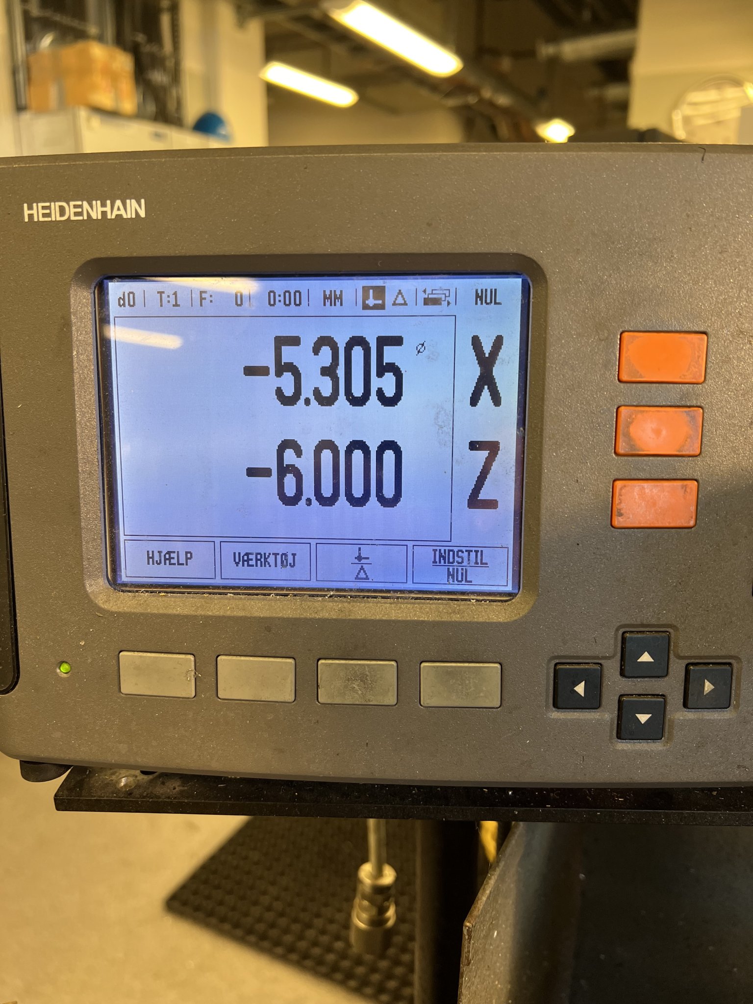

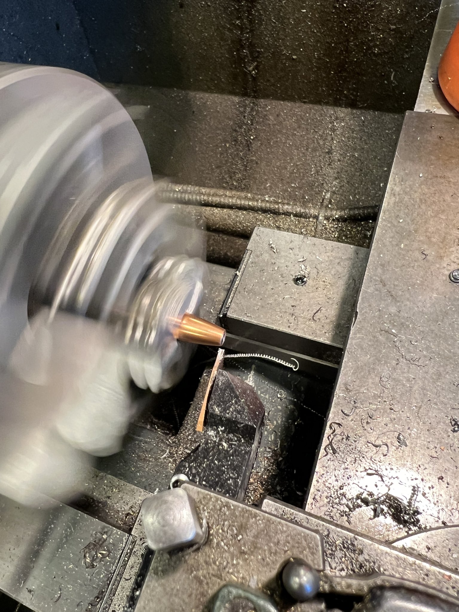

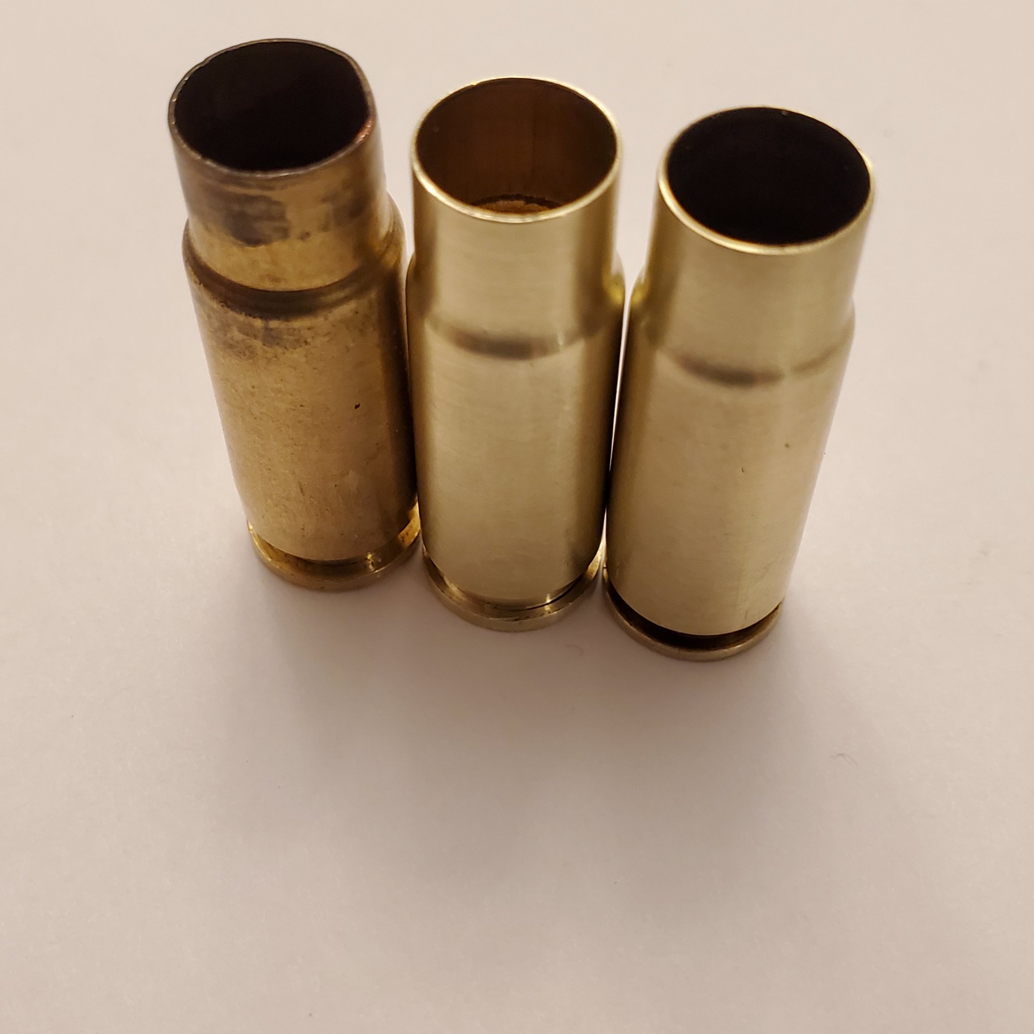

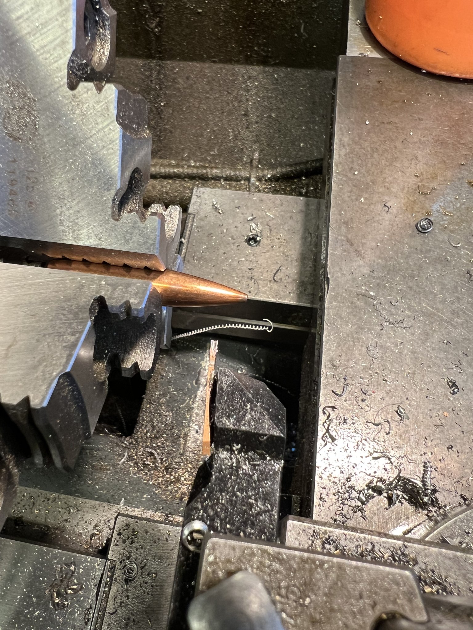

Since I have 224 Valkyrie and 6.5 Grendel cases lying around....I decided to make 338 Spectre cases out of them.
The 224 Valkyrie is easy, trim to length, lube, & run through the 338 spectre FL die.
The 6.5 Grendel is a bit more involved for the average reloader.
Cut to length. Turn the sold head to size, blend out and recut extractor groove, lube, size in the FL 338 Spectre die.
Anneal and resize. It goes pretty quick with a lathe once set up.
So the 224 Valkyrie is really easy.
Both chamber in the rifle at the same die setting as the 338 Spectre brass.
For what it's worth, pressures jump pretty fast in this tiny case, so even tougher, harder case headed brass, might not increase velocity much but hang in there longer for a few more firings.

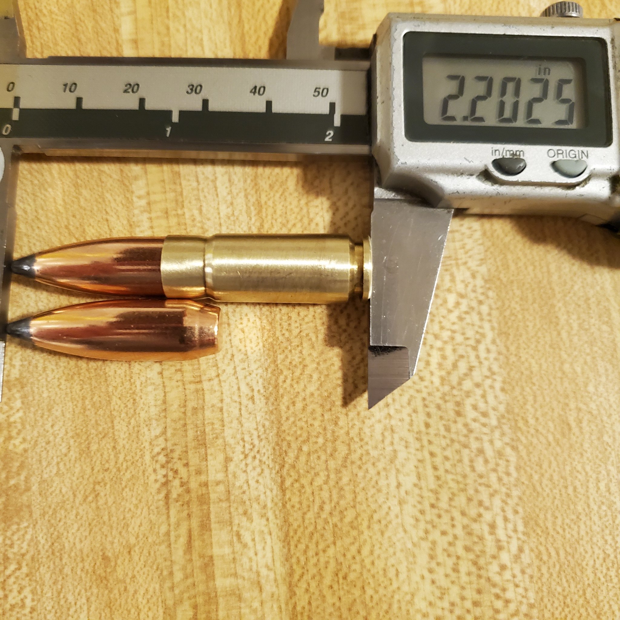

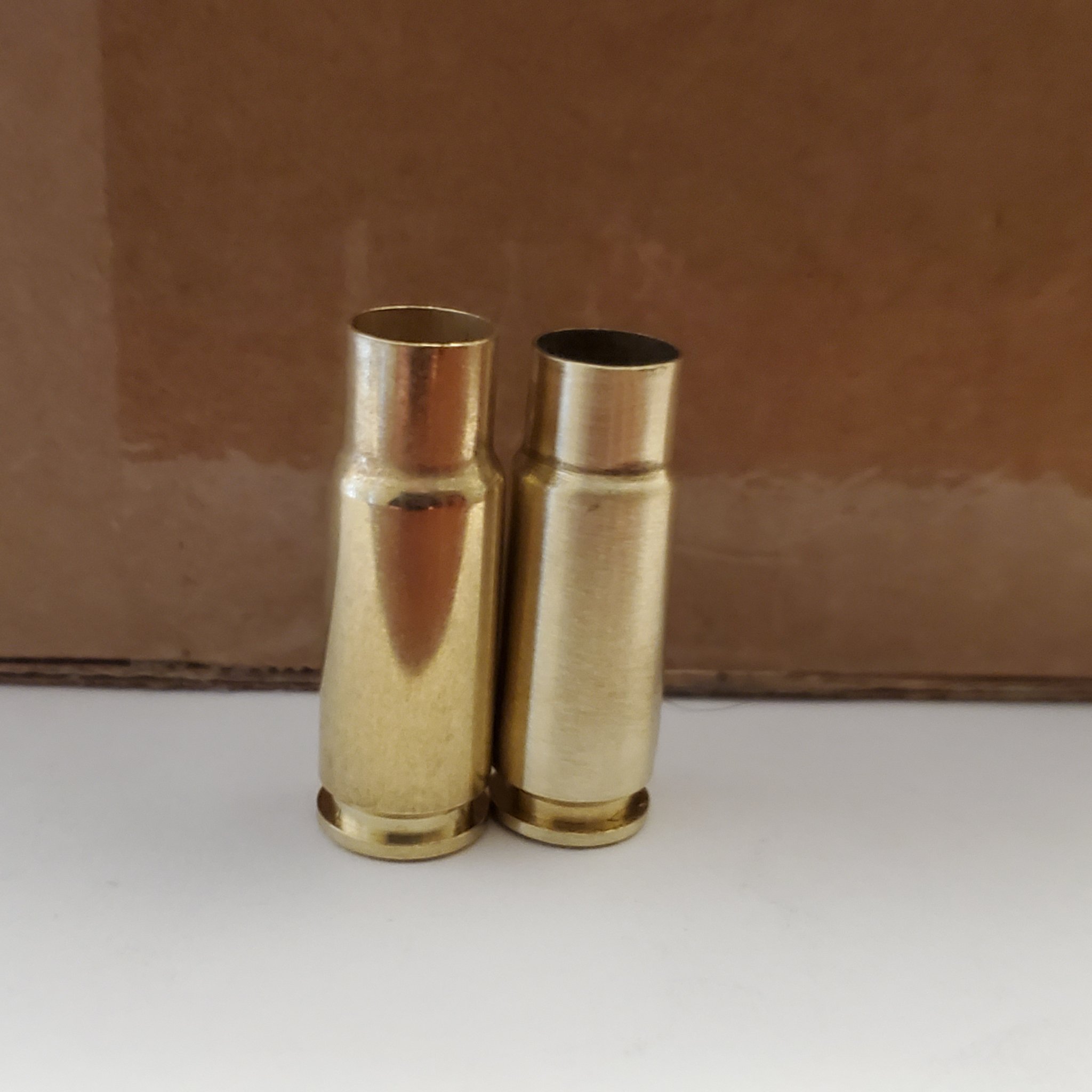

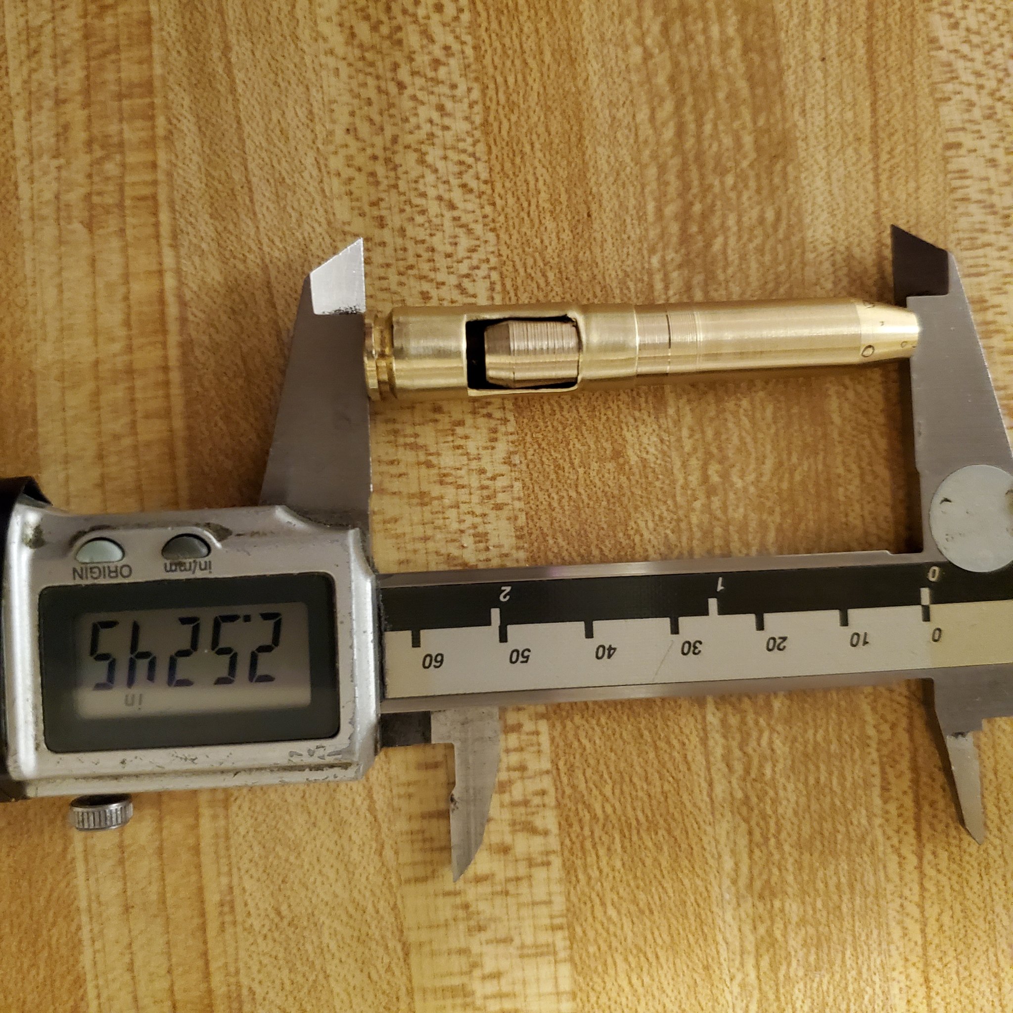

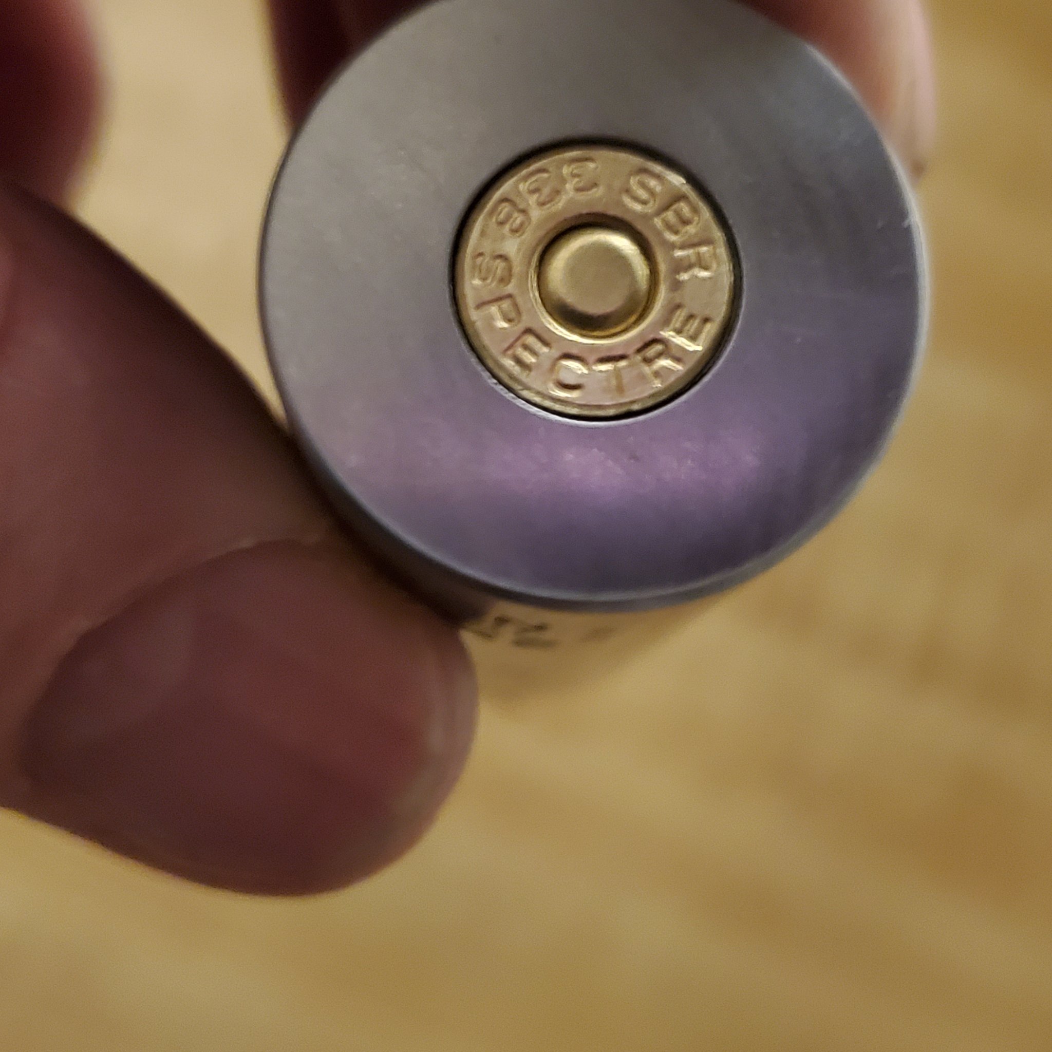

The 338 ARC and the 338 Spectre are almost identical, as I suspected earlier.
I jumped on the Spectre to check out these small cased 338s while waiting for 338 ARC reamer, brass etc.
Well the 338 ARC brass arrived, so let's compare it to the 338 Spectre I now have been shooting is very accurate.
Hornady brass is $104 per hundred, Spectra brass is $46 per hundres for SR primer or a bit cheeper for LP primered cases.

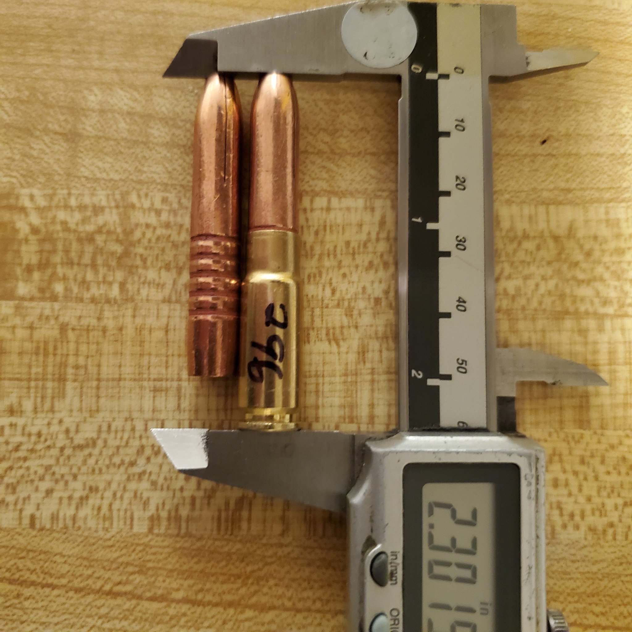

Here they are side by side.

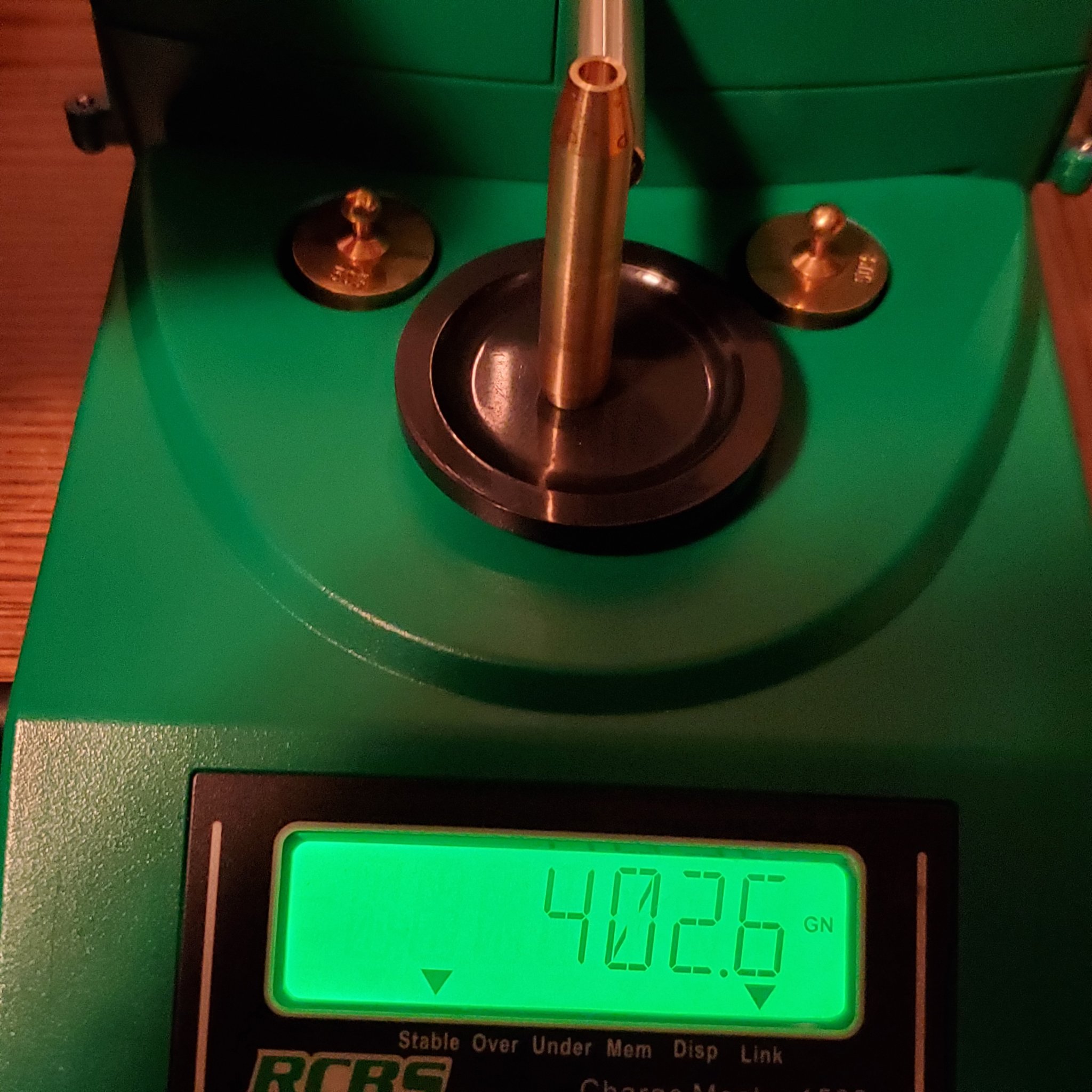

The 338 Spectre holds 29.4 grs of H2O,
The 338 ARC holds 30.5 grs of H2O, probably increase a grain when fired, depending on chamber.
Maybe the ARC will have 25 to 40 fps more velocity with supers...but the difference is insignificant...but with good barrels the ARC should be accurate.
The Spectre has been around a long time over 10 yrs I believe.
The Spectre has a 6.5 twist and I have fired bullets from 160 to 350 grs in it.
Hornady has an 8 twist, that may make a difference with the long heavy 300 gr match bullets at sub velocities. Maker already makes a variety of sub and super expanding bullets for the 6.5 twist.
Their 165 gr super expanding is running 2100 fps in the Spectre 16" barrel and supposed expand around as low as 900 fps.

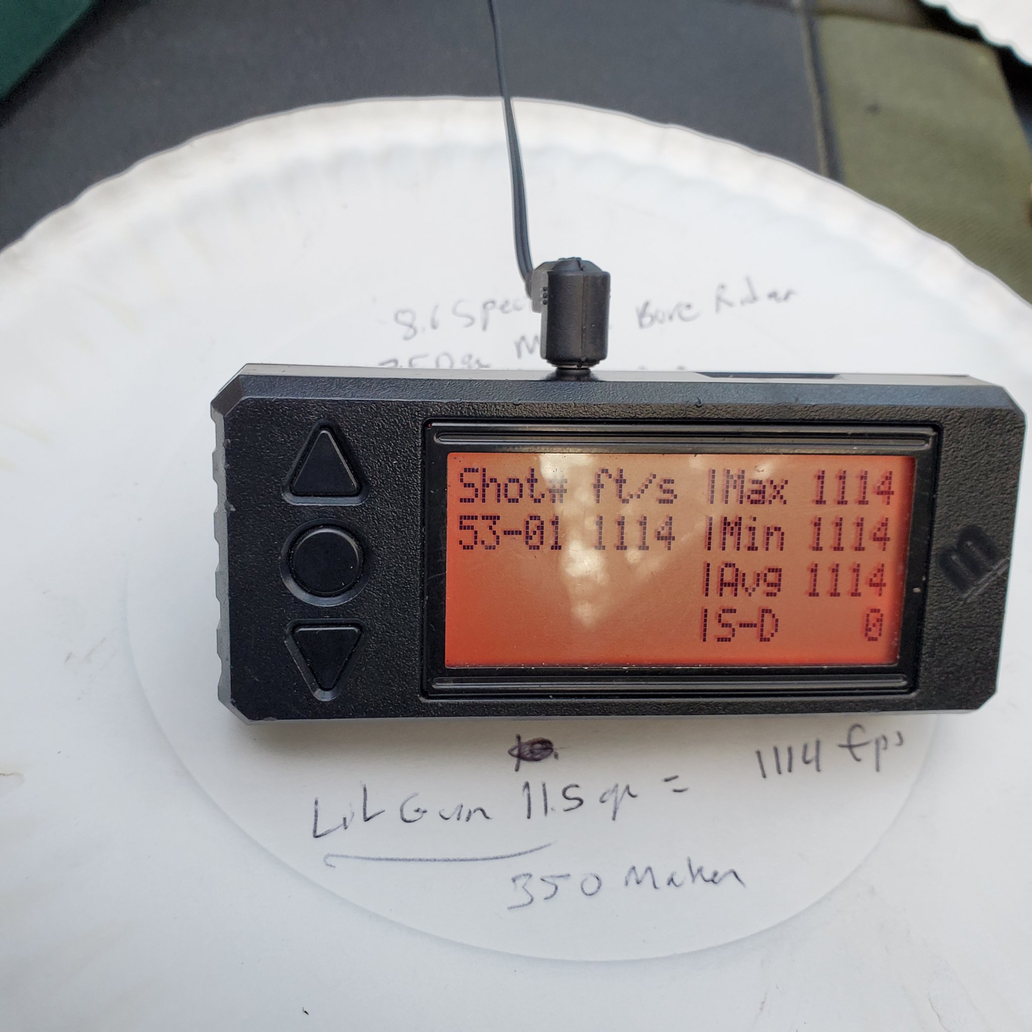

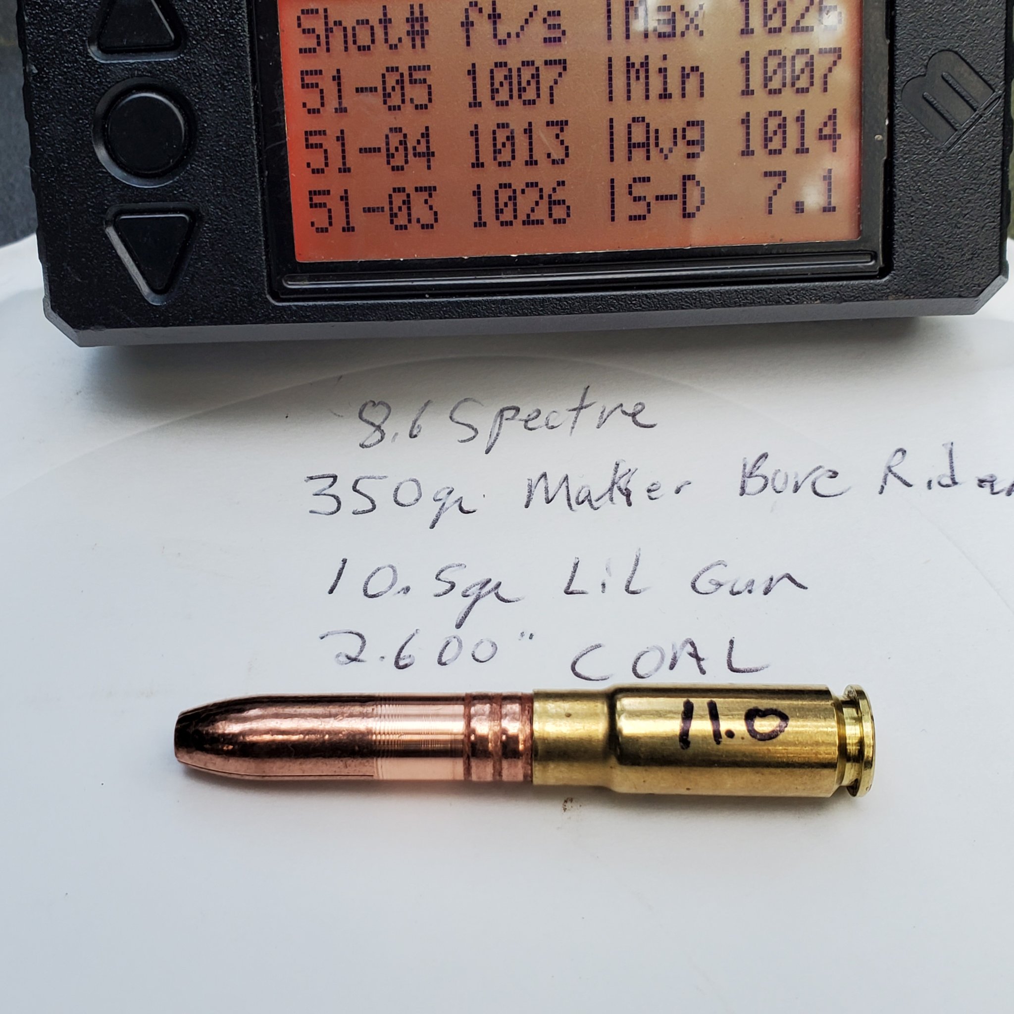

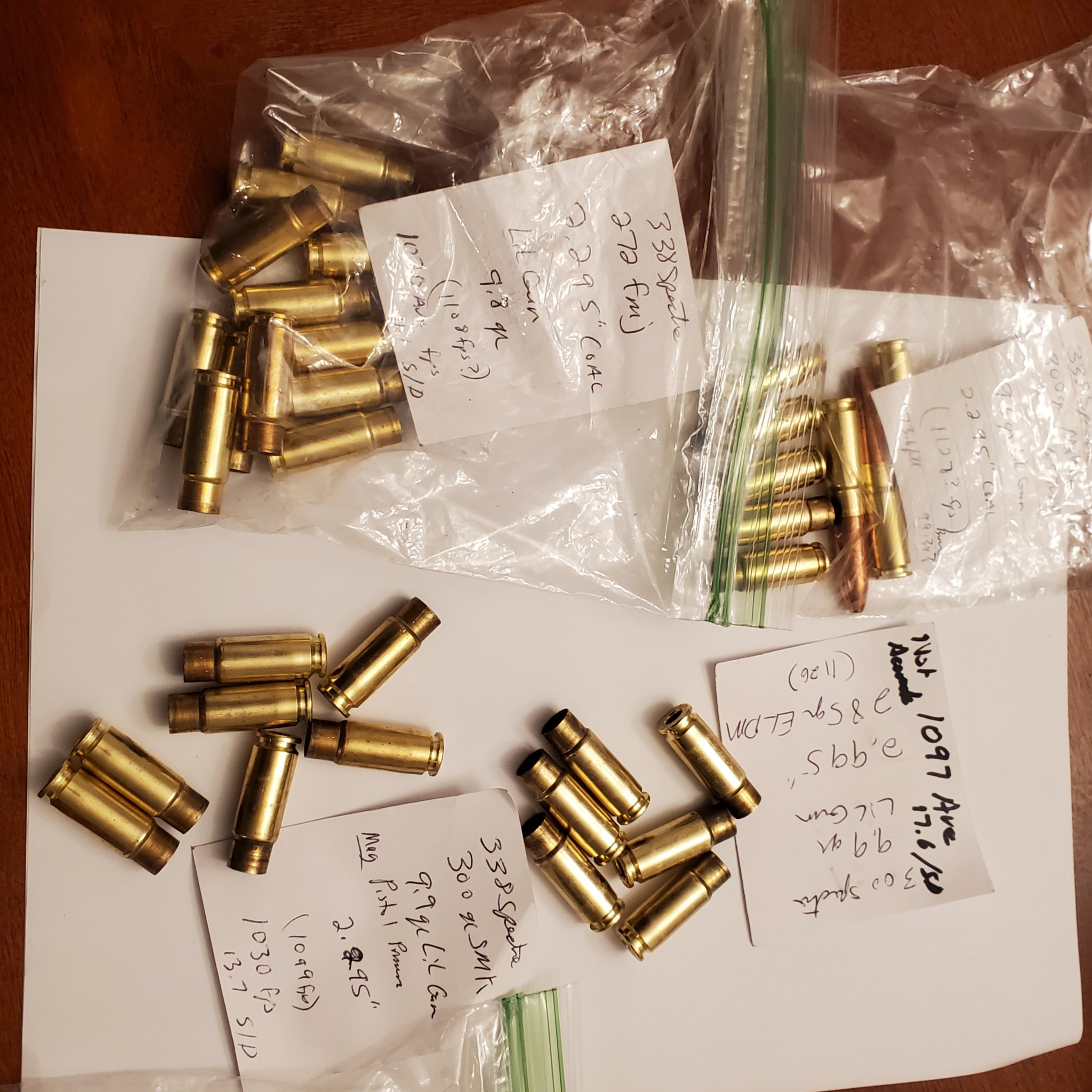

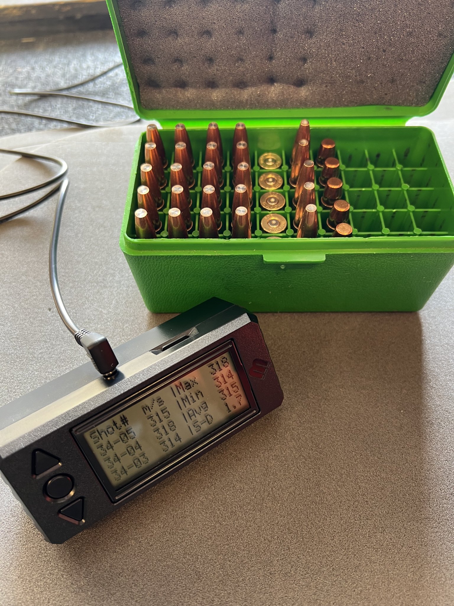

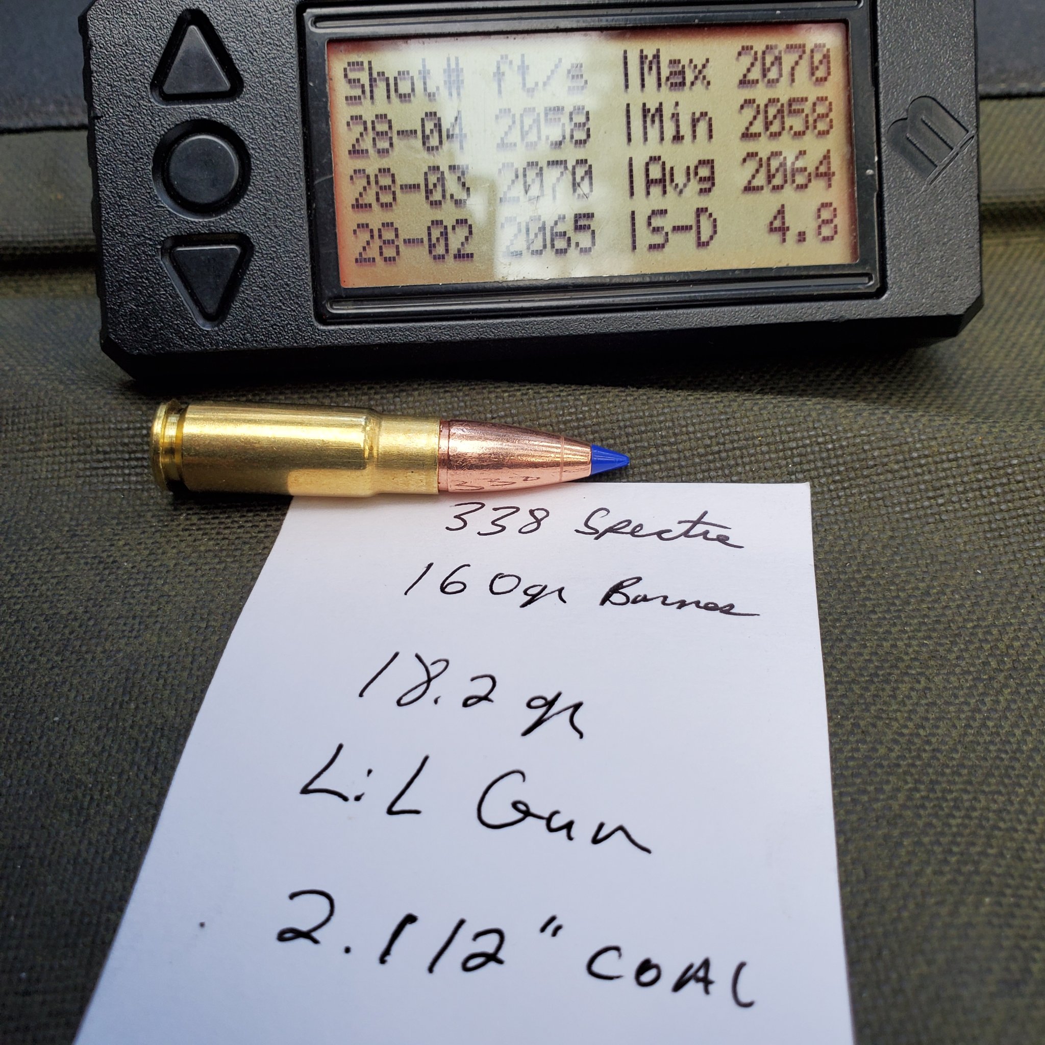

I like the 338 Spectre for accuracy and super consistent velocities.
Just new formed 10 mm mag brass or 338 Spectre SR primed brass, loaded in a Dillion progressive, with just a powder measure.
Single digit S/D is the norm.
Outstanding for an AR 15 mag feed autoloader.
Especially when most all bullet powder combinations are like this... it's what is needed to keep from vertical stringing as range increases.
I have a 338 ARC reamer coming Friday, I could rechamber to 338 ARC.
The only problem is brass is pretty weak for supers as another has alluded to in 338 Spectre.... but for moderate supers and especially subs this barrel is a shooter.

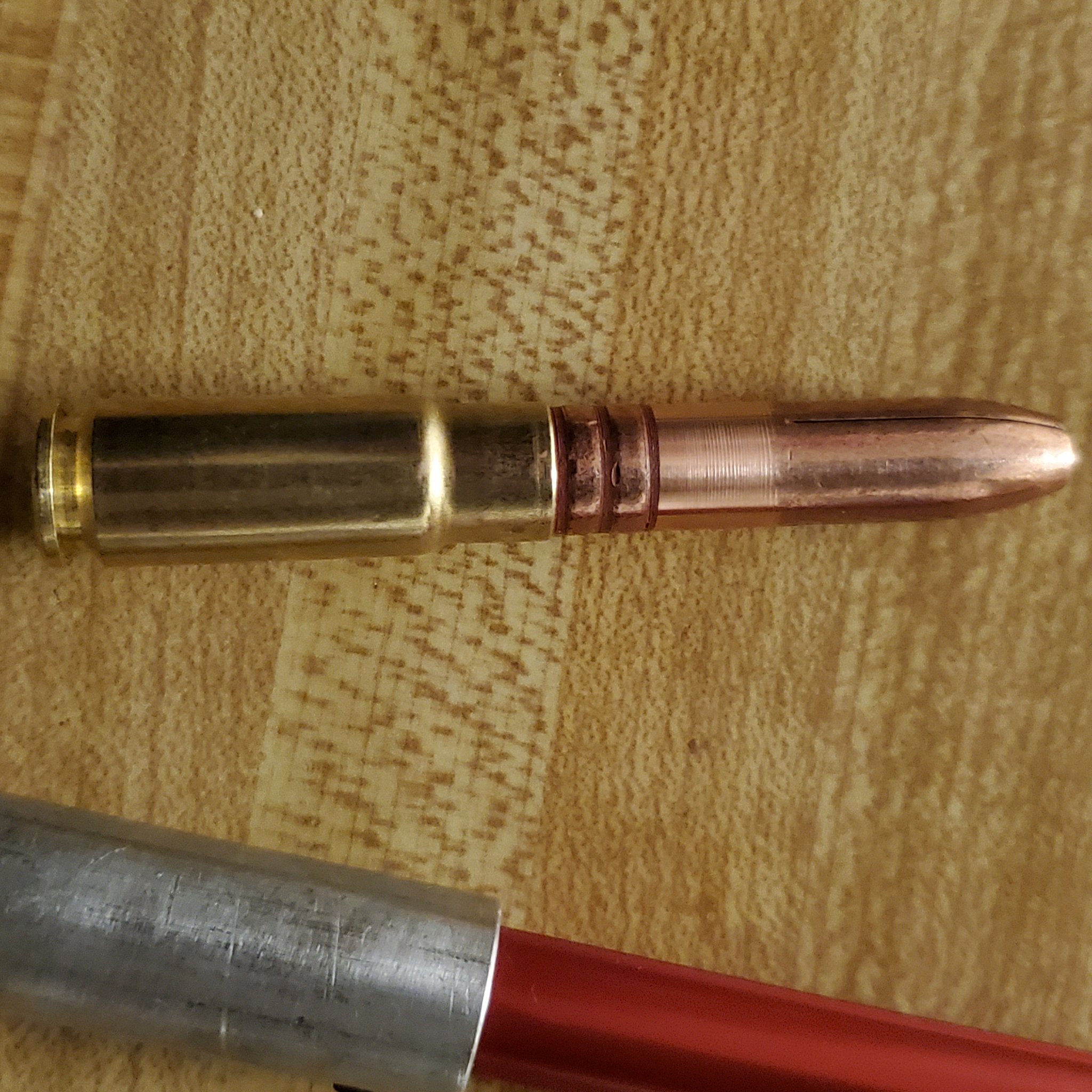

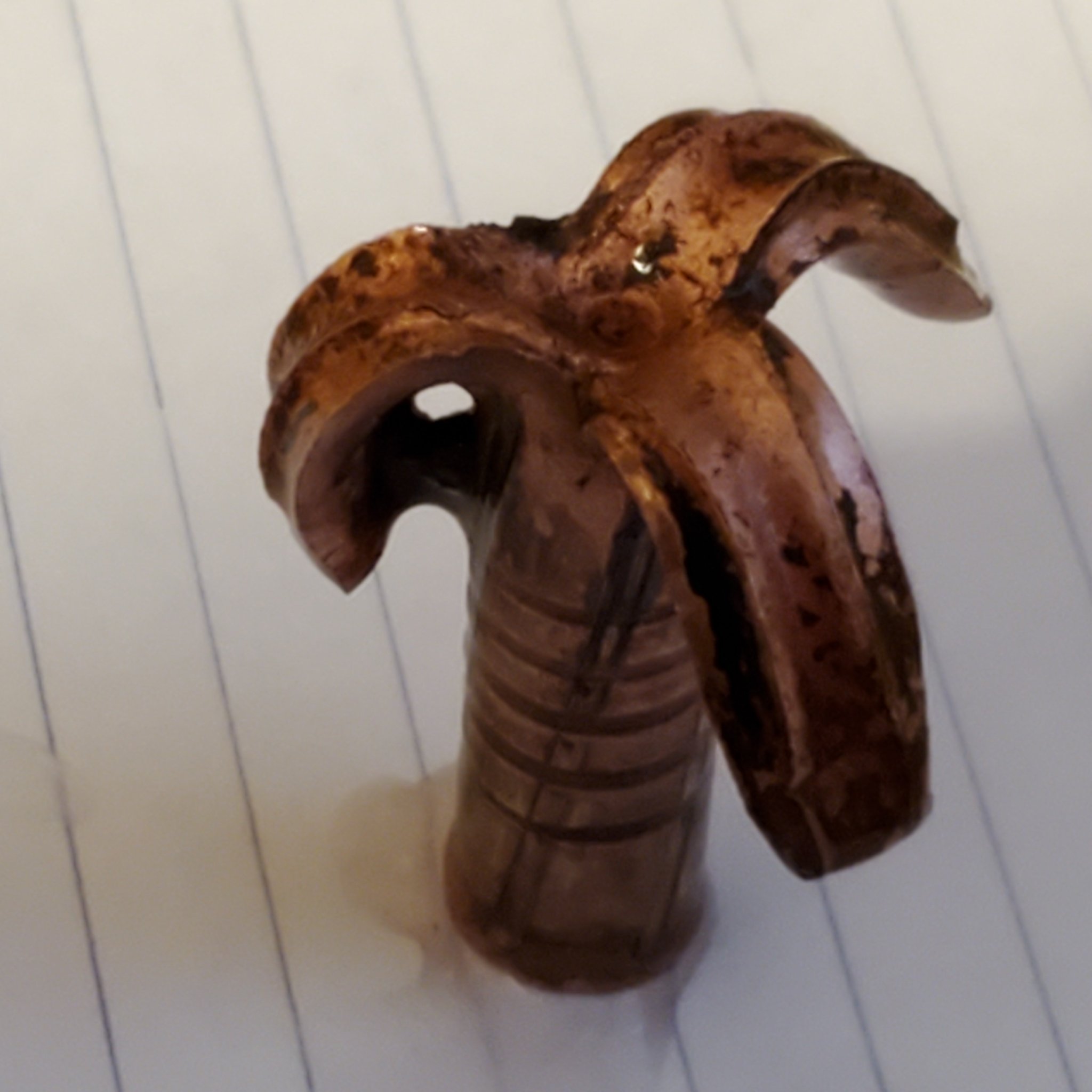

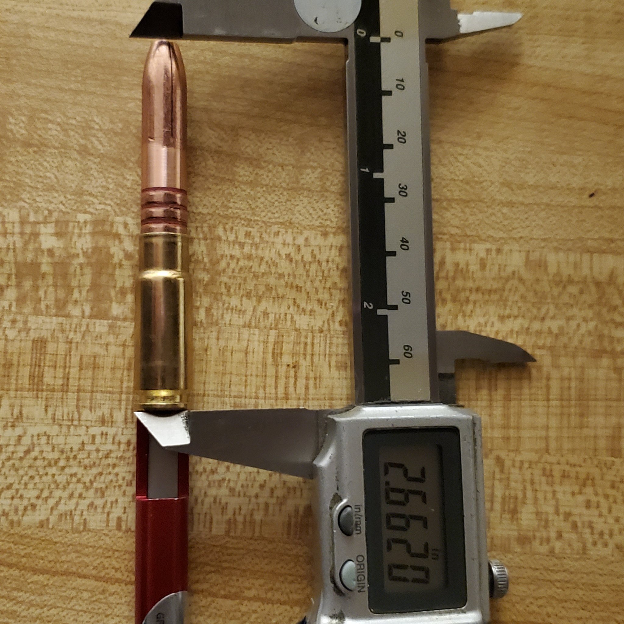

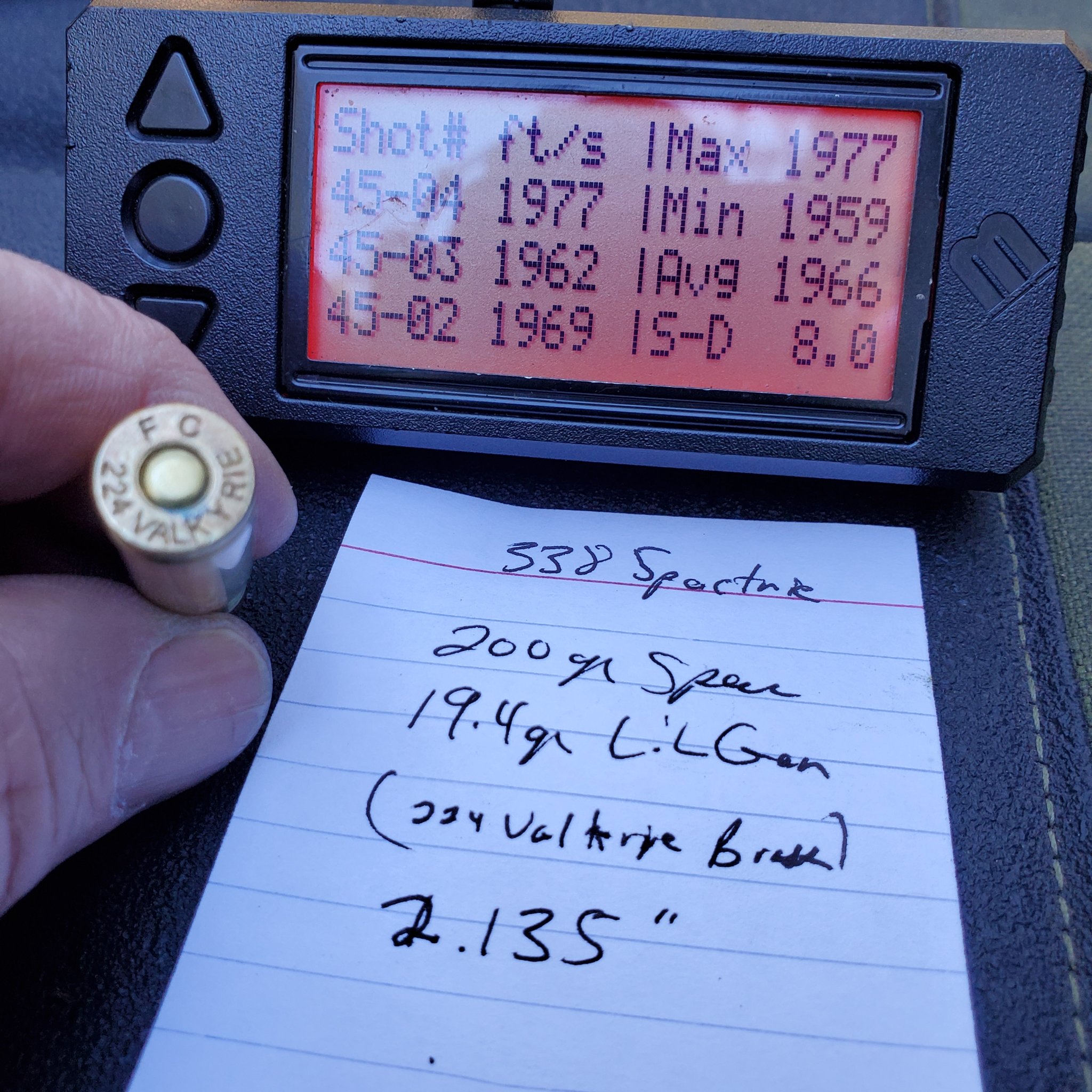

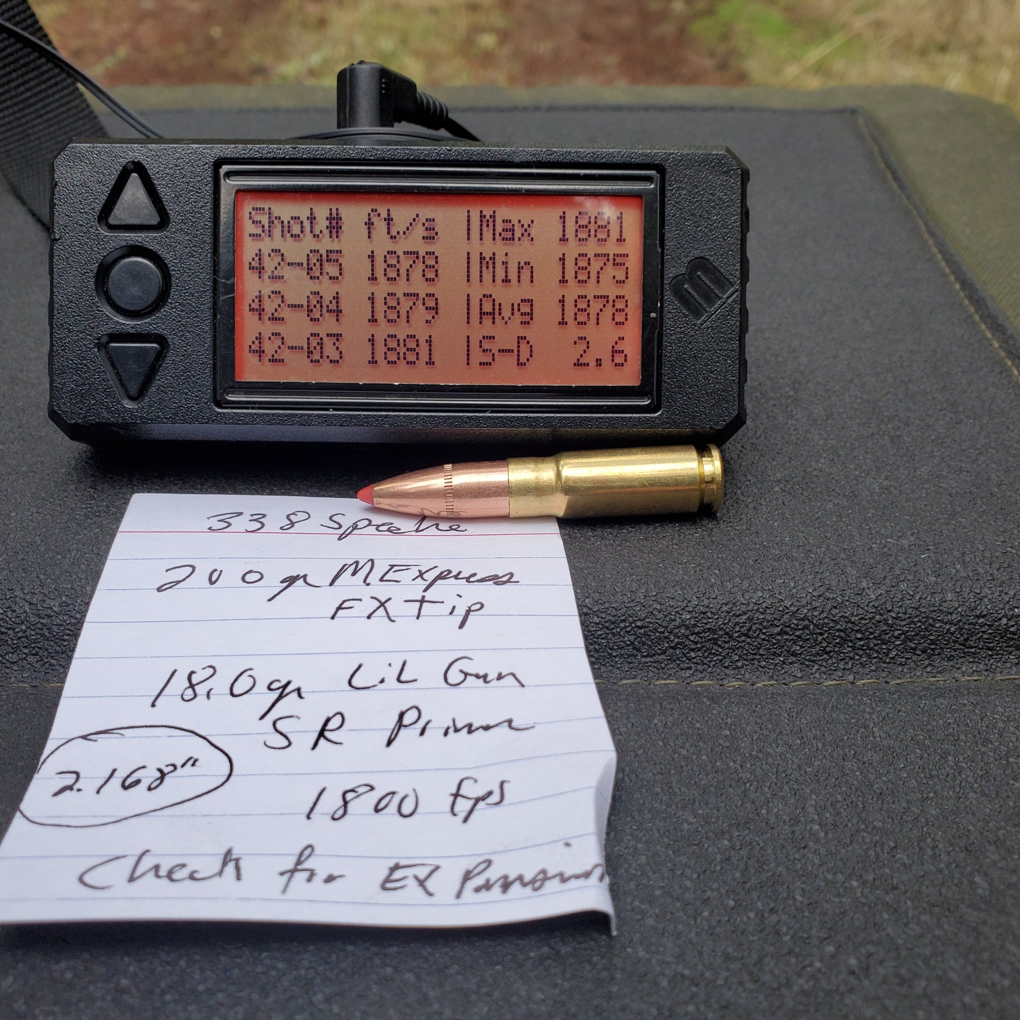

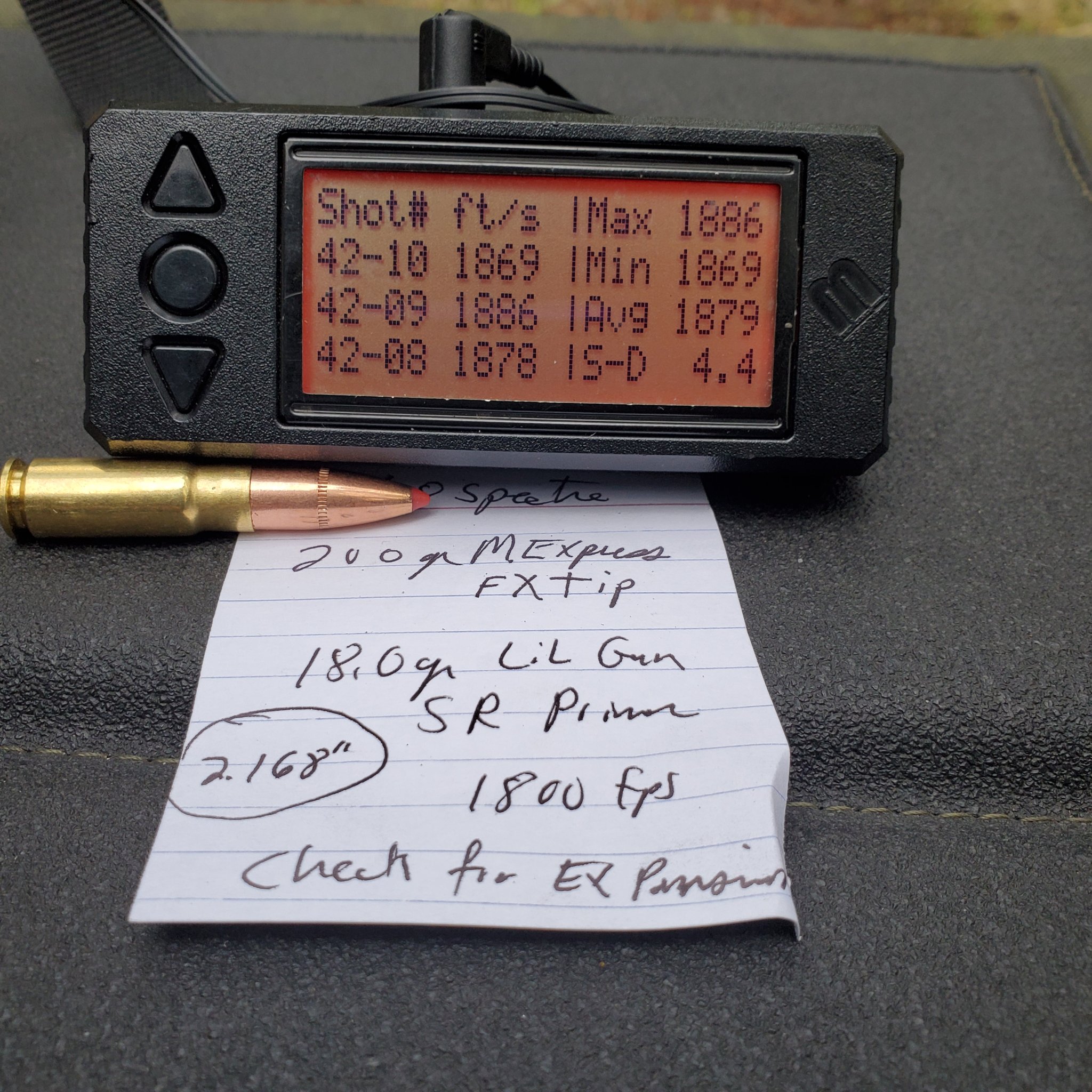

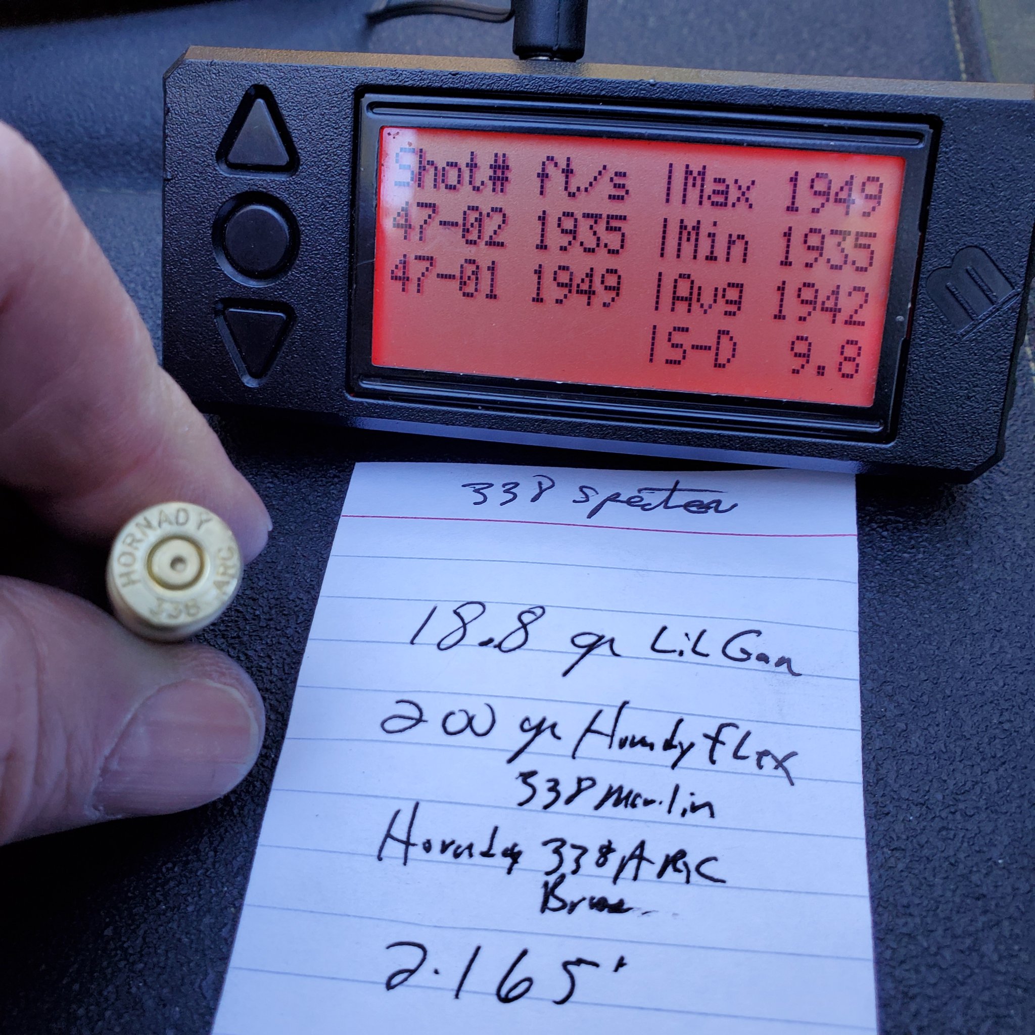

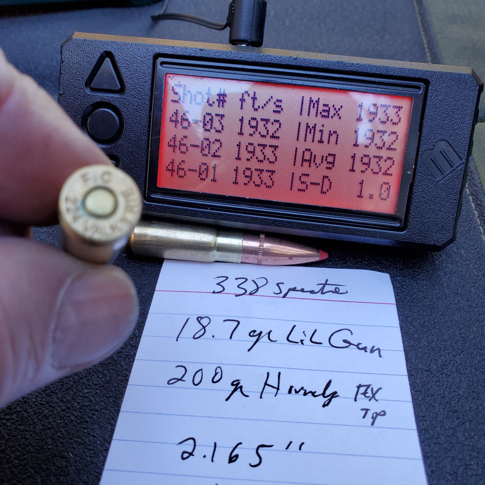

Range day again, for the 338 Spectre....
Loaded it with slightly modified 338 ARC brass and 224 Valkyrie brass.
Both of these brass cases take pressure better.
The 200 gr Hornaday 338 Marlin Express is a low velocity bullet performing in 1800 to 2800 muzzle velocity area according to Hornady.
Seems to work here, but you'd have to check it to see if it's right for you.
The 200 gr Speer at inching up to 2000 fps from this small case with Valkyrie brass, with excellent accuracy and super low S/D for a mag feed AR 15.
There is a lot to like from a case that shoots everything good with low S/D, about best I've ever had in an AR 15.
Spectre brass is a bit weak but cheap, and a non issue with subs, and run supers slower, with cheap lead bullets, or copper bullets, or 300 gr match bullets are accurate.
The diameter of this chamber is a bit oversized, but it doesn't hurt accuracy, but it will be working the brass with sizing.
Can change it to 338 ARC with little effort, since they are almost identical.
Close to a 200 gr 35 Rem in power with 200 gr supers with better BC and penetration.
A fun little cartridge.

You need to put your tinkering skills to the test and develop a 375 Spectre
Here it is 375 / 338 Spectre! ...a 270 gr Speer seated out to give maximum powder space.
A velocity of 1500 to 1550, would be expected max.
The 375 still has a decent sharp case shoulder and would be a fun sub gun in an AR 15.
Now all ya need is a fast twist .375" barrel and a reamer.
The barrel extension and mag mods may be necessary.
Almost there!😃

I've formed a case and seated a 400gr Maker.
But validating the case capacity to push a 400gr subsonic bullet is the real test. Get a reamer made. Have dies made from a die reamer and blanks. Validate the case , size will work with powders to accurately push a 400gr Maker. That's the real deal. And not cheap.

I messed around with it...ya need the exact bullet length, but I don't have it...so I made one.
I machined a 375 bullet from a 750gr 50BMG bullet...an expensive test.
Here is the .375 bullet next to the .338 350 gr Maker.
Weighing in at 402.6 gr complete with hollow point.
Notice the shorter boat tail, that is important if ya want to seat the bullet out for maximum powder capacity in tiny cases.
Next is maximum powder capacity but overall is 2.8" plus or .308 length.
Minimum capacity no room for powder.
Need something in between.
And that would be 2.525" with this 400 gr bullet and give ya 1000 fps cartridge.
But ya need the exact bullet you're gonna use. I can make mine or adjust them to fit, but most do not have the machine tools to do so.
So yes it's possible, especially with a bolt gun.

I have the 8.6 Blk and easily necks up to 375 one quick pass.
its a better looking cartridge and does the job easily with a bit too much capacity.
But that depends on how deep one can seat the 400 gr Maker.
You want to seat it deep because of the large case capacity.
At 2.690" it's a fairly good sub round if the 400 gr Maker can be seated that deep.
Because you want high case fill, fairly high pressure, and 100% burn.
A 308 bolt gun rebarreled would be totally easy.
Total capacity 47 gr usable capacity 25.24 by volume.
If the 400 gr Maker is close then this will easily work.

Okay with the 338 Spectre I just machined the bullet .330" to the first driving band.
It will seat out to 2.660" .
Minus .050 for copper jump
2.600" and 10 gr Lil Gun should be pretty close to the velocity target.
Instead of machining bullets you would use a throating reamer to ream the barrel throat for the 400 gr 375.
This is easy for me, to put em in a collet and cut em down.
The Spectre case is 28.8 to 27.3 depending on the brass, LP or SR primer.
I recommend SR primer cases, they hand a bit more pressure. Or Valkyrie cases cut down.

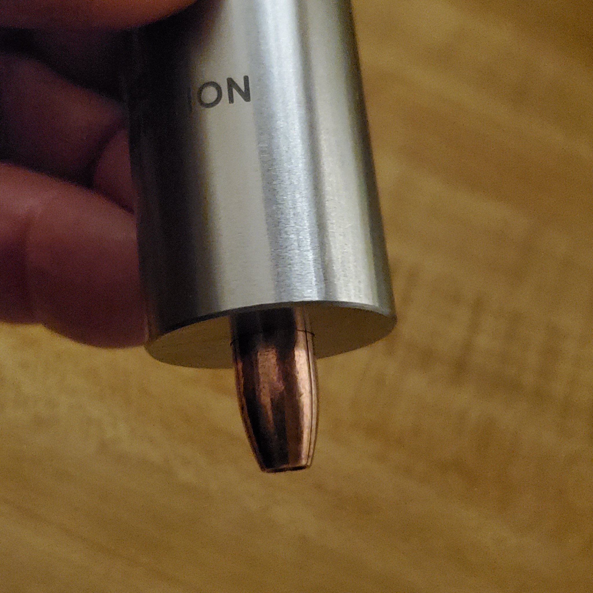

So I loaded one slightly modified 350 Maker. Checked in the gauge.
Loaded in the chamber not the firing pin dent ....extracted from the chamber no problem.
Single load in AR 15... should be able to get 950 to 1100 fps.
Done for now, will load more and ahoot em.

I just fired some 338 Spectre "bore riders" (turned down part of the bullet nose to .3295" to seat the bullet out and add more powder capscity to this small case ) to fit the AR 15 single load, at 2.6"
Here are the results.
The best accuracy load was 11.0 grs of LilGun, at 1049 fps.
10.5 gr was good S/D at 1014 fps ave with 5 rds, wasted too many finding the bullseye, the group a little larger.
Then 11.5 just to find the top of subsonic for this project at 1114 fps
So one could expect the .375 Spectre loaded with 400 grs to act similarly as the 338 Spectre loaded with 350 grains.
This could work for the 338 ARC as well since the capacity is so close...if the 8 twist will stablize them and you can load them to 2.600" COAL.
