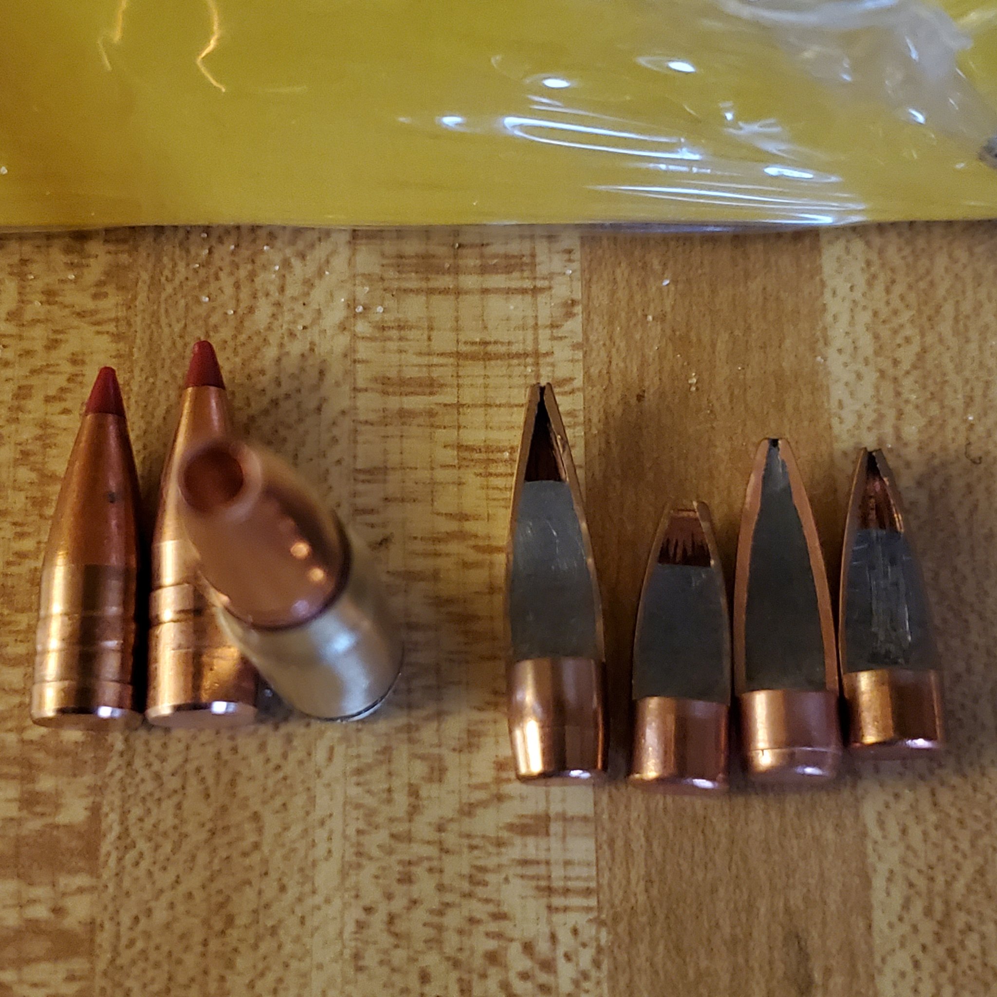

I'm a fan of what works for me...I'm already machining bullets for supers the 132 gr bore rider and 2 150 gr bullets.
Barnes hollow pointed, and a cut down Hornady copper. Checking the jacket thickness & construction of several bullets. So one can make bullets to fit your particular needs including sliting saw to slot into segments. A semi high velocity 338 ARC varminter? Or a 800 fps 100 gr rat gun that probably won't operate the bolt in an auto loader, but it cam be made to expand...inquiring minds want to know.

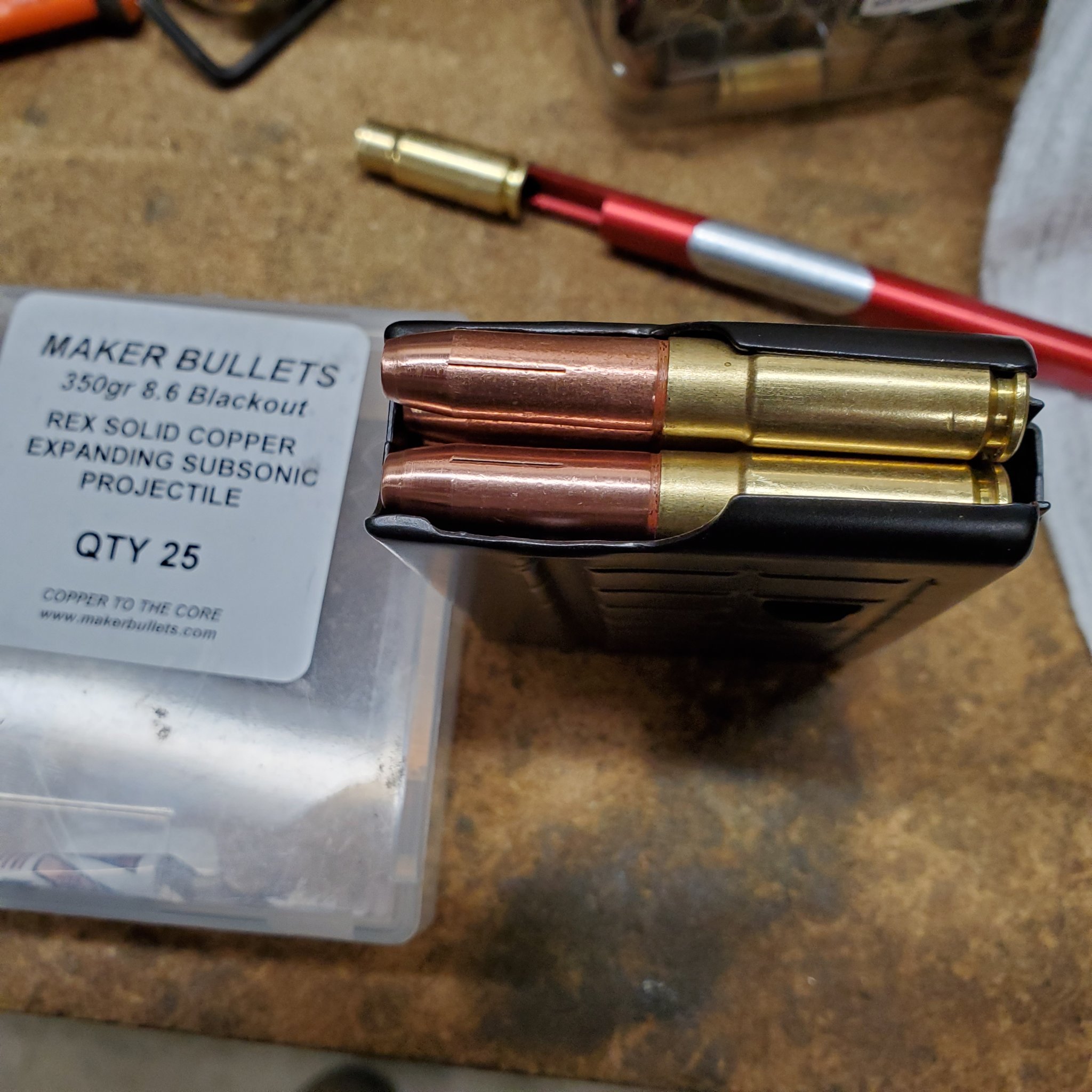

These are 350 Maker loads for my 8.6 blkout 6.5 twist that may be helpful to your new barrel.
9 different powders fired at the same target from 51 yds lazered the 350 Maker was very accurate they tend to go through the same hole...If velocity is similar.
Also found some cheap 35 cent 272 gr fmj for accurate sub plinking, and post the pictures and loads.
For family fun with subs the 35 cent 272 gr bullets shipped to your door.
I fired 100 of em the first time out, and they can be used to get you into the sub velocity ball park instead of the expensive 350 Maker.

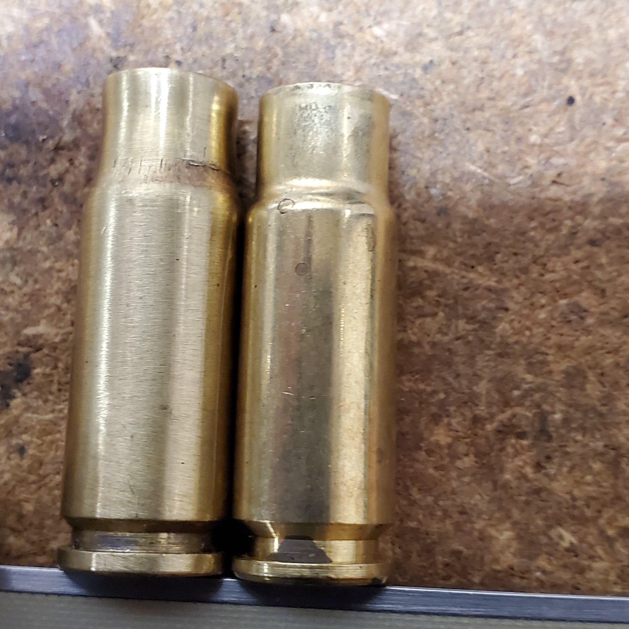

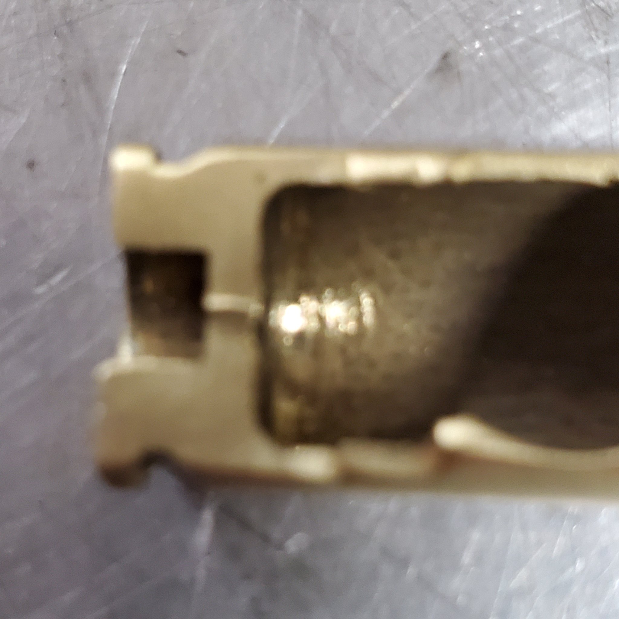

I milled a 224 Valkyrie in half at the cartridge head to compare with the Starline 10 mm Mag pistol brass, they are the same...the 6.8 SPC cartridges in the AR are rated at 55,000 psi the AR 338 ARC is 52,000 psi.
You can get SR cases or Pistol primed cases. I got some of each, They are much cheaper than Hornady 338 ARC cases.

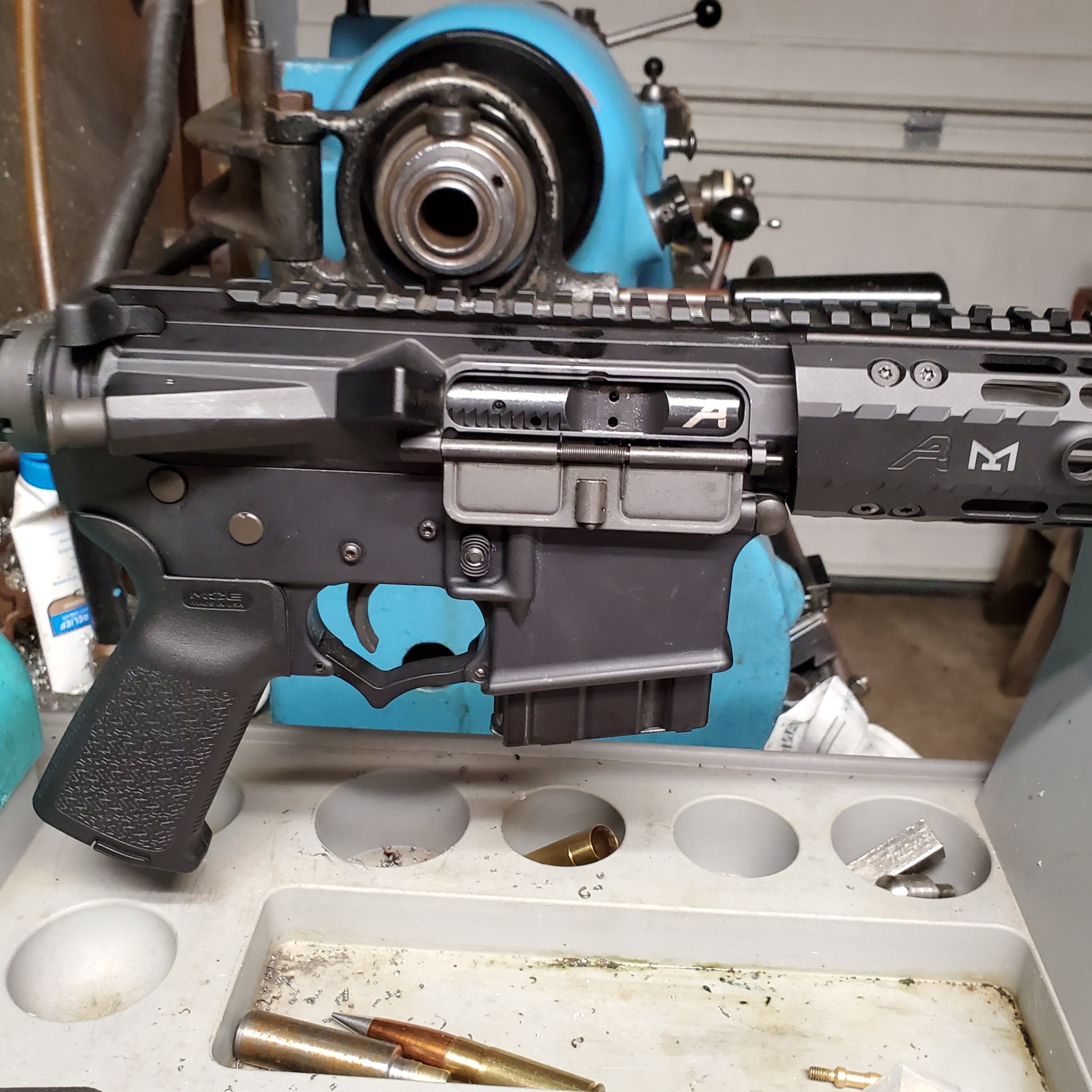

I just put together an AR 15 on 338 Spectre, brass, dies, & cartridge gauge arrive tomorrow.
It's a balistic twin of the 338 ARC but components, dies, brass, and barrels and uppers are available now, and a lot cheaper than Hornaday 338 ARC brass, for those interested.

I ordered all the stuff for the 338 Spectre and most everything arrived in 7 days.
The rifle is done, about 7 days to ship the barrel.
Received 600 pcs of brass, dies, Wilson cartridge gauge, and 6.8 PRI magazines.
The 338 ARC is very similar to the 338 Spectre...almost identical. A side by side, but not exactly....as I do not know where the neck shoulder junction is for the 338 ARC, but a mockup of the ARC compared to a factry 338 Spectre.

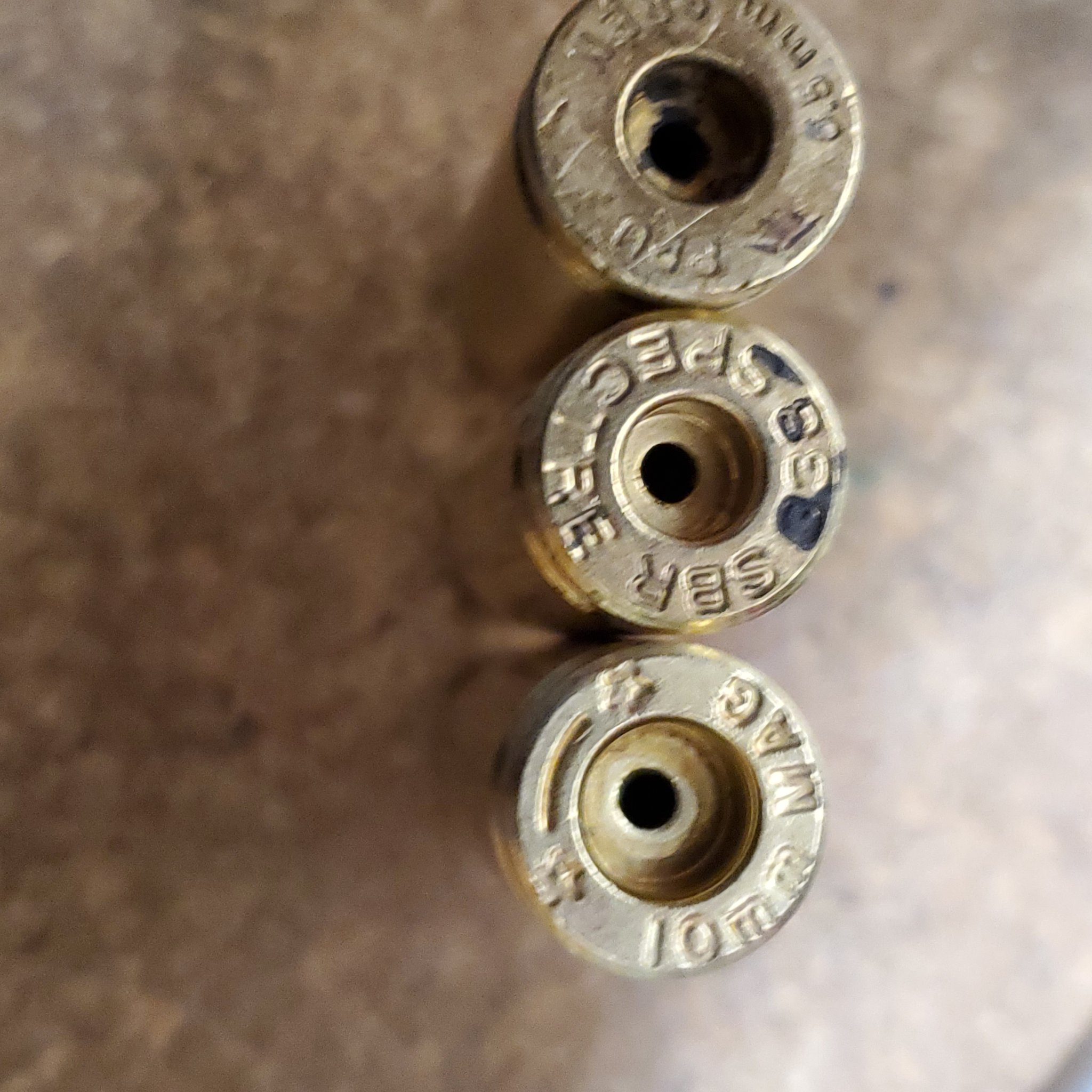

The pistol primer pocketed brass won't tolerate much pressure. I wouldn't advise anyone to buy any. If the 338 ARC is made with rifle brass, that alone is enough reason to wait for the ARC and go with that.
You haven't been paying attention, the 338 Spectre Has SR primers, and run at 55,000 psi same as the 6.8 SPC.
If you make them out of 10 mag they will obviously have pistol primes...I have both!
The pistol brass is 46,000 psi but starline has increased the case web to the same as the SPC rifle brass...I milled one into to confirm.
Do not spread misinformation...
Make an informed choice.

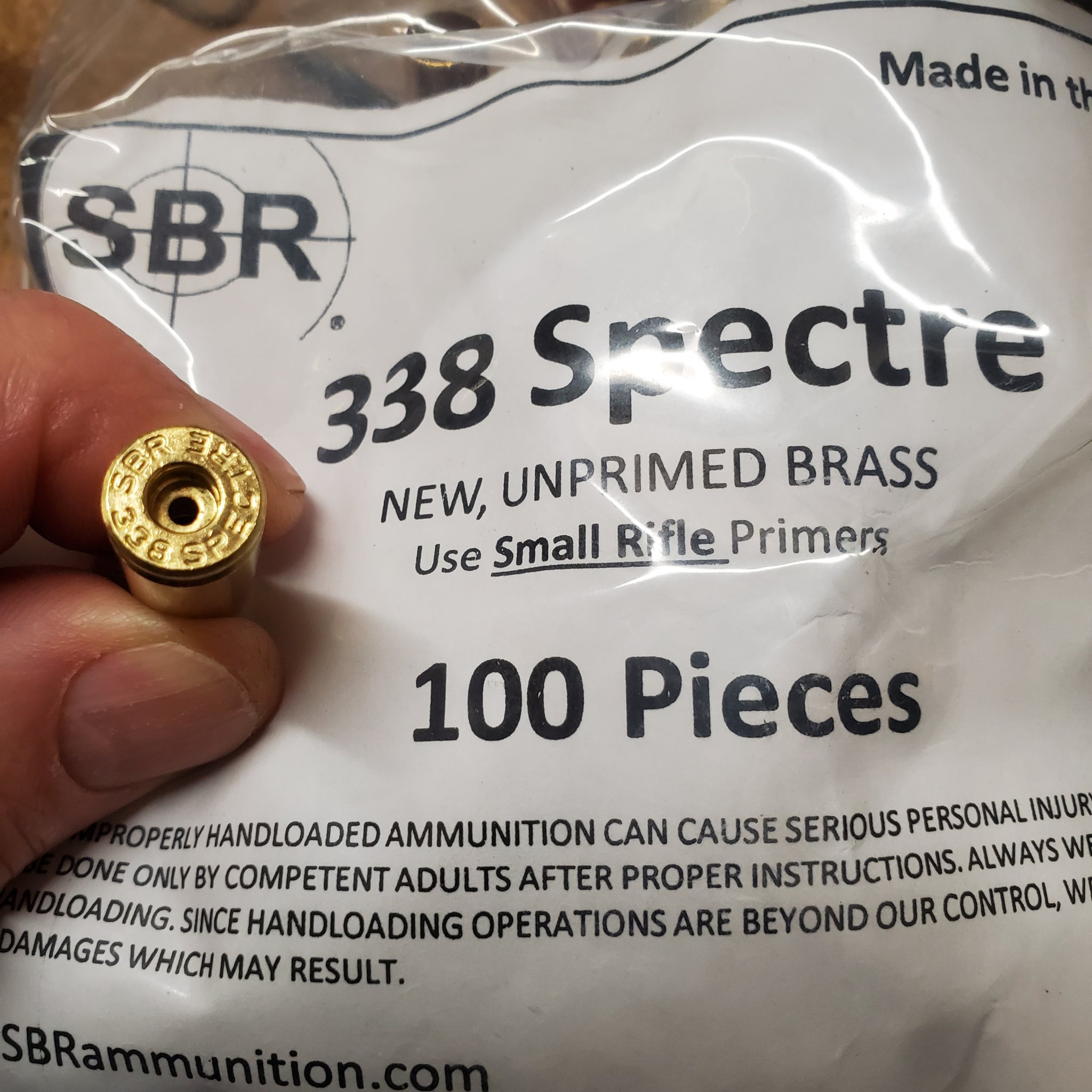

The Spectre SR brass is sold by the 100ps bag and 1/2 price of the Hornady brass.
Plus on most sub loads ya won't use the high psi on any of the brass, depending on the powder.
Just the facts, plus I'm gonna run the pistol brass to 55000 psi to see how it stands up with the pistol primers. I run them to 65,000 psi in 454 Casull running heavy bullets in 45Colt brass.....45 Colt brass has a thicker webb than 44 mag, on Win brass when milled and measured.

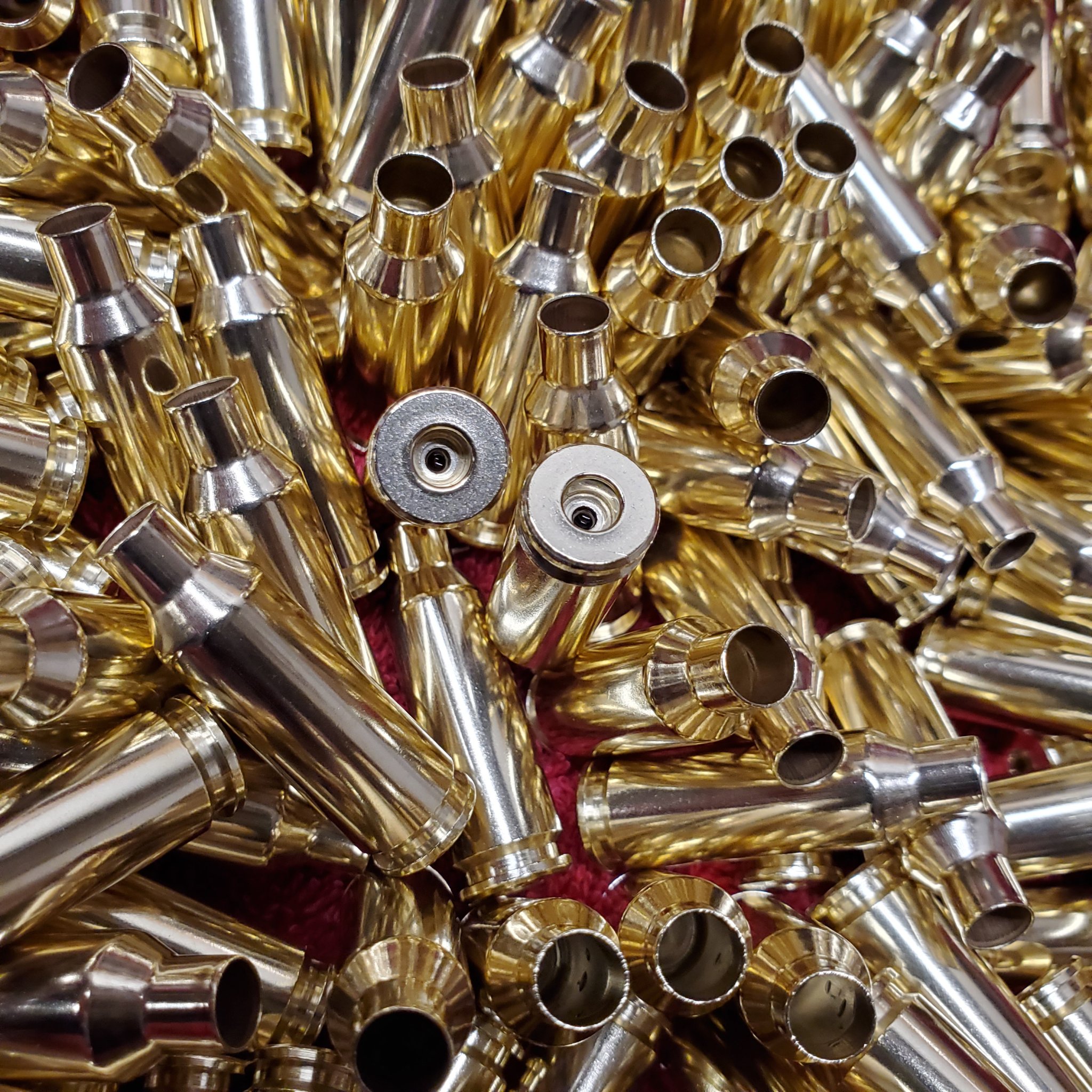

Here are the SR primed 338 Spectre brass for those interested. All the components are available now
I also have both brass from SBR Munitions. I bought the pistol brass first and then the SR brass because I was losing primer pockets loading subs. I was just trying to be nice to you once and let you know not to waste your time with the pistol brass. I guess fuck that.

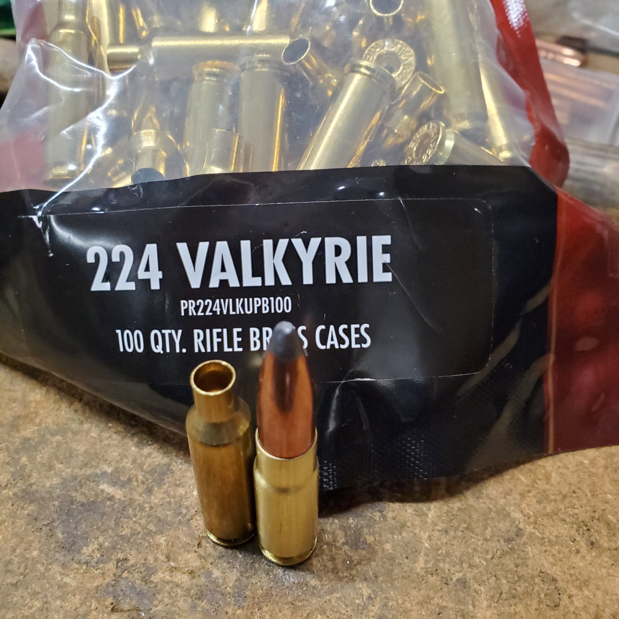

I will never run out of SR brass for the 338 Spectre, as I have a bunch of new 224 Valkyrie brass to make 338 Spectre cases out of, if I want... plus many others with that head diameter.

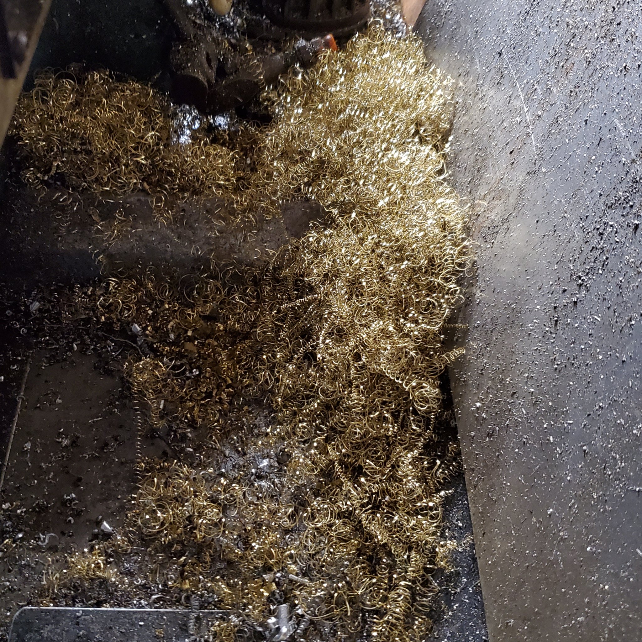

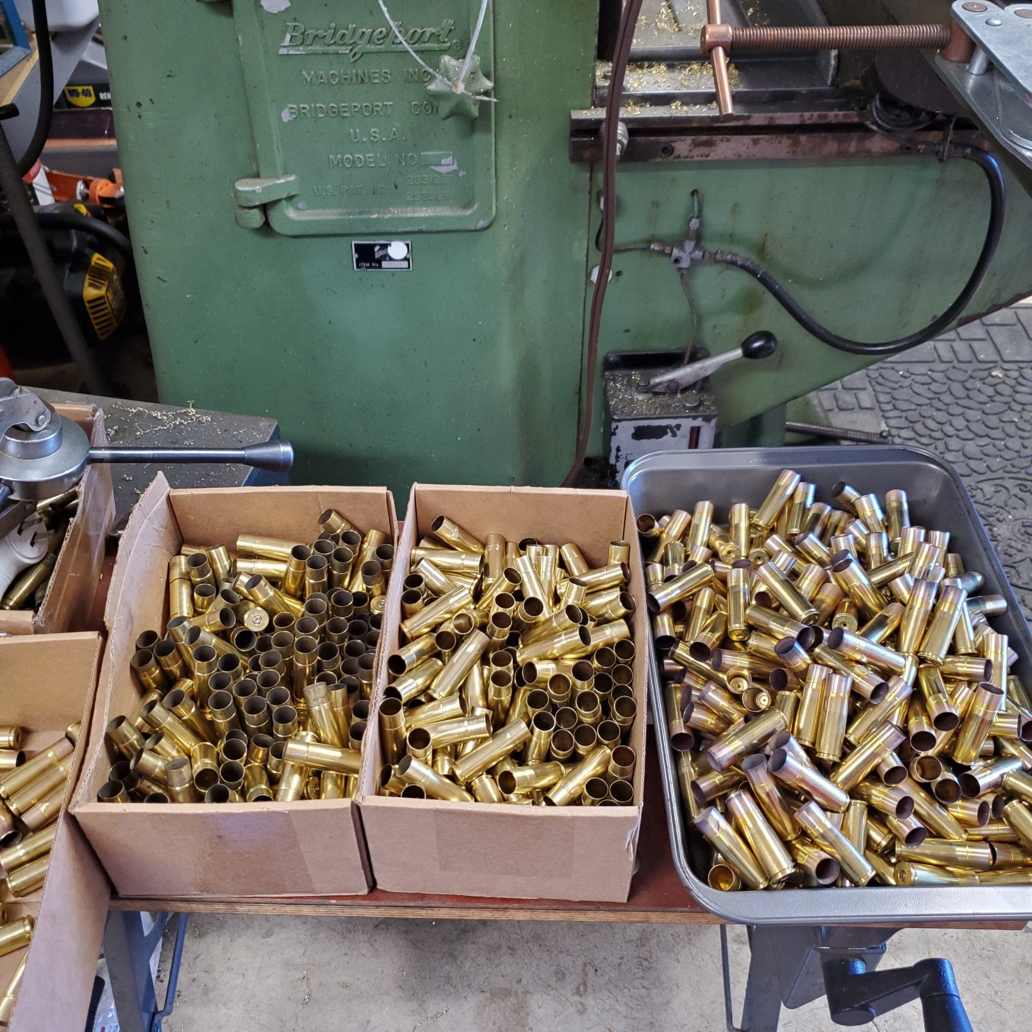

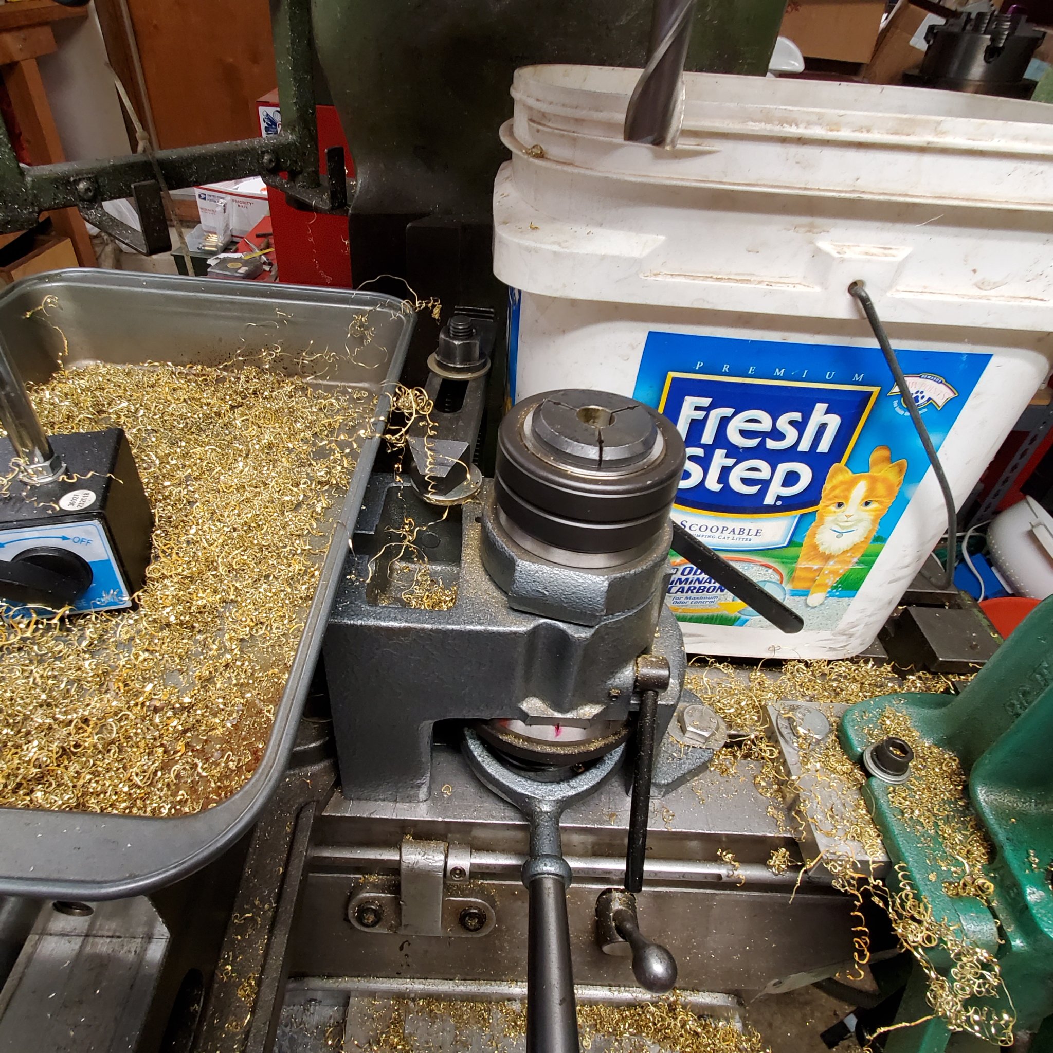

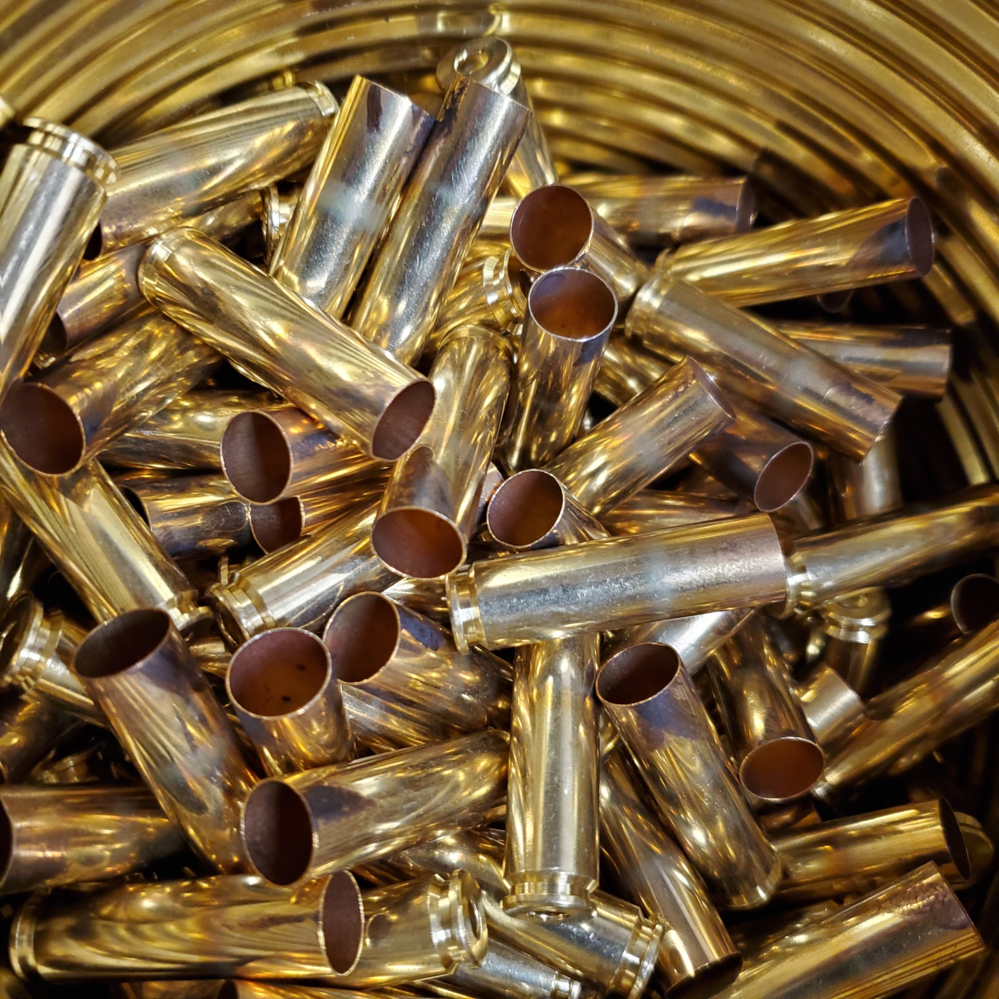

Never out of brass ... serious brass making, milling to length, neck turning 900 pcs, 510 whisper cases.
The 338 Spectre or 338 ARC are easy, there are always cases available, but they may have to be modified. Head turning and extractor grooves recut, even 308 to 6mm ARC is possible but alot of work.
I make quite alot of brass for obsolute calibers. If ya depend on others, many times ya have a long wait.

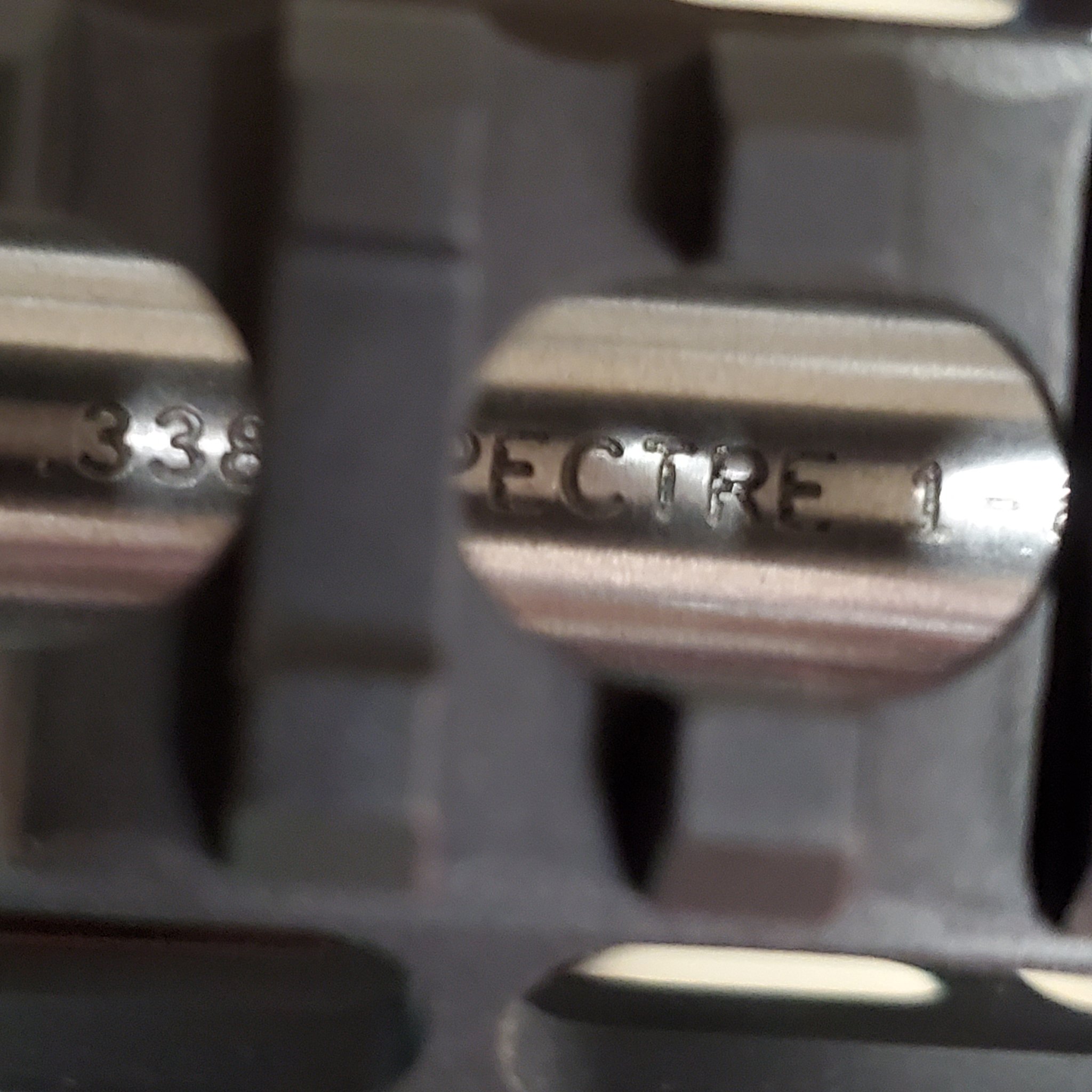

So purchased the 338 Spectre barrel & cheap brass waiting on 338 ARC reamer.
Went out and shot it, after waiting for the weather to clear, it was cold.
Tried both SR & LP primed cases.
Pushed the Speer 200 gr bullet to 1900 fps in the LP primed cases...need to back off to 1800 fps for this bullet, and pistol cases.
It was very accurate with subs 200 gr and 300 gr SMK with pistol primed cases.
Ran the 160 gr 338 Barnes to 2141 fps with the SR cases, which is too warm, 2080 fps might work out well for this combo, it's accurate.
Also ran the 350 gr Maker at 880 fps in SR cases as the pressure moves up fast in tiny volume cases with heavy bullets. This was an accurate combination.
350 gr Maker turned the bullet point 9° angle and cut .060" off the hollow point to fit mag lenght in AR15...So the orginial 350 gr Maker was actually weighed 346 gr and modified it was 340 gr. fit snugly into the AR 15. With no cutout magazine

This 338 Spectre barrel has a 6.5 twist Hornady 338 ARC an 8 twist barrel.
This 338 Spectre shot everything well I tried 160 gr Barnes to 350 gr Maker, I was impressed for the first time out.
