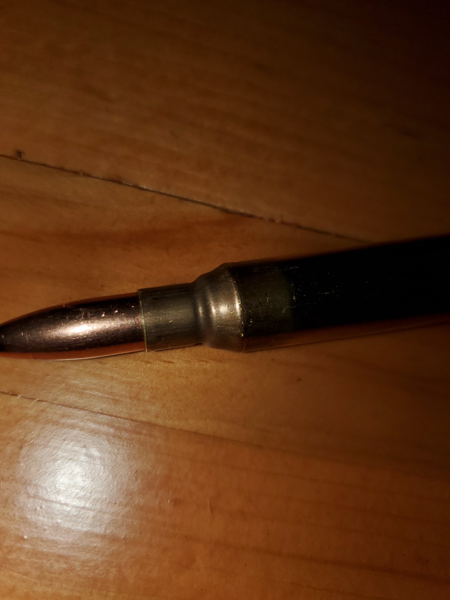

338 lapua magnum, case trim length is 2.714
Bullet seating depth is 3.681
Sized with a fl redding sizing die.
Did not bump shoulder back any.iv never reloded for 338 so im not sure what is going on with this. I tried to chamber it and it wouldn't chamber im assuming the shoulder needs to be bumped back but a non fired empty case chambers just fine so it makes me think the seating depth is off but I went by the specs I could find on it any help is much appreciated. Iv only been reloding for a couple years and never ran into this problem before.

I take it your brass is new. Also, you loaded pretty much to specs. That is what all ammo is loaded too. ie... LM factory ammo, to 3.681. Could be wrong on that. But I believe that's what most are loaded to. I had that problem on neck sizing. Thats why I changed to FL sizing. Also, I see you're sizing with a FL die. I would try, and bump one back. See if that was the issue.
Also just looked at pick. Your shoulder doesn't look right. Seems like the neck is pushed down a little. Over sized maybe, if thats a better term.
Reactions: rady
I see its pushed back but wasn't sure why exactly.i don't have a book for lapua magnum. The books I have doesn't cover it unfortunately.the throat pushed back when I tried to chamber it. A diffrent empty case chambers just fine and it was resized same as the one in the picture.i guess I could try to seat the bullet a little deeper to see if that would work.i just wasn't sure if it would need the shoulder bumped back or seating depth more.
I see its pushed back but wasn't sure why exactly.i don't have a book for lapua magnum. The books I have doesn't cover it unfortunately.the throat pushed back when I tried to chamber it. The empty case chambers just fine and it was resized same as the one in the picture.i guess I could try to seat the bullet a little deeper to see if that would work.i just wasn't sure if it would need the shoulder bumped back or seating depth more.
Well your shoulder shouldn't look that way. Is what I'm saying. Uh, how did you set up your die. Did you raise the press all the way up, with shell holder in it. Then screw your die in till it touches shellholder. Then from there you should adjust lower if need be. ie... bumping shoulder back.
Try it that way, and you will see a difference. Or, you should put it that way. Hopefully it fixes the problem.
I watched a video where the guy said if the case doesn't chamber rite u can turn the die in a half to full turn and it would fix the case to where it will chamber rite but I haven't tried it yet because a empty case that I have resized already chambers just fine. I guess I could try to turn in the die a half turn and go from there and hopefully it will bump it back enough. If it doesn't work I'll wait to get a book that covers it.
[/QUO
Half a turn might be to much. Go with about an 1/8 to 1/4 of a turn. To start out, better way to see what you need. Unless you know you need more. Then 1/2 would be ok.

The problem is that your seating die is not properly adjusted. You have the die screwed in too far so it is trying to crimp the neck while the seating stem is still trying to seat the bullet in deeper. This results in crushing and deforming the entire neck and shoulder of the case.
Back off the seating die a full turn to start and back out the seating stem. Run a sized empty case without any powder or bullet and the case dimensions on the neck shouldn't change. Then charge a case, seat a bullet and adjust the seating stem to get the desired seating depth.
It may not be necessary to bump the shoulders back any on once fired brass. My Lapua brass in .338LM took three firings before any shoulders needed to be bumped.
Edit to add; I've got the same RPR. It likes the Hornady 285 gr. ELD-M with H1000 & 215M. Good luck! It's a blast.
The neck was fine till I tried to chamber the round . then the bolt wouldn't close all the way so I extracted the round and the neck was pushed back as in the picture.thats why its got me stumped on whats wrong.this is the first time iv reloded for bolt action rifles. I usually load 223/5.56 or 9mm so iv never ran into this problem before
You mentioned in post #112 that another sized case chambers just fine. It pretty much narrows it down to seating. I highly doubt that this was done during chambering. It would have taken a lot of force.
Try doing what I suggested in post #115. You shouldn't have to taper crimp this cartridge. When you run a sized empty case through the seating die, you should feel no resistance. To set the seating die adjustment, run a sized empty case all the way up in your die, then screw the die down until you feel contact, then back the die off 1/4 or 1/2 turn and set the lock ring. This method will not taper crimp when seating.
