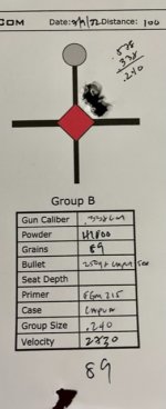

338 Lapua Magnum
This is the Berger target over two range visits encompassing 8 days, or so.
I couldn't get to the 1000 yard range over 200 miles away, so I just played with seating depth. The longer rounds (closer to the lands) are towards the left/top.
SDs for me, when I can chrono things, are in the lower double digits, but since I'm just a hack, I don't sweat things too much.

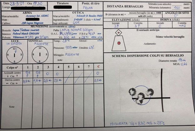

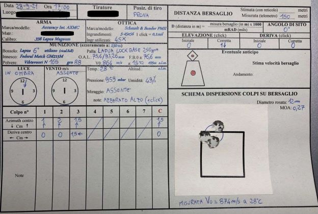

In Italy it is almost impossible to find your powders so I specialized on the Vihtavuori powders.
For my AXMC I have tree recipes that have proven to be accurate and consistent.
Lapua Brass
Federal 215M
88grn N165
Lapua Lock base 250grn
FB 1mm
V0=864m/s (15°C)
Lapua Brass
Federal 215M
92grn N165
FB 1mm
V0=896m/s (20°C)
Lapua Brass
Federal 215M
91grn N570
Lapua Scenar OTM 300grn
FB 1mm
V0=832m/s (28°C)
But I've seen you guys push 300grn balls much faster.
Aren't you afraid of going too high with the pressure?
Then I noticed that it is not necessary to go with very low FB in the .338LM instead I see that you even reach 0.01mm .....
Have you seen any improvements?
thanks

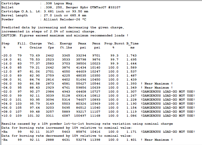

Best powder for Berger 250's? I'm currently only getting 2800 FPS with 90.3 grains of H1000.
Vihtavuori’s N560 560 link
book max on berger 250 grain's of N560 is around 89 @ COAL 3.681 inches; gets you around 2907. VV tends to post on the safe side.
Now, 560 is a dual mix, so it runs a bit hotter; and people have said that it will increase throat erosion faster than a single based propellent.

It’s interesting that the max load for N560 varies significantly between the 250 Scenar and Berger OTM.
